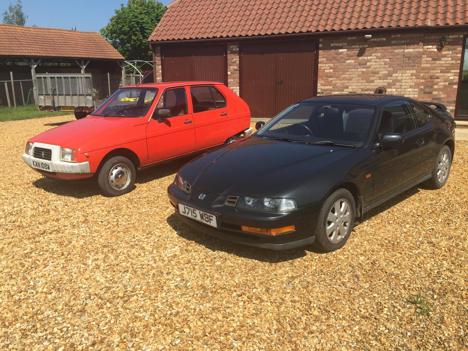

JohnDeere Posted June 9, 2016 Author Posted June 9, 2016 A slightly sunnier version of Japan-France relations. It would be a perfect pic if the Prelude wasn't covered in bird shit and dust from ploughing. Jim Bergerac, Six-cylinder, HillmanImp and 4 others 7
Spottedlaurel Posted June 9, 2016 Posted June 9, 2016 A slightly sunnier version of Japan-France relations. It would be a perfect pic if the Prelude wasn't covered in bird shit and dust from ploughing. You use the Prelude for ploughing? Interesting choice…. wuvvum, JohnDeere, Dick Cheeseburger and 4 others 7

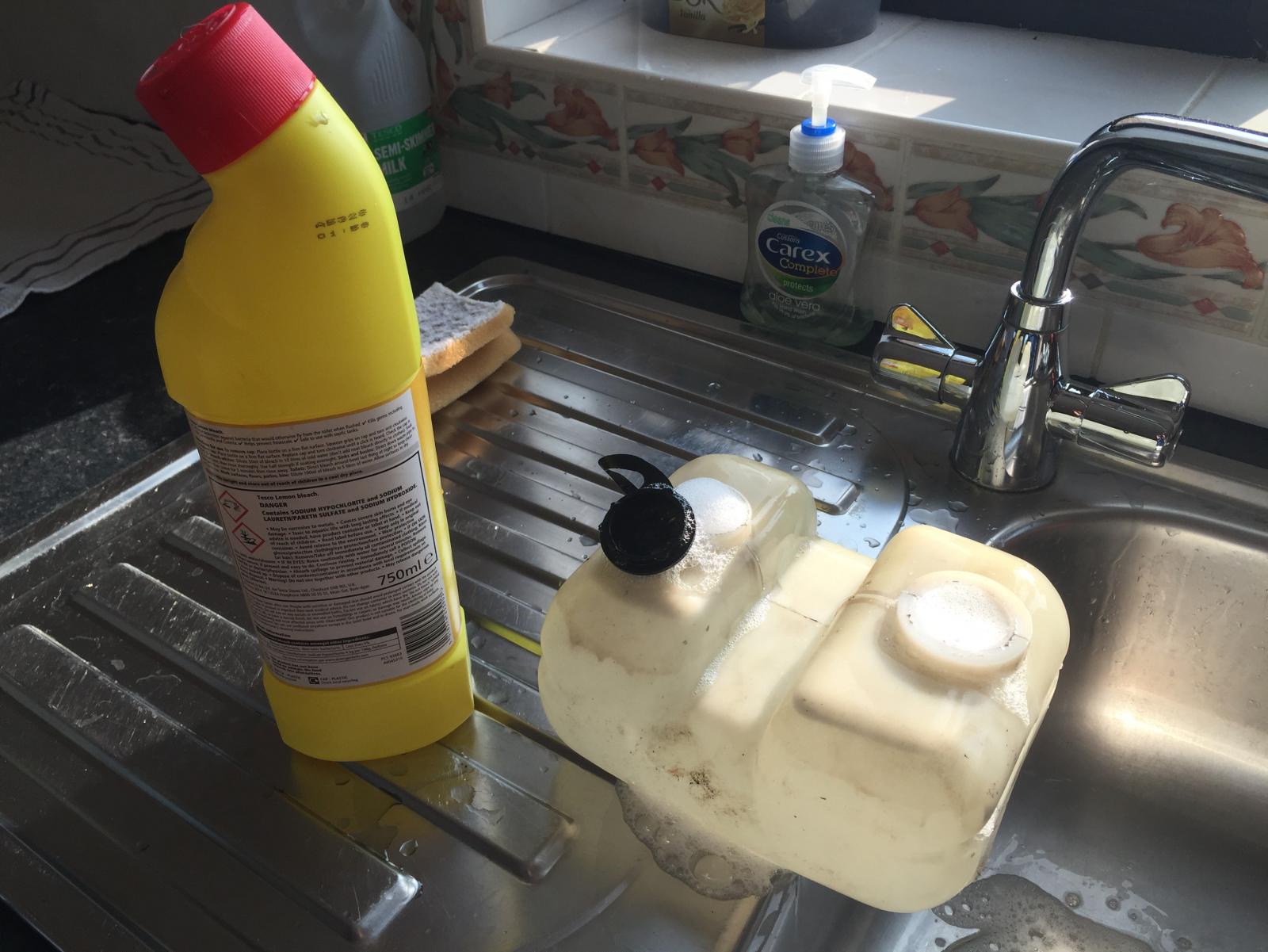

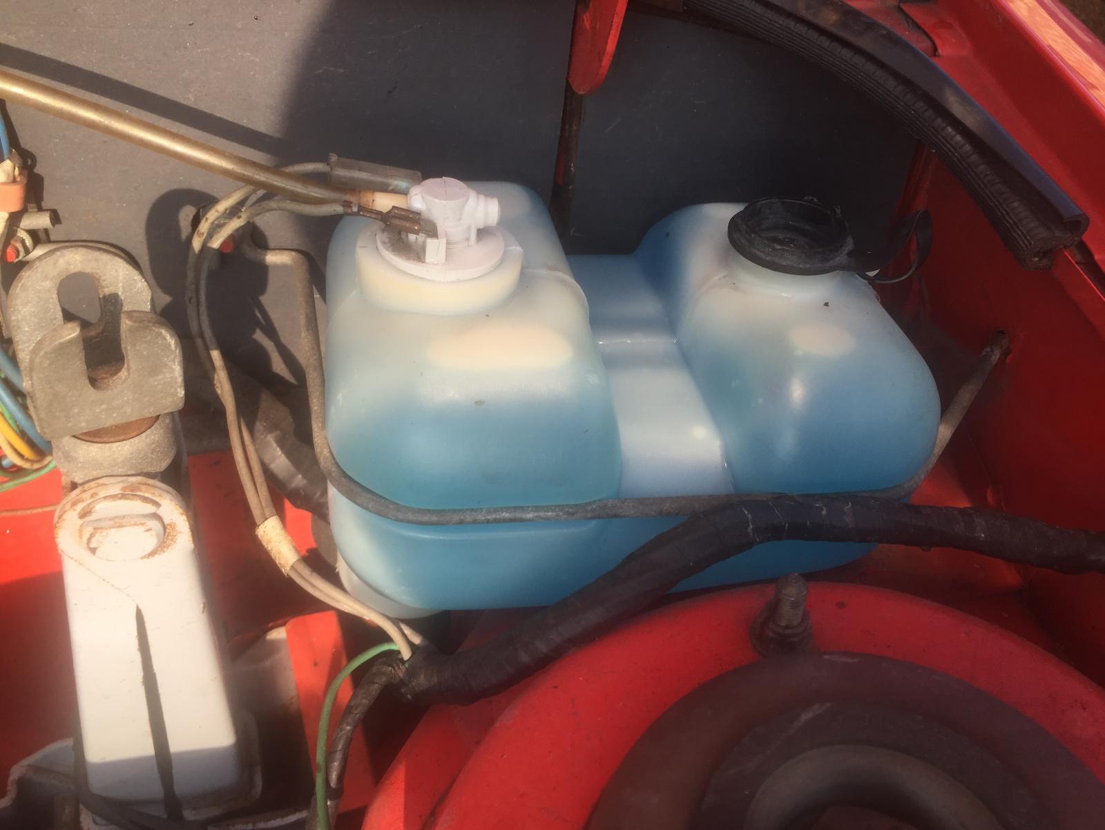

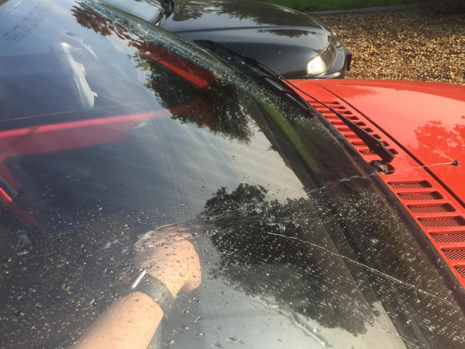

JohnDeere Posted June 9, 2016 Author Posted June 9, 2016 More Visa news. First job done. Barrett let me know that the windscreen washer water wasn't washing the windscreen. Say that out loud a few times. A test with the magic meter showed that there are volts and amps and all manner of electrickery reaching the pump when the button is pressed. That is a good thing. Obviously this picture shows 0v, but I couldn't squirt and shoot at the same time: Let's have a look at the pump. This doesn't look so good... In fact the contents of the tank were some form of primeval slime. I had David Bellamy knocking at the door. I then followed the Haynes Guide to Vulgalourising your car.... And it came out nice and clean. Add a bit of blue... Final clean up of the nozzle with a needle, and... We have water... and one less thing to fail the MOT. Six-cylinder, Lacquer Peel, Jim Bergerac and 6 others 9
