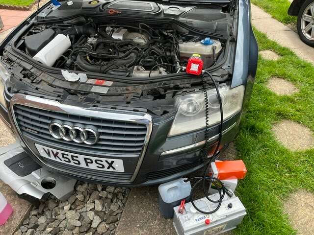

More A8 stuff: oil and filters change.
@Kiltox did mention it needed a service when I bought it, so amongst the boxes of Range Rover parts arriving there were also 10 litres of 5w30, an oil filter and an air filter.
Its the first time I’ve used the Lidl oil pump:
Genuinely a game changer. If you’re putting off an oil change because you don’t want to be scrabbling around under the car, spilling oil on your drive etc, get one. 8+ litres out and into a couple of bottles within 10 mins and no mess. I’d still be wanting to do a full sump drain every 3rd change just because it’s likely there’ll still be a few hundred ml’s of old oil that the pipe down the dipstick won’t have picked up, but even draining via the sump plug you’ll never get all the schmutz out without also removing the sump itself and giving it a proper bath.
Filter housing wiped down, new o-ring on the housing cap, and new filter in and pre-filled as much as possible:
Never hurts to fill an oil filter up with oil, this took a good litre and a half to bring it up to the level seen here. Don’t fill this type of filter housing to the brim, or it’ll overflow when the cap is screwed down.
New air filter as the old one was a bit grim (though by no means the worst I’ve seen):
All cleaned, plastics all wiped down, all done. Less than an hour including a brew stop and dealing with the kids asking questions.

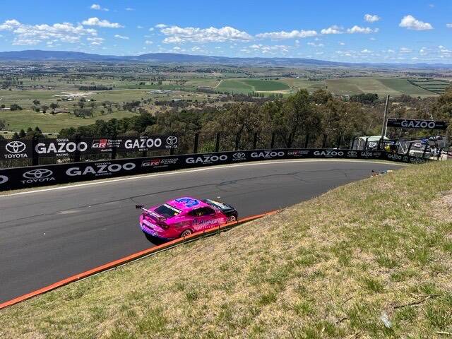

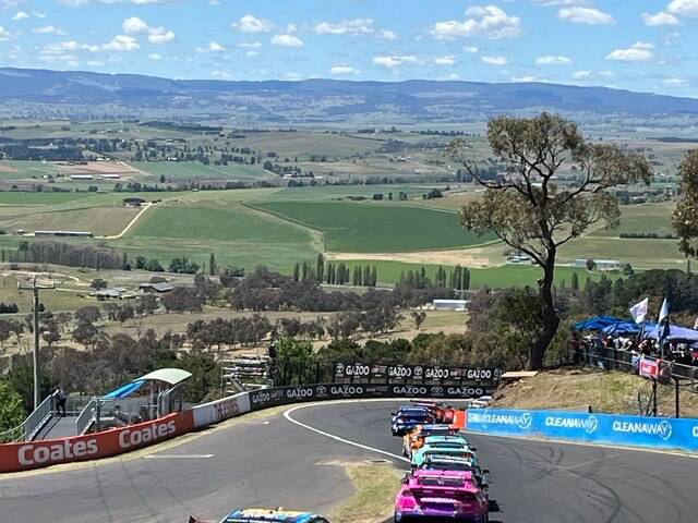

On Sunday I visited a small local motor race:
First, a couple of older motors on display:
And some of the on track action:
Bathurst is incredible. If anyone is thinking about going, JFDI. I could write loads on the whole experience, but the best thing to do is book a ticket and go. The campsite at the top of the mountain is something to behold, it’s a proper temporary village with people clearly so well kitted out they’ve been going for years. There was also this:
