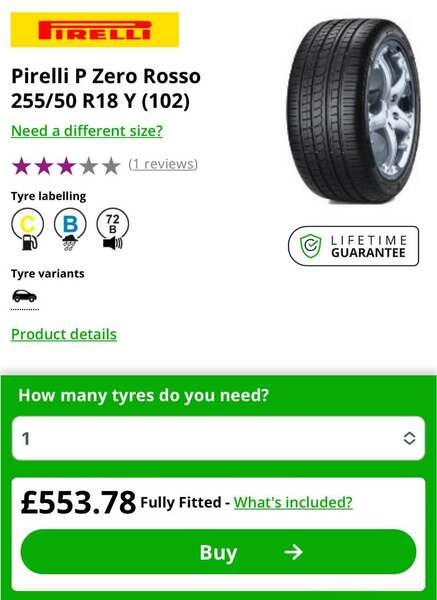

The Bentley's tyres will be done first as the first available slot for the Range Rover's windscreen was after the test slot, and the Range Rover has ticket until the end of March. I've settled for a set of Hankook Ventus S1 Evo's all around as the Arnage wears a slightly oddball 255/50/18, which came to just shy of £700 fitted at home. I declined the opportunity to fit the Bentley approved Pirelli P Zero Rosso, because the Hankooks have better ratings for load, noise and wet weather, and also:
Yep, over £2,200 just because they're 'approved'. For context, the bigger Pirelli P Zero Scorpions on the L322 were less than £600 for the full set.
Fuck. That.

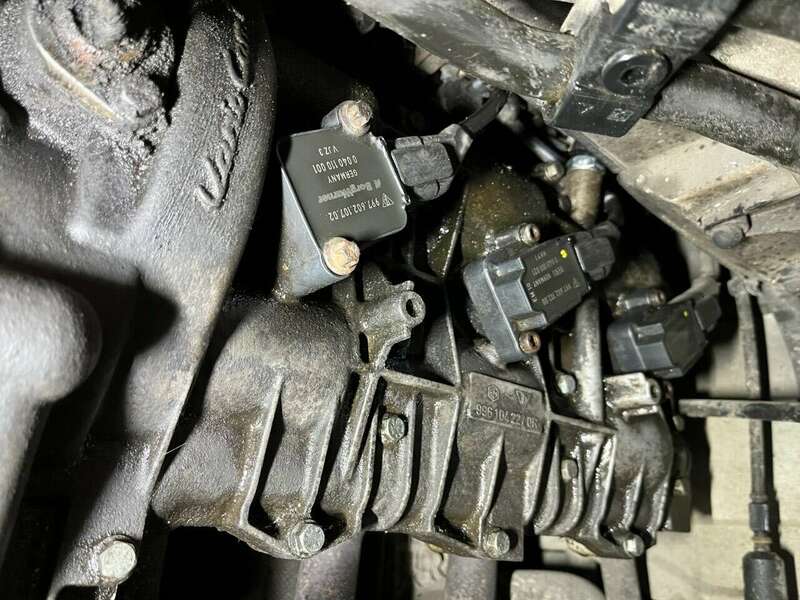

With a spot of dry weather today it was time to tackle the Porsche’s inability to contain its oil.
From a previous look under it was definitely wet around the o/s cylinder head, and I was expecting the spark plug tubes to no longer be oil tight.
Clearly moist. Not enough to be smelling of hot oil like it does though, so more investigation required. Started the engine and ran it at a fast idle to see if any oil made an appearance, and sure enough a thin bead of it appeared down the cam cover between the first and second coil packs:
Looking up it appeared to be coming from the oil pressure sensor area. Took the engine top cover off and found this:
2.5 litres of dusty Porsche M96 engine.
More importantly there was also this:
The black shiny thing is the rubber cap over the oil pressure switch, wiping it off and running the engine showed it is leaking around the plastic base so time for a new switch. The plug tubes definitely look wet and will need changing at some point but for now I’ll fit a new switch and make sure that leak is gone first, so a liberal dose of engine degreaser will be needed.
You would think that after all these years Bosch could make pressure switches that didn’t do that.

New oil pressure switch fitted:
I took the old one out with a 24mm shallow socket. Not ideal, but got away with it but just dropping the extension bar in the top of the socket resting on the spade terminal. I didn’t want to do that for refitting, so on the way back from buying the switch I stopped at Halfords and bought a 24mm deep socket.
The new switch is 23mm across :angry008:which caused an attack of the swears.
Luckily I could just about get a 23mm spanner in there to nip it up, but I should really buy a full set of deep sockets. Next up was trying to get the engine bay a bit cleaner, I’m not after the concours look but being a bit less covered in crap makes it more pleasant to work on:
Also scrubbed off the o/s cam cover to see where else there are leaks:
Took it out for a quick Italian tune up, the smell of hot oil dissipated quickly and didn’t come back so hopefully that’s a win. No evidence of leaks when I got back either.
