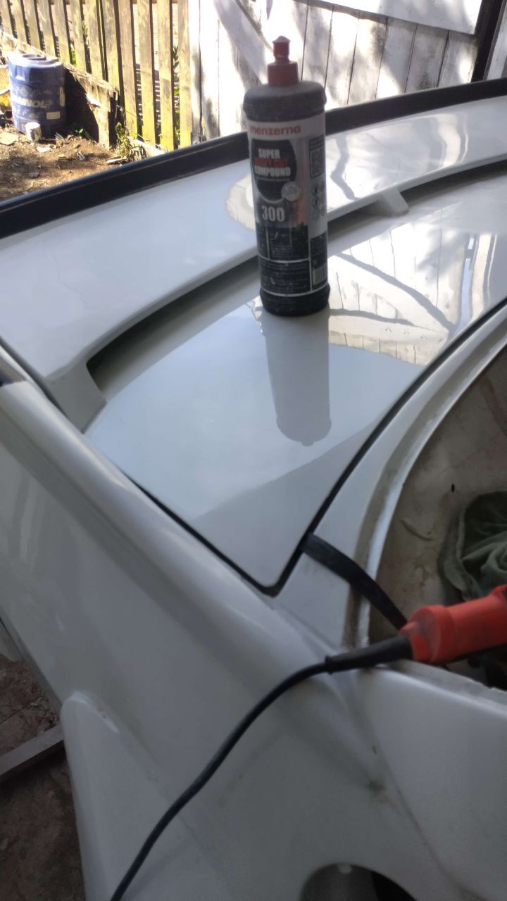

GingerNuttz Posted September 3, 2024 Posted September 3, 2024 Scuff and a buff in a few days. JMotor, Back_For_More, paulplom and 19 others 22

GingerNuttz Posted September 4, 2024 Posted September 4, 2024 Tis very white 😂 The gaffer approves Little but of urethane wave but it'll block out before it's buffed. dome, Saabnut, Joey spud and 21 others 24

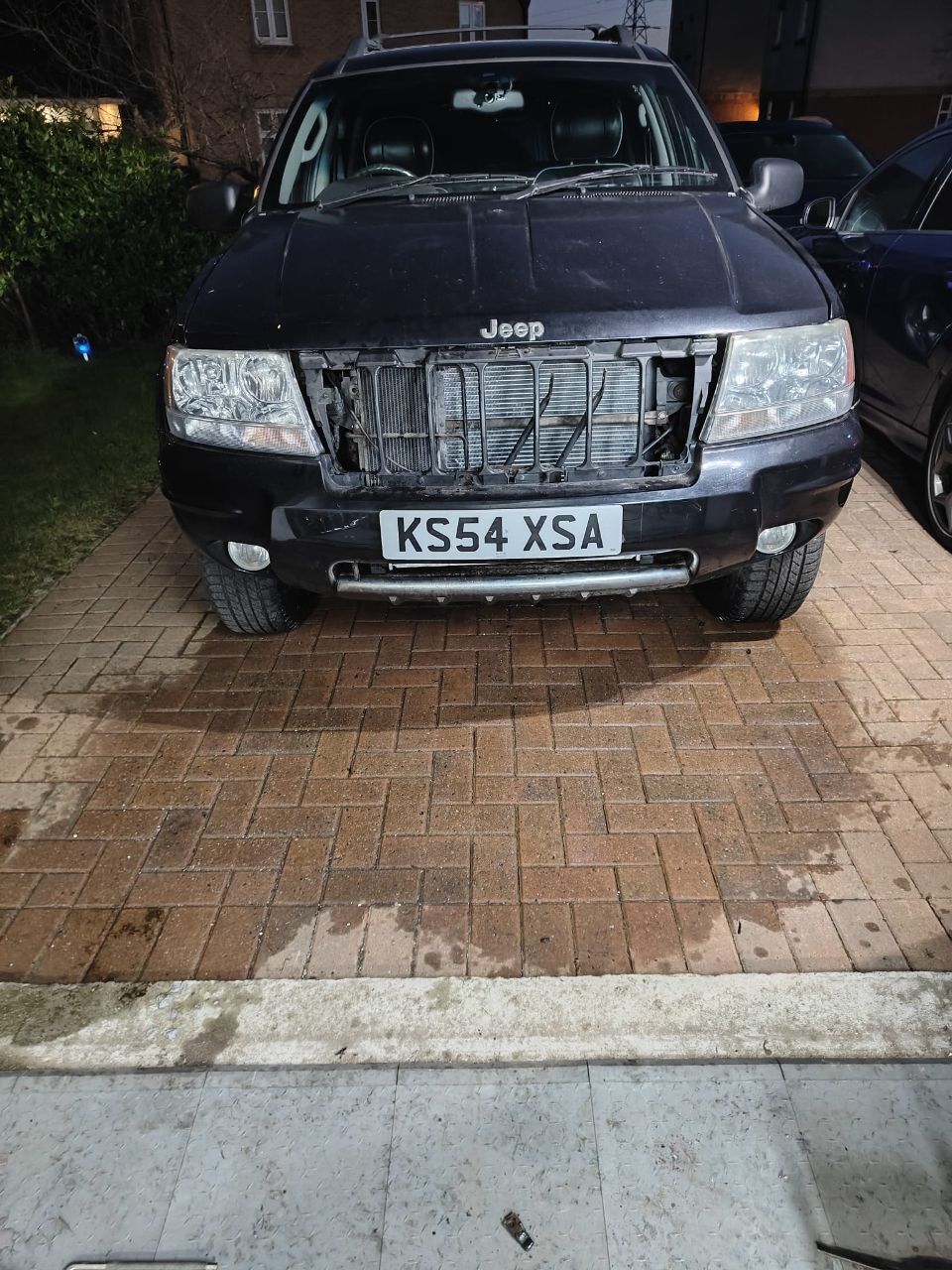

dome Posted December 16, 2024 Author Posted December 16, 2024 Well, that escalated quickly on the Heep At least @GingerNuttzwill be able to enjoy his Carribbean holiday when I've paid for the welding 🫣 IronStar, Dyslexic Viking, somewhatfoolish and 5 others 3 3 2

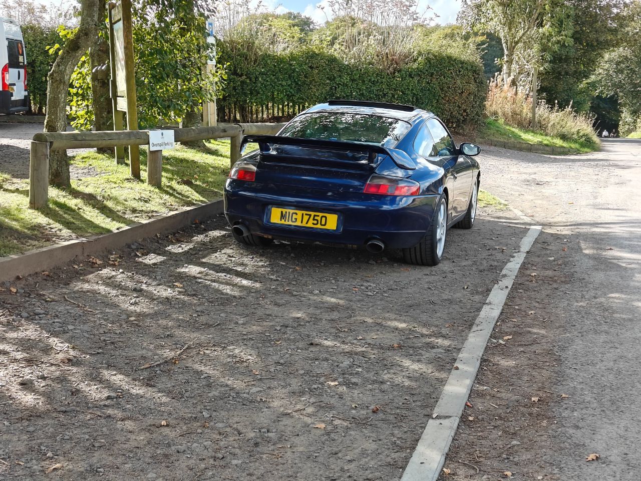

dome Posted November 1, 2025 Author Posted November 1, 2025 911 This has been in the doghouse a bit due to the deteriorating bodywork. The £11k glass out respray it had before I got it was done by fucking cowboys and both rear arches and sill ends/sills have deteriorated rapidly since I bought it. I did buy some blue duct tape though so that's fine* Because of this I'd not been using it that much but I decided to ignore it as you can't see the shitty bodywork from the drivers seat. So, in August I set off up to Aberdeenshire to watch the Grampian Rally, a round of the Scottish Rally Championship. All was going fine until I used the brakes north of Coupar Angus and the pedal went to the floor😶 I limped it to a layby and found a puddle of brake fluid under the drivers front wheel. Splendid* It had enough brakes to limp it home and I then stuck it in the garage and decided to see what the fuck was wrong with this cunting thing this time. Assume the position... It didn't take long to find the issue-the linking pipe between the two halves of the Brembo caliper had failed. The pipe has a rubber cover and water must have got in and corroded it. Here's the offending article, along with a similarly crusty "stainless" brake hose. The brake lines on this have seen attention before and regular readers may remember the line that goes over the gearbox failed on me not long after I got the car. Time to try and sort it once and for all(maybe) There was no way I was going to drive it without replacing the other link pipes, which meant making sure all the bleed nipples (2 per caliper) were free. And replace all the stainless flexis. And make up new hard lines for each corner(apart from the one I had done already) as each caliper would ideally have to come off to replace the link pipes. So, 8 bleed nipples and between 4 and 8 unions to undo per corner to replace all the crusty stuff. You can imagine how much I was looking forward to this. There's not many pics here but you may be surprised to know that with a combination of plusgas and heat I managed to get almost everything undone successfully. Caliper off and in the vice. New lines made up and fitted Another crusty link pipe. You get the idea. I had one union pull the threads out but got a local engineering place to sort this for me. I also had one bleed nipple pull the threads out but you can get kits for this-handily my mate Stu at Renomotive sees this with the Brembo calipers on fast Renaults so he was able to do a repair for me-nipple therapy FTW I finally managed to go through the whole system and get it back together and bled up. SO I could actually drive it again! Meanwhile I had bitten the bullet and ordered up some new panels for it which arrived a couple of months ago Once the Manta is back it'll go off to @GingerNuttz to let him undo the bodgery by the previous bodyshop Oh and the indicators decided to stop self cancelling. A common thing on these and a new set of stalks are required. I took this as a sign and ordered up a set with a cruise control stalk so I can add cruise to it in the future. In true 911 style all of the specialists have these available at prices far more than if you actually go to the dealer. A second hand one is about £300, my dealer is getting me a new one for £320 🤣 Cruise control is going to ave me money, this thing has a natural cruising speed that will rapidly lose me my licence😶 yes oui si, Dyslexic Viking, 320touring and 15 others 18

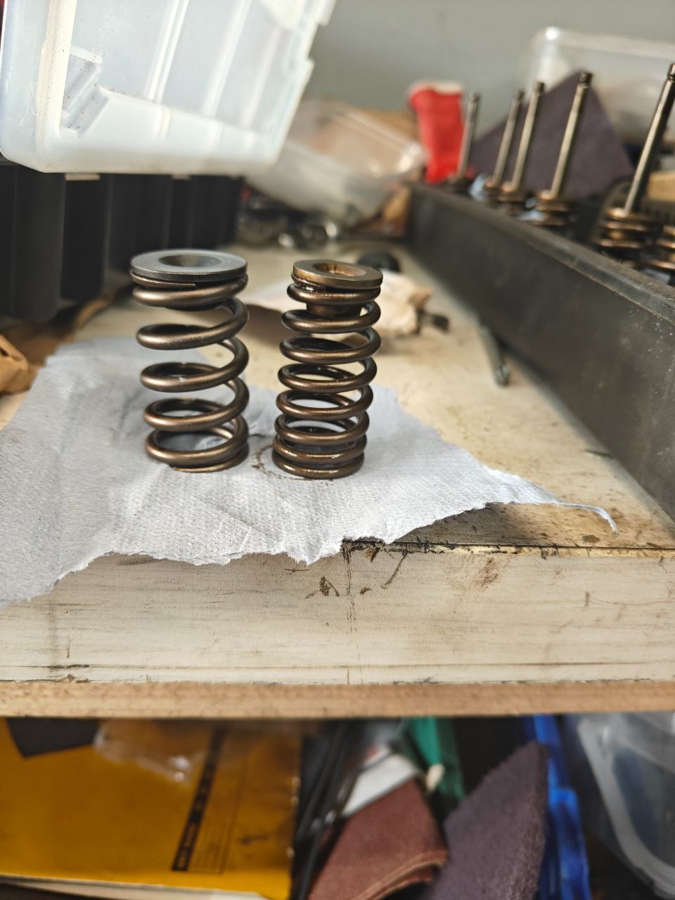

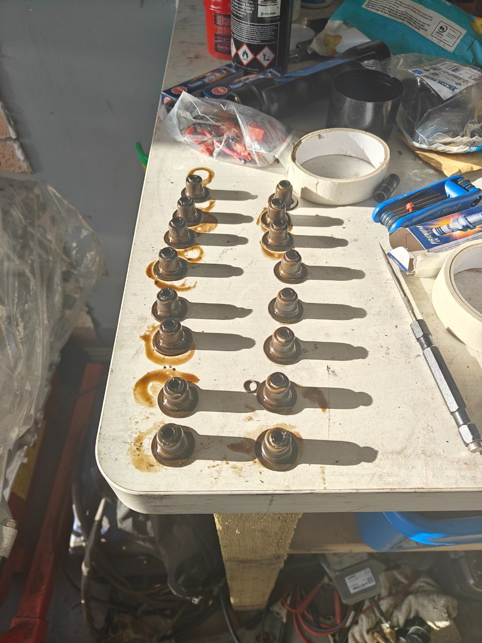

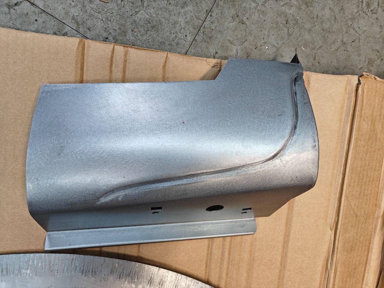

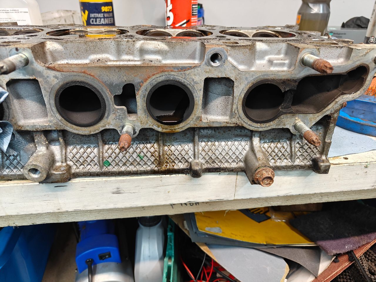

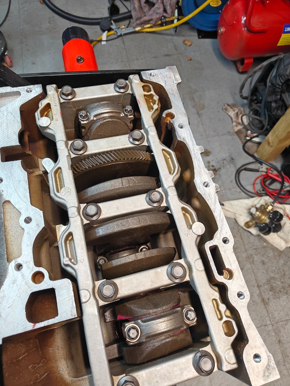

dome Posted November 1, 2025 Author Posted November 1, 2025 Manta As you can see from the pics above the bodywork on this thing is nearly complete. I can't wait to get it back and then the fun can begin. For those of you who are new/have forgotten I guess I should go back to the start I've always loved Mantas and rallying in general. I decided I wanted to build a 400 kitted Manta but also wanted to modernize it a bit, for various reasons. I picked up a Mk3 MX5, these come with a tool eater 160bhp Ford Duratec engine. I also picked up Mazda6 2.5 Sport. This has a 2.5 version of the Duratec but is only rated at 170bhp as standard. The 2.5 swap is a common thing in MX5 circles, especially in the US where the 2.5 engine was fitted to a lot more cars, over here I think only the Mazda6 (and maybe the 5) got them. There's a crazy situation around these engines whereby if you go to a UK Ford specialist to get parts there's definitely a Fast Ford Tax on things whereas in the US Mazda MZR(the Mazda name for this engine) parts are a lot cheaper So, a couple of years ago I ordered up some shiny bits from the US The 2.5 engine was tuned for torque and had low compression and fairly mind cams. A tuner in the US had done some homework and found that an oversized piston for a GM 2.4 4 cylinder is a perfect fit and raises the compression ration from 9.7:1 to 11.5:1 I also purchased a new set of Stage 2.5 (yes it is a thing) BC Racing cams to liven things up a bit and uprated valve springs too. I don't want to go too mental, around 200bhp would be ideal and more importantly I wanted an NA 4 cylinder to keep it true to the original 400 (It had a 2.4 4 cylinder with heads by Cosworth). All of this came from the US (a couple of years ago admittedly) and I had change from $1000. For context the piston set alone in the UK is £1k 😶 Anyway, in a spectacular display of taking ages to do anything nearly 3 years after ordering the shiny bits I finally got my bottom end assembled today. In my defence I've never used file to fit piston rings before (more info here) and it took me a while to get my big boy pants on and actually file them down to fit. This week however more has happened, here goes. Pakora sauce is the key to building engines. The block and cranked had been checked over by a machine shop and pronounced as good. So, gloop it up No pics of fitting the pistons but here they are installed. Note my markings on each piston of where to locate the ring gaps for each ring, as per the Total Seal instructions. You'll note they aren't connected to the crankshaft yet, this is because the big end bearings I'd bought 3 years ago were the wrong ones. It's not all bad, they'll fit my Focus though 🤣 Correct big end bearings ready to install And the bottom end assembled The shiny engraved metal bit just above middle left of the crank is a blanking plug from where I've removed the balance shaft that these engines came with as standard to let it rev better, save weight and release a few horsepower. If you were fitting a Duratec to your Mk2 Escort then many Ford specialists will happily relieve you of around a grand for a bespoke sump. Or you can do what I did which is buy a Ford Ranger sump from Rockauto for about £100 which does the exact same job🤣 No pics of it as it's currently attached to the tool eater engine which is at @GingerNuttz garage where it was used to ensure this batshit idea would actually fit into the Manta. Spoiler alert - it does after he did some amazing work to make it happen🙏 With conrods connected and pistons in the correct positions. Now onto the head. I hadn't touched the head yet so had a look to see how it was. Hmm Upside down and filled the combustion chambers with fuel Hmmm It was getting stripped anyway so here goes. Shiny tool, bought from @DavidB which fitted perfectly And valve stem seals removed Head now bare And after a mild cleanup I'll need to carry on cleaning it up and then regrind the valves-something I've never done before. But then I've not done valve stem seals either, or removed valves for that matter! I could get some porting/polishing done to the head but I believe these flow pretty well as standard. I may look at doing that in the future but in the meantime I'll be happy with cleaning it all up and getting it back together with new seals and the valves ground in. The Manta now has a Volvo 940 rear axle fitted with a 4 link kit. The standard Manta axle is a weak link, comes with drums and an LSD is ridiculously expensive. The 940 axle comes with discs and an LSD is much easier to come by for sensible money. Also it means I can run 5 stud wheels the same as a real 400. This did leave the problem of getting the front converted to match but there is a company in England who'll make a blank hub for Mantas which you can get drilled to any PCD you want. I dul bought this and gave it to my tame engineering place who drilled it out to 5x108 I do need to work out what brakes to use. I was tempted by Brembo but the 911 put me off them for life 🤣 5x108 is common on a lot of things, ideally I'll get access to aparts catalogue and be able to find a disc/caliper combination that'll work. Whew, well done if you've made it this far. Stay tuned for more updates as I carry on assembling this engine! Oh and finally have a pic of my new valve springs-new on the left vs the originals. Meaty! Fraz, High Jetter, Tickman and 20 others 23
