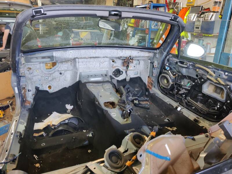

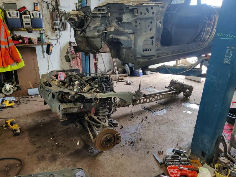

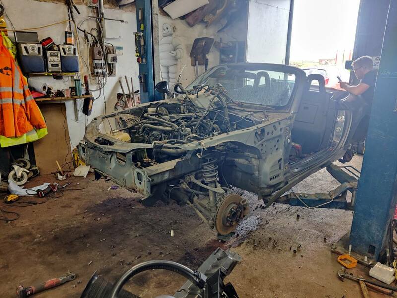

So on Saturday we set out to strip down the MX5 and get everything off it that we could-space was at a premium so it needed to be gone ASAP.
I started on the interior whilst Stu started stripping panels and getting ready to drop the front subframe out with the engine attached.
Pretty quickly it looked like this.
With it being so rusty underneath it was decided to forego the subframe bolts and go for a more, err, direct approach to removing the engine and back axle.
Reciprocating saw ahoy!
Up she goes, with very little left attached handily...

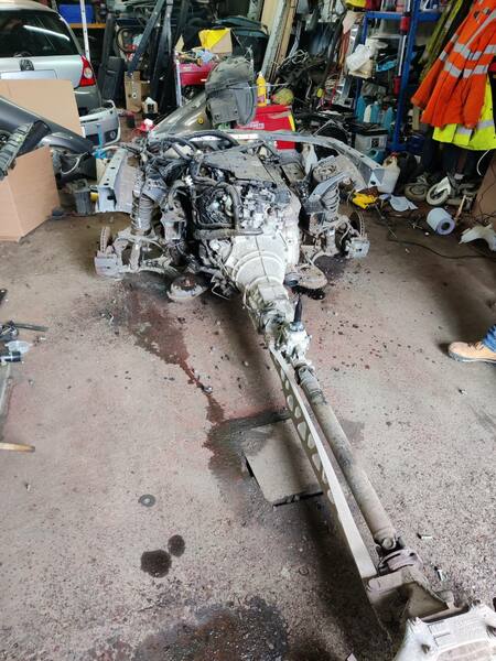

Believe it or not the engine and loom came out untouched. The recip saw was also applied to the rear arms as they were fucked. The diff should be worth selling on though, being an LSD.
With the engine and box safely deposited in the back of the Kangoo we could continue harvesting the MX5 for anything worth saving.
I carried on with the interior. I have no idea how much loom it will take to get the engine to run so I took pretty much all of it, along with the ignition barrel and pretty much every sensor I could.
Coming out
And stripped
If anyone needs any Mk3 MX5 parts you know who to speak to!
Suitably stripped the MX5 shell was dragged away ready for the crusher.
Not a bad days work!

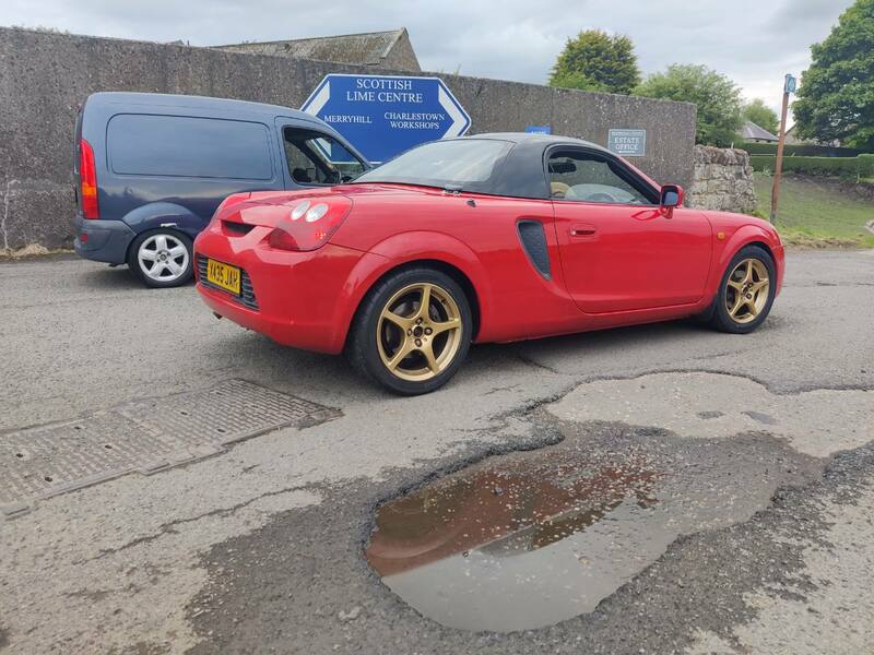

We ended up having our first 2 track days of the year in quick succession. I gave it a quick oil change before the first one, gave it a quick check over and fitted it's new, shiny track tyres.
Here it is ready to go, along with the support vehicle
And at the track
Another pic
And it seemed to go down well at the track 😁

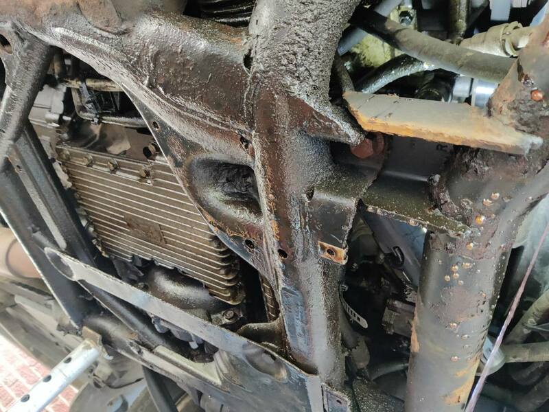

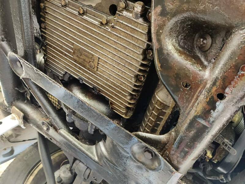

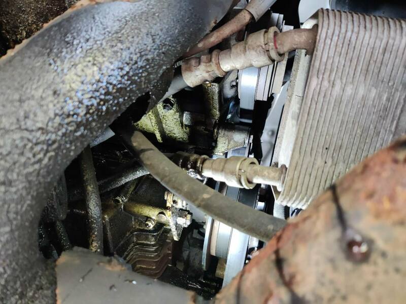

This has been wafting along quite happily. I did notice a couple of weeks ago it appeared to be marking it's spot a bit more than normal so had a look underneath in an attempt to find the leak. Oil mainly, but also a bit of coolant more worryingly.
oily.thumb.jpg.dcdfc5689292670e8c776da04eabcae4.jpgoily2.thumb.jpg.e049e2d598c9ae5d98f702885e87110b.jpgoilytwo.thumb.jpg.a5821542bf264d3d55c36fa4fead92a2.jpg
Nothing conclusive there, just quite a lot of oil distributed all over the engine bay so it must be dripping onto the pulleys at the front.
I sprayed it with some degreaser and gave it a blast with the hose, I'll definitely* revisit it soon to see if the source of the leak is apparent. There's still one rocker cover gasket to go but I'm pretty sure there's oil coming out of somewhere else.

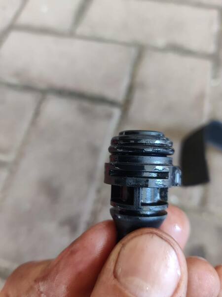

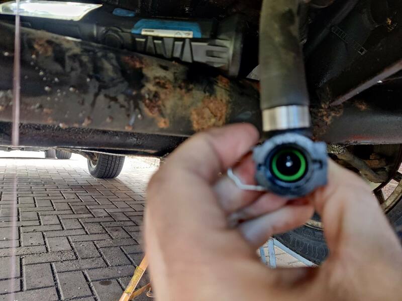

Coolant wise there was some telltale signs of leaks around the lower radiator connection and also on what I think is the transmission cooler thermostat. I still have a big pile of orings from the set I bought from the US so changed over everything I could find. I can't recommend this enough to folk with older BMW engines.
Here's one of the old orings, you can see how it's profile is no longer round
And the new one fitted
Much better!
Have another(bad) picture

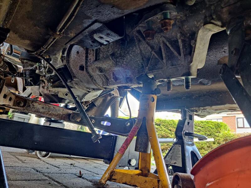

The new green oring has been installed in the coupling ready to go back on. BMW don't seem to list a lot of the coolant hoses any more. The hoses themselves aren't usually the issue, it's these orings.
Back together and bled and it's still using a wee bit of coolant-I'm super anal about checking it though so I've never actually had the low coolant warning come on, only dropping a wee bit in the expansion bottle.

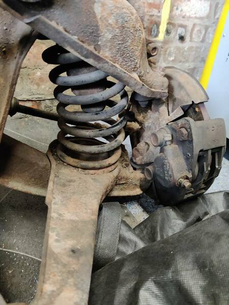

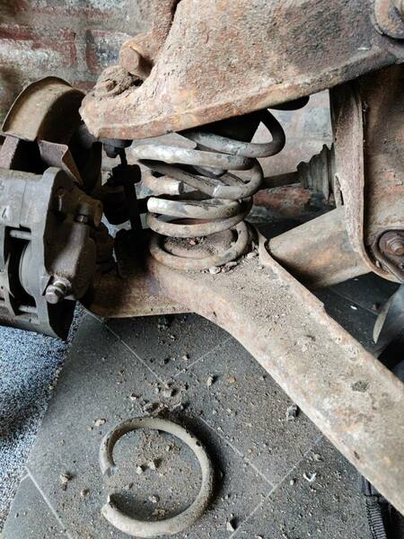

Did a wee bit of work tonight on the Mantas front suspension.

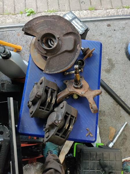

Mr Scary long front spring, meet Mr. Grinder.
IMG_20210610_180713.thumb.jpg.1c46bee3ff66f68de1652e74ba6f7a72.jpgIMG_20210610_180709.thumb.jpg.477ae3ab90572cc6950c4c8e196c96e0.jpgIMG_20210610_193158.thumb.jpg.a76d9f5ff87ef46b7d43243b6d466d0c.jpgIMG_20210610_193255.thumb.jpg.f6df34da52bd1438d8abc86a20c11cf1.jpg

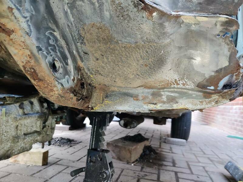

The condition of the parts is bloody good for being 40 years old. Brake backing plates are in excellent nick and the bolts undid without a problem. Still got the other side to do, them pull the engine off and trial fit the Duratec

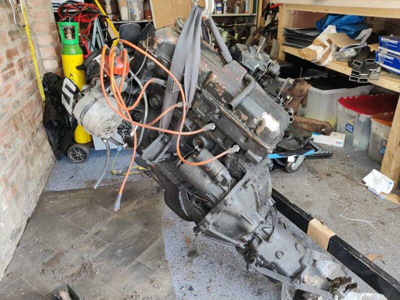

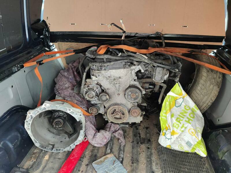

Then I could remove the old engine and box from it.

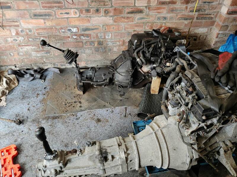

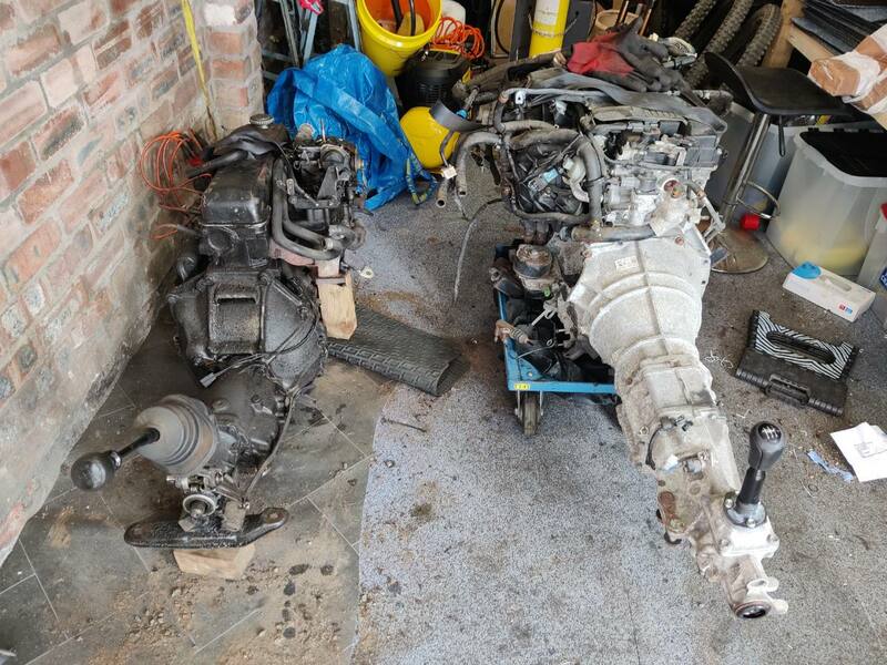

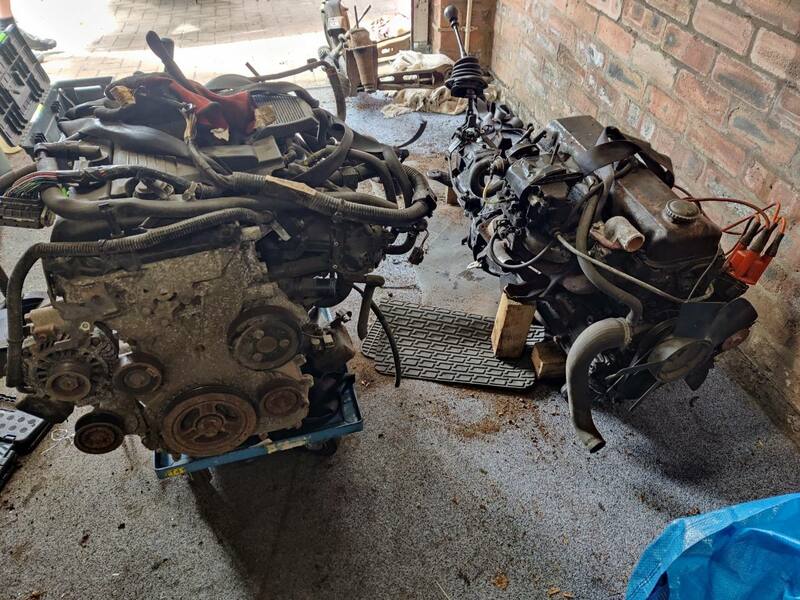

Once that was done I got the new engine and box out of the Kangoo and sat them side by side to see how they compared
IMG_20210612_133419.thumb.jpg.3122410af526e6efed990569517158fd.jpgIMG_20210612_133424.thumb.jpg.11f2b20a10f02336655fa9aefb2dc856.jpgIMG_20210612_133431.thumb.jpg.3f9bcde327c9bd797c8918117ac879a7.jpg
Not too dissimilar overall.
In for a penny, in for a pound.
IMG_20210612_152404.thumb.jpg.c00b6a14ded6fe8cc204b1bb2f29215d.jpgIMG_20210612_154044.thumb.jpg.bbdf2613876baef5995dfaac37589a04.jpg
Obvious things are sump will need changed and the oil filter may need relocated.
Most importantly thought the gearbox fits in the tunnel, although as you can see from the side by side pics the shifter hole will need to be relocated. This was to be expected.
Duratec M8. The Manta fans are going to love* this

Keep the Mazda logos prominent, it'll be okay. The Big Bad was always lobbing a Cosworth YB in there, that would draw some breaths.
I'm actually surprised they're so similar: the side by side pic showed me what I expected, then I realised the Mazda units were on a dolly...
Agreed about the silly gear lever position though, I always did wonder why they didn't knock up an extension. It's hardly a radical or unusual solution.

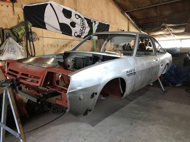

  • dome changed the title to Domes shonky autos-Manta Rollover jig completed
Small update.
Options for a sump are pretty limited. £500+ for a bespoke one to fit a Duratec into a MK2 Escort which may or may not fit the Manta. Or for a fraction of that you can get a sump for a US market Ford Ranger which had this engine mounted the correct way.
Bet you can guess which one I've gone for? It's winging its way from Rockauto as we speak along with an oil pickup to match. I'll fit that to the engine and see where we are fitment wise. If it's a no-go I'll flog it to the escort boys and go back to the drawing board.

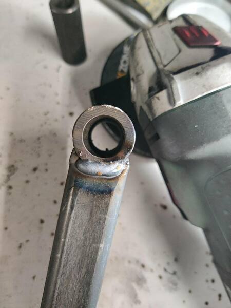

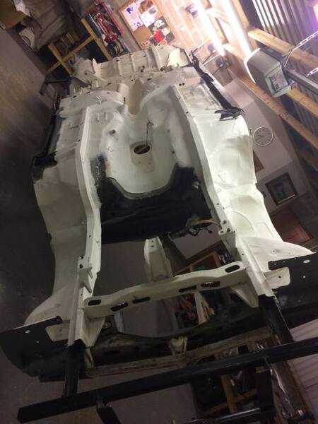

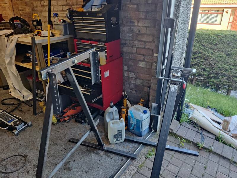

Tonight I cracked on with assembling my rollover jig. Some of the welding isn't pretty, it all survived being hit by a hammer though so I'm calling that a win.
IMG_20210617_195754.thumb.jpg.6ed4e480b408aabe362b811859ff8fae.jpgIMG_20210617_195743.thumb.jpg.5546326dfba3e58ee0c98ca81d0cc640.jpgIMG_20210617_195736.thumb.jpg.0e5b01135ad95cc2097e0a55108406cd.jpgIMG_20210617_195747.thumb.jpg.0c04b06c2ef6f6b59d9a6a36288aa65b.jpg
I've only assembled it loosely just now, I'll strip it back apart, clean up the welds and give it a lick of paint before final assembly. The Manta will only go onto it once I've sussed out where we are engine fitting wise. Then it'll be a case of bolting it up and recreating wheel of fortune with a rusty 80s sports coupe stripping back all the paint and underseal and seeing what's left😬

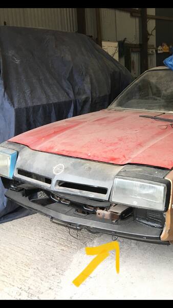

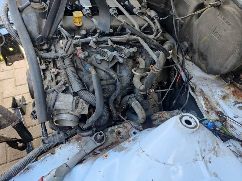

Did a bit more on this today. I did a bit of stripping down the front end with a view to getting ready to make the body mounts for the jig.

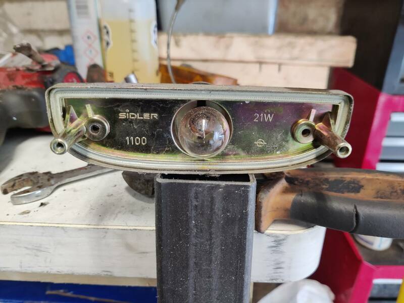

Headlights, bumper, headlight wipers and indicators removed.
I'm guessing these aren't the original indicators-they're mint!

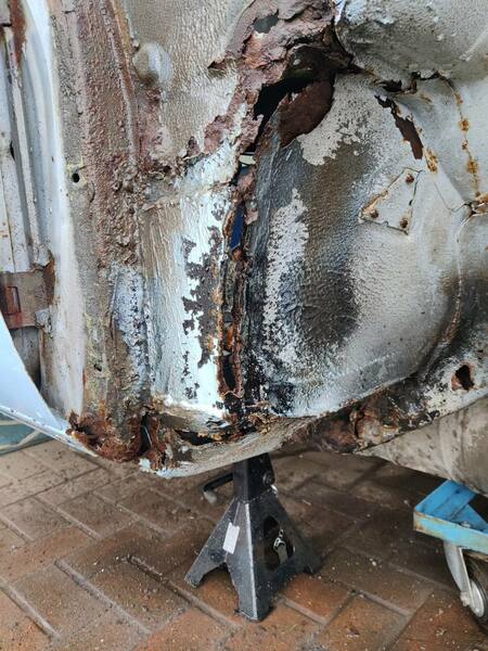

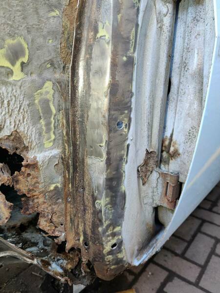

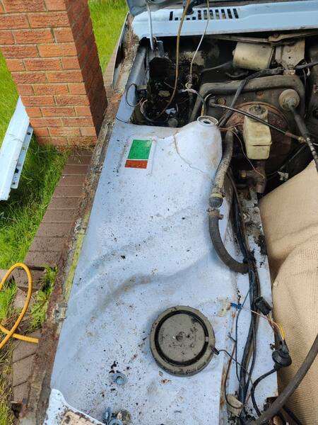

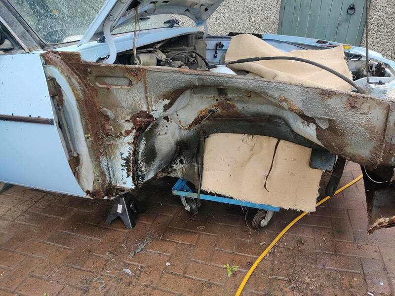

I decided to remove the drivers side front wing with a view to removing the valance-as you can see it's pretty rotten and has been repaired* before
Luckily all the bolts for the wing came off ok-it might look fucked (and it is) but I've had very few sheared bolts. So far.
Wing off. Carpet was covering the Duratec whilst I hosed the inner wing down.

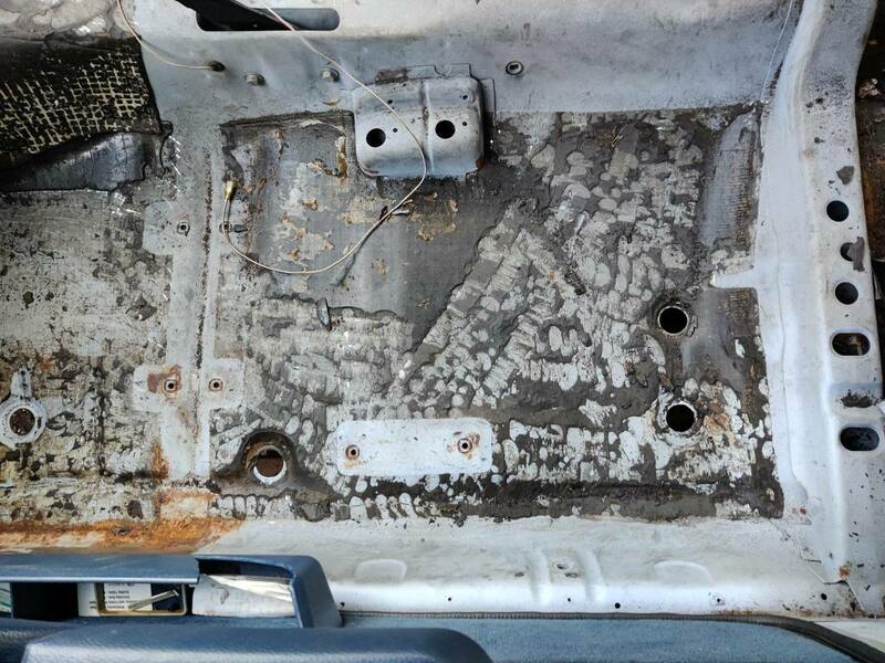

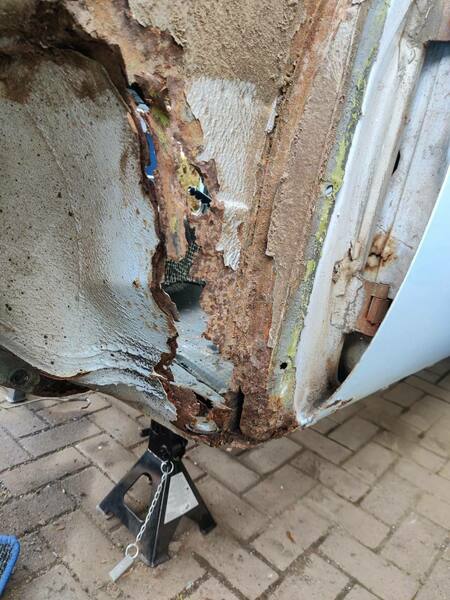

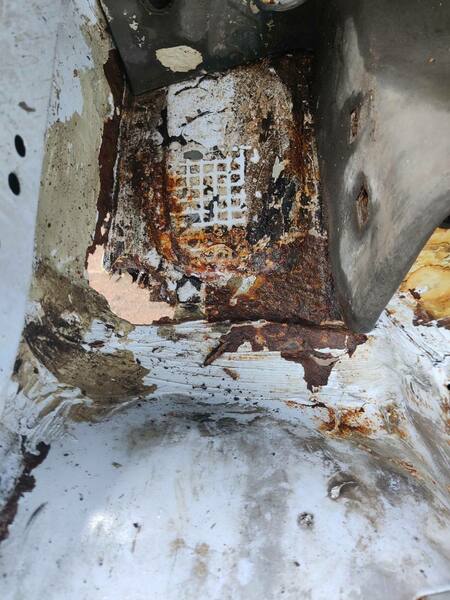

Inner wing isn't bad. The washer bottle sits in front of the scuttle, that area will need repaired

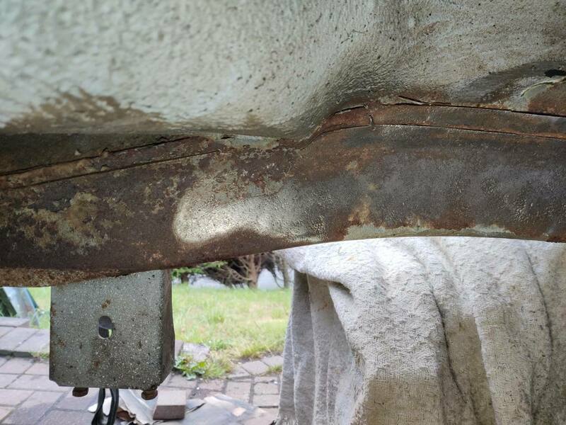

I can now get a better view of the a pillar/bulkhead/floor area. Probably the worst part of rust on the car and the one I'm least confident of trying to fix. Where do I even start? The lower part has been patched before.
I might be able to use the bumper supports for the jig, the valance will need to come off anyway though as it's rotten, the 400 front bumper will hide most of what's under there anyway
@sutty2006 any tips on removing the front valance? I'm not sure where to chop it!
That pillar/bulkhead/floor area looks no worse than the Oxford was.

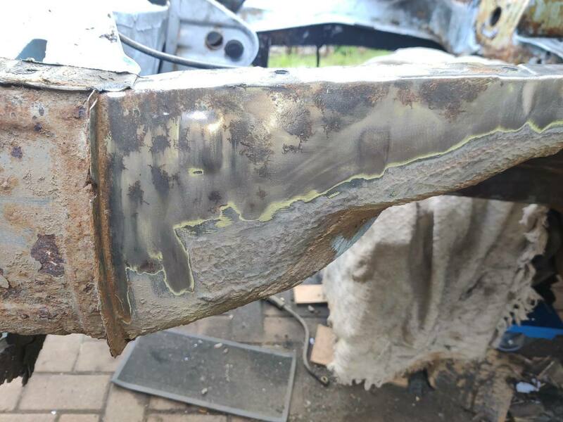

We plated the two sides separately, then used a curved reinforcement strip up where the two parts meet. This was L shaped so it formed the corner.
@Tickman will probably explain it better!

Yep, that's the one. I'll get some better pics

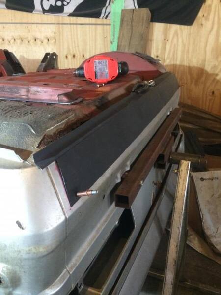

This is how a few have been done over on the Mantaclub website
front attaches straight into the chassis legs and bolts through the bumper bracket holes
rear through the bumper holes with a strengthening bar on the inside.

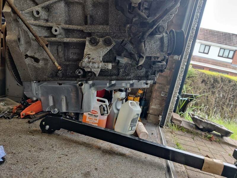

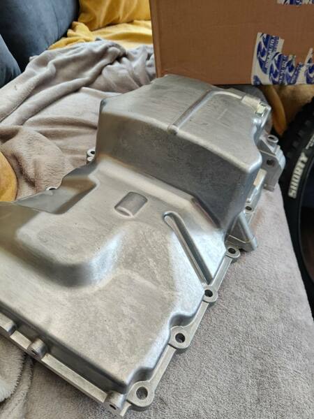

All the way from the US of A, here is my new sump. It should fit the engine, the question is will the engine fit in the car with the sump on?IMG_20210625_152741.thumb.jpg.3bda8136e7b757ca9eae361f6dfdefe2.jpgIMG_20210625_152730.thumb.jpg.1d009f4b8e4e9c858142f4207c11544a.jpg
I suspect the answer is yes, but only after removing the brake servo and heater box. Hopefully will get a chance to find out this weekend. Stay tuned!
Which way round ? If the tall bit is at the front of the engine then I think you might struggle, it’s quite a deep one by the looks of it. If it’s the other way round then it should fit no mither!
Yeah, the big bit goes at the back. This sump is basically the same as the posh ones you can buy for £500 to fit a Duratec into an escort, except it was $50 before tax and shipping.

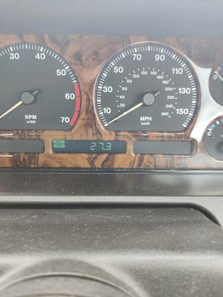

This has been getting used whenever the chance for a decent drive not requiring me to carry bikes/ a small dog crops up. Most recently a trip to Glasgow.
With the Andy bracket fitted(this advances the ignition timing) it's got noticeably more shove above 3k rpm and it actually seems more economical driving it at 80(ish) mph where the engine is turning at around 3k than below that. That'll be my excuse when i get stopped in it anyway.
And I gave it a wash, it's still a 10 footer but that's fine by me :)

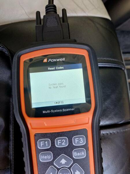

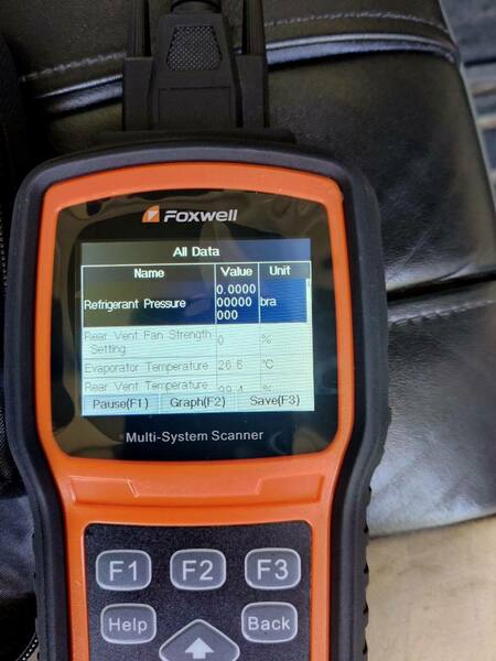

First things first, a foolhardy L322 owner voluntarily plugs in a code reader.
WHAT HAPPENS NEXT WILL SHOCK YOU
After I picked myself up from the floor I prodded a bit further.

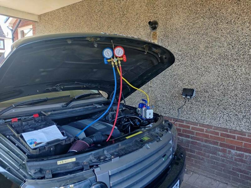

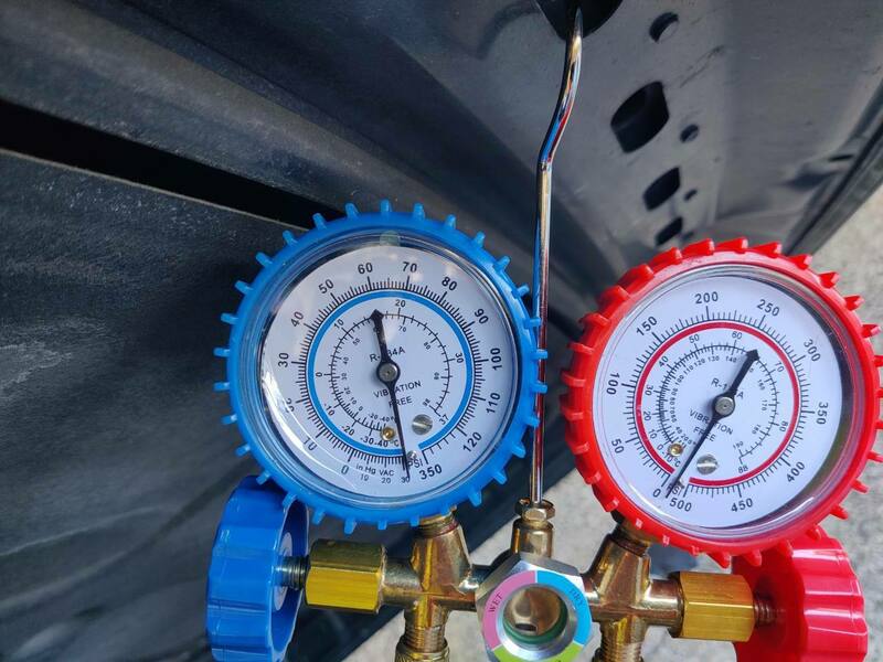

The pressure sensor agreed that there was no pressure so I moved onto connecting things up

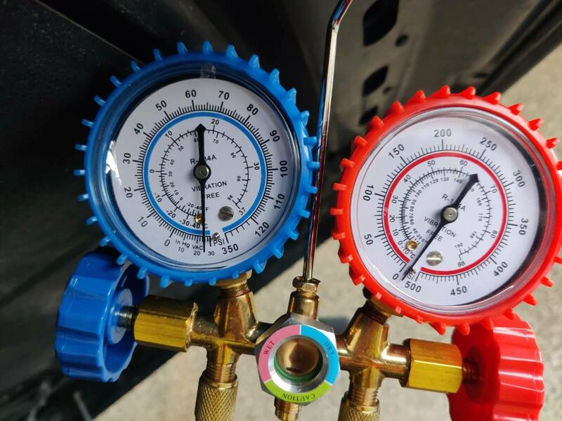

 Gauges connected to the high and low pressure sides of the system and to the vacuum pump.
After the pump had ran for half an hour or so vacuum was achieved. gaugebefore.thumb.jpg.98eeed403d93f4b2e984858d8878ead4.jpg
Leaving it for a couple of hours the blue gauge (low pressure I think) pressure had decreased showing signs of a leak.
I had been supplied with an adaptor to allow me to connect a spare tyre in place of the vacuum pump and pressurize the system with air.  I did this and went around every joint on the system I could see and also as much of the condenser as I could access armed with a spray bottle soapy water in the hope that some bubbles would show my leak. Sadly, nothing.
Although I did spot what looks like a coolant weep from the radiator, so I've got that going for me...
I'm not sure what to do next. Until I find the leak it would be a case of firing the parts cannon at it which I'm not overly keen on. I may pull the condenser out and see if there's any sign of a leak on it but other than that I'll live with no air con for the time being.
My BMW had a slow aircon leak. It would hold a vacuum but after 2 weeks all the gas escaped. They put that UV dye in it and it still didn't show up so the put more in and eventually it could be seen in the bottom corner of the condenser.
It usually is the condenser. Not sure what it's like on the RR but on my BMW it's front and centre to get smacked in the face with every rock that comes up off the road.

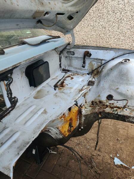

Manta

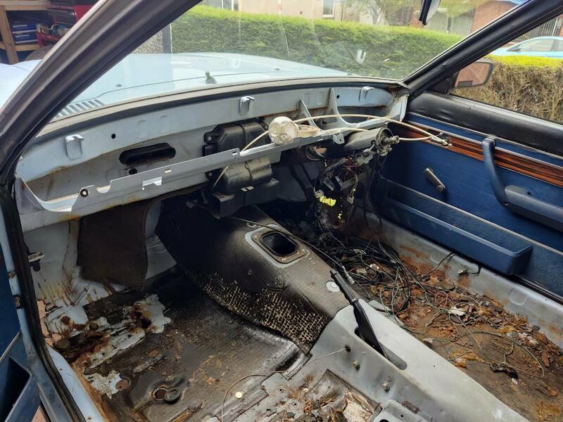

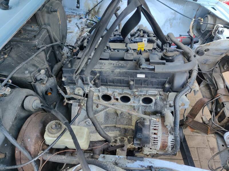

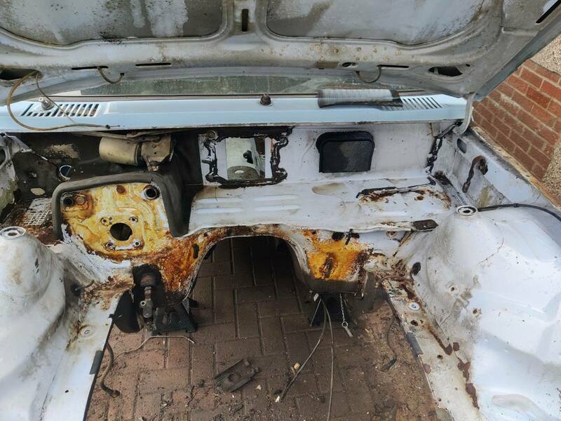

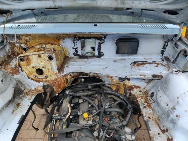

I've been picking away at this, still stripping it down to get it to a bare shell. Partly to find all the rust, partly to make space in the engine bay to fit the Duratec.
Inside the car I carried on getting the loom and dash out of it.
Working in the engine bay I removed everything from the bulkhead-matrix, interior fan and brake master/servo all came off.

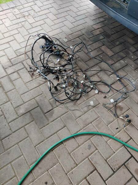

Which meant I could pull the rest of the loom out complete.
Here is the entire loom from the car, it's tiny!
Engine bay as of now-still got the wiper motor to remove.

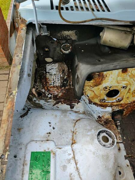

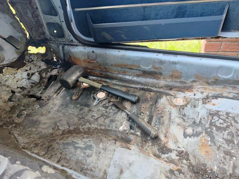

The battery tray was pleasingly solid
the opposite side, where the screenwash bottle was, less so

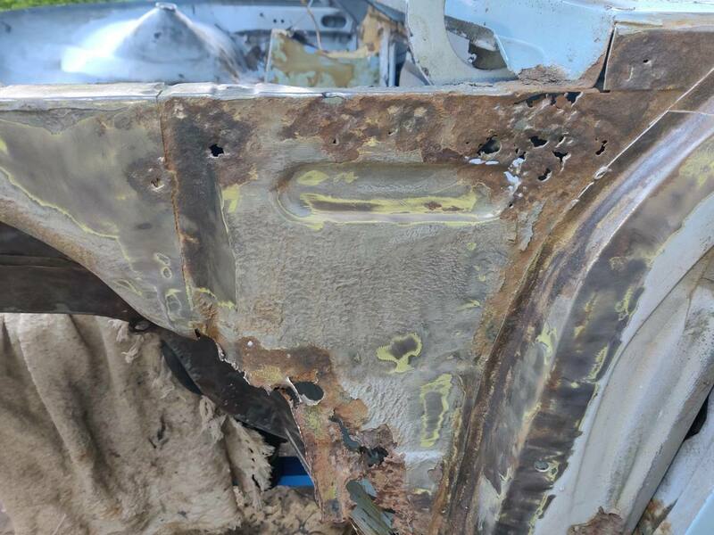

A bit more prodding revealed this
No big surprise, that side looked crusty with more to come no doubt.
I pulled the LH wing off and it was a similar story to the other side.
Yep, not pretty.
To make myself feel a bit better I've ordered all the parts to rebuild the front suspension-a full set of balljoints, polybushes and a new pair of uprated front springs.  I've also got a set of strengthening plates to add to the wishbones to stiffen things up a bit. That bit I can do.
I'm on the hunt for a 4ha axle for it, possibly one from a Mk2 Jag as it seems like it will fit and is easier to find than a Scimitar axle. Plan is to 4 link the rear end and fit a Jag POWR-LOK LSD.

A little bit of progress with the Manta-I'm carrying on stripping it back to find the rust in preparation for repairing it.
On the inside this means stripping back the original sound deadening to find out what lies beneath. This is great fun and tends to involve a hammer and chisel to chip away at it.
IMG_20210731_181934.thumb.jpg.de6401a24c91883455225fac381afef3.jpgIMG_20210731_181928.thumb.jpg.9d588932c11fc43f1e21e785abaa1275.jpgIMG_20210731_181924.thumb.jpg.82fade2a7f5b72d70b0f86b2cbffdade.jpgIMG_20210731_181922.thumb.jpg.e36b61dfa11065e0478796994f42c6c7.jpg
To get a break from this I started stripping back one of the arches to see what I could find. This doesn't look too bad. There's lots of seams and lots of seam sealer. I didn't have to go too far from the rotten parts to find solid (ish) metal. It'll likely end up getting cut out anyway when new panels are made.
IMG_20210731_181857.thumb.jpg.a1709752af4f892e0c2a87350b7cb8b9.jpgIMG_20210731_181855.thumb.jpg.f2eb5b62abbf9b237589ee9e0fd40229.jpgIMG_20210731_181847.thumb.jpg.4c8b8bdfbd8ddfa5971d84d33effc488.jpgIMG_20210731_181841.thumb.jpg.a661451a44abc6a137ac6a543de2bee1.jpgIMG_20210731_181836.thumb.jpg.19242f02e42c03e3287559b11e3f36fd.jpgIMG_20210731_181831.thumb.jpg.edd5652da39ce18b1d1890c281851efc.jpgIMG_20210731_181827.thumb.jpg.a9fd8901dbec9152cc95f2c5a2b34b99.jpgIMG_20210731_181814.thumb.jpg.52ed3f90d6890e7f02d2e37cc660c8b4.jpg
At the front I've removed the lower front panel-it was pretty rotten and the 400 bumper renders it useless anyway
The engine bay is stripped back and ready for repairs.

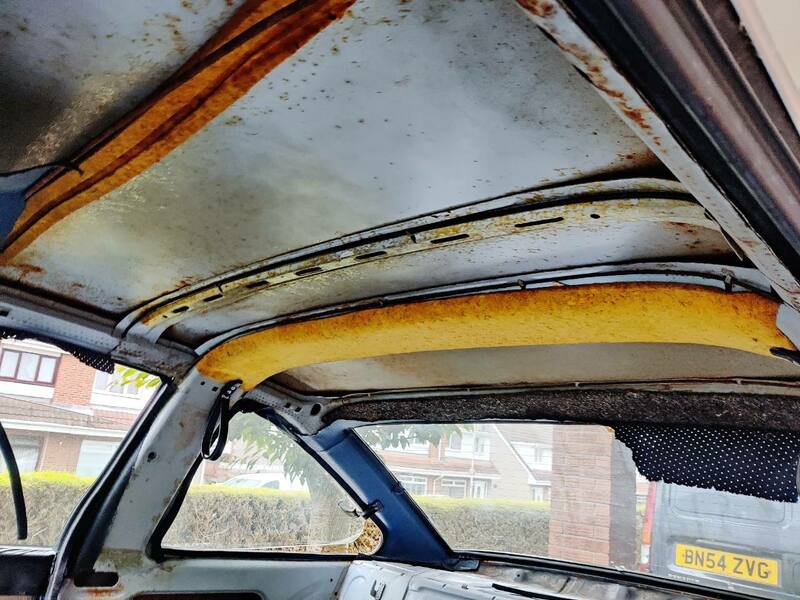

And the headlining has been removed. It was knackered so a bit of brutality had it out.
