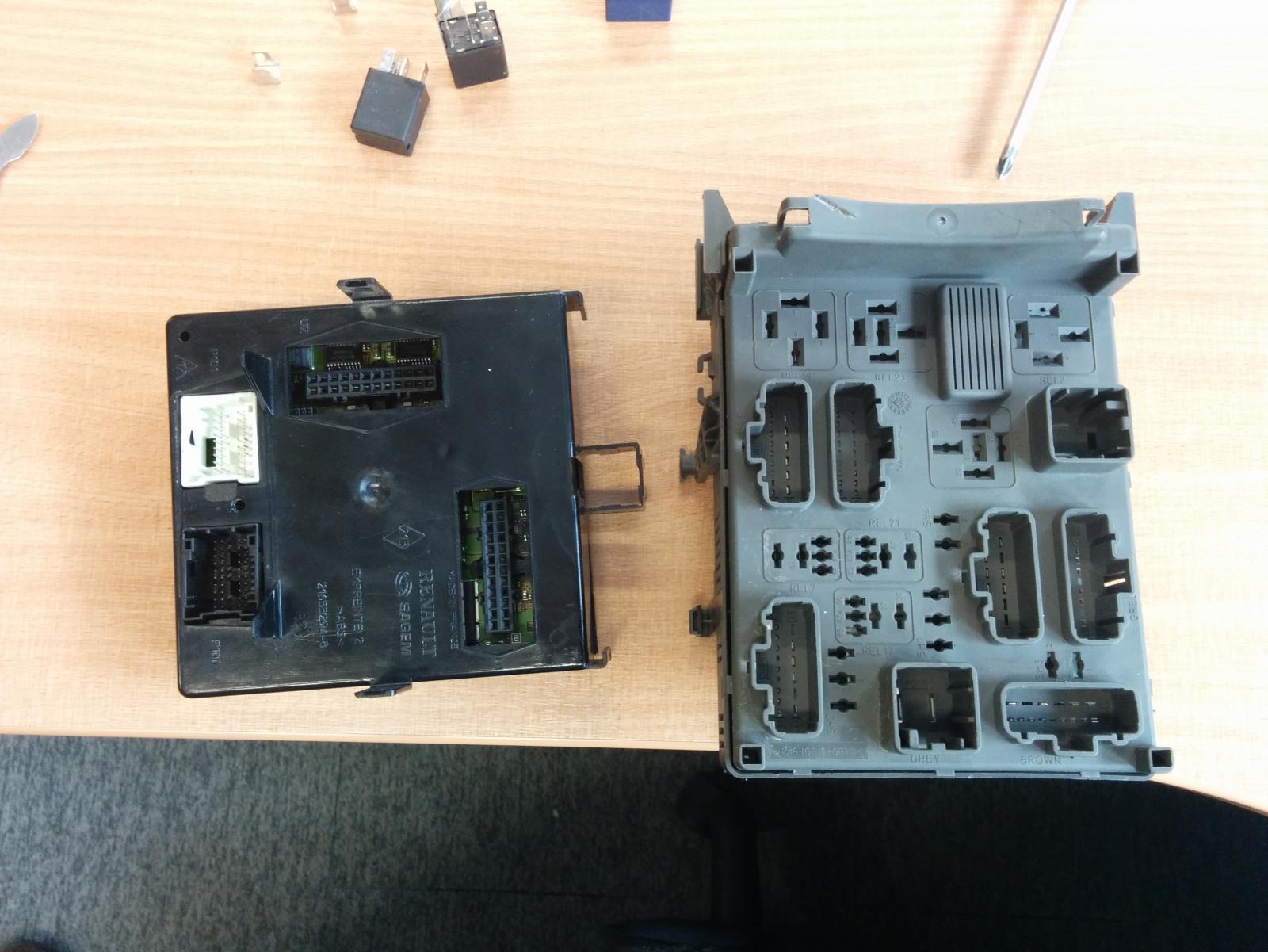

Which half of the UCH is dead?
The fuse section (right) is easily replacable.
The other side isn't as much, because it has all the immo data in it. But it should be, in theory, possible to get a donor unit and copy the data from the old one to the new one. Let me know if you're interested.

There are companies which can virginze a UCH from a scrapyard.
I'd also google to find it if you can't use the engine ecu + keycard + UCH from a scrap vehicle...
I did that with a 2000 laguna 1 with an engine ecu full of salty water... Admittedly, in a Lag2 there might be more components coded directly to the UCH - for example the electronic steering lock. The card reader, however, is not.

That's true and a good call, a ECU set will do the trick - probably the easiest and quickest option if the UCH is dead, dead. I've seen ones much cheaper than that though. Just make sure that the steering column bolt is unlocked before trying to undo it - its also a left-handed thread.
A complete set is: ECU, UCH, keycard and steering lock. If you can get the first 3, then the steering lock box is mega easy to virgin (write FF to the EEPROM) and will code itself to the code when put with a ECU+UCH that match themselves up.
Renault say you can't recode from one car to another, once they have been programmed in once. The immo data is stored in the main controller IC (rather than a separate chip). However I have got some data on how to read out the eeprom data from the UCH. Never done it before, so only in theory it works. If it didn't, the other option is to desolder the main chip from one and solder it to a new working one.
But a ECU set still will be the easiest option to do - providing it works enough to get the steering lock disengaged.
But check to see which half is damaged. IIRC, from your previous pictures, it appeared to be mostly the fusebox part that got wet and suffered the corrosion?

Diagnostics couldn't contact the UCH so I assume it's the circuit board part? Will ask the garage who did the diagnostics when I pay them for that tonight.
Ways to fix sound interesting, pissed off with the money wasted so far & feel like scrapping it is pouring money down the drain. Tell me more....

Most of the circuit board section is powered off the fusebox part. Main feeds come into the fusebox first. When you pulled the UCH apart last time, was the circuit board part (black box) wet at all?
Guest Hooli
The circuit board was dipping when I last removed it.
Been to the garage to pay them tonight, will collect the heap monday.
The circuit board in the UCH has visible damage that I'd missed when I looked at it, so it is that that's dead. I'll look for a cheaper ECU set than the one above, but tbh £120 doesn't seem to bad to fix it in my head.
