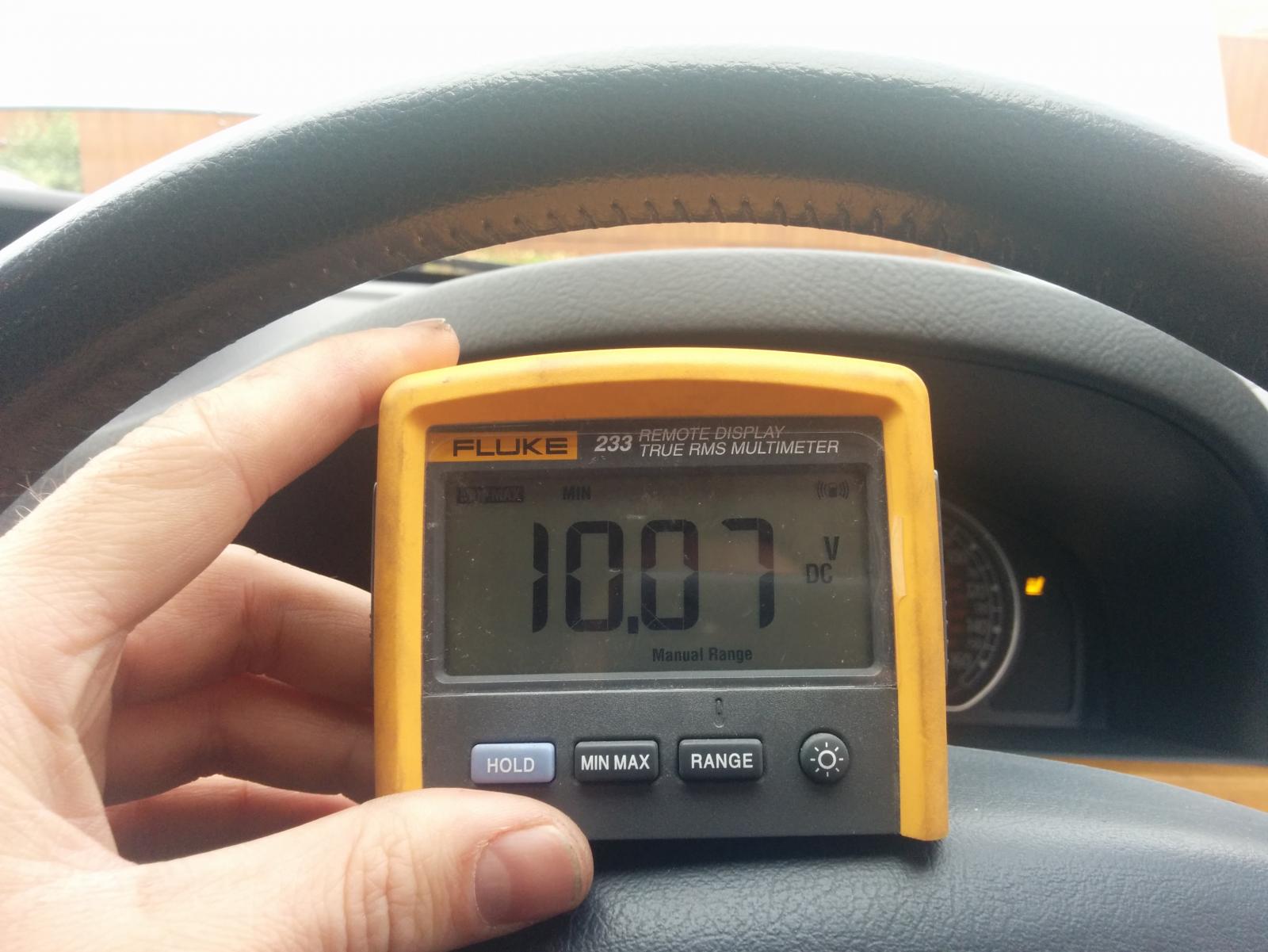

Found 2 Espaces with a different arrangement of clamps, but 2 fuses. I chose the 2.2dci Espace as if the fuses are large enough to start a 2.2 diesel, they should be good enough for a v6 petrol. These had the ratings on (175A and 235A) which mine didn't. Paid £3 for 2 which is a bit on the steep side, but needs must.
Popped them in and started right up. I'm now getting an annoying squeal when idling with high electrical load now!
Min voltage when starting:

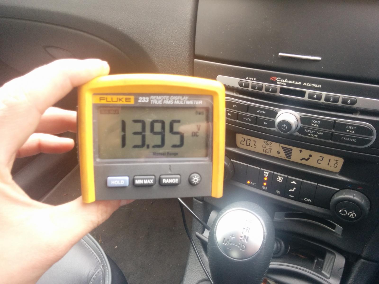

Idling with full fan, rear+front+wing mirror heaters and electric seat warms on:
Much better! I reckon giving the clamps and power feeds a good scrub with sandpaper has helped massively here too.

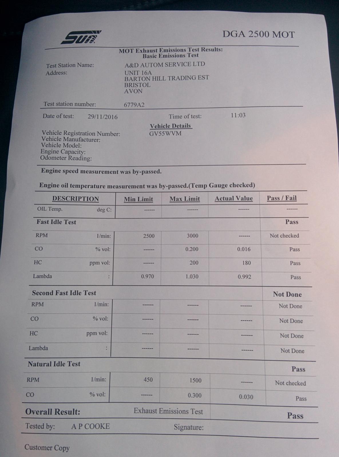

Not that easy going by this on the hydrocarbons!
Admittedly going by the time of the test, it'd been sitting around for a couple of hours. Or that it needs some new plugs.

I do wonder if the last garage put it as a Diesel to get it through. MOT guys on here - doesn't that like flag up a thing on the MOT system? Or is it manually inputted as a pass/fail on emissions (rather than being linked)?
Manual entry of the emission result. You can pick anything you like, the system relies on the tester knowing what he's doing. If it's a pass printout then someone used the wrong machine to test it and the system wouldn't even know.
If you pick the wrong fuel type when starting the test it will flag up "FUEL TYPE CHANGED SINCE LAST TEST" and give you a chance to change your entry.
That would be my guess too - it passed a BET (quick pass) so they didn't have to go as far as measuring oil temp and warming it up properly.
I dropped the car off at 9am, so by the looks of the time on that it had been sitting around for 2hrs. It's been pretty cold today too.
I assume that lambda reading is a lambda sensor in the tail pipe probe (Rather than the cars lambda read out over OBD or similar)?
Lambda as measured at the tailpipe. That's why small exhaust leaks mess up your emission test.

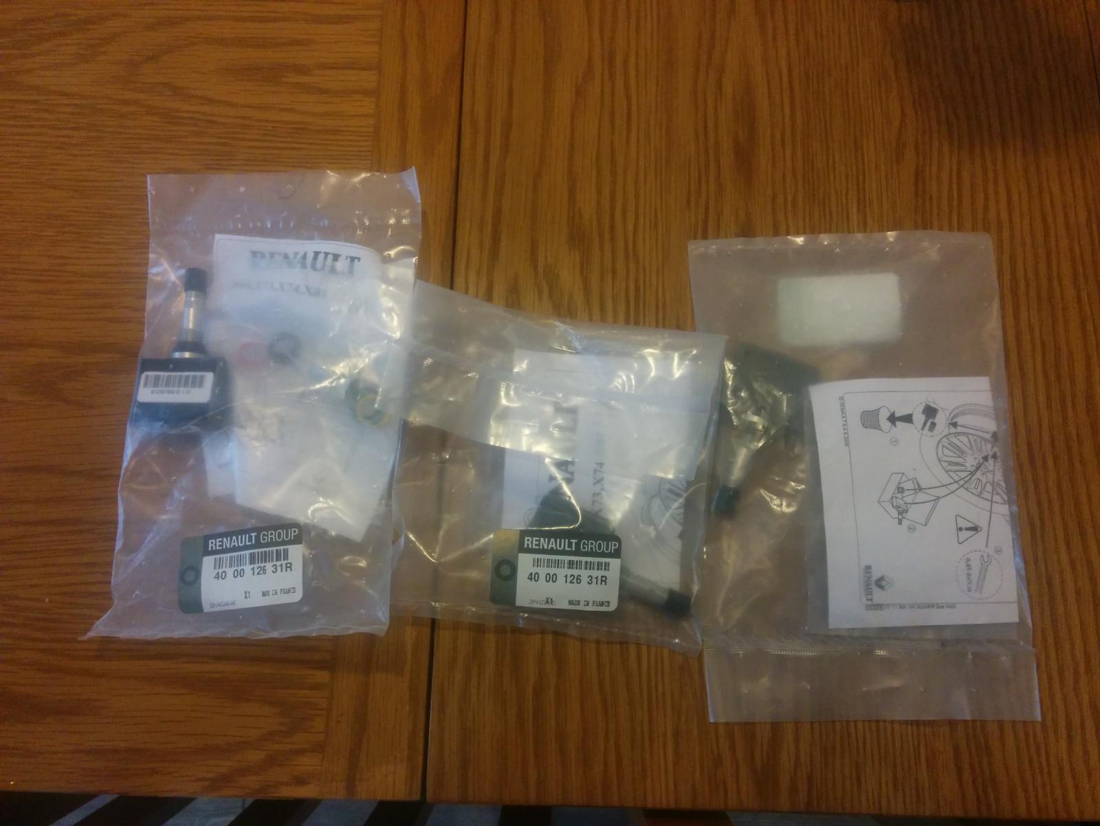

Tyre Pressure Sensors! 3 because it's missing one on the rear and the warning on the screen annoys me.
Please don't tell the wife that I spent more on these than I did for her Xmas present (!)
