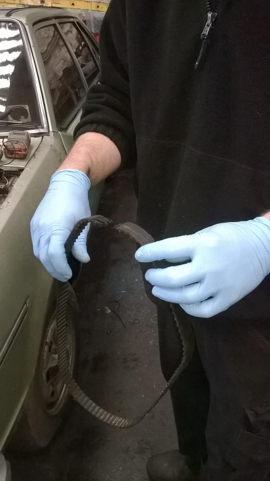

Hi Folks, I have been investigating the lack of the spark in the Renault today. The news is not good..........

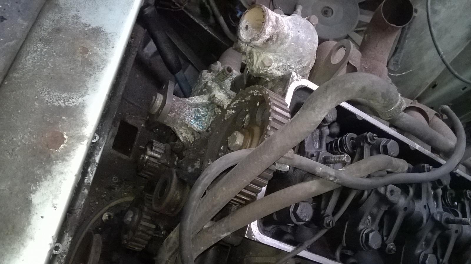

Having tried every trick we know, we decided to strip the engine down.
And all became horrifyingly clear:

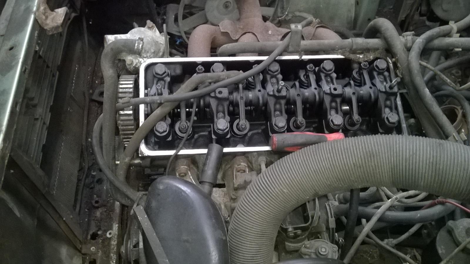

but the Valves might not be damaged, there is no sign of trouble looking at the spacers
And all the pulleys turn freely; none of them are on the piss either
SO WHERE DO WE GO FROM HERE?
Anyone know if this is an interference engine? We could try a new cambelt at £30, just take our chances..........but lets face it, there's bound to be valve damage of some kind. New Engine? Anyone know of one in good nick? I understand these engines went in a number of different cars and vans, but god knows which....................
You've nothing to lose by timing it back up and putting a new belt on. If it's snapped on turning the engine over you might be ok. If it's snapped at bollock flat out you won't.
^^^WHS^^^
I'm no expert, more "bloke in the pub" but I'd certainly wang a belt on and keep 'em crossed.
As above, can't help apart from suggesting try a new belt anyway. Shame that the outcome is the least desirable one. Fingers crossed the engine is non-interference...
I'd put a new belt on but try turning it over by hand when it is on.
For £30 is isn't worth scraping the engine.

I'd consider asking about for the use of a borescope if you are worried about valve damage. Will quickly rule out a bent valve or a twatted piston. I'd also check the distributor end of things, if the timings badly slipped and someone's attempted to turn the engine over.
Thanks, I'll see what the guys say. I guess it could be that the timing has slipped in 26 years of none use, who knows.......
The timing wouldn't necessarily slip but a perished belt might jump a cog or two on turning over, thus giving the trouble you've had. Always start at the cheapest option. As example I've had a problem recent with the fuel pump blowing fuses, start with relay, then the filter, then check the wiring then at last resort swap the pump.
New belt - plugs removed- turn over by hand.
You could try parking the crank so all pistons are halfway down the bores, then turn the cam and look at the valve clearances, that would show up very bent valves, or airline stuffed in the plughole see if you hear them whistle, or even pushing them open with a big screwdriver and letting them snap shut to check they all make that nice chank sound rather than a dull thud.

New belt. You will need one anyway,no matter what. Might be that the pushrods took the "bounce"
I agree with previous posters.  After fitting the new belt and turning the engine by hand, assuming it turns freely, do a compression test for additional peace of mind.  Good luck.  Most of these rusted away decades ago.  Why are Renaults looking so attractive again?  Must be all this Laguna propaganda (although a R20 is nicer).

I'm afraid to say I had the valves bent, when I took the head of...the belt broke on idle.

Try a new belt first, you might be lucky and only have a couple of bent valves to replace. Probably cheaper and simpler to fix that than hoist an unknown engine cross country only to find its shot or won't fit. Plus there is originality to consider...
