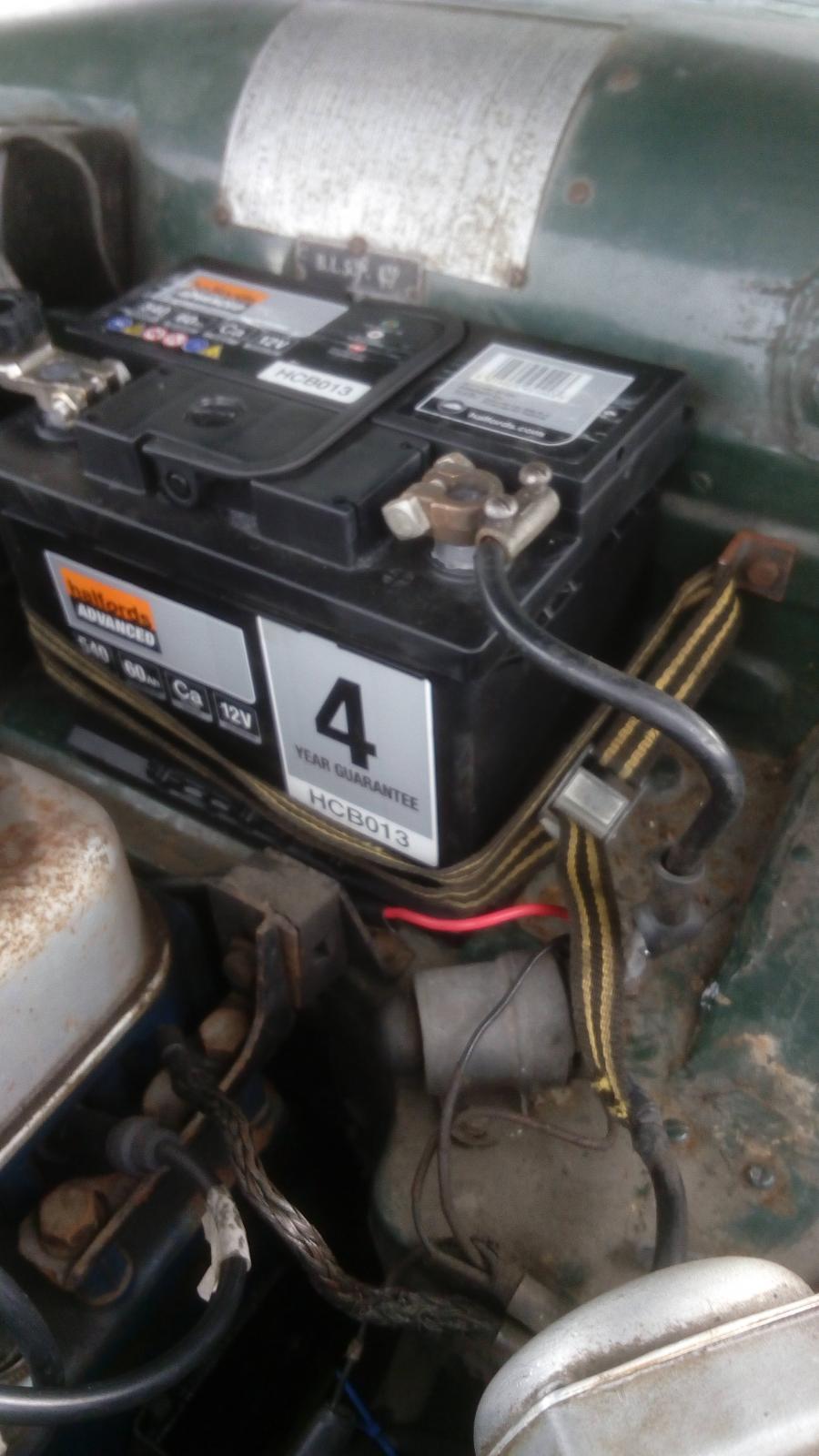

Here am I broke down in the pissing rain again, this time just outside Peterborough. And the culprit, Halfords very expensive battery. 4 years? The cunt has only managed 2 months, bought as a get me home measure when the almost new alternator failed in Surrey in early Feb. That time the RAC were too busy to even answer their phone, this time they say they'll be 45 minutes.

Most new cheap electronic stuff like voltage regulators, ignition components etc etc is crap, but I've honestly never known a battery fail on it's own accord without being provoked severely. They're just lead plates in a bucket of acid, there's nowt to go wrong!
You'll probably get halfords to swap it but definitely check the rest of the charging system out.
RAC man jump started the Sunbeam and voltmeter showed no charge despite generator failure light going out, so the replacement recon alternator has bitten the dust.

Can't agree with you on the Halfords batteries. I've had 4 of them, all performed faultless, one of them even lasting 7 years +. Is the battery correctly specified to the car?
I'm perplexed as to why the battery started the car when I left home yet it failed completely 12 miles later. However the RAC man was in accord with Mr Cobblers on this so I will probably have to put my hand up to a misdiagnosis. A spare regulator and one of those colour changing LEDs to give a warning of battery condition look like a good idea. Just thought, even the indicators were working fine until the engine started misfiring- the old type of non transistorised ones would have started getting sluggish and been a warning. Anyway, I collected someone from Peterborough and got home again without further drama.

The Sunbeams wiring was my own effort and he did look at it. Very simple and after pulling out the alternator plug type connector his meter showed all was well.
Its well over specified for the car, the size commonly fitted to Di transits, early Discos. The Sunbeams compression ratio is only about 7:1. However when charged up I'll put it onto the landrover before I go bleating to Halfords.
I reckon some Halfords batteries, especially the less common sized ones, have been sitting on the shelf for quite a while.
I've never been in a Halfords store and seen them charging any of their stock back up. Self-discharge on lead-acid is high and not keeping starter batteries fully charged is a sure way of degrading their life.
I reckon some of them are discharged a fair bit, thrown in a car, have a huge load from starting the car while being discharged and then the current shoved back into them at a fair old rate by the alternator. This won't lend to a long life - especially like this early in their life!
Probably cheaper to have people claim on the warranty (they'll get money back for refurbishing/recycling them too), than the cost of insurance/risk of liability of their staff charging them regularly.

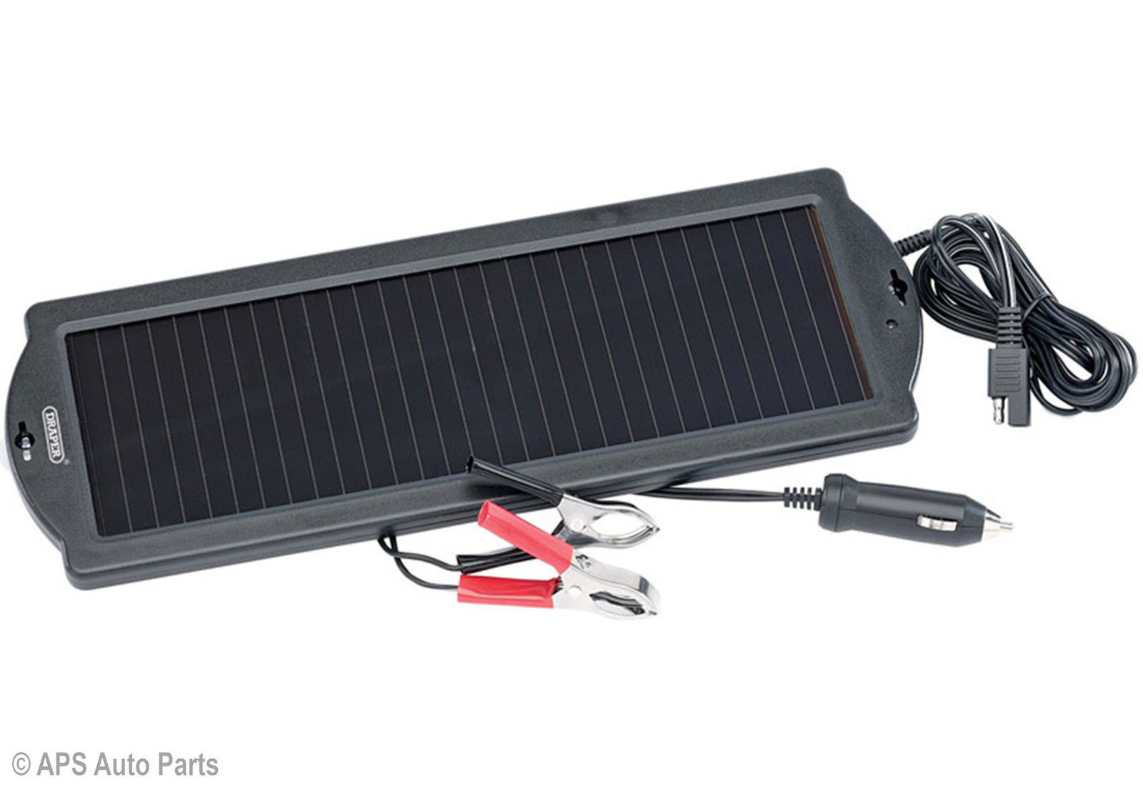

Are you sure it has an alternator and not a dynamo, most cars of that era were dynamos ?  In which case just remove the two wires and join the two terminals on the dynamo together and put a voltmeter on them, run the engine and the voltage should track the engine speed if the dynamo is good. Usually the problem is the external Lucas electro mechanical regulator (like an RB106). For years I have used a Morris Minor 12v dynamo with the terminals joined run directly from a Suffolk Punch engine for 24v DC MMA 1.6/2mm stick welding and it easily stands the abuse. If you want to keep some old motor ready for action then purchase one of these modern shit type technical crappy solar energy total eclipse whingeomatics of the which sit top of the dash keeping the battery happy.
