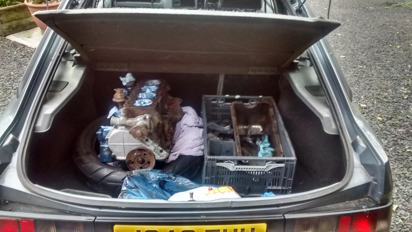

Sierra boots are massive. I transported a full size fridge in my Mk1 when I moved into the nurses home in 1986.
They sure are I recon four body's easily 😀
