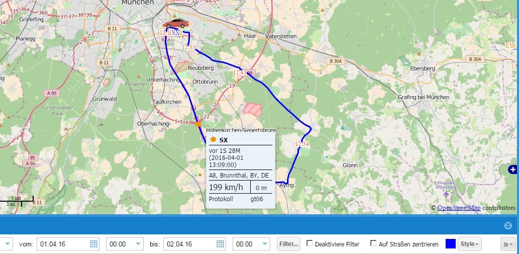

so i bought a Tk102 tracker from ebay for 19,50€ including pp and a 10€ prepaid SIM that includes 10MB per month for year.
Threw it all into the Tagora SX and installed "traccar" software on my server. Took me a day.
Results are more than good, works as advertised, installation was painless, great stuff!
For that cheap, all my "old" cars will get a tracker now.
Out on a test drive:

Can you monitor the data use? I guess it's small but id be interested in exactly how small
Wot no detour via Andechs?
Passed through Aying, they have the better beer... a bit to cold today for the Biergarten today though .

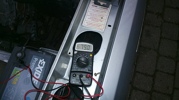

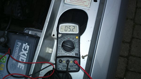

Here's a real world example of current consumed, tracker had been on for a couple of days so internal battery should be charged, vehicle battery showing a healthy 13.1 volts, little meter says 0.1 of an ampere.
No big deal really, about what one tiny dash lamp would use, 'should' be ok left for a couple of weeks.
Mine uses just 5.2 mA,
goes up to 80mA for 30 seconds when it sends a position.

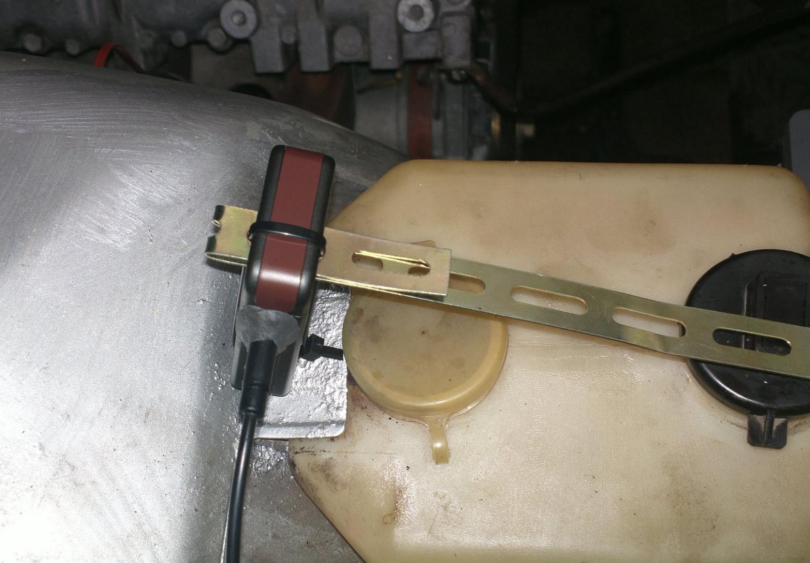

it doesn't really have anything to fix it permamently and the mini USB connector is not made to hold the power cable firm. Fixed the USB with some sticky stuff and used leftovers from the last radio install to fix it to the car (secret location remains untold...)

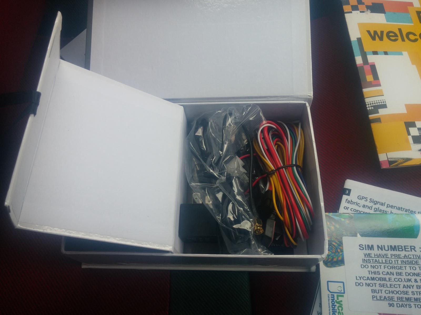

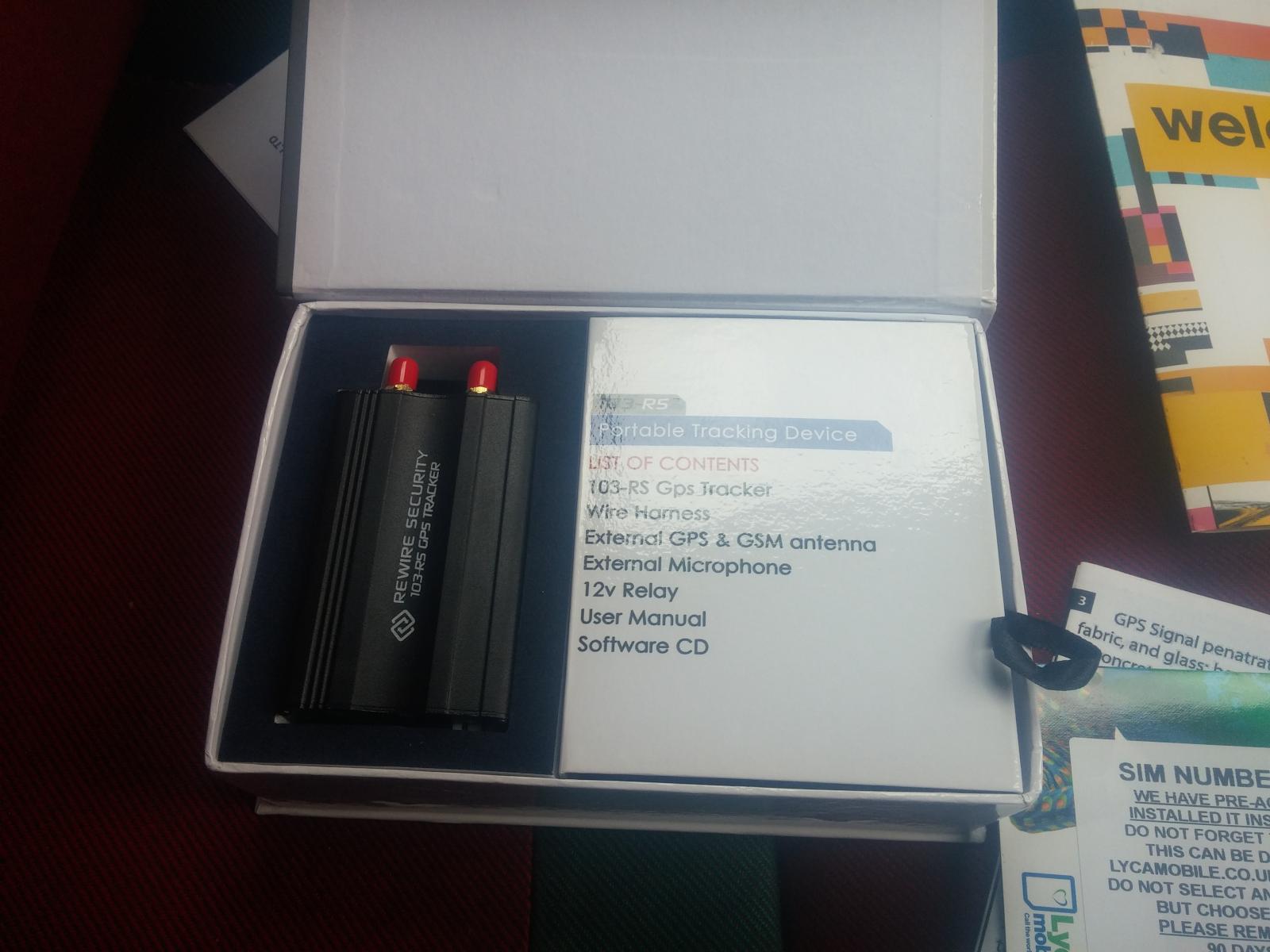

So, the tracker turned up last week and I got around to bunging it in a car today.
Here is a brief review.

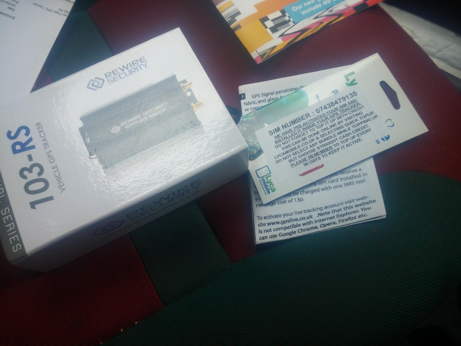

The Rewire Security types are clearly going for a "premium" look here to justify the price being about double other similar units.
It arrived bundled with a Lycamobile sim card. I think they may be on a sweetener from Lyca for bunding these as at 8p/MB they are not the cheapest for data. I've gone with Giffgaff at 5p/MB.

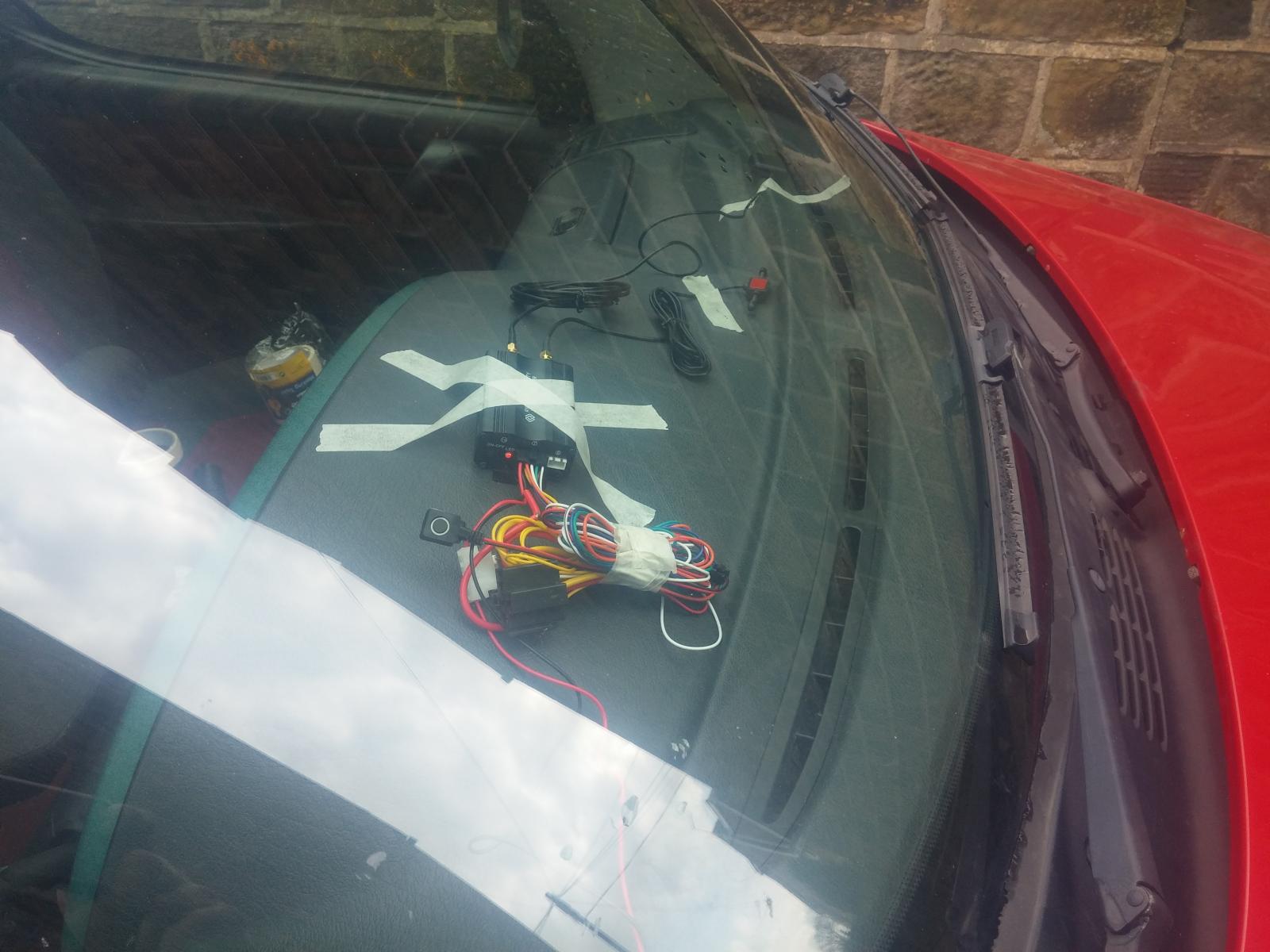

I've done a "full stealth" temporary install while I check it works OK before the final installation in my other vehicle. All I've got connected is a permanent 12V power supply.
See if you can spot it.
Very impressed with tracking so far and was a doddle to set up using the Rewire Security app.

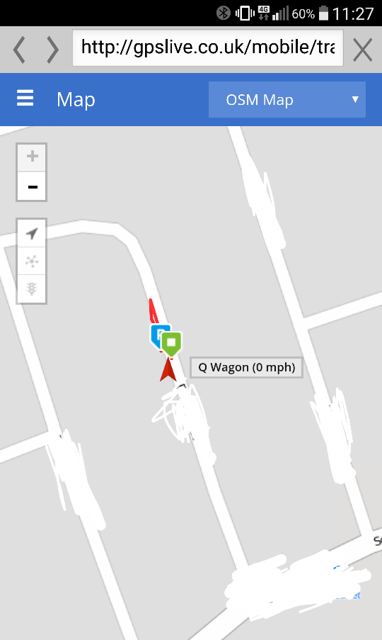

Quick update from me, tracker has been in just over a week, last Friday I moved it to inside the dash.
Tracking still seems fine, although the attached screenshot is for a day when the car didn't actually move.
To be fair the distance pictured is about 25m so within expected accuracy.
My giffgaff balance is down to £9.41 which includes a couple more text messages setting up alerts so I estimate about 20p a week in data.

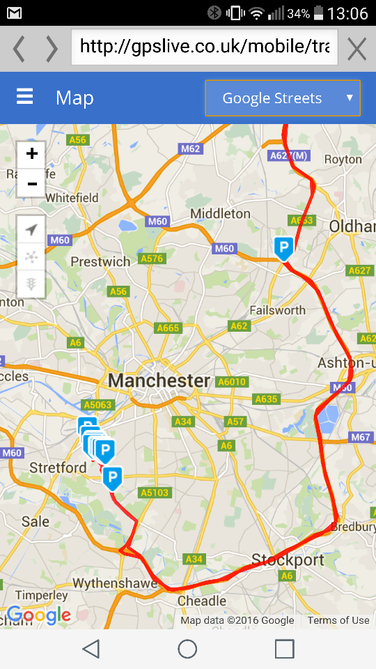

What sort of reports can you get of where it went on what days? Or is it just built up over the day and thrown away?
It all gets saved on the server so you can look at any dates or times you want.
For example, this is some of last Sunday when we drove to Manchester for my wife to do the marathon.
All the Ps are stops of over one minute. On the proper computer you get more details of each section between stops including average and max speeds.

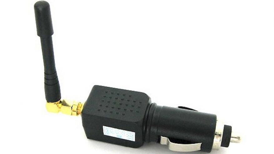

It is possible to buy GPS signal blockers for a few hundred.
You can get these for £15. They work, I had one in my company van. It stayed logged at work overnight while I drove it home for four years.
Yes I've seen those, but firstly, the crim would have to know there was a tracker fitted, and that is was a gps and not a vhf or whatever the others work on.
Secondly, I think you can set them to notify if gps signal is lost so you would have an idea that something was up.
Ultimately no measure is going to stop someone very determined from taking your car away, but anything that can help you find it or deter them is well worth approx 30 quid.
Remotely controlled 18 inch spike hidden under the driver's seat..........................
Thing is, by the time you've caught up with where the car is, you wouldn't want it back after it's been used for a couple of burglaries and had some crack heads sat in the back getting a fix.
Yes. Also as soon as you plug it in your sat nav signal drops. Makes one quite nervous if plod pulls up alongside you at the lights.
