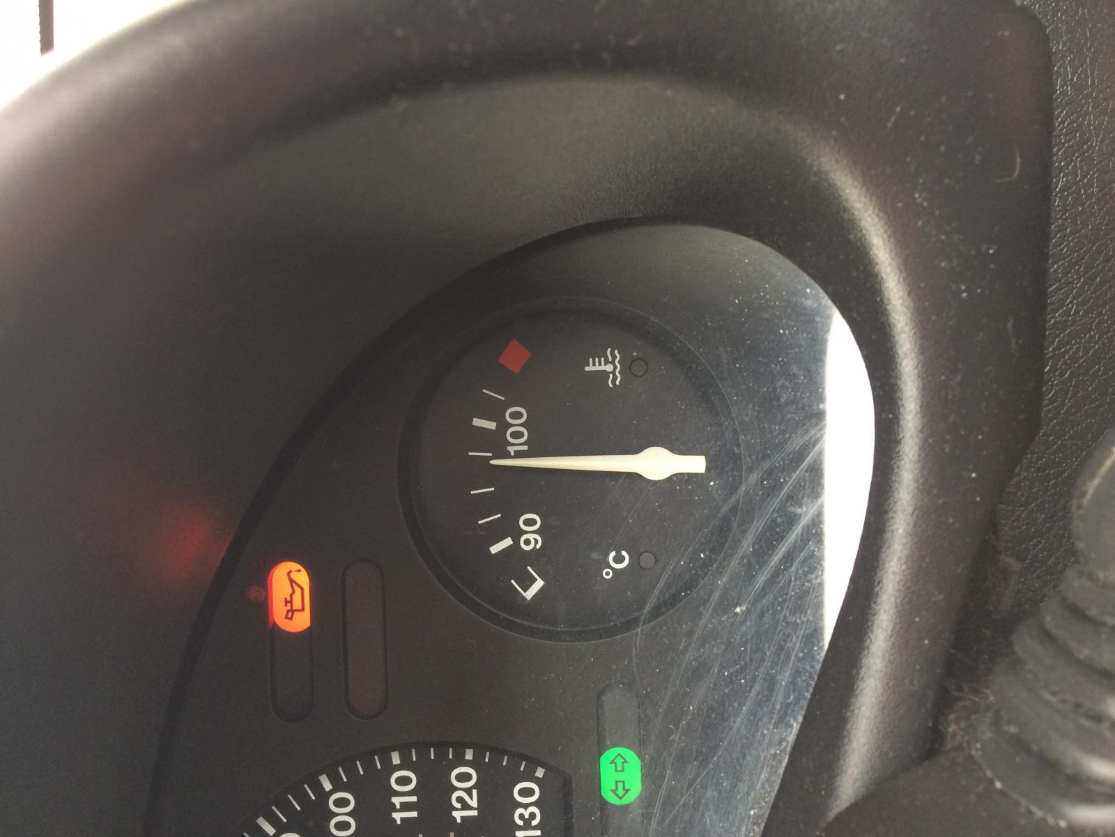

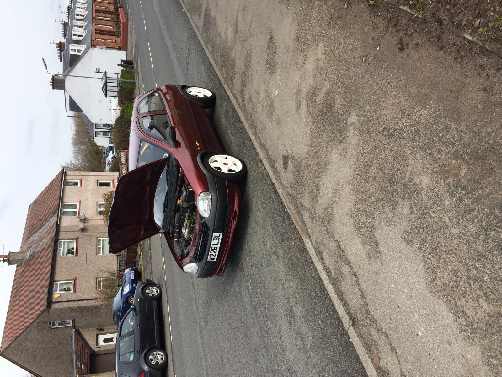

Split_Pin Posted April 2, 2016 Author Posted April 2, 2016 Well fuck. Replaced the coil pack and had a spare new spark plug, fitted that and it was running grand. Took it for a short drive and within 5 mins the temp needle was making a run for the red, went up alarmingly fast. Coasted to a halt and cut the engine before it got any higher than in the picture but looks like it's HGF. Apart from some Mayo condensation on the oil cap, which has been there for years, there are no other signs of HGF. The water level has sunk a bit but I think that's because I haven't driven it since refilling the cooling system. Oil on dipstick is fine, no smoke, just the overheating ðŸ˜ðŸ”« Amazing how NO passers by, some known to me as I am on a road not far from home, have stopped to say "you ok m8". Cavcraft 1
Cavcraft Posted April 2, 2016 Posted April 2, 2016 Did you warm it up before you took it out? 5 minutes seems alarmingly quick for it to overheat, unless the 'stat is shagged or it popped a hose or something. Could it be an airlock after you refilled the coolant system? oldcars 1
