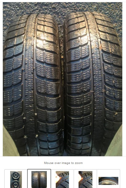

I told you it wants tyres, right?
It wants tyres.
Two different sizes fitted, both too wide. (All cracked and/or bald. And need weekly pumping.)
185's would suit, I reckon. What's right for these wheels?
I've a set of 45 alloys in my garage with ace tyres for the successful* person ....
Ideal, they'd need Shitelying down the country though!
Interest in these alloys has been expressed further up the thread if they become surplus to requirements.
Oh, I forgot, Will has these 14's available for £30:
They're on Rover rims, ready to go.
