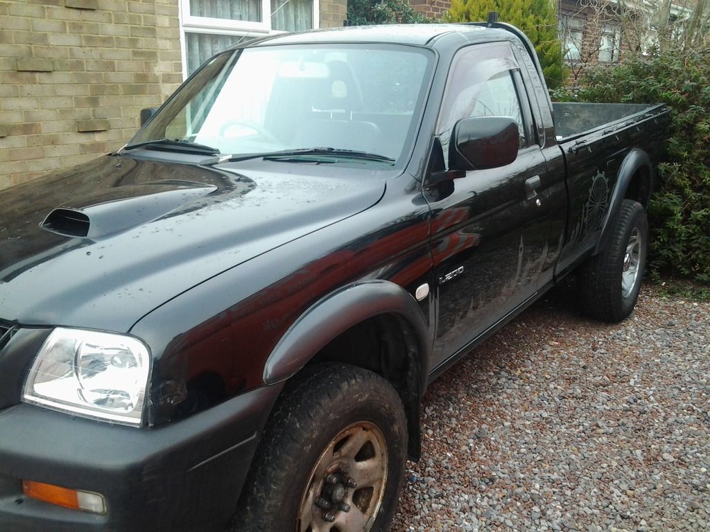

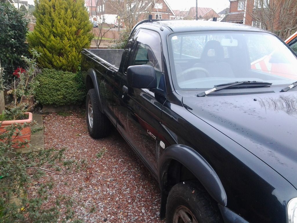

Joey spud Posted March 10, 2016 Posted March 10, 2016 I wanted (but did not need) another Pickup as the little Subaru is getting scratched to buggery by getting used as a pick up again.Never again will i pay big money to paint a vehicle as once it was done i became all precious about using it which really defeats the whole point of having a little pickup truck. So i decided another Japanese truck was needed,one that could be abused without getting stressy about it collecting scratches and the odd dent.When at work i get to see what's good and what's a bit shite so avoided Navara's and Rangers and couldn't afford a Hilux so settled on a Mitsi L200.Although old L200's are prone to crank pulleys and head gaskets (and diesel pumps) they are a simple 8 valve cam belted engine,bits are cheap and every Mitsubishi i have ever owned has been a faithful servant. I didn't want a crew cab with a load area no bigger than a wheel barrow nor did i want any tacky chrome additions or two tone paint jobs (in other words the Essex look).I looked at a few and checked the online mot history (a great idea and what the internet was made for) and found these things rust for fun but can do big mileages with little complaint. So cutting to the chase in the end i went and bought a Roofers well used and abused daily work vehicle and collected it from near Gatwick last night. Pez shot.It has a really severe wheel wobble at anything over 40mph which is matched by a equally nasty brake judder so the 50 mile M23 / M25 run was interesting but other than that everything is good and the engine is quite torquey for such an old,simple design. And in daylight. I was off today so instead of first looking for the cause of the steering / brake wobble i decided peeling the lettering off was far more important but left the London skyline ones on for now reasoning to myself that they will peel off a lot easier when the weather warms up. So there it is not really Autoshite material but i like it. scdan4, dave21478, DVee8 and 6 others 9
dollywobbler Posted March 10, 2016 Posted March 10, 2016 Poshest tidemark ever. I like these, though they do seem to like rotting, which is why they aren't more common around here. They were once! garethj and Joey spud 2

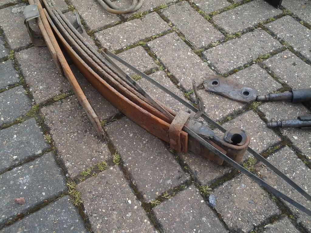

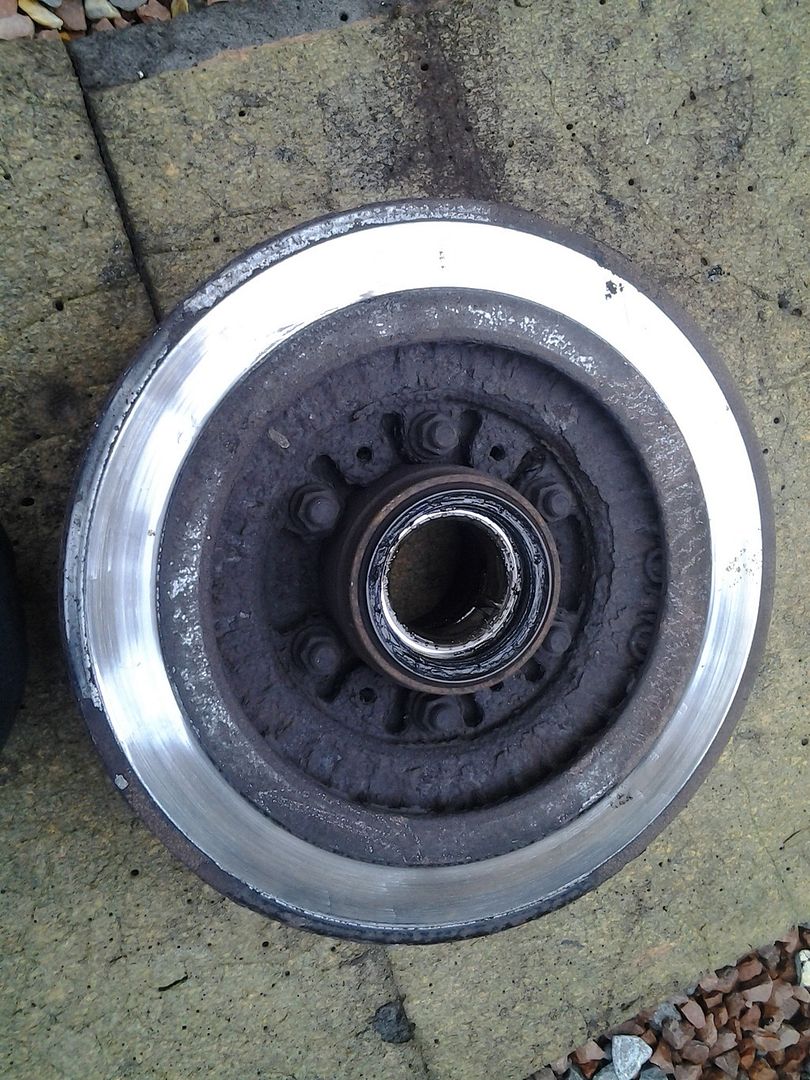

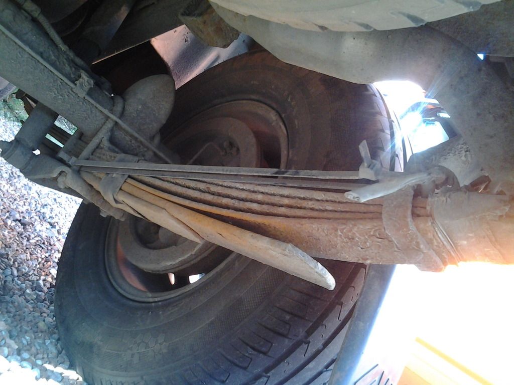

Joey spud Posted March 10, 2016 Author Posted March 10, 2016 Here's a better shot of its posh tide mark. This afternoon i had a look at the front end to try and suss why despite its nearly new mot it can't get down the road without shaking it self silly.It came with its standard wheels in the back so i tried them first but no luck it still shook and all the ancient technology (steering box drag links and idler) were fine but the front discs are hateful and the brake caliper slides were seized solid on the drivers side. I managed to pick up a set of pads and discs locally for a bargain £48 and popped them on and now it drives as well as a steering boxed and torsion bar front end and cart spring rear ended pick up ever could.It is actually quite civilised. Before i lost the light for the day i had a look at the rear suspension and found a broken leaf on a rear spring held in place with a length of 2.5mm twin and earth cable and large zip ties. Cavcraft, garethj, andrew e and 9 others 12

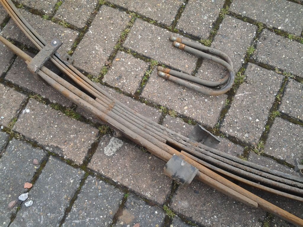

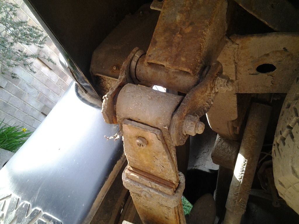

Joey spud Posted March 14, 2016 Author Posted March 14, 2016 Had a bit of time today to play with the L200 so had another look at the rear springs. The spring hanger bushes are totally shot. (but cant go any where). And this is the rear spring with half a leaf missing one end and other leaves secured with gaffa tape,twin/earth cable and zip ties. Along with the seized brake caliper and totally buggered discs which must have shown up on a brake tester it looks like the little truck has had a bit of a lenient mot. Lacquer Peel 1
Lukas Posted March 14, 2016 Posted March 14, 2016 Check the chassis carefully for rust. It seems there was never a rust-proofing done, so they usually are rotted through from the inside out at the typical parts after 10 years. Joey spud 1

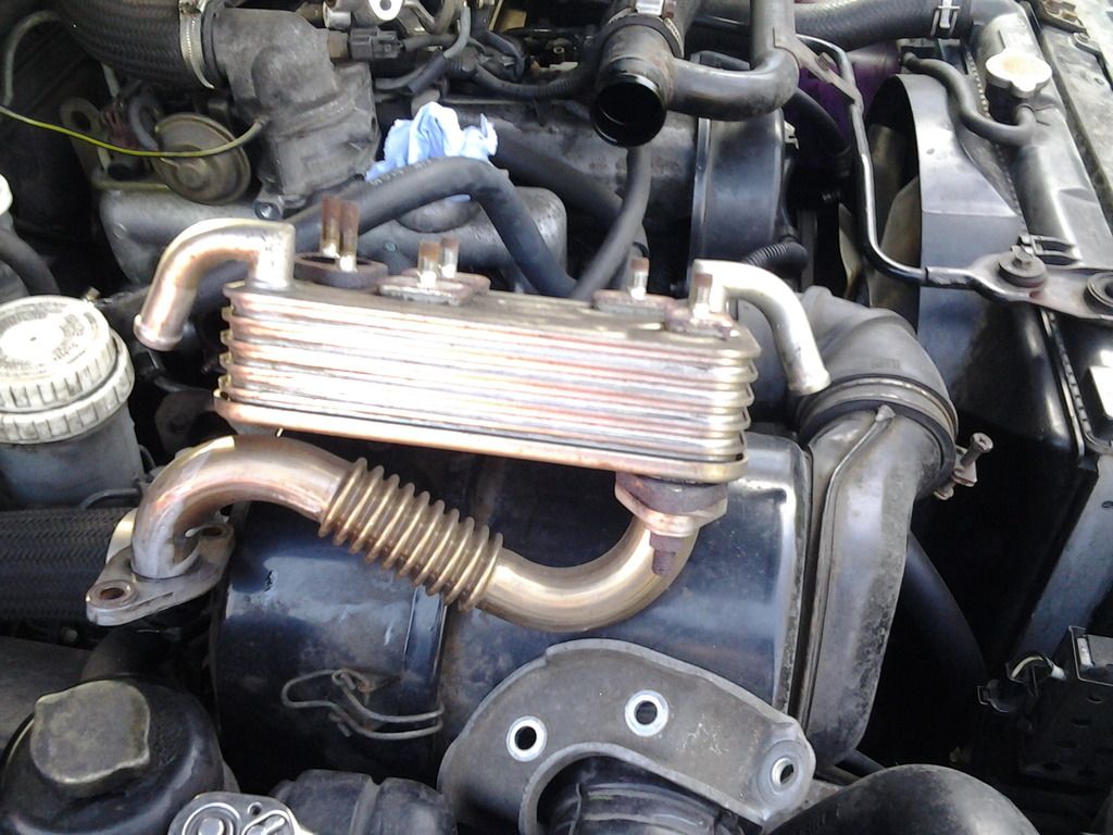

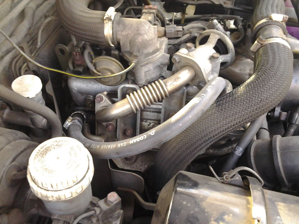

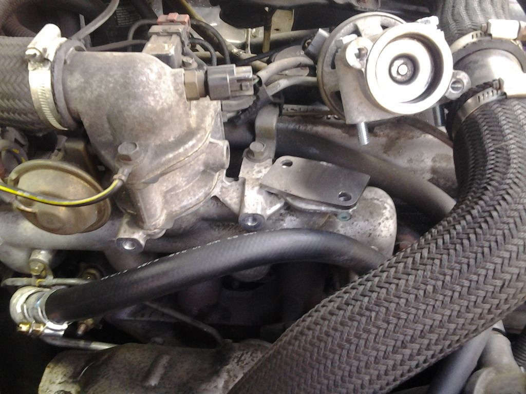

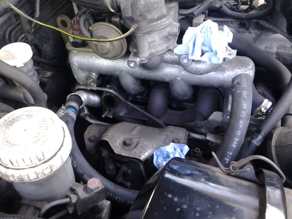

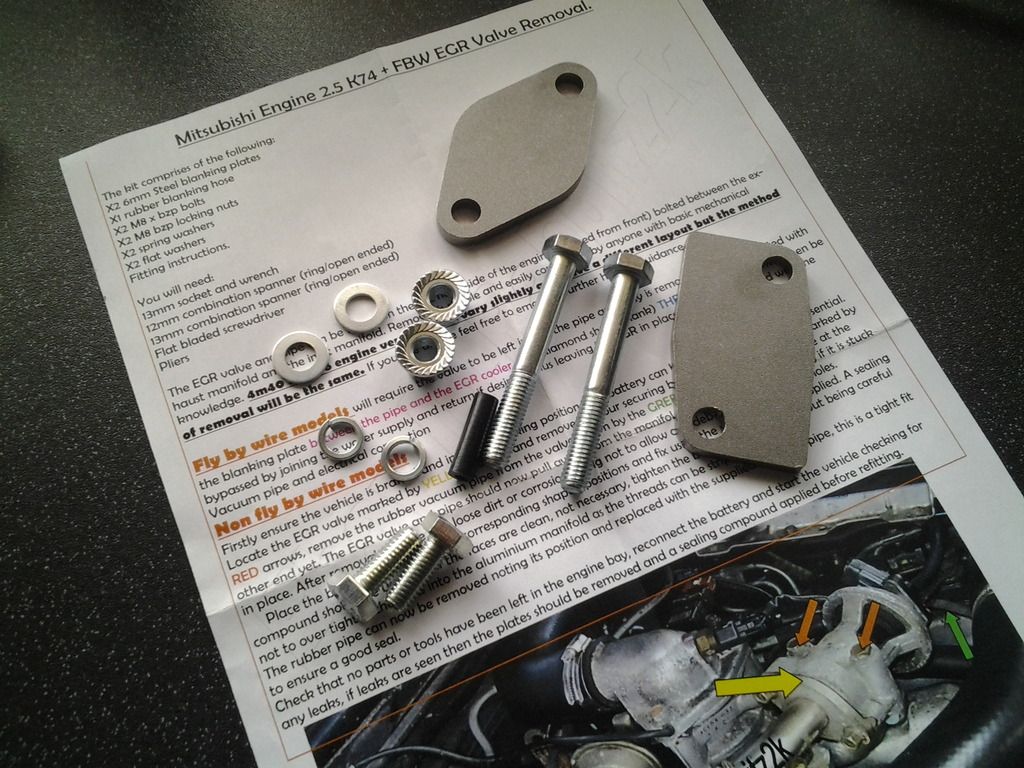

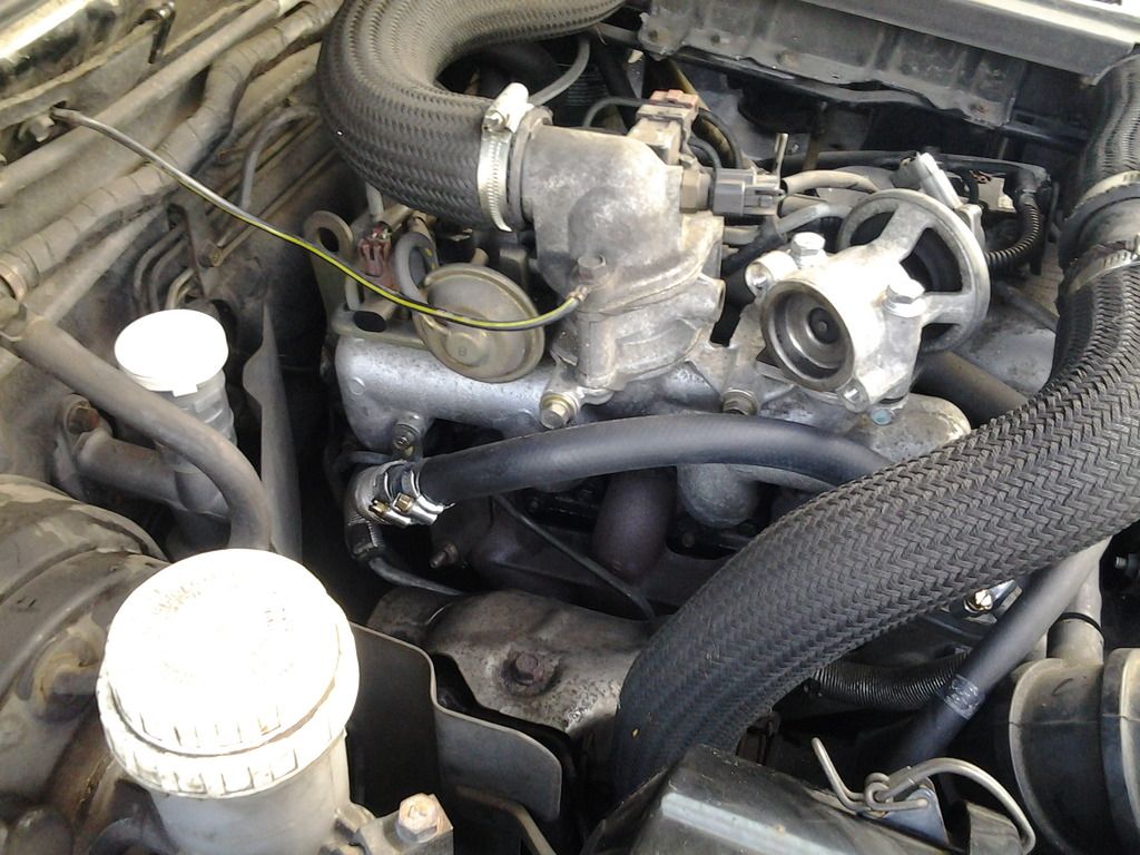

Joey spud Posted March 14, 2016 Author Posted March 14, 2016 So EGR removal was the name of the game earlier. I got a cheap blanking kit off ebay,for the tenner that it cost it wasn't worth the hassle making up an inferior copy. On these engines the exhaust gases are also cooled by coolant before it gets metered into the inlet manifold but the cooler must have been leaking at some point as its pipes had been disconnected and it was now by passed. I could have just blanked the pipe to the valve itself but decided to remove and bin the cooler too. Then it just needed one of the plates fitting to the exhaust manifold and the other one slipped under the EGR valve. I wasn't sure if unplugging and removing the EGR valve altogether would put the mil lamp on so i left it fitted.I wouldn't be suprised that in the future part of the mot test will include looking for deleted EGR valves as well as DPF filters. Much better and it seems happier on the road too. Lacquer Peel 1

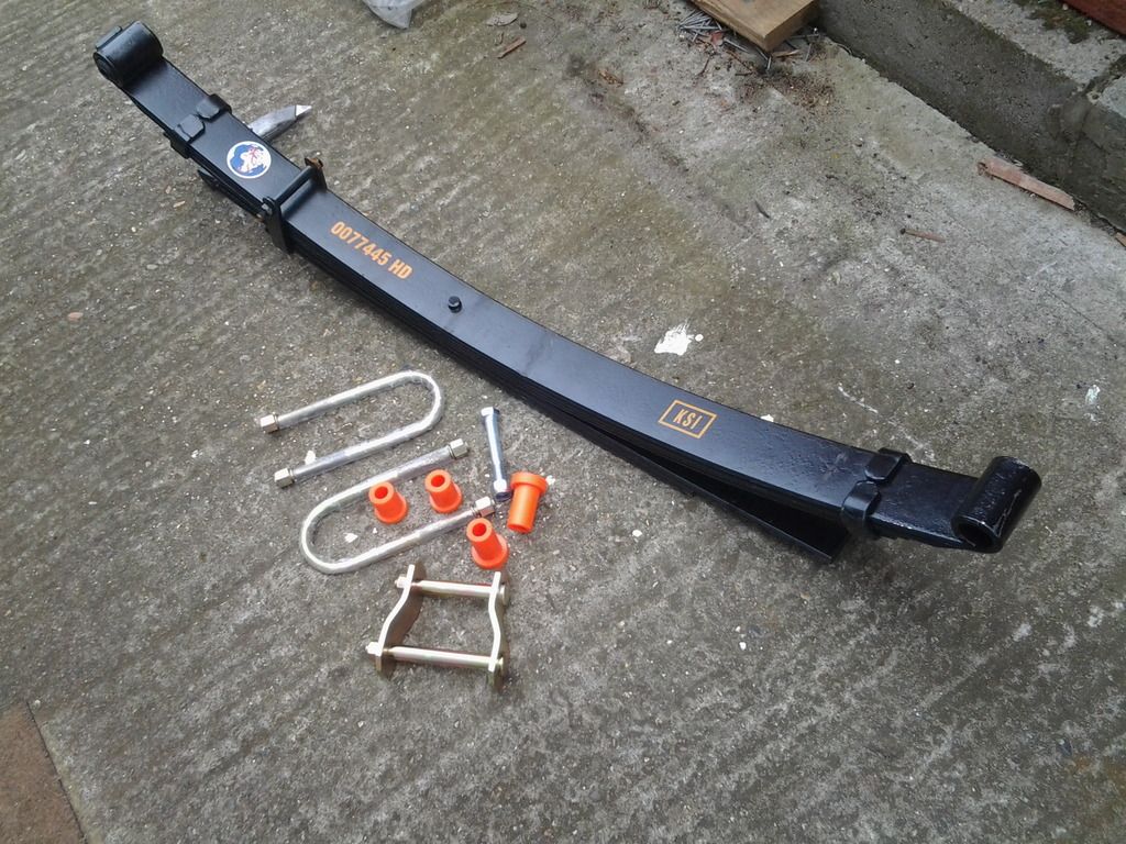

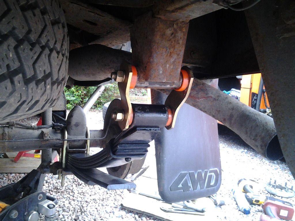

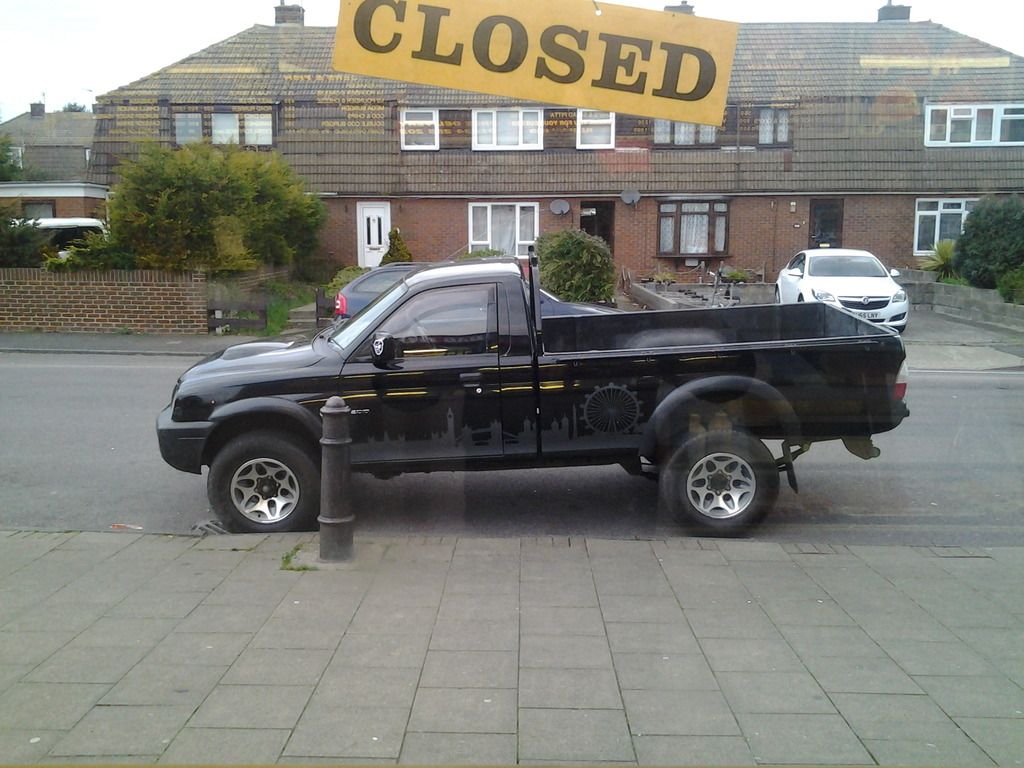

Joey spud Posted November 1, 2016 Author Posted November 1, 2016 A bit of an update for anyone into Jap stuff. The rear springs were totally shot with broken leafs and dead bushes so i ordered a pair online and after a couple of days a heavy parcel arrived. They came with all the bushes and bolts required and fitted fine but they were listed as heavy duty ones and now the rear sat a bit high and going over bumps really hurt my moobs. Even with a selection of railway sleepers in the back it still sat high and bounced about so i ended up taking the springs off and removed the third leaf and tried again,now it is much more refined but still has an arse high stance probably due to tired front torsion bars. Outsde the Kebab house (its natural habitat). Lacquer Peel, mouseflakes, mat_the_cat and 2 others 5
