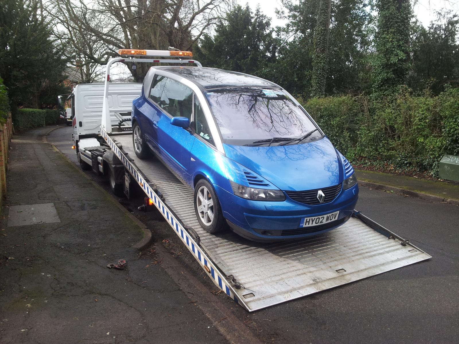

Its French its inevitable...and expensive...
After 6 good years I suppose a good and proper fail was overdue.
Firstly a little damp in the main fusebox ment it wouldn't start, so had to be recovered to my prefered Avi knowing garage in Notts, MGC servicing.
I knew the brakes and tyres were overdue, but the MOT was unplesent.

So this is why what look like immaculate cars this age get scrapped.
Going to be the thick end of 1200 /1500 quid.
Winged it for a couple of years so not so bad.8
Shit that's brutal! is that estimate with them doing all the work? What are the part prices like for these beauties
When you look at the fail sheet it's not so bad.  Tyres and track rod ends go all the time, brakes wear out too and light bulbs blow.  It's not as if the transmission has spun a bearing, the petrol tanks has rusted out and there's severe corrosion near seat belt anchor points.
It's just a bit unfortunate that all its biorhythms have aligned on MoT day, but plenty of people spend a couple of hundred every year for the MoT so which is worse?

why did it need to be trailered home, as it still had valid test left? (I assume cos not roadworthy)
Doesn't seem an unreasonable shopping list for a 14 year old Renner.   None of it made any worse by being attached to such a great looking car.

Defo being fixed, can't fault the garage doing the work, its just what it costs if you can't do it yourself.
I'm ok on the proper old stuff, but not this.
Its was recovered from home as my RAC covers everthing except homestart. Cant tow it as its an auto.
What I ment is if it was an Espace/Laguna ect it would be goodbye time.
The only frustration is the fact they are still worth little, so it a heart not head ruling this.
I don't think the bill sounds that terrible if its for everything, depends on the labour for the brake pipes but for all i know theyre routed through the headlining or something.
Its all very well saying I'd fix it for £12.50 and a days work but some people can't or won't turn their own spanners, if so this is what it costs.
Well done for getting it fixed anyway capsuleboy, looks lovely even on the back of a truck.
