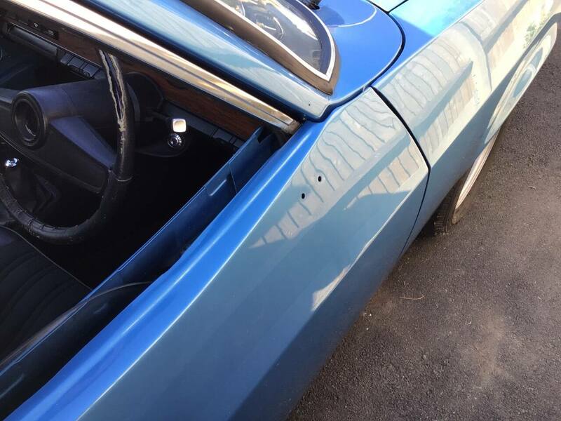

Firstly, it’s picked up some bullet holes!!

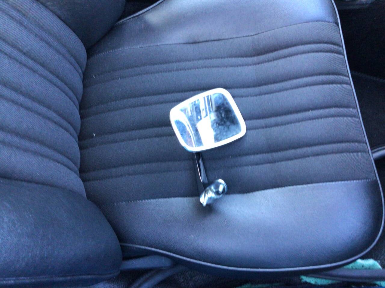

Oh yes, it’s time to fit the door mirrors!!
This bit was a bit of a one shot deal, get it wrong and you’ll see the error! As usual, I could find no information anywhere about exactly where these needed to be fitted on the door so it was a case of find what pictures I could of the right style mirrors and cobble something together that looks right.
There’s a variety of different types of mirrors that were fitted to these cars from the factory, depending on the cars age and specification. Believe it or not the earliest mk2’s actually had no set mirror type, some were even sent out with no mirrors at all or, like mine did, with a single extra cost mirror on the drivers door only. Then of course there’s a whole shed load of non genuine mirrors that people fitted too.
When I got the car it had a non gen mirror on the drivers door (chrome TEX item). Then after it’s first rebuild I fitted a pair of standard late Mk2/Mk3 mirrors, the chrome version. These, while not being a bad choice weren’t right for the age of my car so I decided to hunt down the right ones. I mentioned this earlier in the thread somewhere, but my car being so early was almost certainly originally fitted with a mirror similar to some Mk1’s had. Despite looking similar it’s actually a new part for the Mk2 in 1974. However it seems this design was very short lived (from what I gather the ‘ball’ type position adjustment between stem & mirror head was prone to wear which meant the head would just flop down rendering the mirror useless unless you liked looking down at the road!) This design was only available from Jan 74 to Nov (I think) 74… nowadays this is a rare part!
Naturally this was what I wanted as I just love making life difficult for myself!
I looked for ages for a pair, and eventually got lucky finding a new old stock left hand one in Germany. Then shortly afterwards spotted a mis-described right hand one, also new old stock, here in the U.K.
Since I’m aiming for reasonably close to factory looks for this car I should have only needed the drivers side one. But, I’m going for the pair as having both door mirrors will just A; be safer - better visibility. And B; I think having both looks better!
So, masking tape stuck to the door in roughly the right area I measured, offered up, measured, offered up… many many times to be absolutely sure! Then compared measurements from one side to the other just as confirmation. Then drilled a pilot hole through my lovely doors. This was followed up with the step drill bit through to a 6mm hole x 2 per side.
After that, I cleaned up the swarf and painted the bare steel edges of the holes, first with primer, then a coat of blue, then finally I swabbed in a bit of thick Waxoyl just to be absolutely sure rust can’t start on the holes if any damp manages to creep in under the mirror stem seal.
Here’s what I used to get approximate position from, a Ford press pic.
I actually had someone hold my mirror in place then I jumped in the car to check I could see properly from each seat (before drilling the holes!) but I found I could see more by moving the mirror further forward up the door than Ford put them so I went with that. It’s barely noticeable tbh but I’d rather be able to see properly than worry about absolute mm perfection to original!
Fitting is easy once the holes are drilled, slide the stem seal on, push the two studs through the holes then stick your hand up inside the now freshly wax filled (!) door and do up the nut. They didn’t come with washers, but I did add a big penny washer and spring washer to each, just to be sure. I’ve also smeared grease over the studs/nuts to stop corrosion and then blasted wax over the backs of the holes inside the doors to protect the hole edges.
I’m well pleased with them! Exactly what I wanted, and quite an unusual item on these nowadays. I forgot to get a pic but standing back and looking at the car now it looks really nice with these on. They really set it off imho.

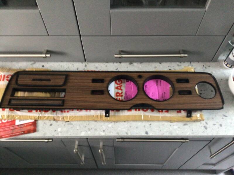

Should be doing a few more jobs on this tomorrow. For now though, check this rarity out!
A dash facia that’s still got both the radio and accessory button blanks! Never seen one before tbh so I bagged this one!
I probably won’t be using it here in all honesty, since I’ve got a decent period radio lined up and already fitted the aerial etc to the car but I just wanted it purely for the rarity value!
