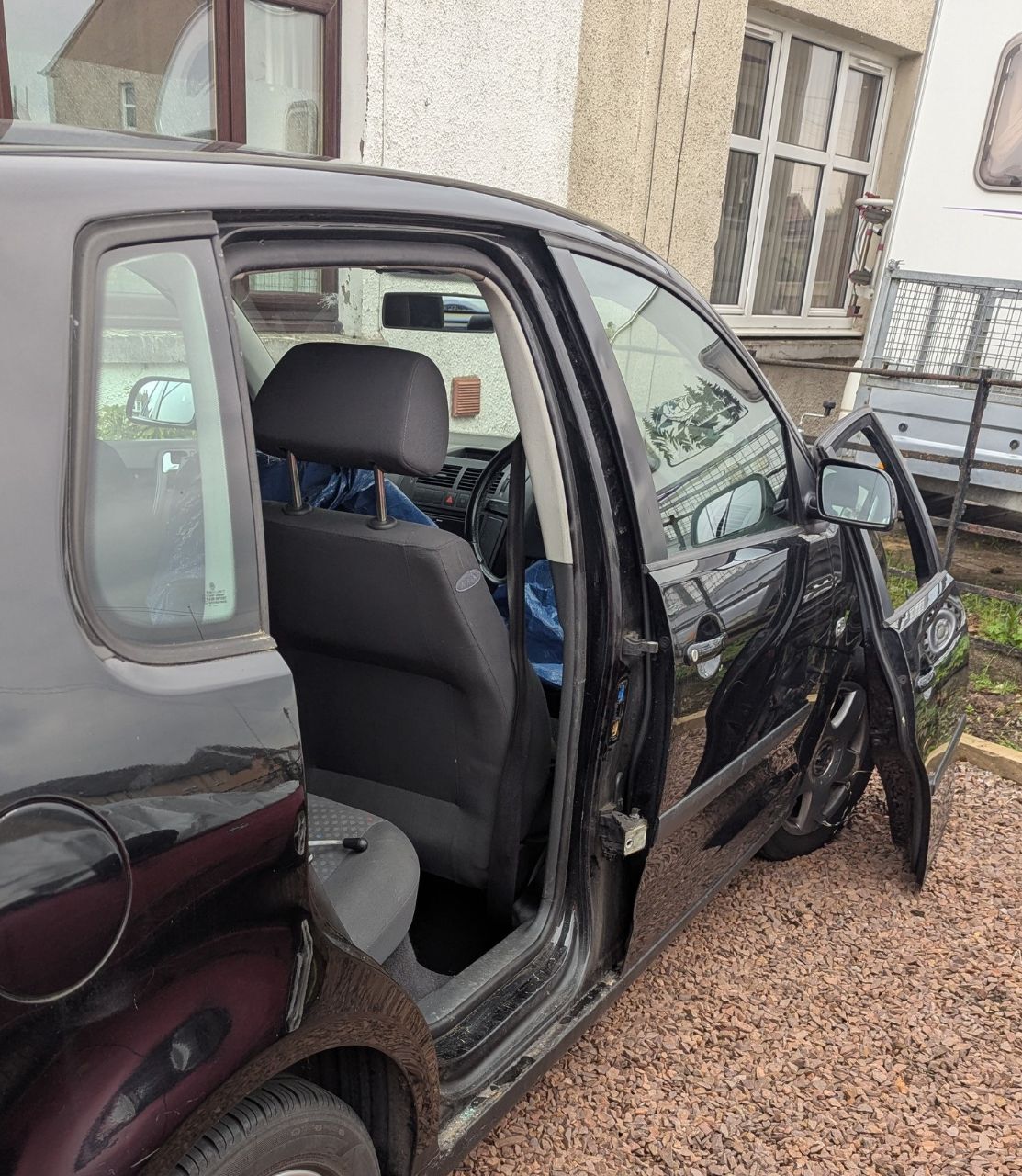

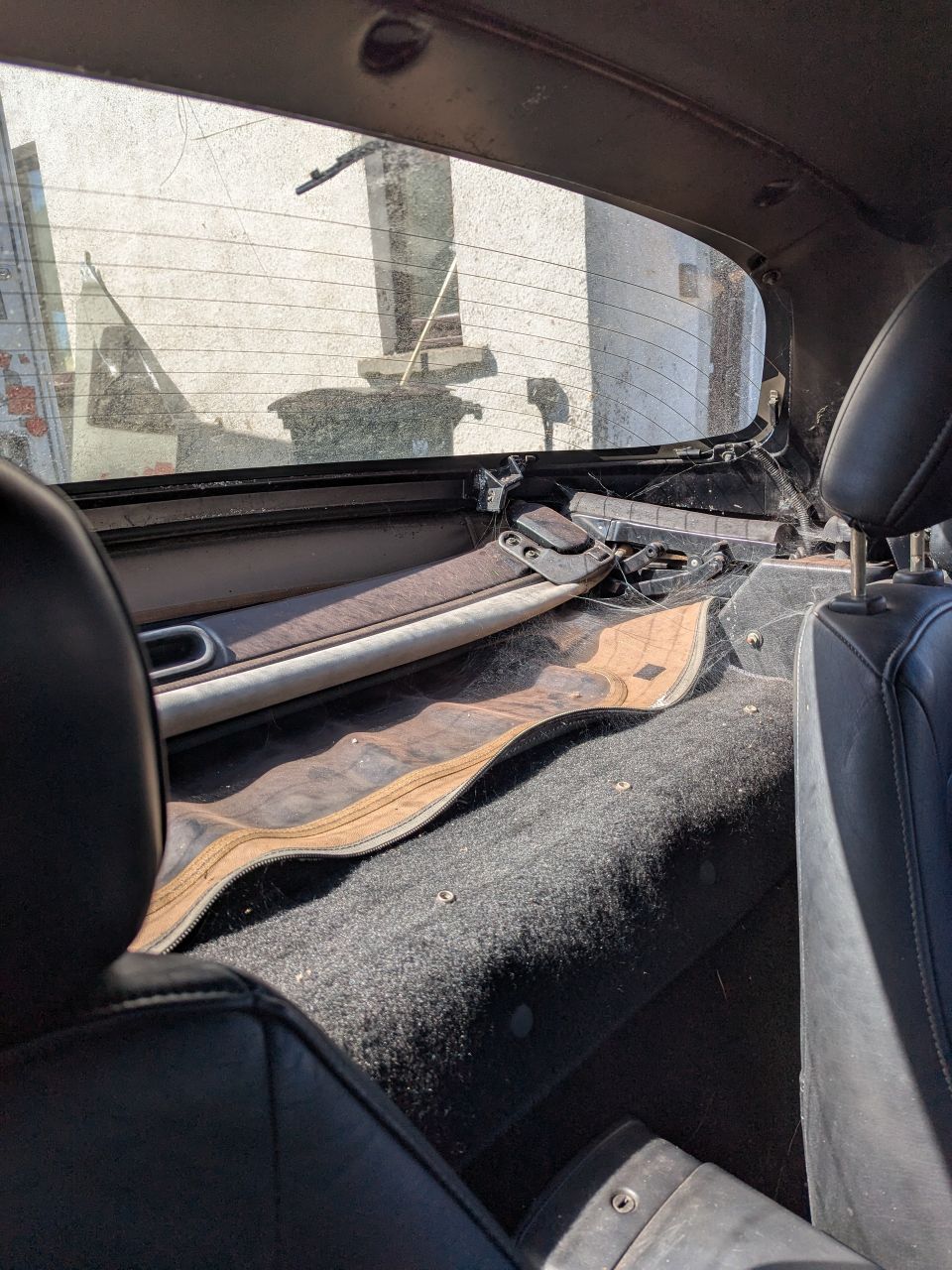

Wandered along to U Pull It today, to pop that cherry.

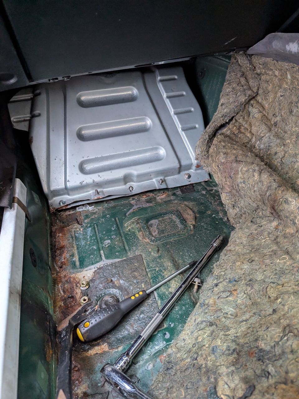

Before I left I removed the rear door on Polo to check how easy it was - literally two bolts and it popped off.
PXL_20250426_125527721.jpg.37af1d66107488c8b8bad9a3f8b47045.jpgPXL_20250426_132508878.jpg.1c0f0d1947b5799b52572bf806693e9e.jpg
There were two black polos in, but on both the rear doors seemed to have the catches knackered on them as they wouldn't open.  So as not to waste I journey I decided to get something to fill the hole
I came back to find another warmish ford parked next to me
Back home and popped it on.
It will do for now. I am likely to spend Tuesday swapping over the internals and fitting a new lock.
At least the dash now doesn't have any undue lights on it!

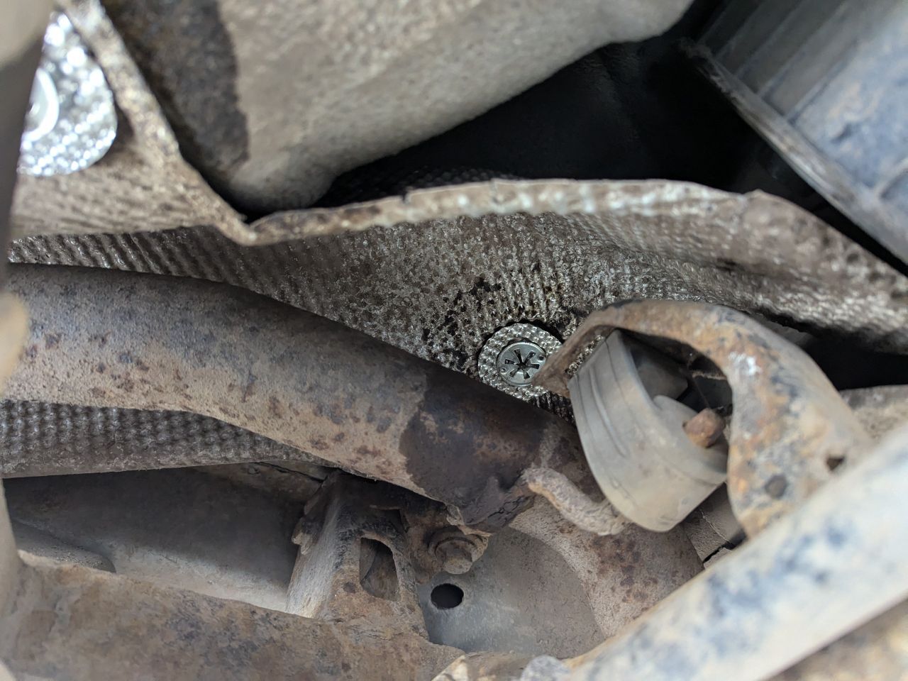

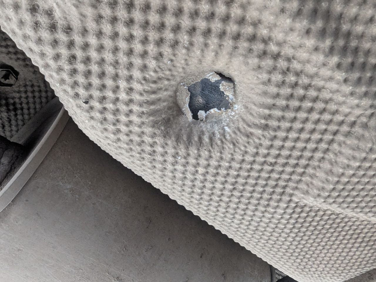

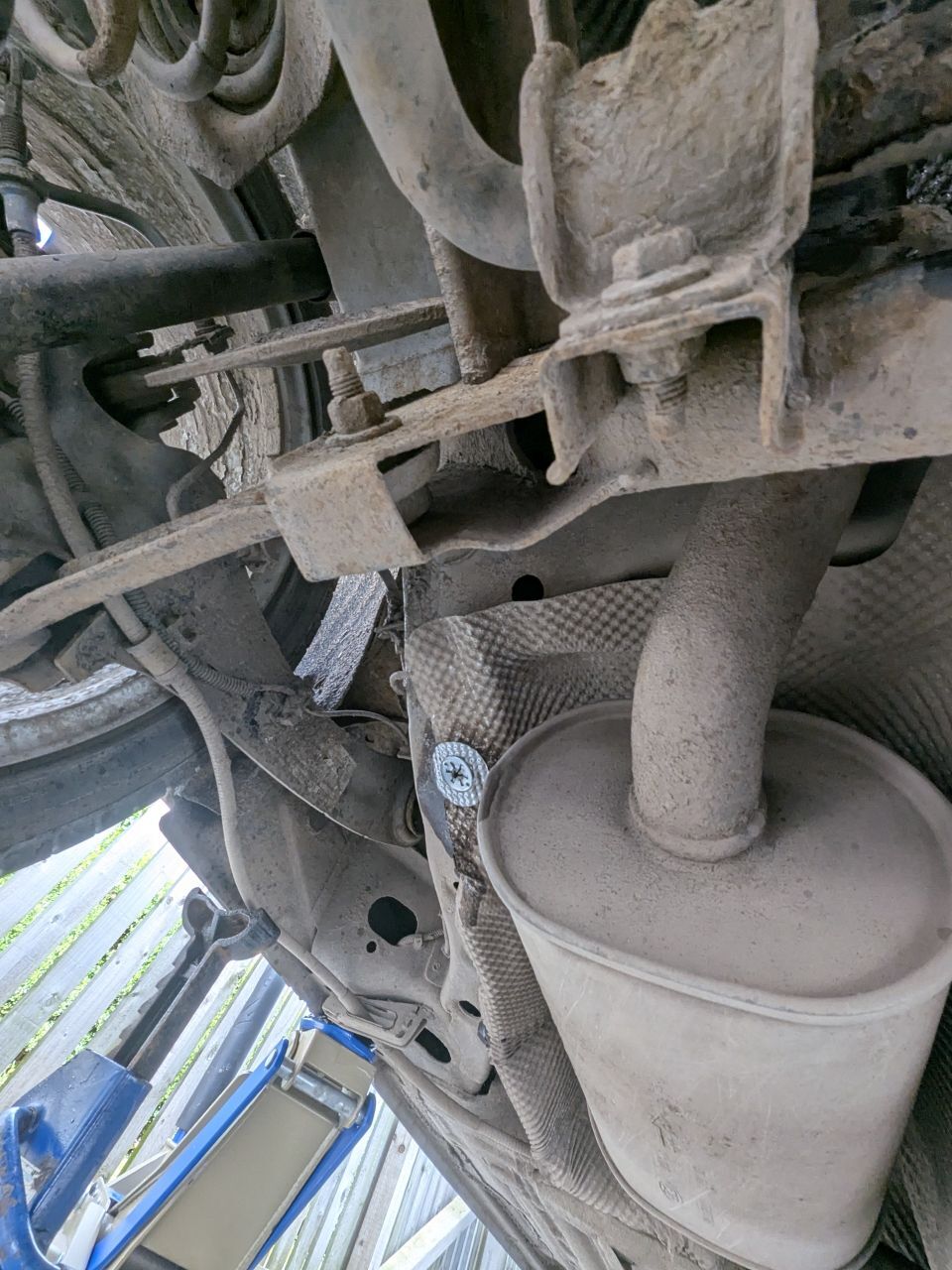

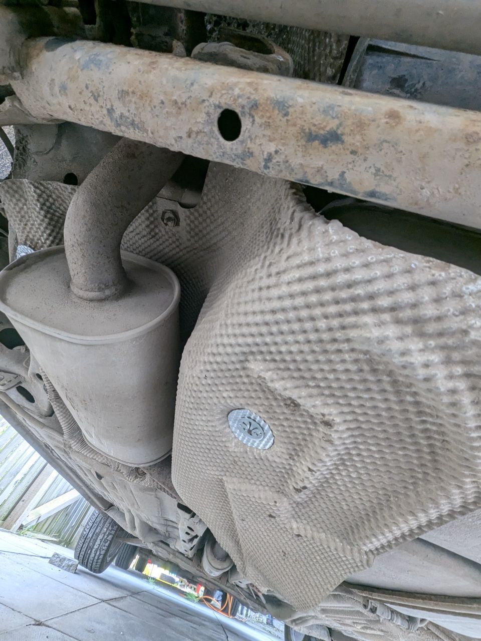

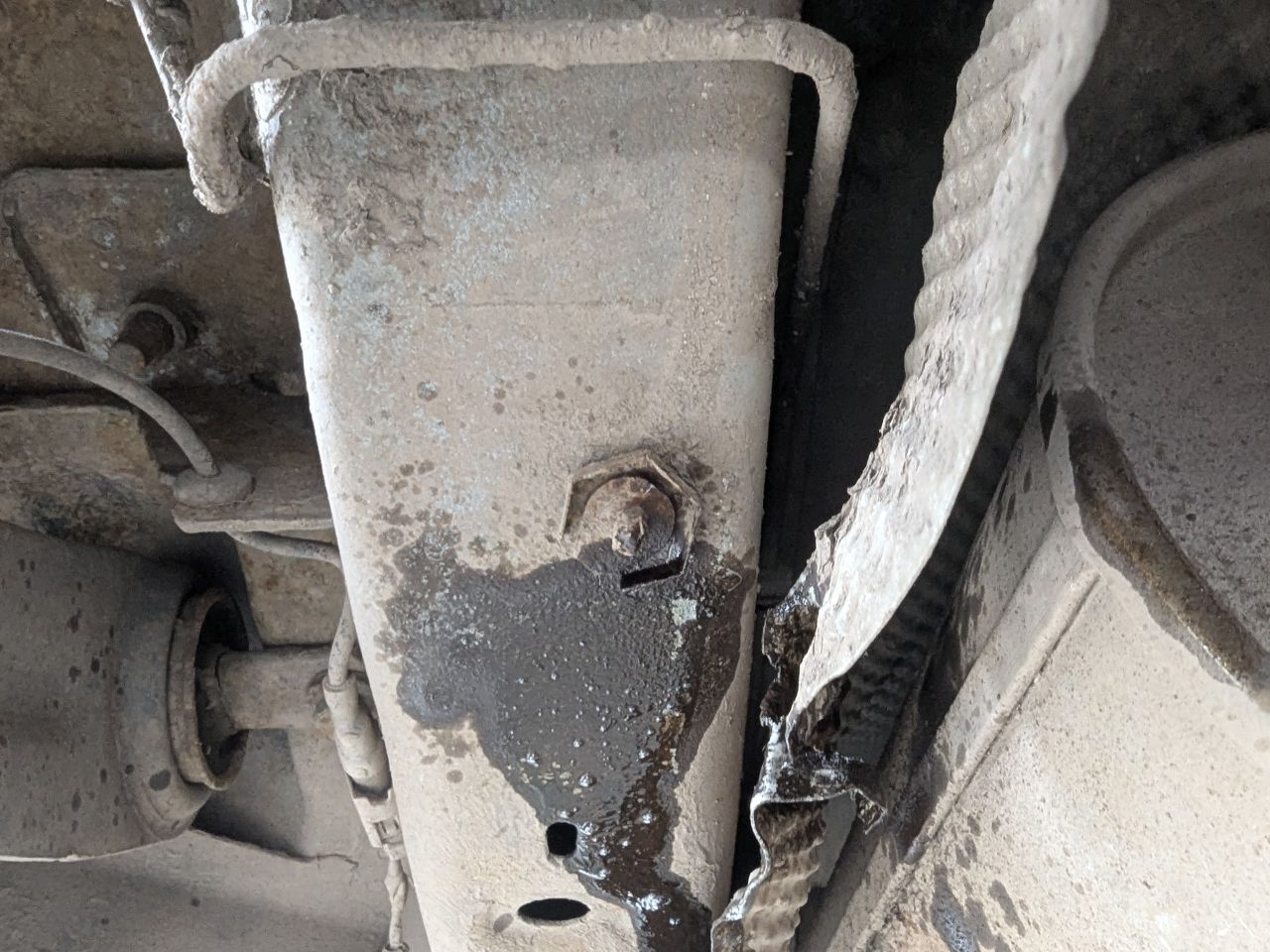

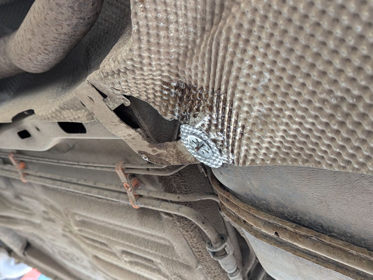

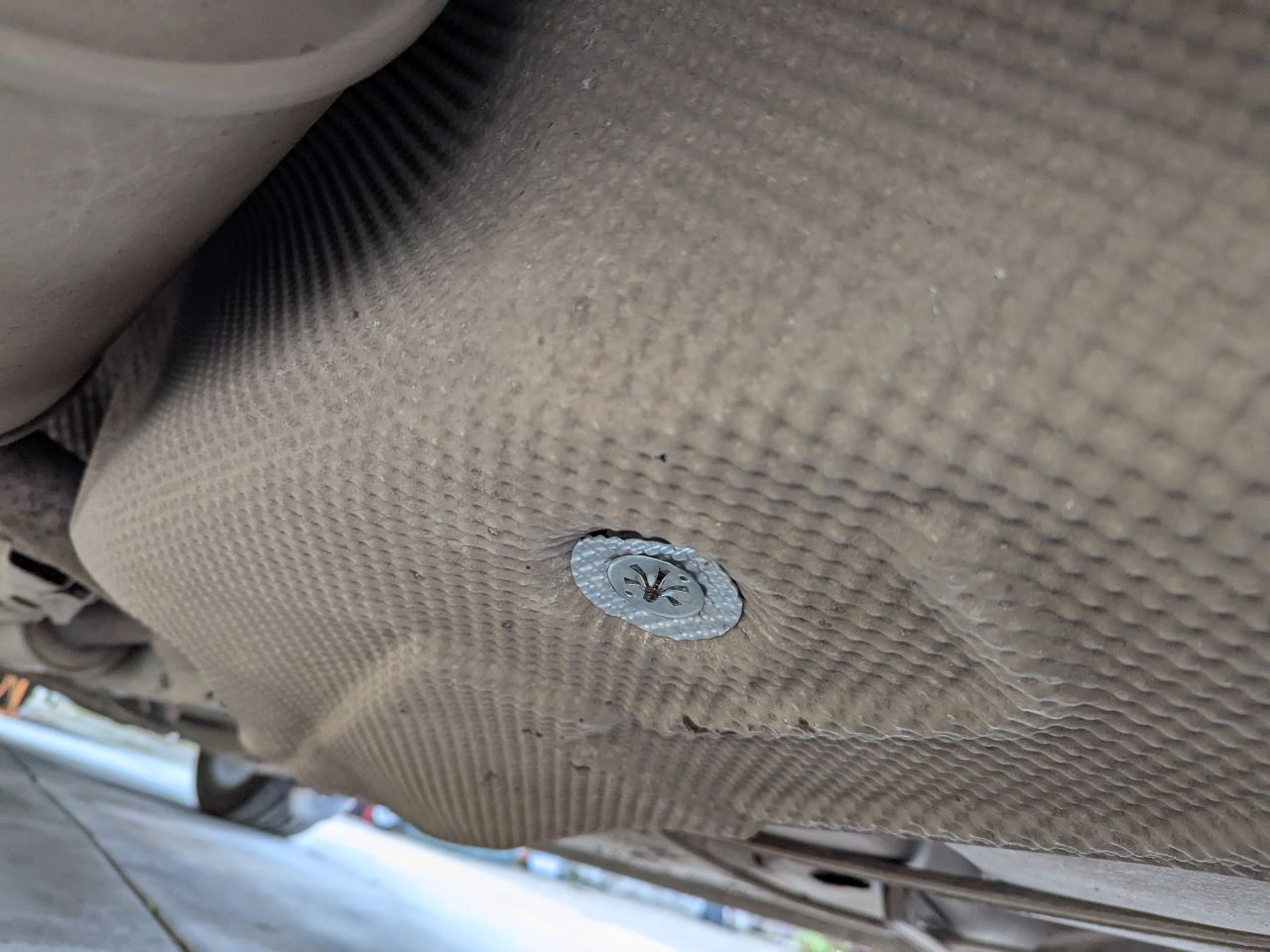

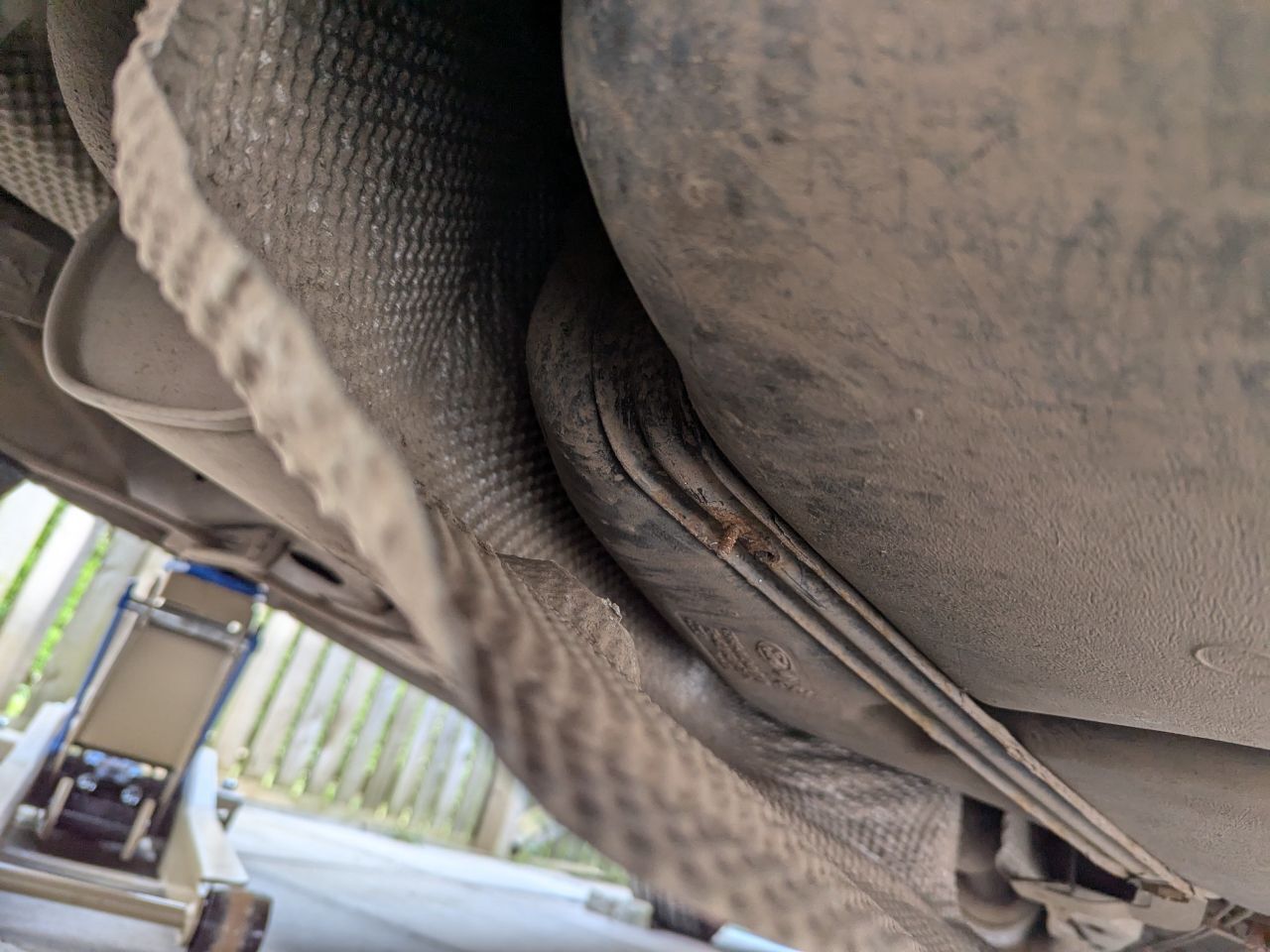

After removing the grass and mud from underneath, I set about sorting out the scraping heath shields. Surprisingly snacking them on a field had hastened the departure.
PXL_20250504_143615405.jpg.d4d17a91f5decc0039fcc3728c0e0e7e.jpgPXL_20250504_143620816.jpg.8705efe81c2105c65508a50dac866a62.jpgPXL_20250504_144726248.jpg.02b9f9445000b5bee3121bbce1172a5a.jpgPXL_20250504_144823449.jpg.84f6da2c019fe36c97c9b8a648ea8f18.jpg
From eBay you can get repair washers kits for not much.  I highly recommend them PXL_20250504_150256523.jpg.bed892324c8b7ec10bd69f37b0874a00.jpgPXL_20250504_151248608.jpg.6e4b2c5bea766fef52f8345368cece9e.jpgPXL_20250504_150254922.jpg.8b29c14624e5ee74f7b3f61a603d32c1.jpgPXL_20250504_150246895.jpg.bec3582e0c3a1d9115e3519e1c1b12dd.jpgPXL_20250504_145641278_MP.jpg.0016fdf386d415effe87fa0283b681b0.jpg
I used a small socket to hammer the star washer on and now have a silent underneath.

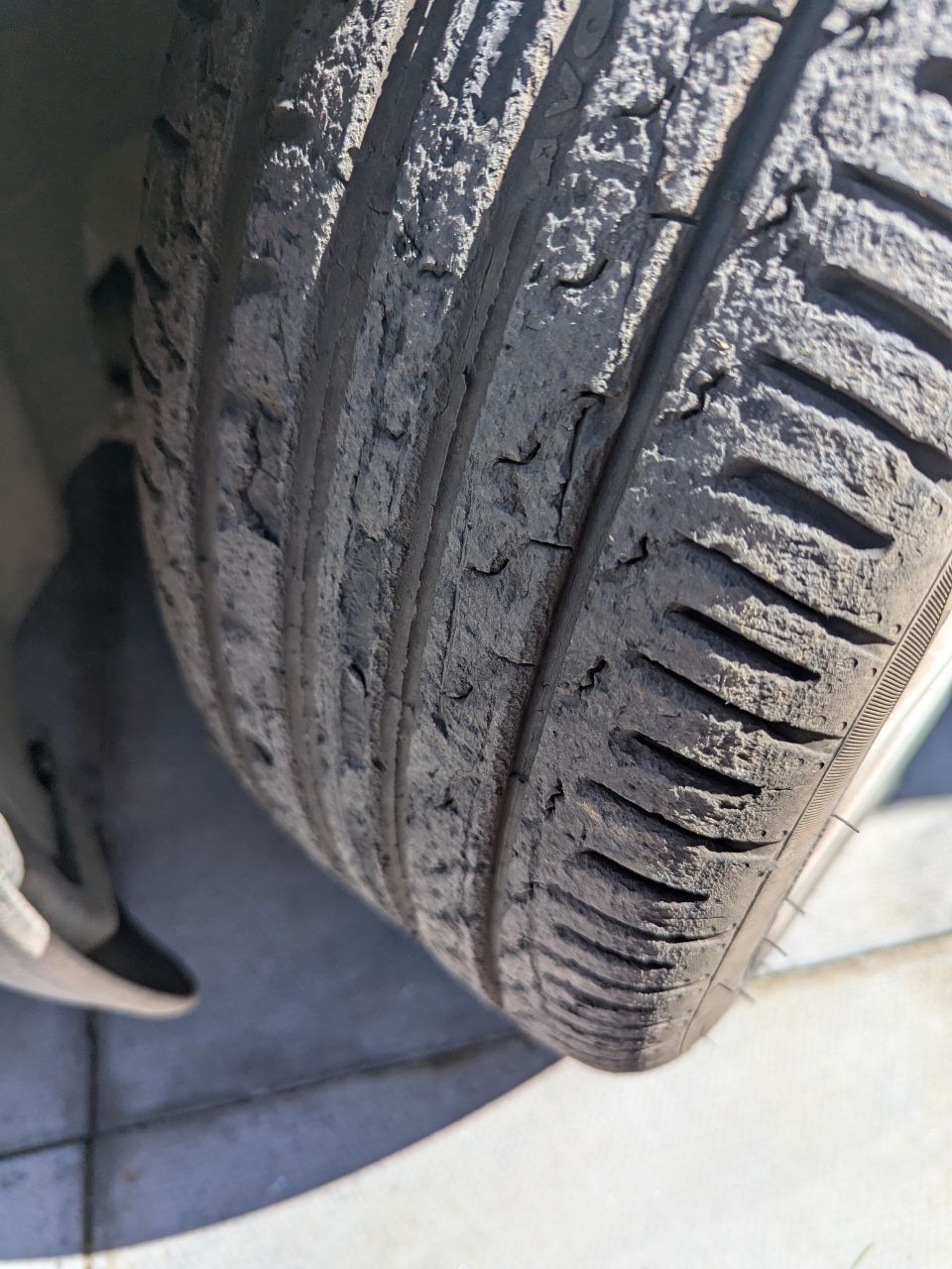

I may also have to source some extra wheels with race wheels as I don't think these Avon's are holding up to drifting. PXL_20250505_125012941.jpg.efac70af04539bb7683b23e9c9a407e7.jpg
When the heat shields went on my Focus I simply bent down and ripped them out but I understand that you’d probably want to keep yours.
I've got a set of 16” Cosworth style alloys on my Focus that I’d sell if you’re interested and ever passing my way?
I think technically it is an MOT fail with no heat shield.  Also we rag the bolloxs off it with no air flow.
Very much would be interested - got any pics and price?

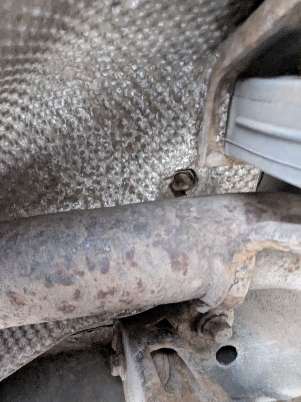

I've got a loose exhaust heatshield on my car which cause a mild knock (VERY far down the to give a shit about list though) but those repair things are just what I need to buy when/if the time comes, thanks!
Here's the badger - literally took 20 mins to fit.
https://www.ebay.co.uk/itm/315664087299?mkcid=16&mkevt=1&mkrid=711-127632-2357-0&ssspo=yr9jpp_-tqw&sssrc=4429486&ssuid=WTt5QNjFTlm&var=&widget_ver=artemis&media=COPY
My old Astra J had loose exhaust shields from memory, used to shake like a right prick and do rumble sounds during idle, think we just bent it to the point it didn't move and that outlasted the car 👌

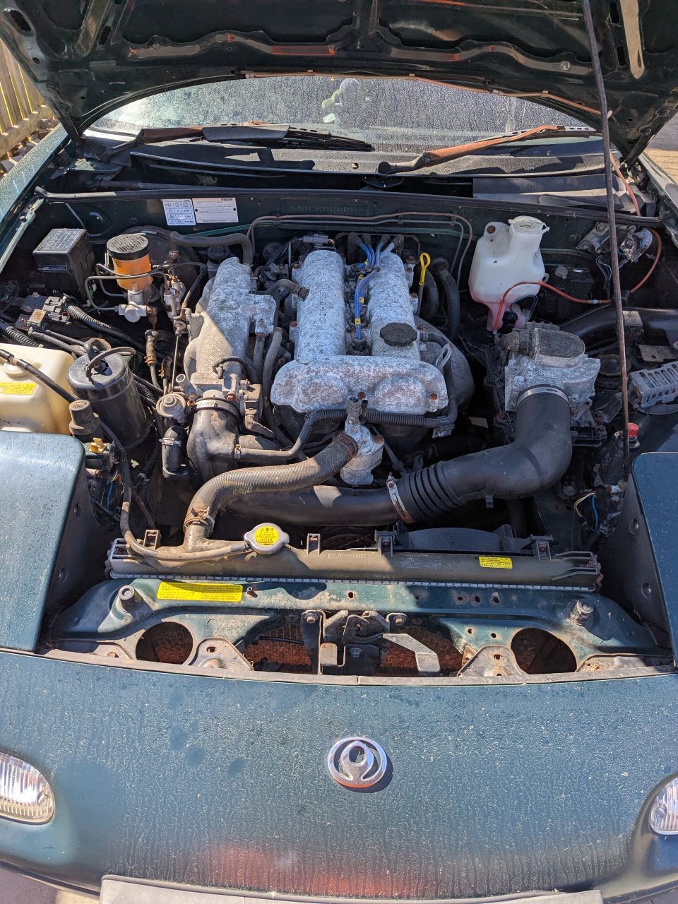

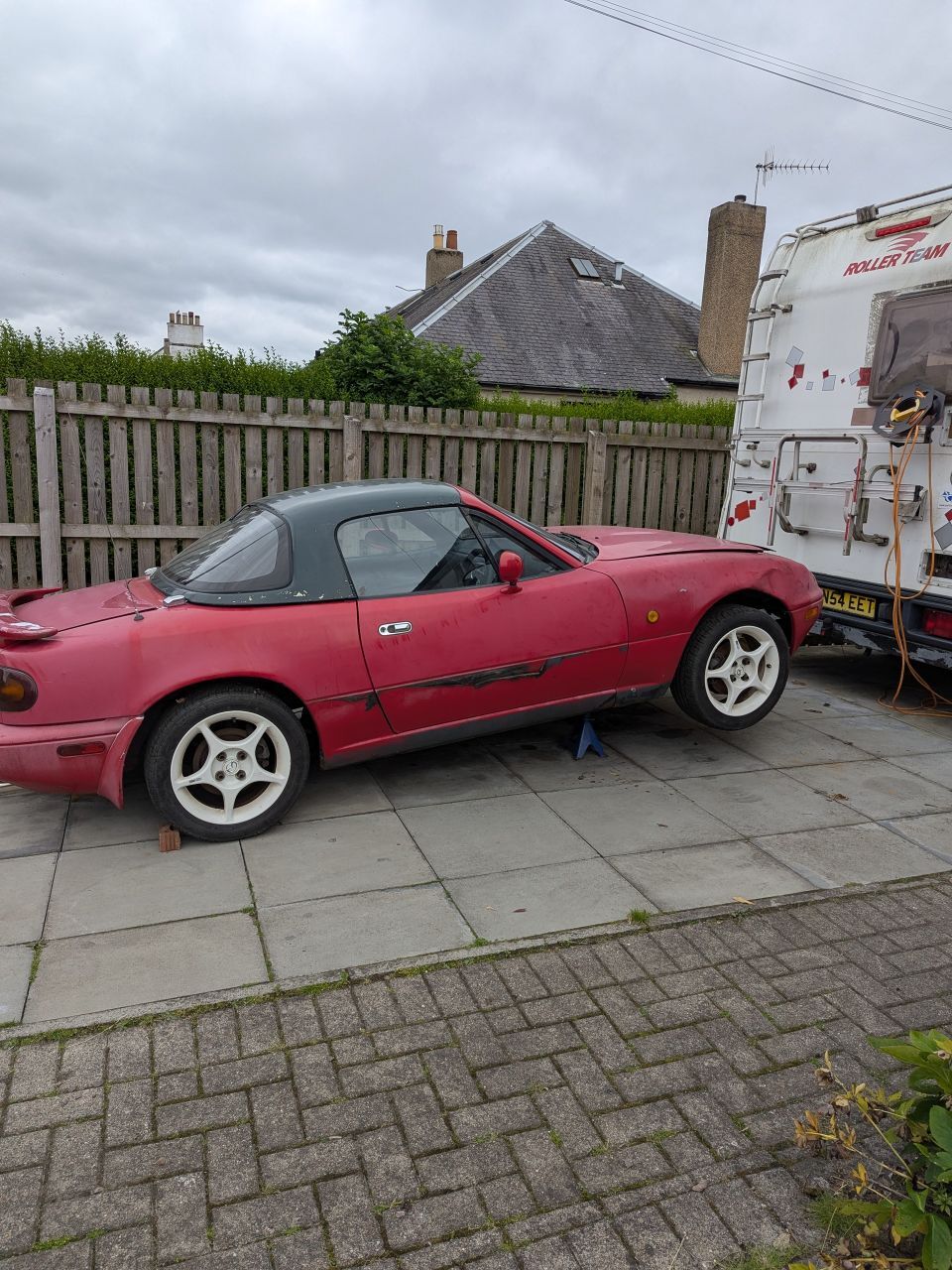

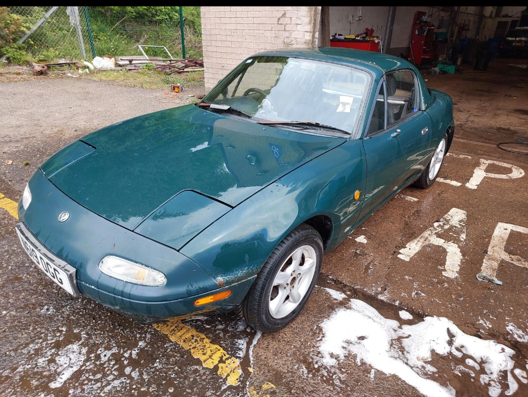

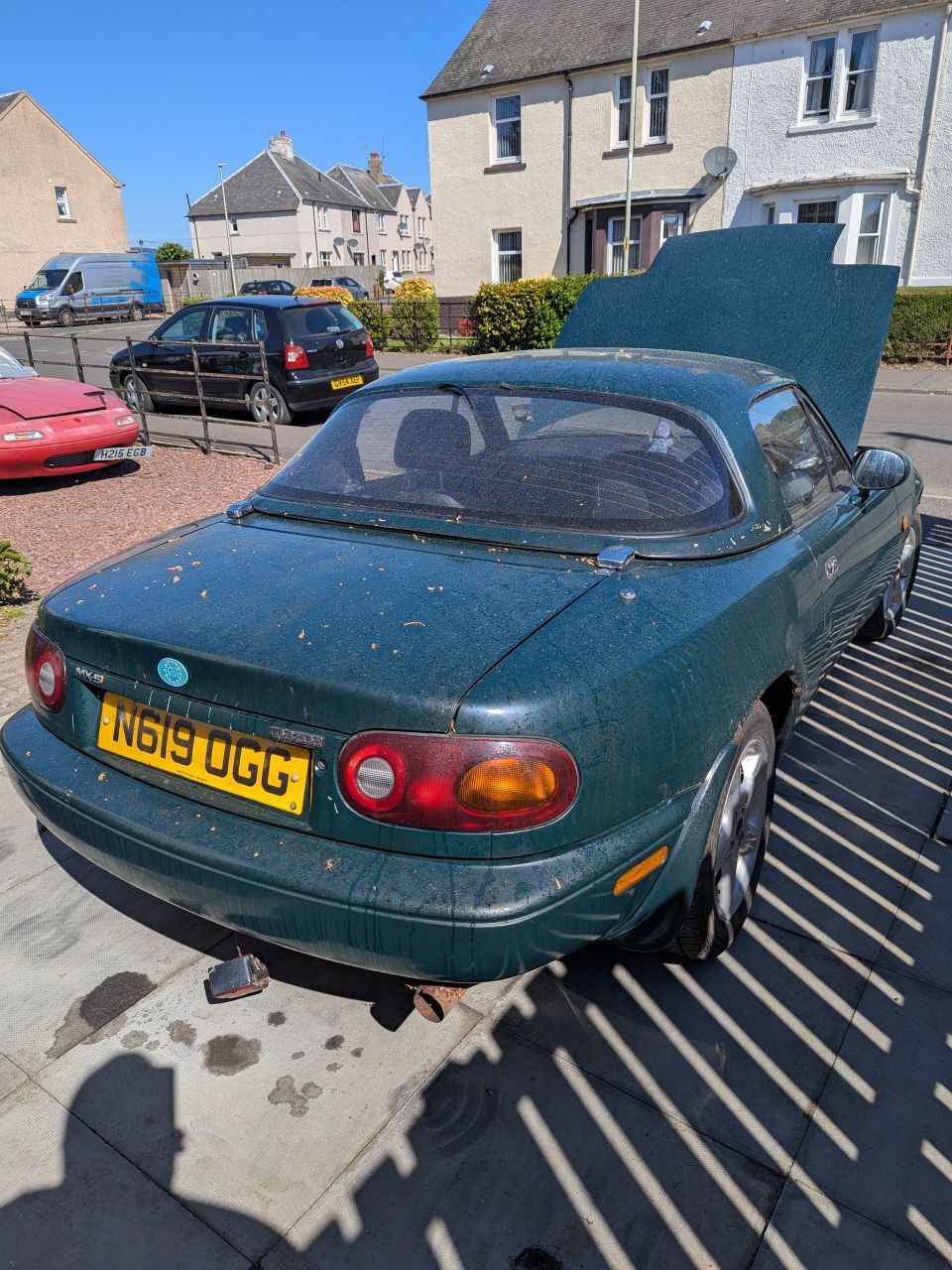

So when this popped up locally I had to have a bid. A Scabby mx5 Na 1.6.  running engine but tin worm to max. Screenshot_20250518-2059132.png.37ba03c9105dcec475a7ed58fa0f3f9d.pngScreenshot_20250518-2059222.png.83df1b0ae1e568db9c23076813ebbcc9.pngScreenshot_20250518-2059192.png.15e8b288af411c128811921837a71832.pngScreenshot_20250518-2059252.png.448ad83f3452a27cf7f71ad7d5c0778e.png
The selling point is that it has a running engine, came with hardtop and also a pair of new front and rear wings.
Won for £750, plus £30 for delivery it duly arrived Saturday.
Car ran, but had a misfire or vac leak.
The plan was to either a) get this one back on the road or b) nick bits for my one for her it running (in non turbo form if needed).
Initially it didn't look too bad.  A hoover and de spiderweb was first up
PXL_20250517_094458436_MP.jpg.9e9b60c3ebe44cede6d50b593ee3cf50.jpgPXL_20250517_143245436.jpg.aaac829de22f310b5109d8a4d0d4ccdf.jpgPXL_20250517_143247122.jpg.62f66859abfbb41577f123aa88b07794.jpgPXL_20250517_143829371.jpg.fb9c60897bafb01f7551c126ea0b3203.jpg

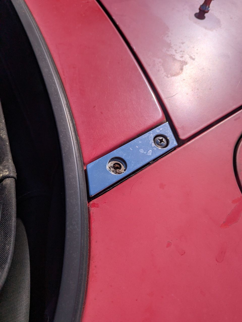

Hardtop off to reveal the brown roof.  Was in very good condition except the rear window zip is bust.
Nevermind the hard top is going on my other one.  Needed to swap the Frankenstein bolts over first. PXL_20250517_154131645.jpg.c4e6bb3e9e3cac4825db303c6e712b3f.jpgPXL_20250517_154426849.jpg.ebde909f58f169c15ed90b5d47e2087c.jpg
Took the green one out for a run on private roads, brakes sucked.  So tried an emergency stop - pedal sank to the floor as something burst.
I don't really have time or inclination to fix it.  So will keep hardtop and wings, then once I have got mine running will scrap it.

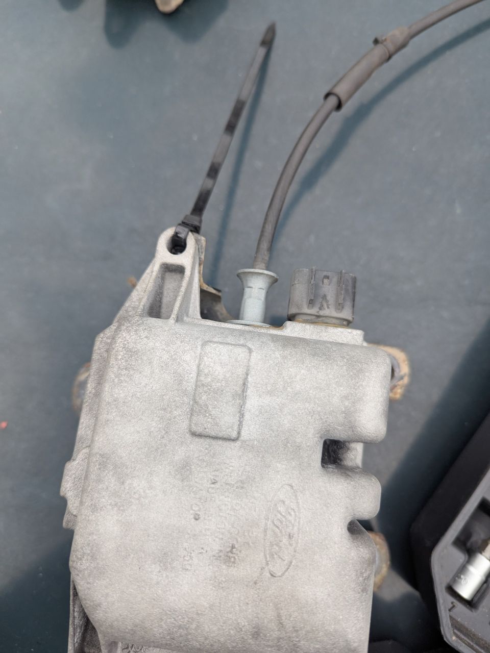

The easiest "repair" is once you have the deadlock unlocked to disconnect the loom to the door - the door will lock and unlock manually with no warning lights and the deadlock will not engage again, ever.

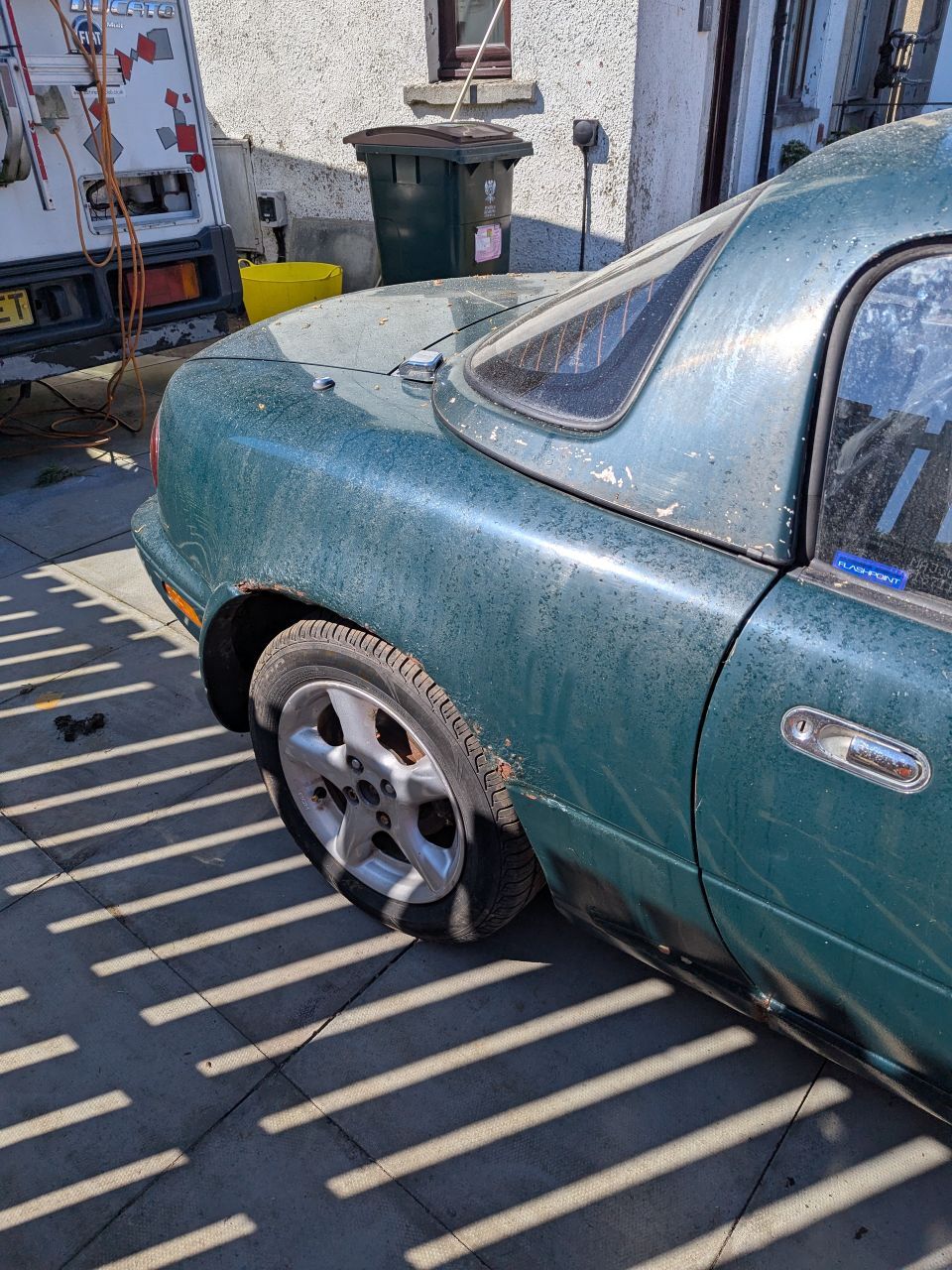

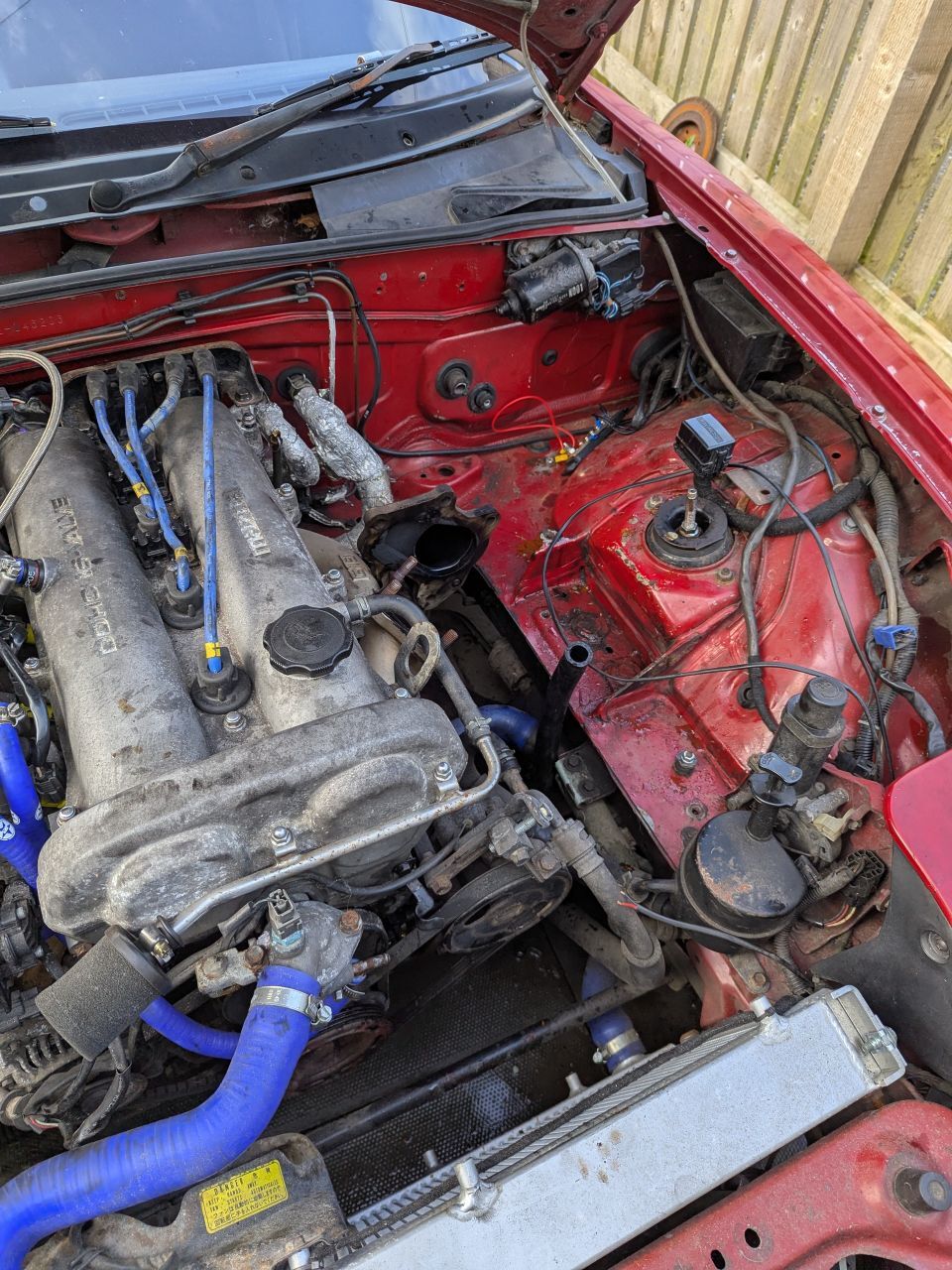

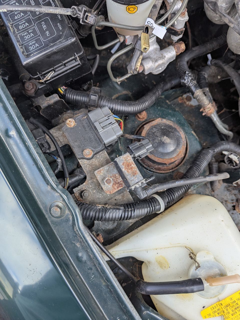

Day one of project get a working mx5

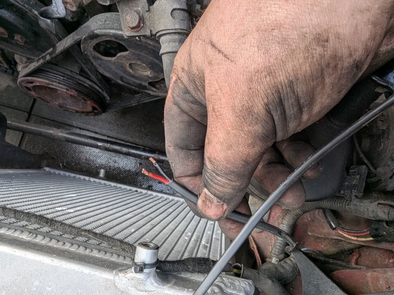

I tried swapping over cas and ignition coils to the red mx5 - but still no start.  I spoke to a remote tuner and it would need a wide band O2 sensor. Checking with the guys who converted it, they don't fit one - using their own sensors for set up the system.
Also the exhaust they have fitted doesn't have a sensor bung.
Plan B is to remove the turboey bits, get it back to running a NA setup with the intent to returbo in future.

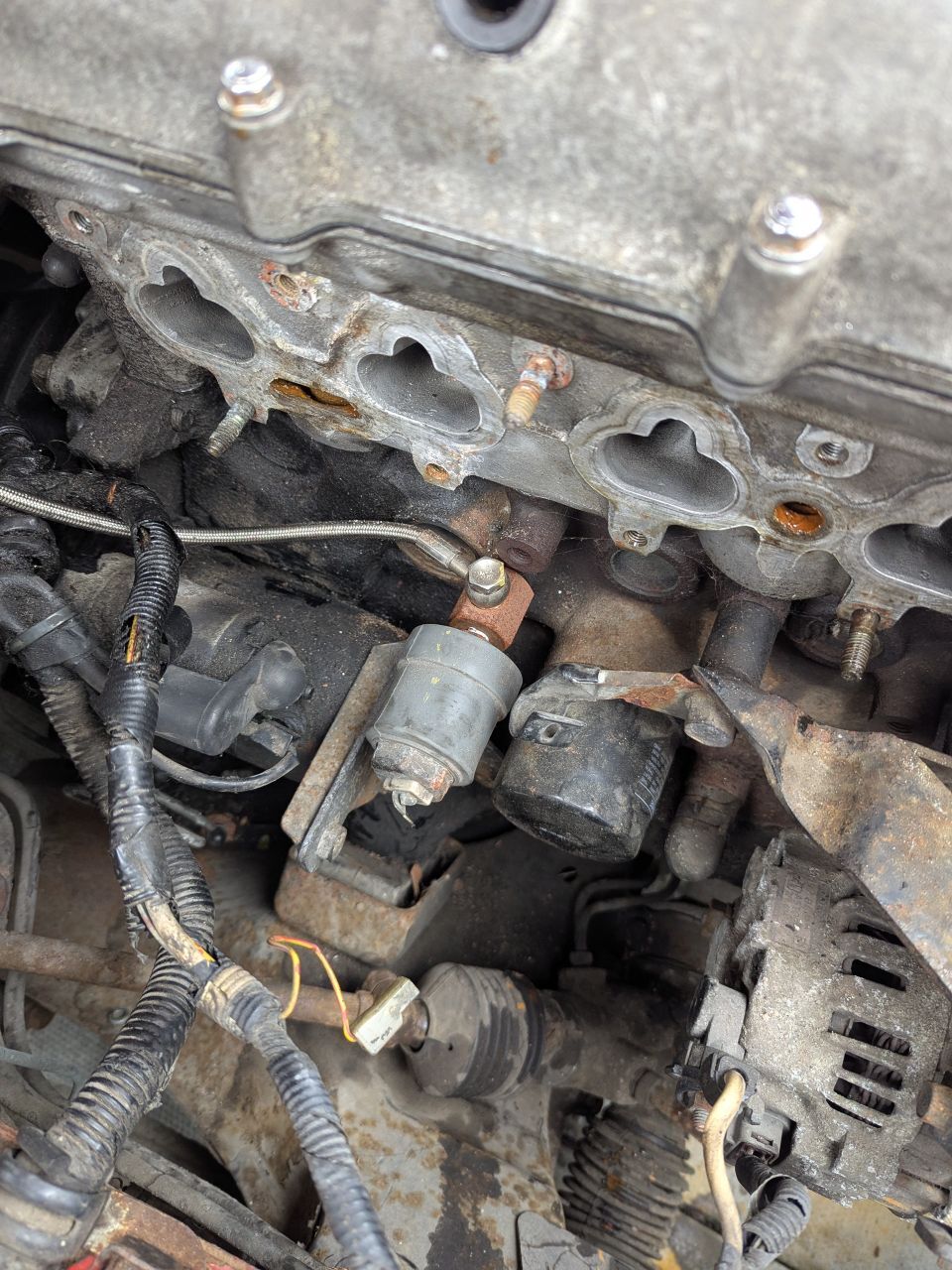

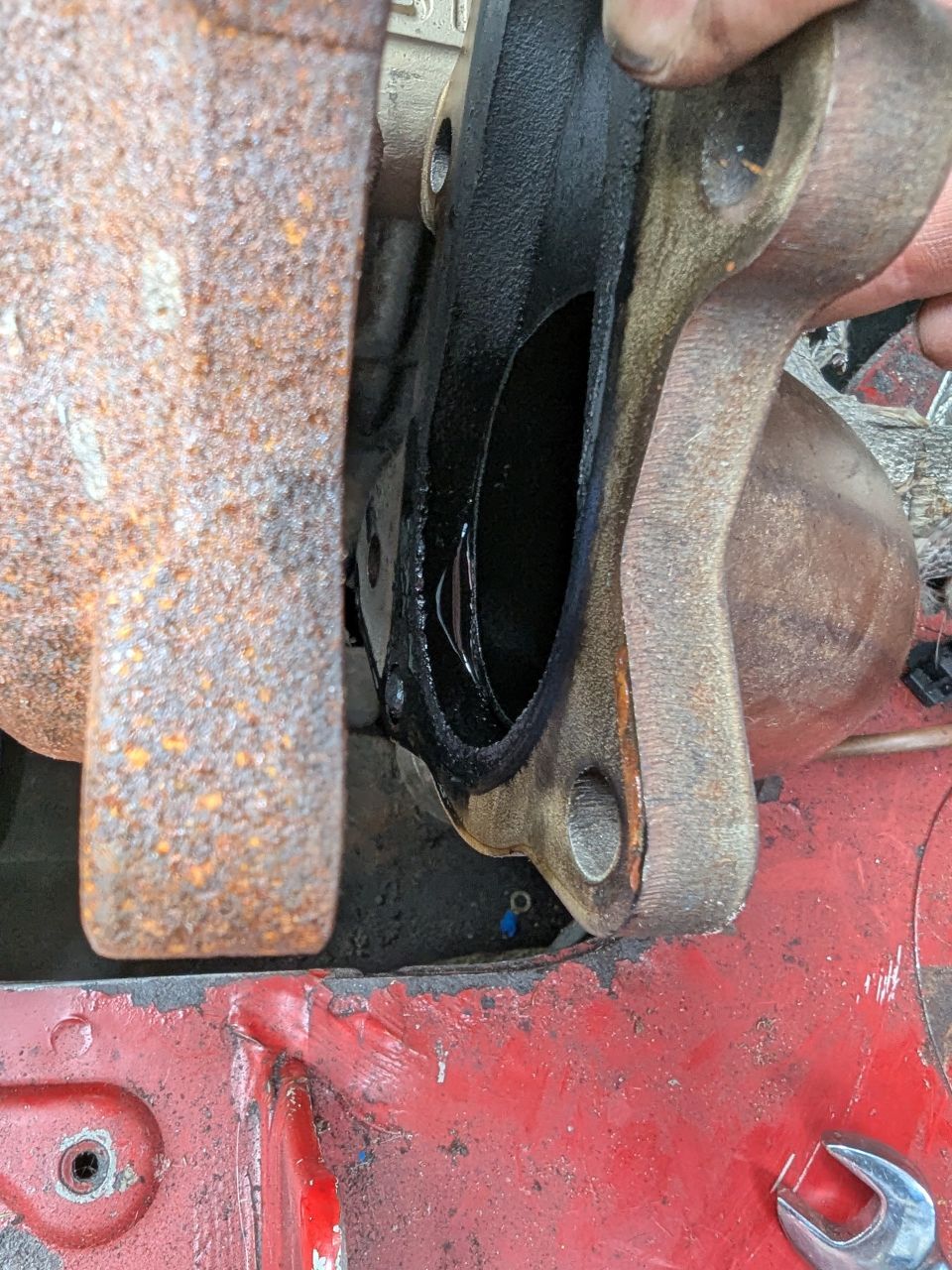

First up was get off the turbo
PXL_20250615_155557889.jpg.18940d2c2b32f025f375e56f84588068.jpgPXL_20250615_161134463.jpg.d99d10c6eea3e8a6f3c3cc6813f640cd.jpgPXL_20250615_161631471.jpg.6ca666214a5c8101e5f8b56a0affafa2.jpgPXL_20250615_165109438.jpg.182634053849c13007f1aace56d0d217.jpg
Little bit fiddly.

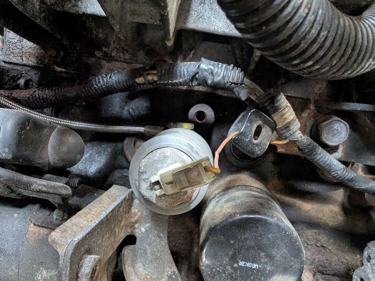

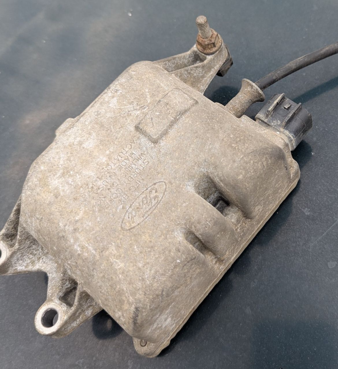

This was concerning - you can see the plug to the waste gate actuator, the end literally fell off
Not sure it causes a no start but doesn't help. Stripped and the good bits in a box to go in the shed

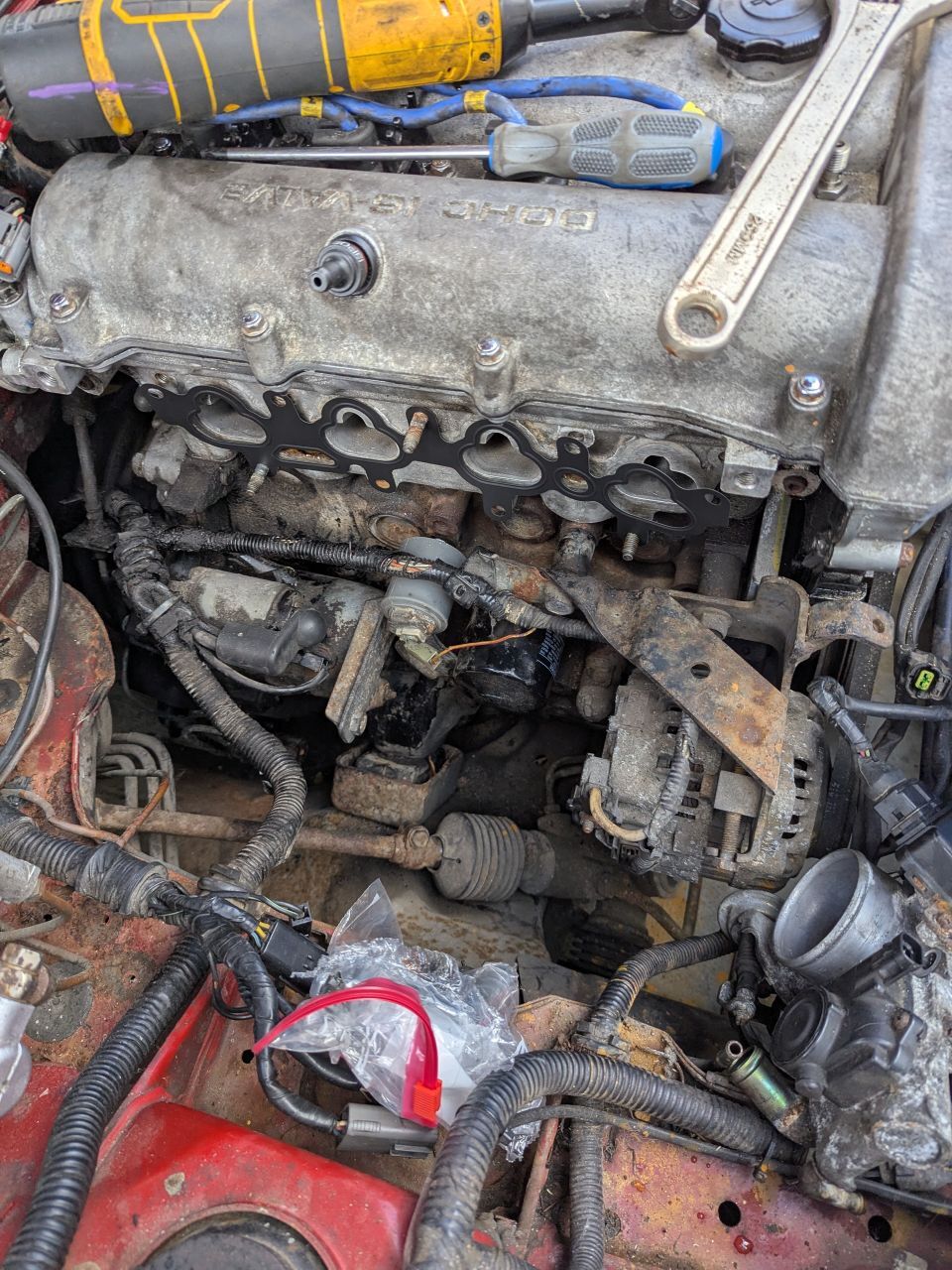

Then it is remove the engine wiring harness from the green one and fit it into red one. Going to be a bit of a fiddly job and will need to label everything.

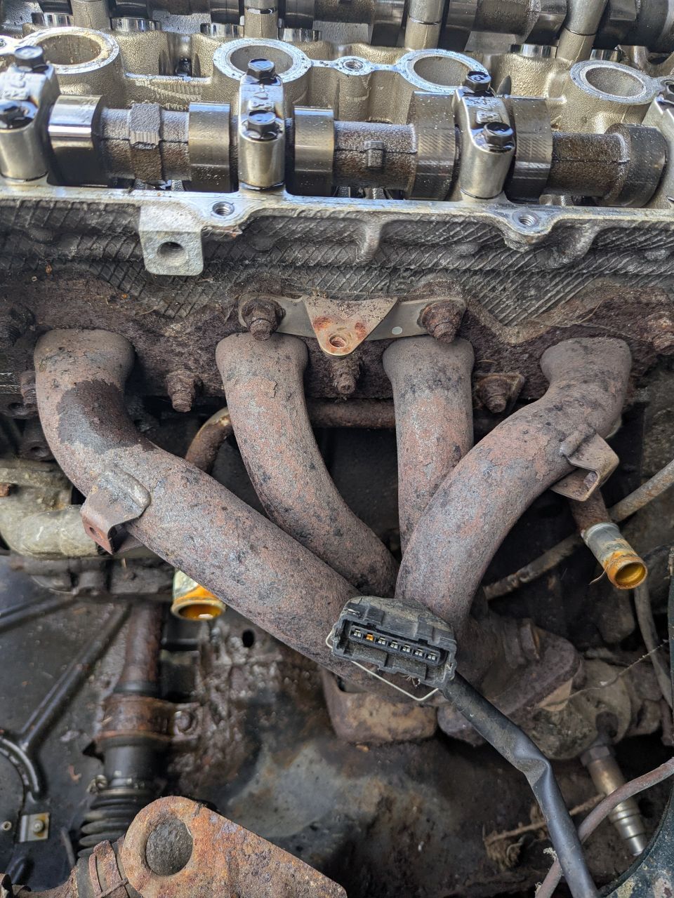

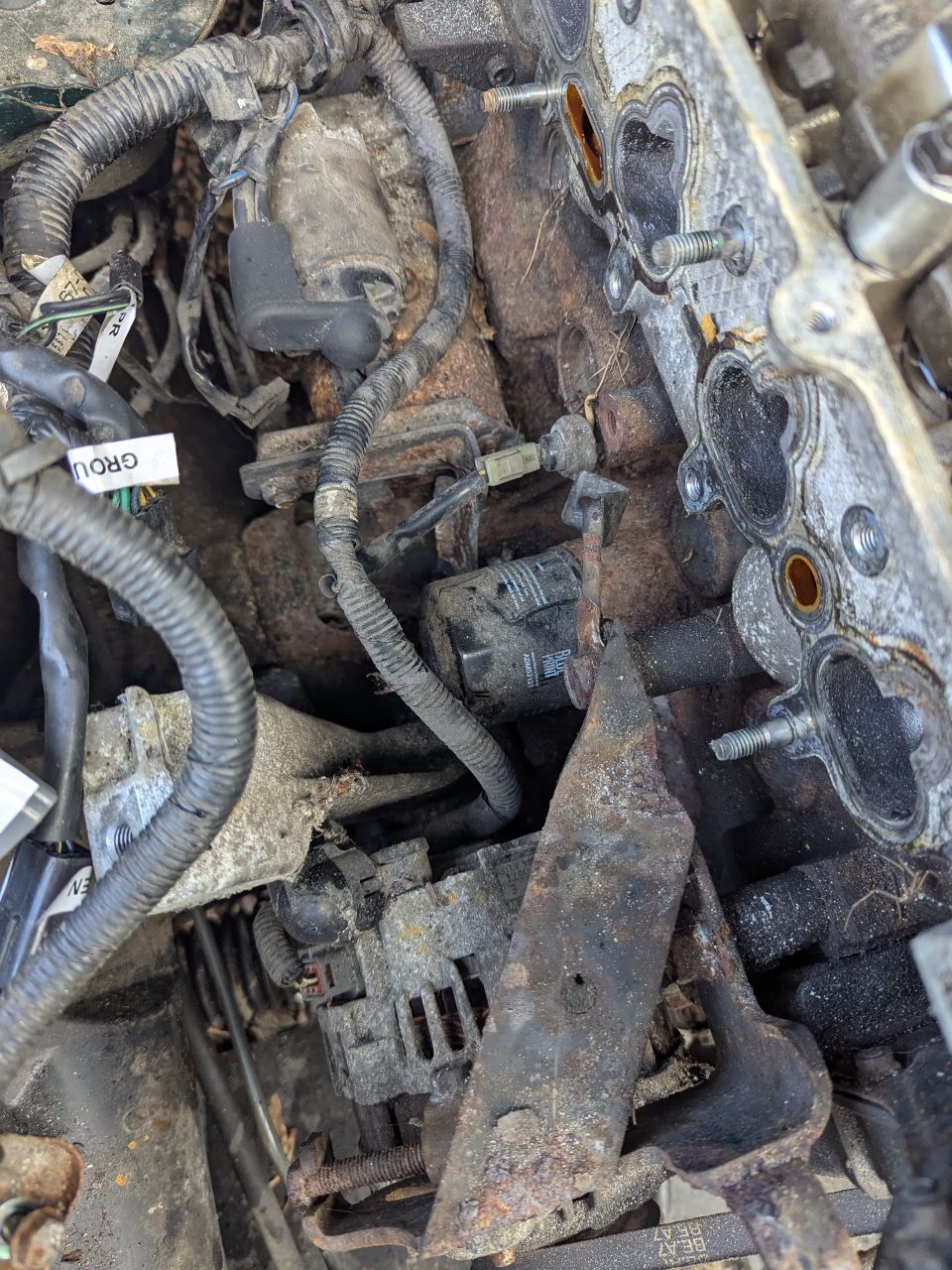

Continuing the dismantling - taking all the good bits off the green one
The rad is scrap but thats no issue.

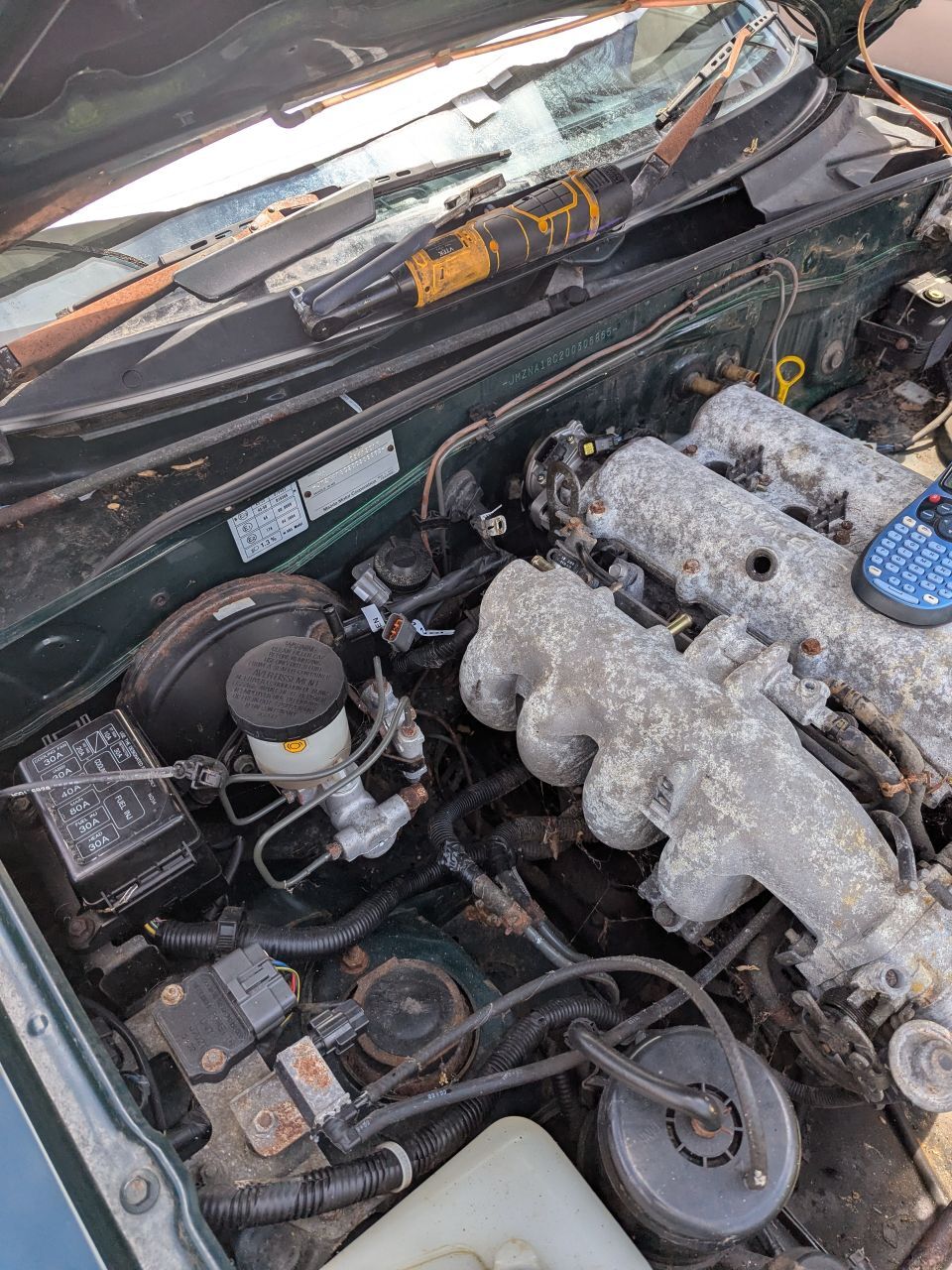

I need to swap back the TPS (just going to do the whole TB whilst at it). Removing the cam cover as when I get a chance I will clean and paint it.
I had hoped to remove the exhaust manifold, but it is rusty boy - so a shiny 421 was ordered yesterday and arrived today.
Tried to be good and label all the electrical connectors incase I need them.
Parts that came off were bagged and tagged.

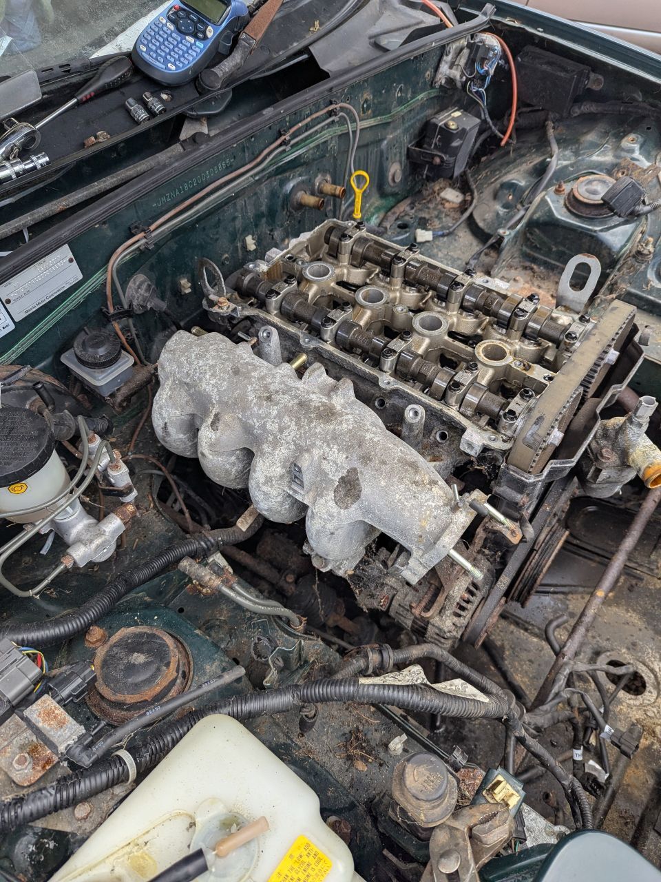

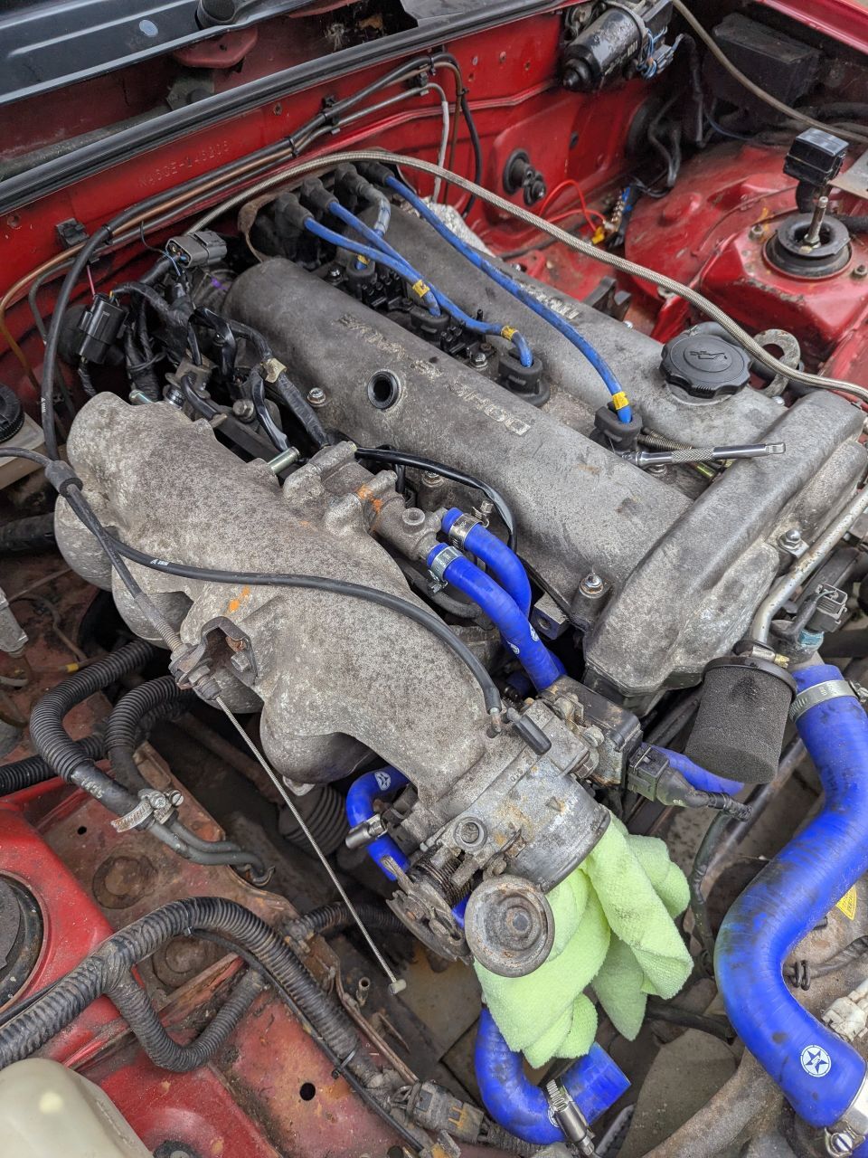

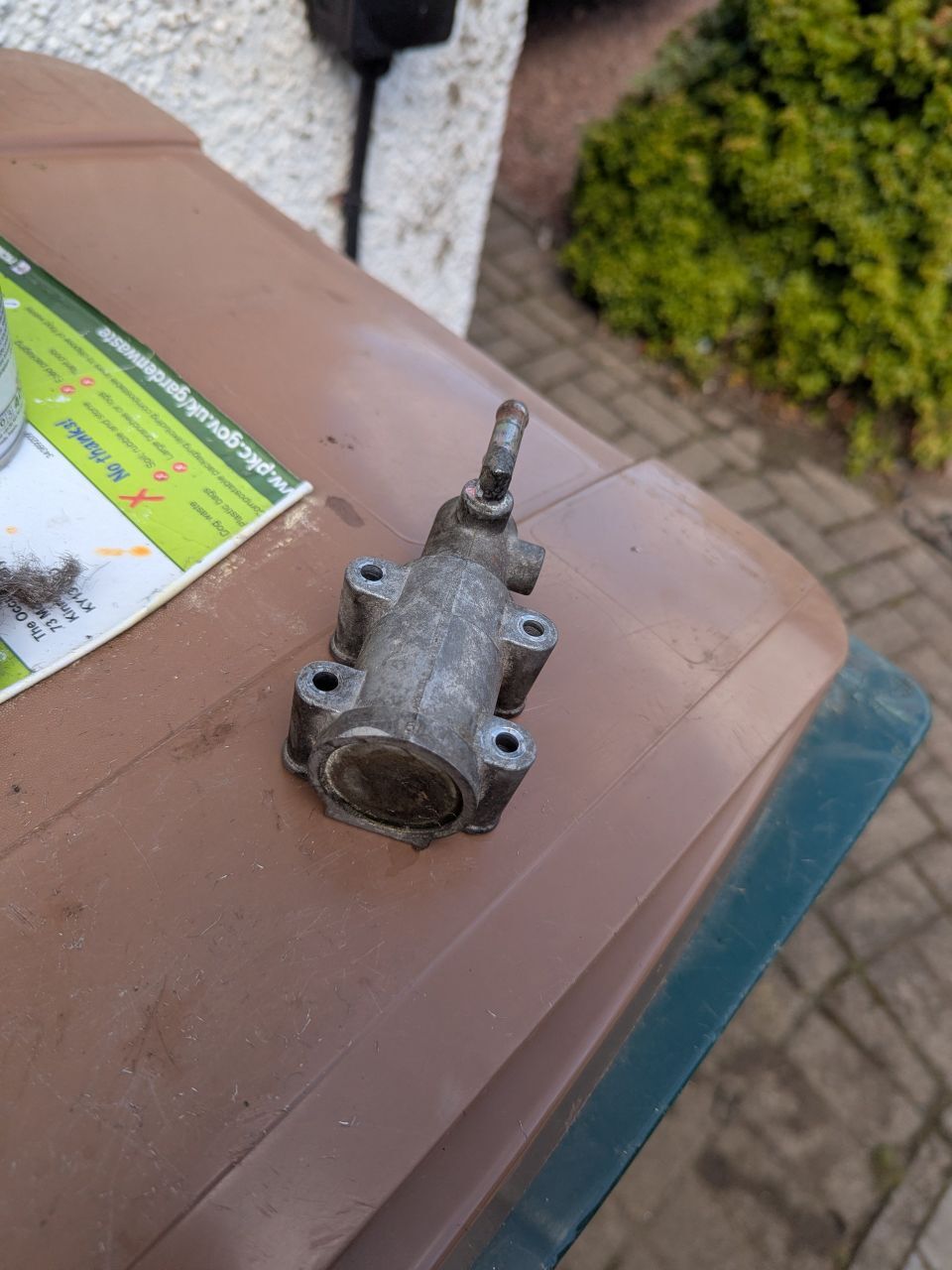

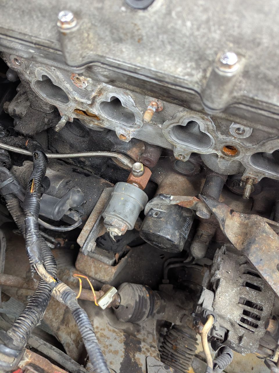

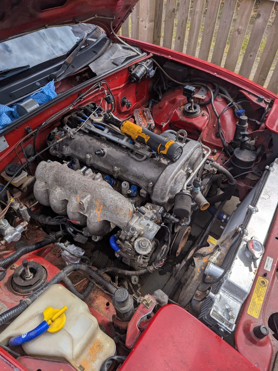

I stripped off the inlet manifold as practice because I need to blank off the oil line feed on the turbo mx5. Easiest way to do that seems to whip off the manifold and get full access.

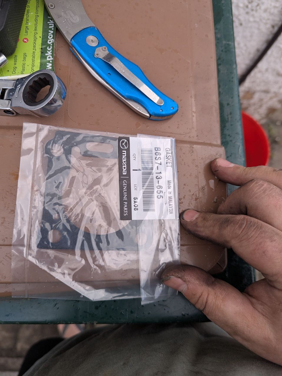

Placed an order for gaskets for inlet manifold, air idle control etc.
Next steps are to remove inlet manifold on red one. Blank off oil feed - then refit it all with gaskets. Then fit injectors from green one and ensure the left hand side is all buttoned up.
After that is is to seal oil drain from turbo, swap out ECU, fit headers, swap over O2 sensor and extend the wire, fluids then try for a start.

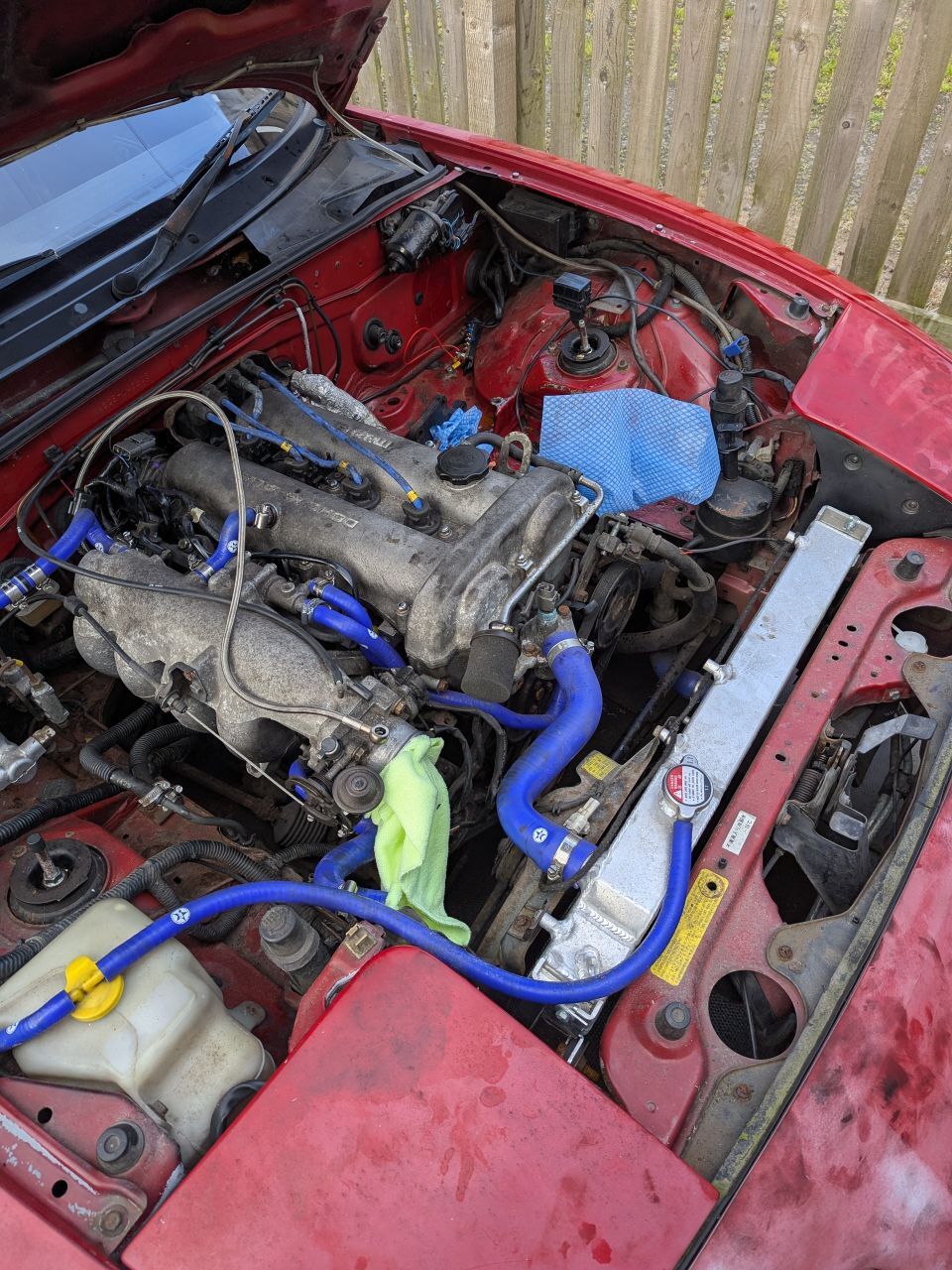

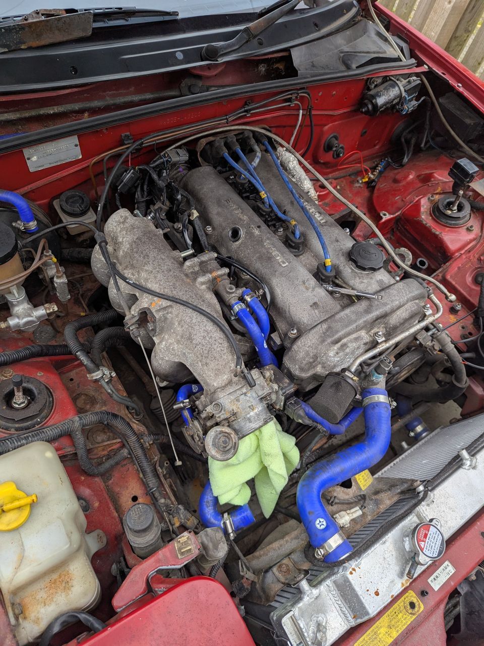

More stuff is happening

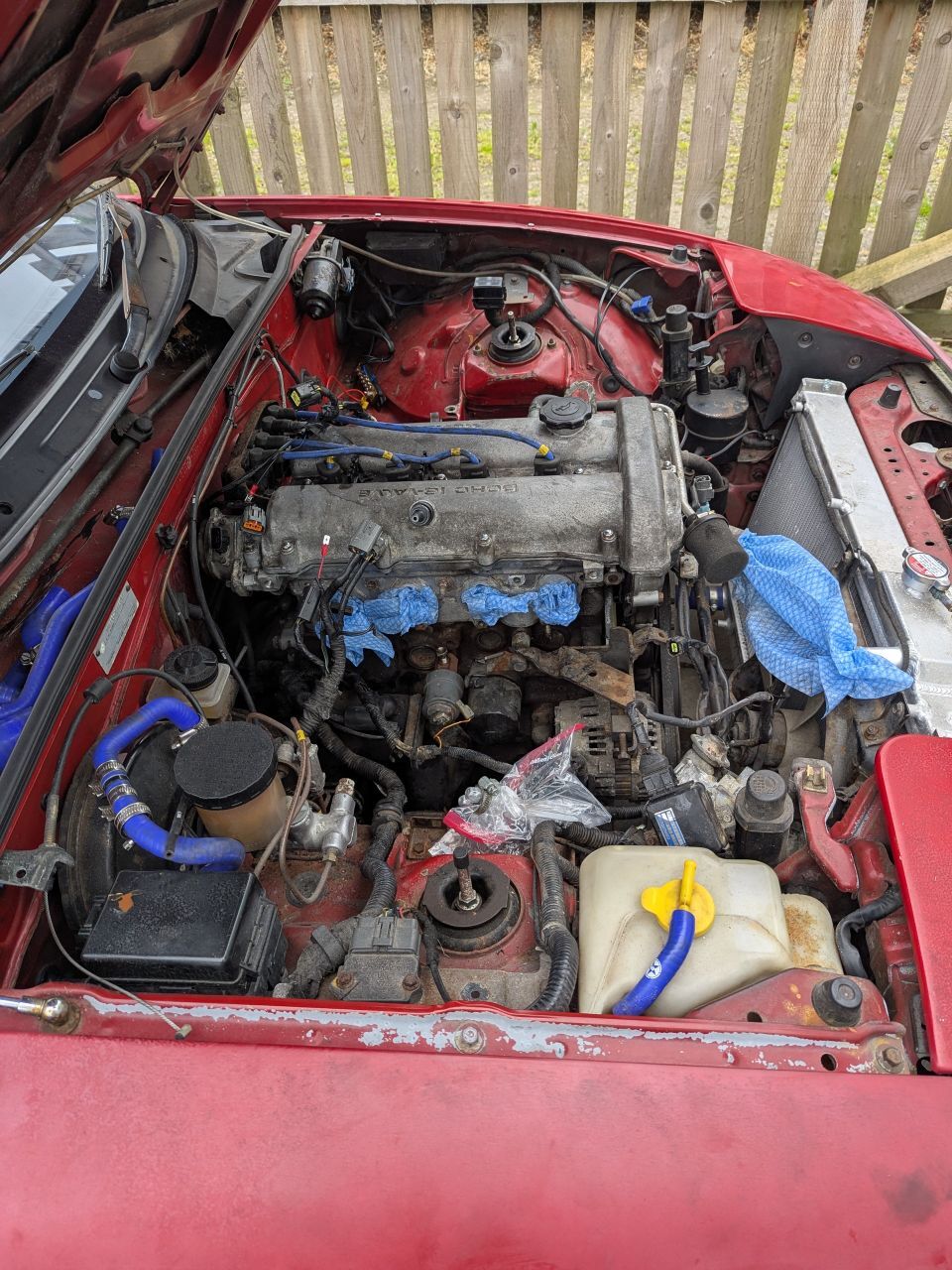

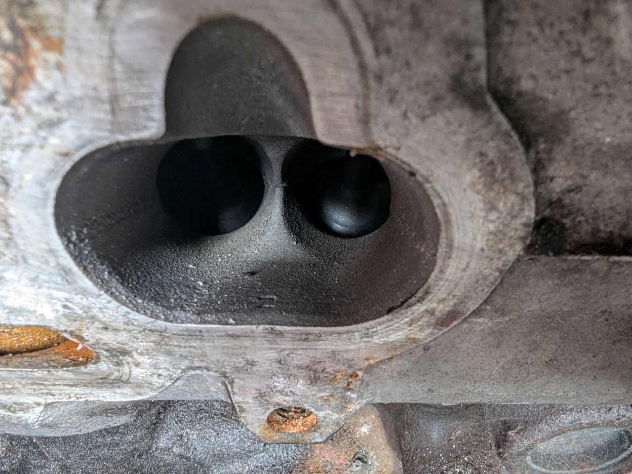

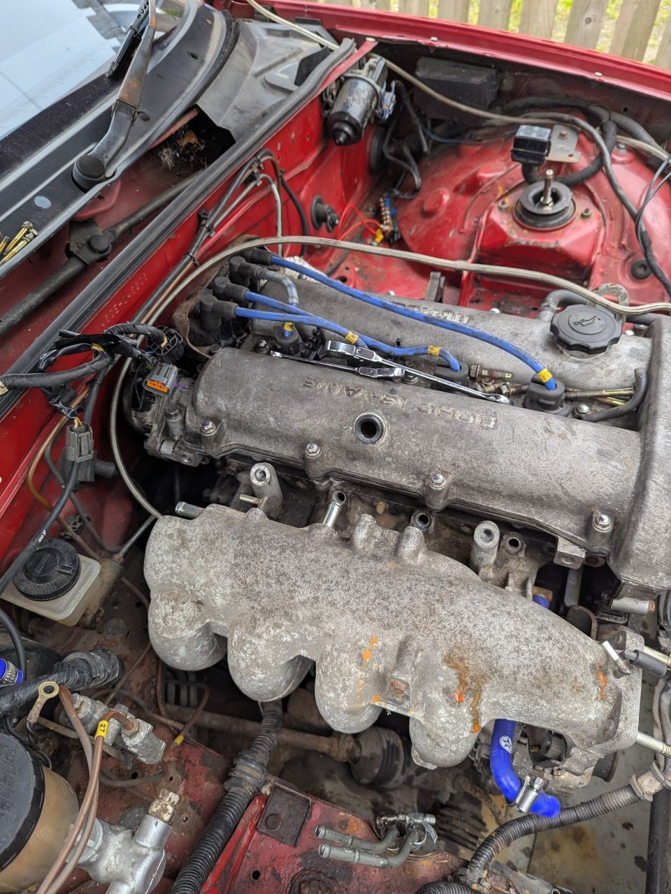

Took off the inlet manifold, removed the oil feed to turbo.  I was hoping to stick an oil temp gauge in, but decided to just go with stock for now.
New gaskets for throttle body, inlet manifold and Idle control. Swapped in the injectors from green mx5 so they are back to standard.
Refitted all of the inlet side loosely to check I have got all the hoses.  Had to cap off the feed to boost gauge, but I think it is air tight.

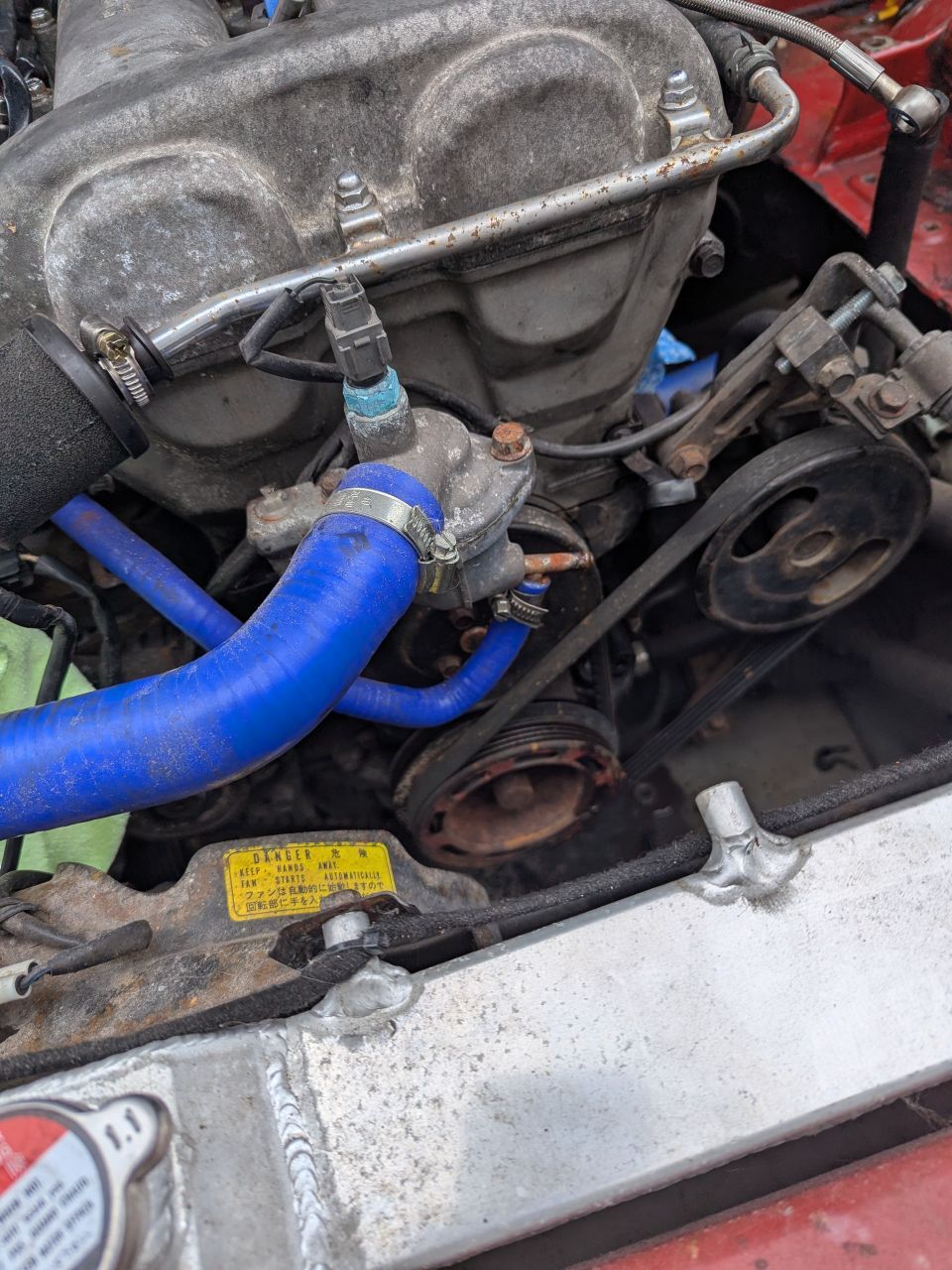

Back to mx5. Next up was off with the turbo exhaust and on with the new header
It looks really punny!  I am awaiting a couple of silicone blanking plugs before trying to it's first na start in a while!

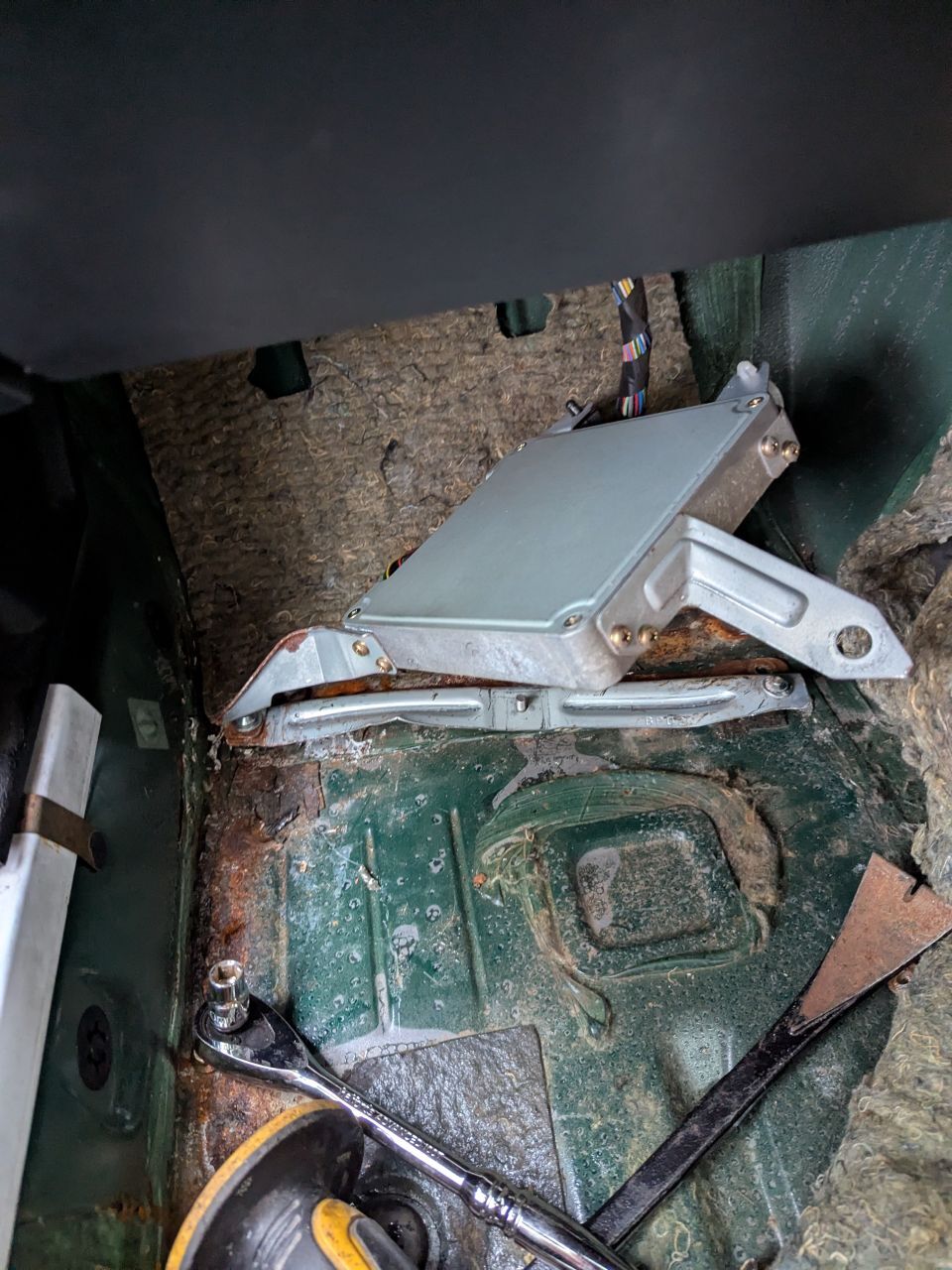

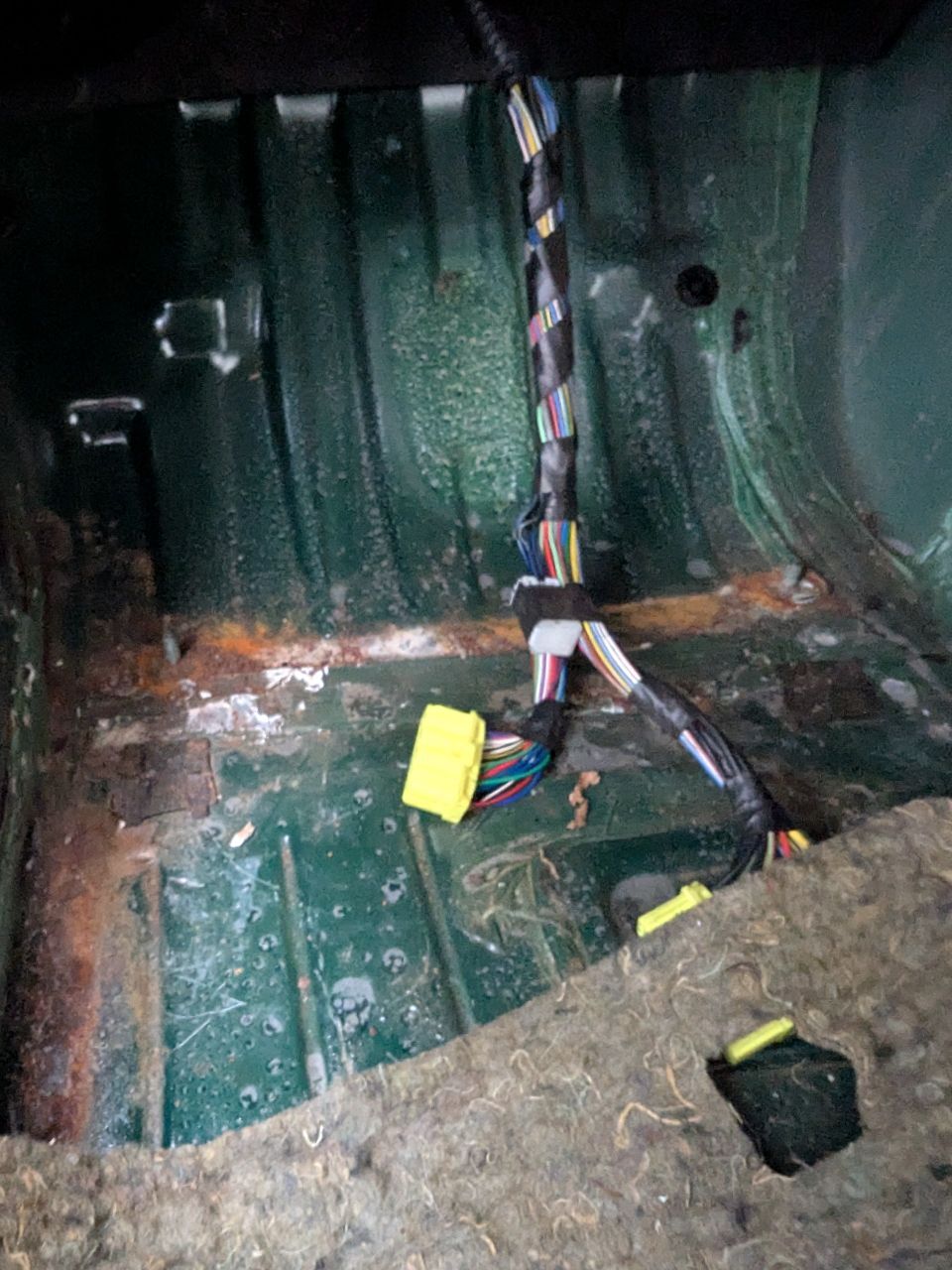

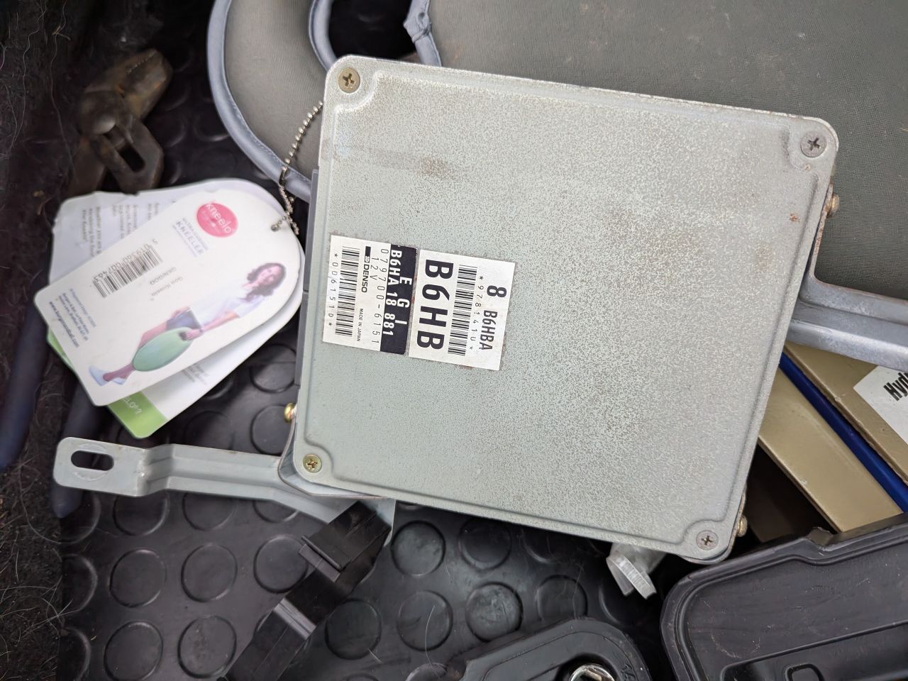

Final bit for today was whipping out the ECU from the green meanie. This is to be transplanted into the Red one.

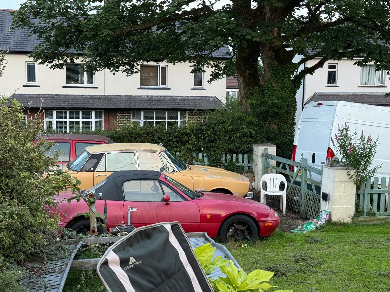

The green one is rusty everywhere, so definitely not a saver.  In comparison @Fat_Pirate must have don't a great job looking after it,  as the red one looks only a bit surface rusty underneath.
Fingers crossed we can get it back up and running this weekend.  I will need to sort out an exhaust from cat back, as the 3 inch one hangs far to low for any autotesting.

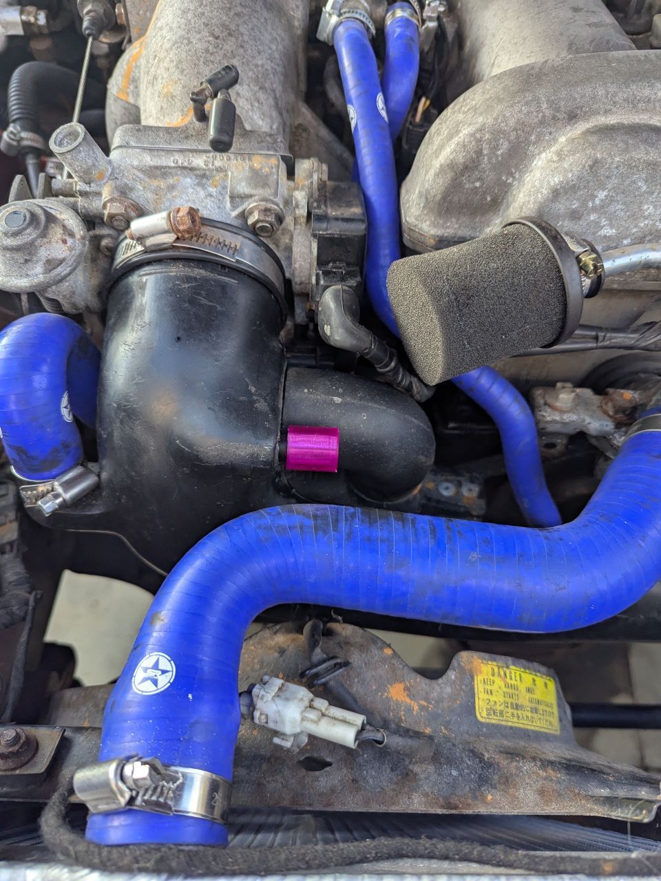

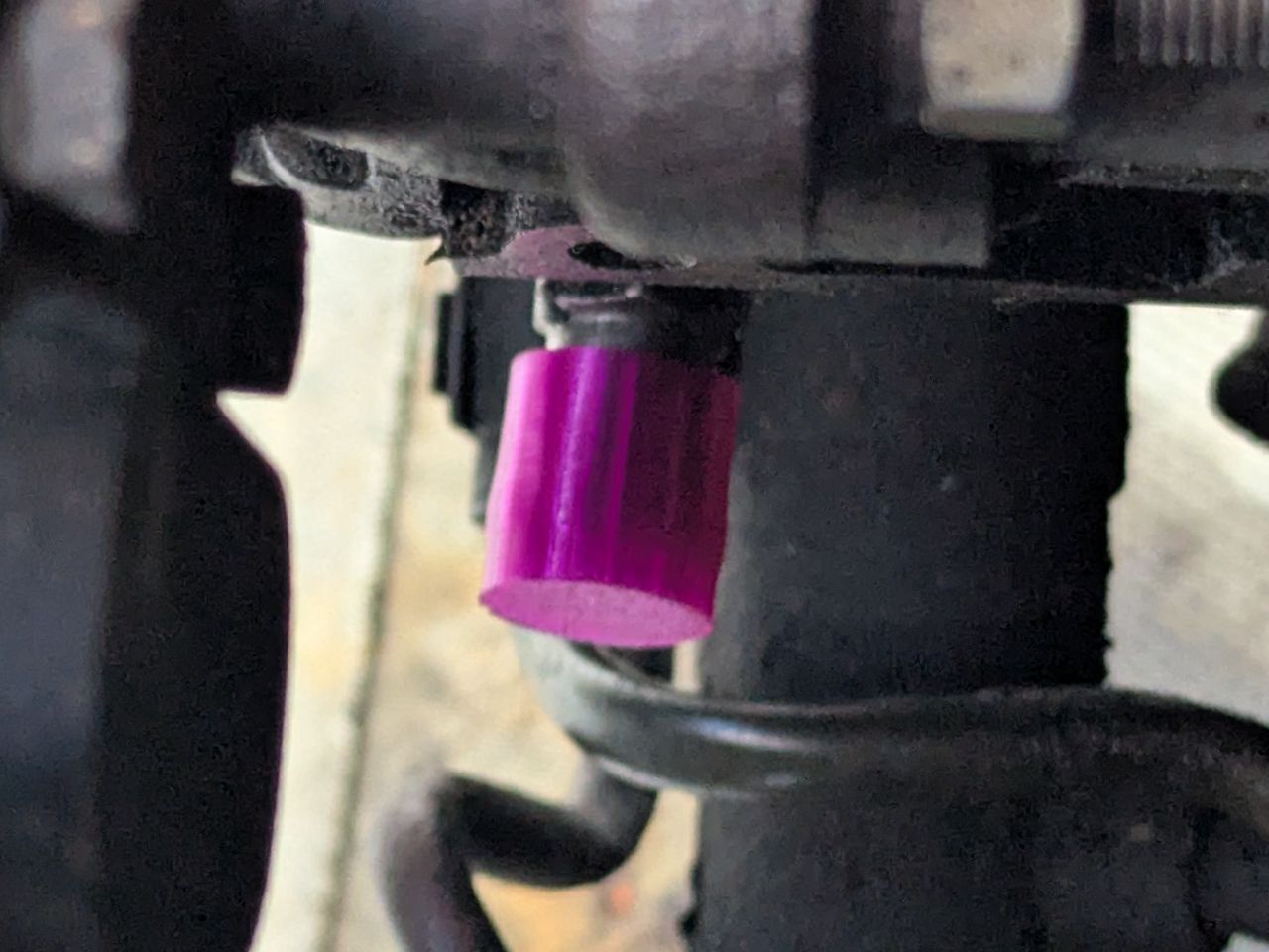

Time to fire up the 3d printer.  I have been waiting for silicon blanking g plugs, but for now I have printed some in TPU.
Measured then modelled in Tinkercad.  TPU filament and took a total of 20 minutes to print both

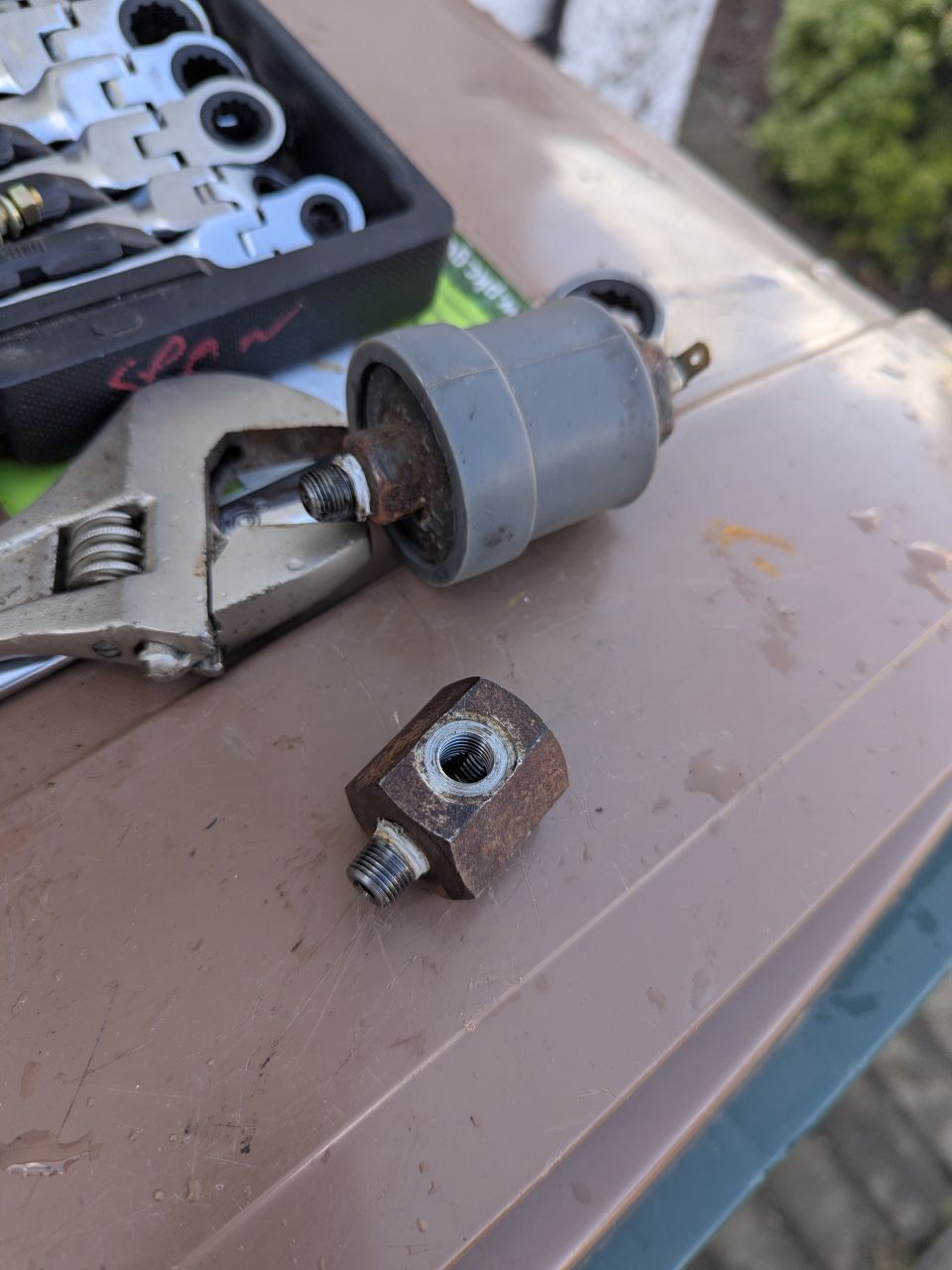

Using the nice weather to address the failure on St170.
First up is my new toy.  £130 from eBay delivered.
Stuck suspension bolts are no hassle.  It has got a quick disconnect to swap coils.
Old one out in about 30 mins
New and shiny
Need to do a boot clip then swap over the power steering pump ready for MOT on Sunday.

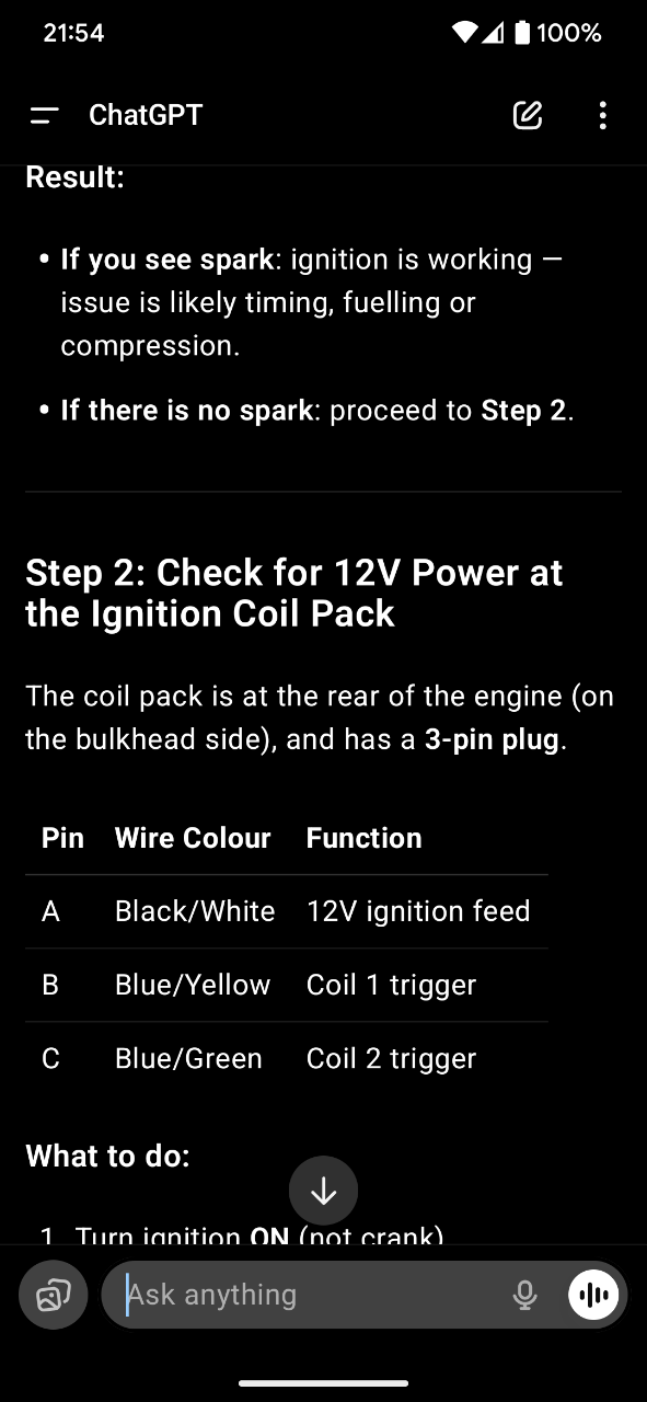

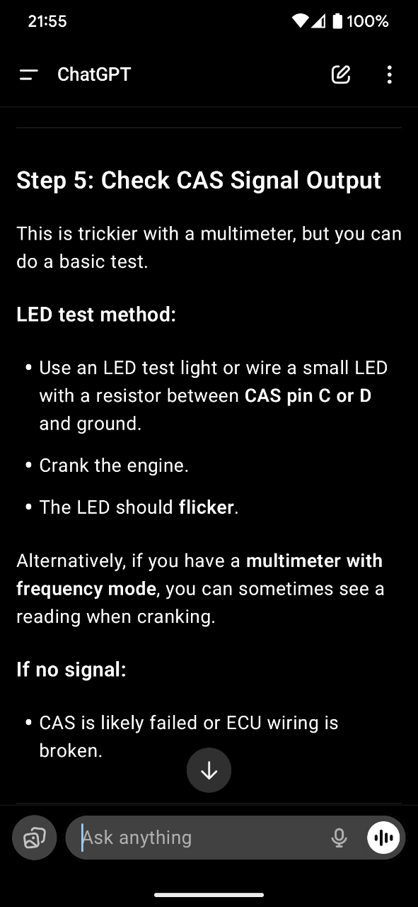

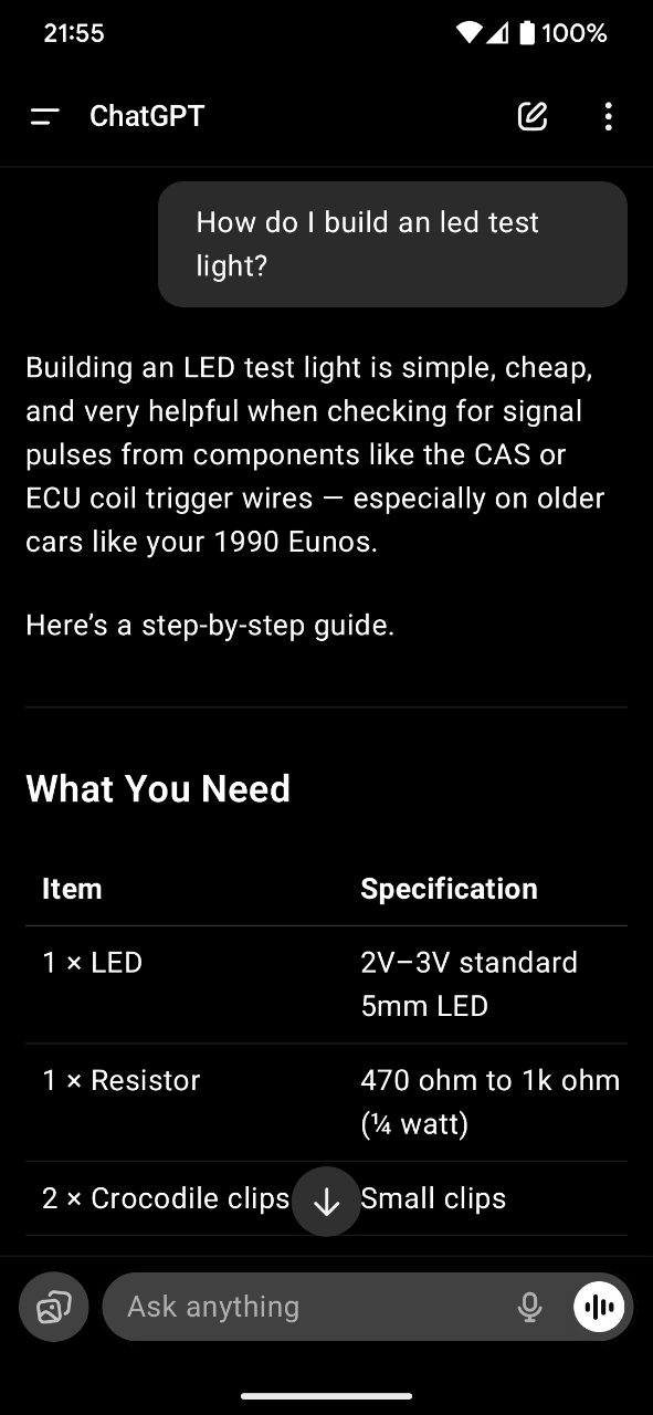

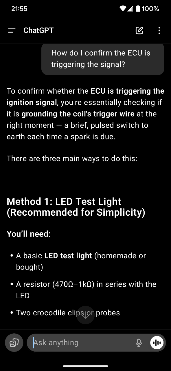

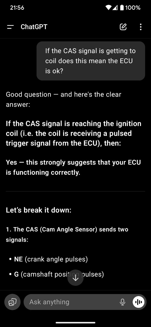

After work today I decided to have another stab at mx5 diagnostic. I suck at following step by step instructions - so I decided to try something new. I fired up chatgpt and got it to create a work plan for me.
It's really useful (assume the UK information is correct).  Gave me loads of instructions and I could ask stupid questions to check understanding.

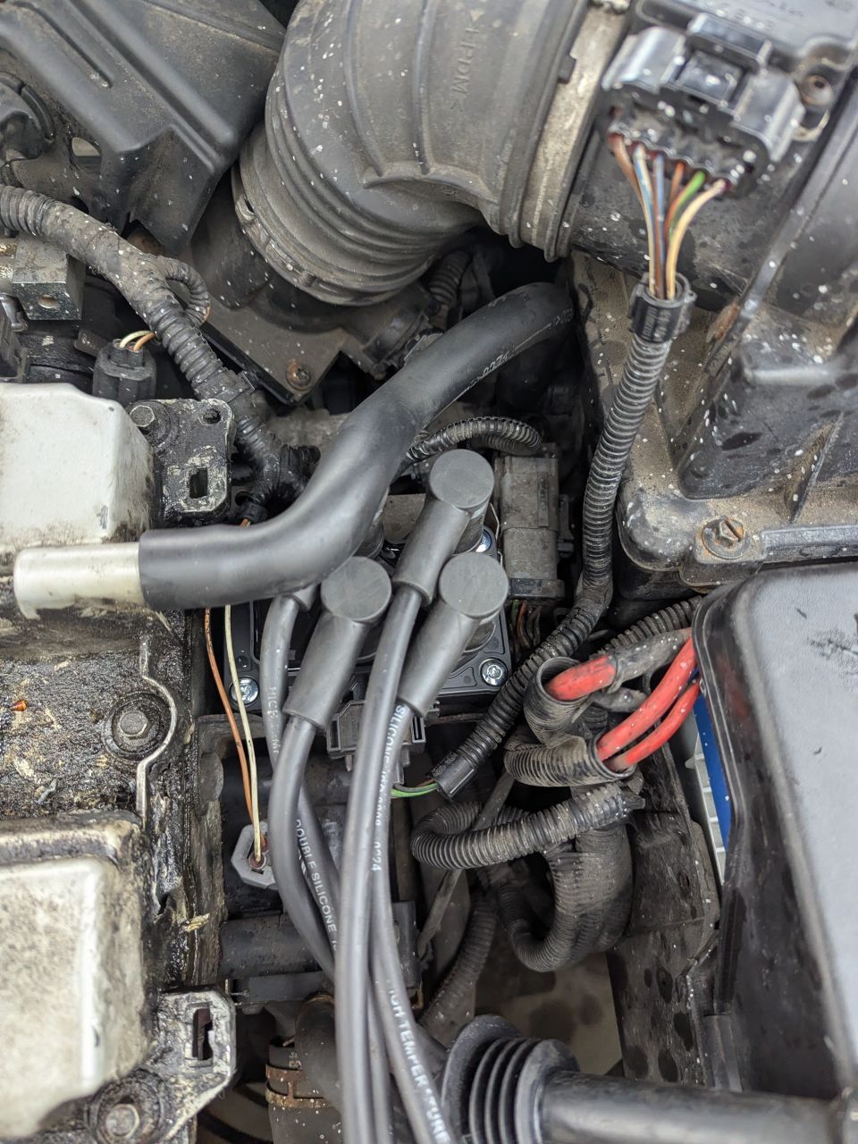

State of play is that there is definitely something up with coil pack - when I took it off one of the coils was roasting and the other cold. Ordered a new set Nd also new HT leads to rule them out.

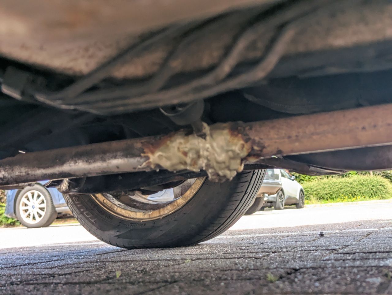

New car in .. a cheeky eBay purchase which required a trip to Galashiels.
PXL_20250802_095531986.jpg.771263cf30ab66ac2f5dc9d1217e4071.jpgPXL_20250802_095556718.jpg.d15b3ad7be6106e61742bc42f15fa80d.jpg
Faults are noisy exhaust and airbag light on. MOT till November but at £500 didn't think it was too bad.

Seamless exhaust repair
