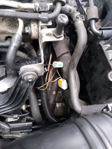

The boring golf has been throwing up a MIL which when scanned said diesel temp sensor
New one is duly ordered
Fitting
AHH might have found the issue.
Secondhand sensor with wiring ordered to try and fix it

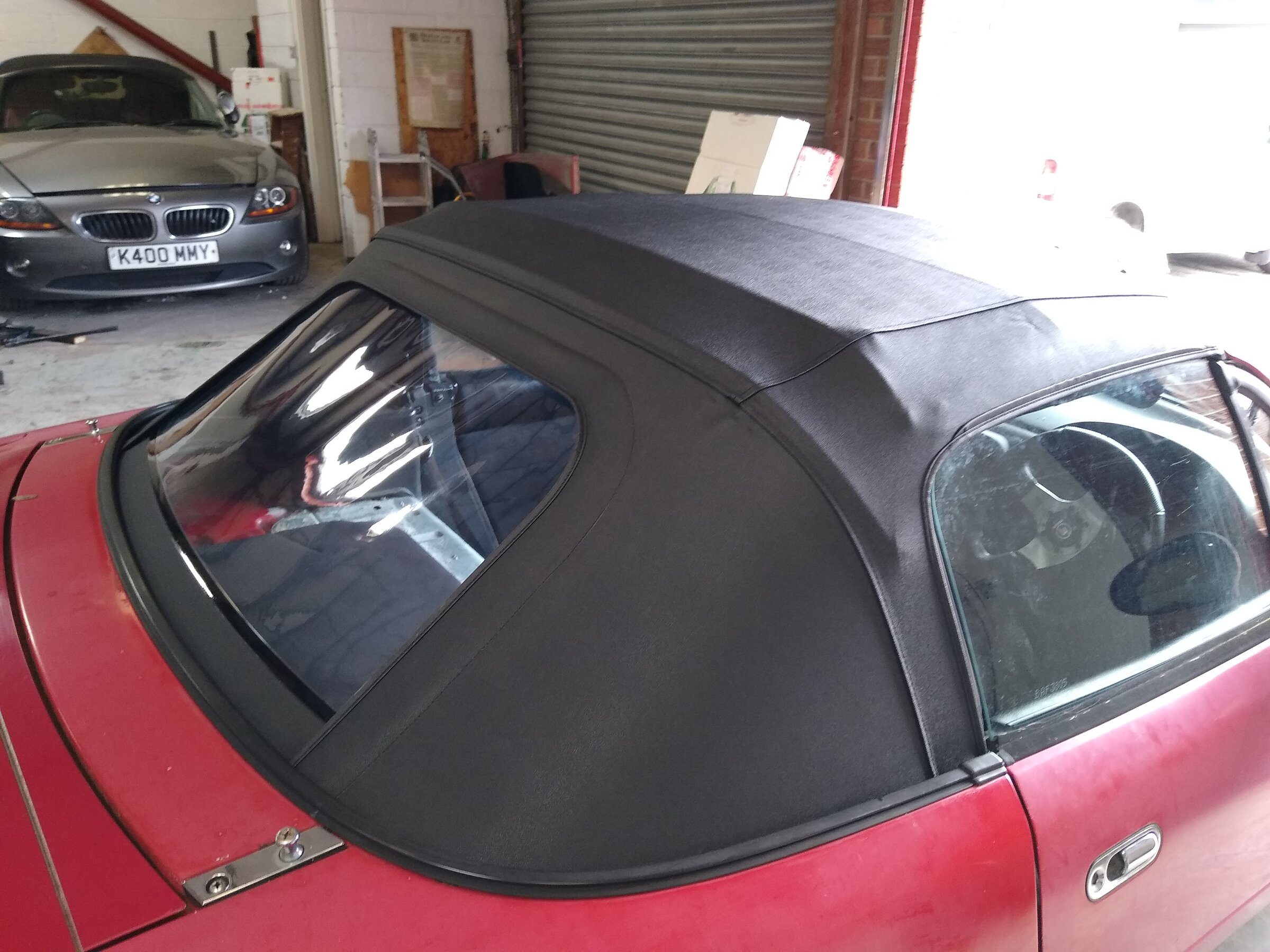

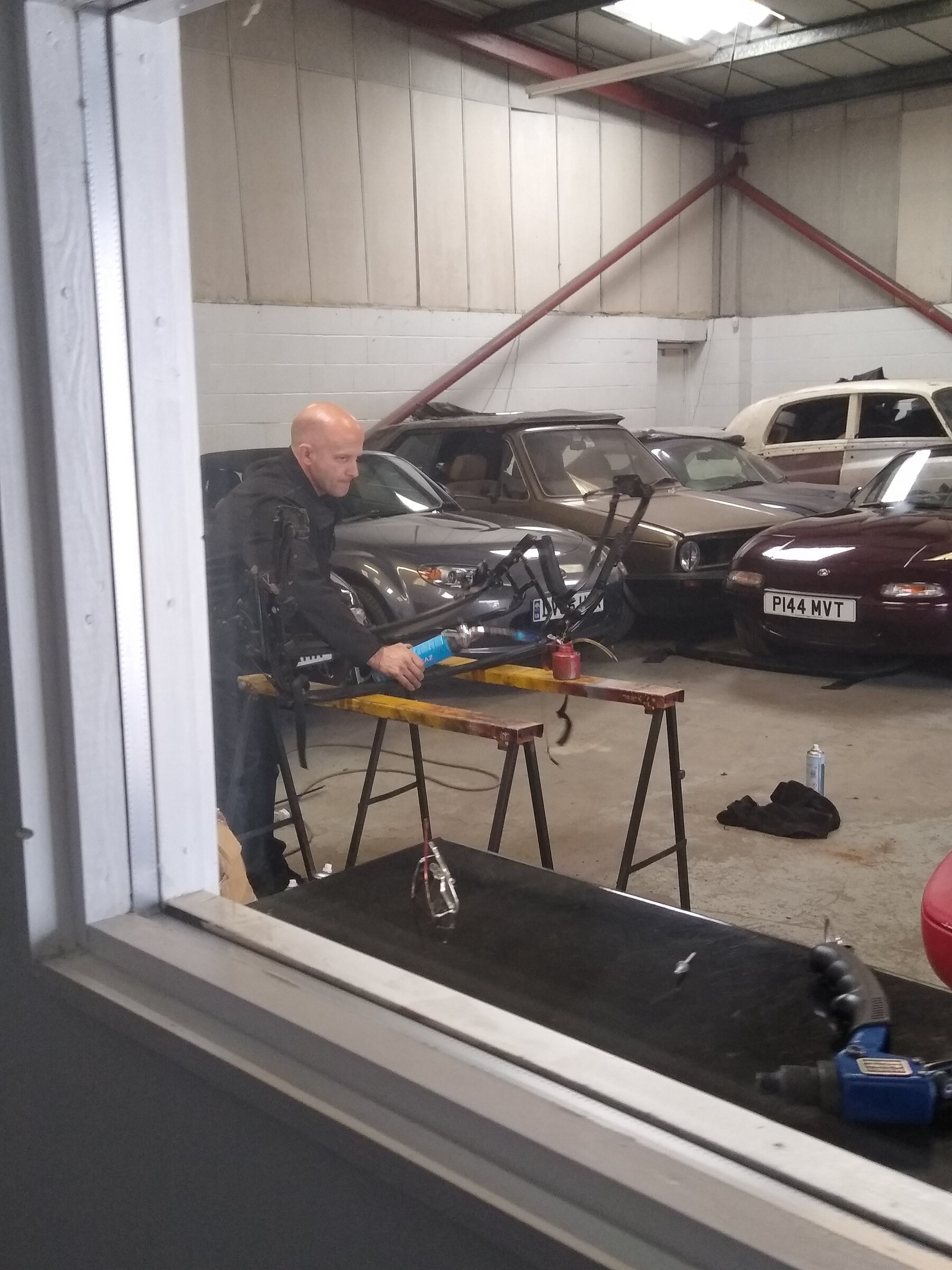

How to fit a new hood to an Mx5.
1) put the kettle on
2) make a coffee
3) take a seat
4) let the expert do it
IMG_20190503_135700882.thumb.jpg.311cec12dcb8c42fbc1f72850dfd1470.jpgIMG_20190503_143428581.thumb.jpg.e50b7ae75b62cec502e49d0274786bdc.jpgIMG_20190503_150711413.thumb.jpg.ad42f02128edb2912ef0ea288250ee3b.jpgIMG_20190503_150738105.thumb.jpg.8fa143cbca056dd7723da7510250820f.jpg
Poor little thing.
It’s like watching an episode of Supervet where Noel Fitzpatrick gives a worming tablet to a stray.
is he taking a blowtorch to it in one of those pics ?
Yep. Don't know why - whether it was to loosen up the joints or get the old glue off.

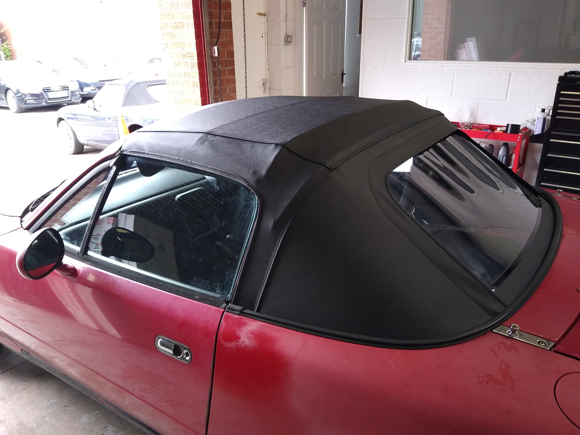

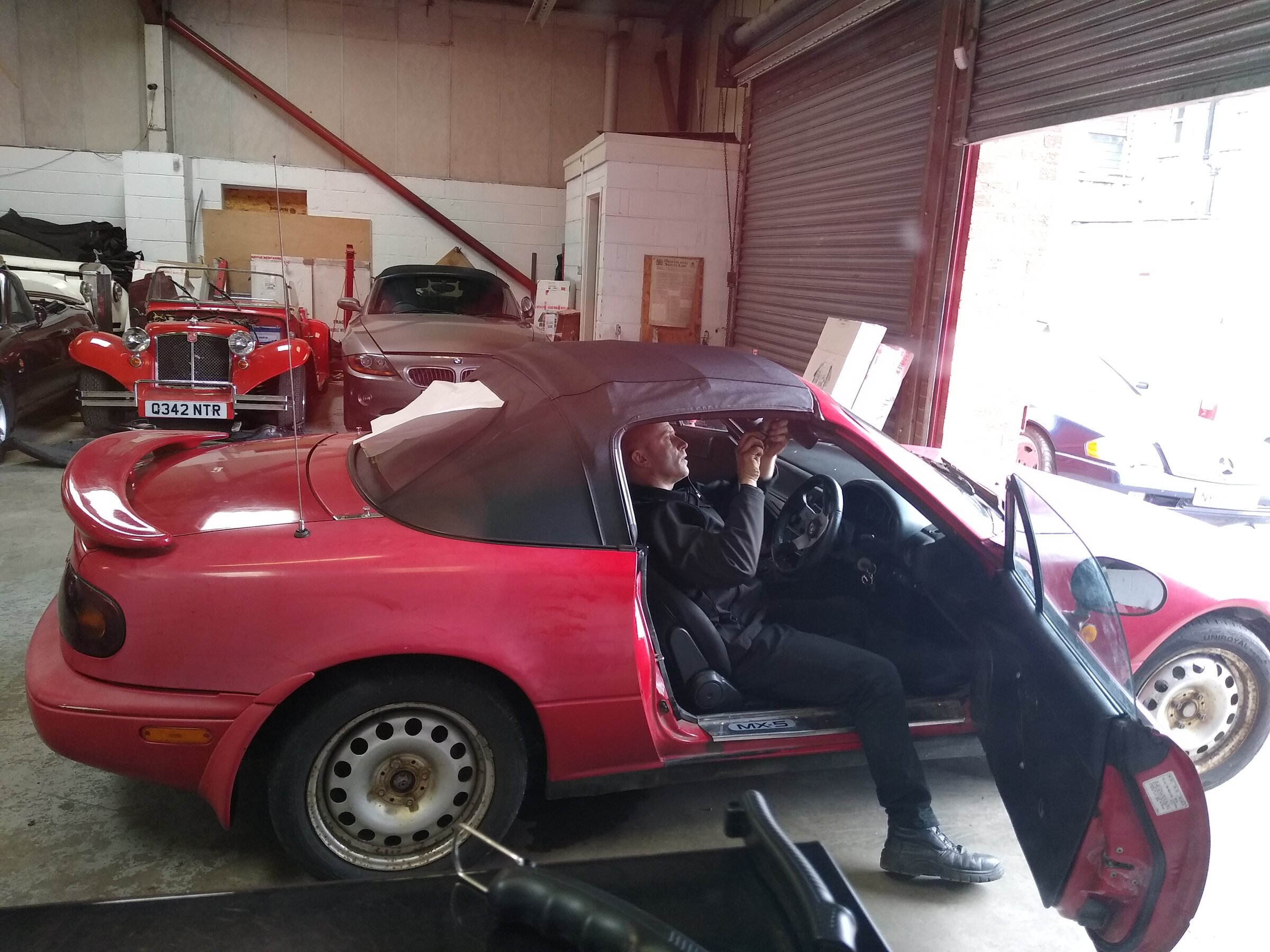

Some more pics of it being finished
IMG_20190503_155702434.thumb.jpg.74675fb9934771e35d69fceb65ad2fc0.jpgIMG_20190503_160723022.thumb.jpg.a26e1b2b4018556fb007cdfc53e1cc85.jpgIMG_20190503_162333706.thumb.jpg.e247a997ad250227d4eefeaa676541fd.jpgIMG_20190503_163419404.thumb.jpg.cdce8dae215d3292e8cfb93d24b21e06.jpgIMG_20190503_163424323.thumb.jpg.9756473b3492168cc80636386ddffd4c.jpgIMG_20190503_163429581.thumb.jpg.5db4c4ba2f4f9a3272b8bbe109de4143.jpg
Comes with 2 year warranty - need to keep it up for a week to stretch it.

Golfs turn today.  Firstly the secondhand sensor turned up for the diesel temp sensor.  The old one had sheared off so ordered a whole sensor off eBay. There are two wires to the sensor and I wanted to connect it for now to check I have got them right way round so waygos applied for now.
MIL is out so will see how I get on and solder/heat shrink them later if they are the right ones.

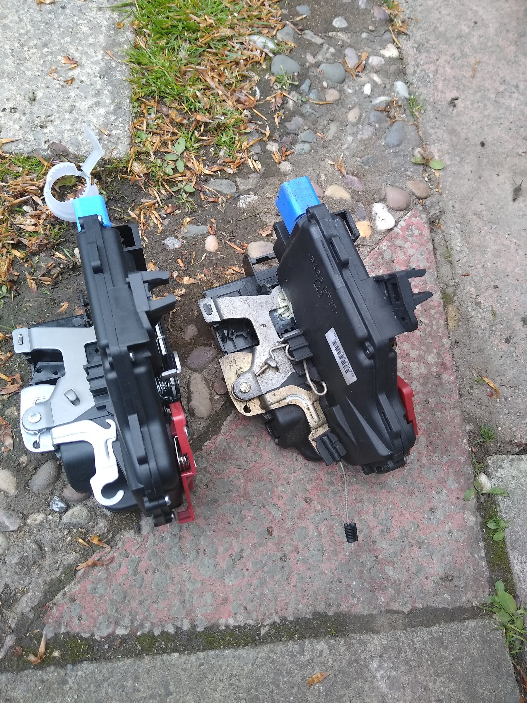

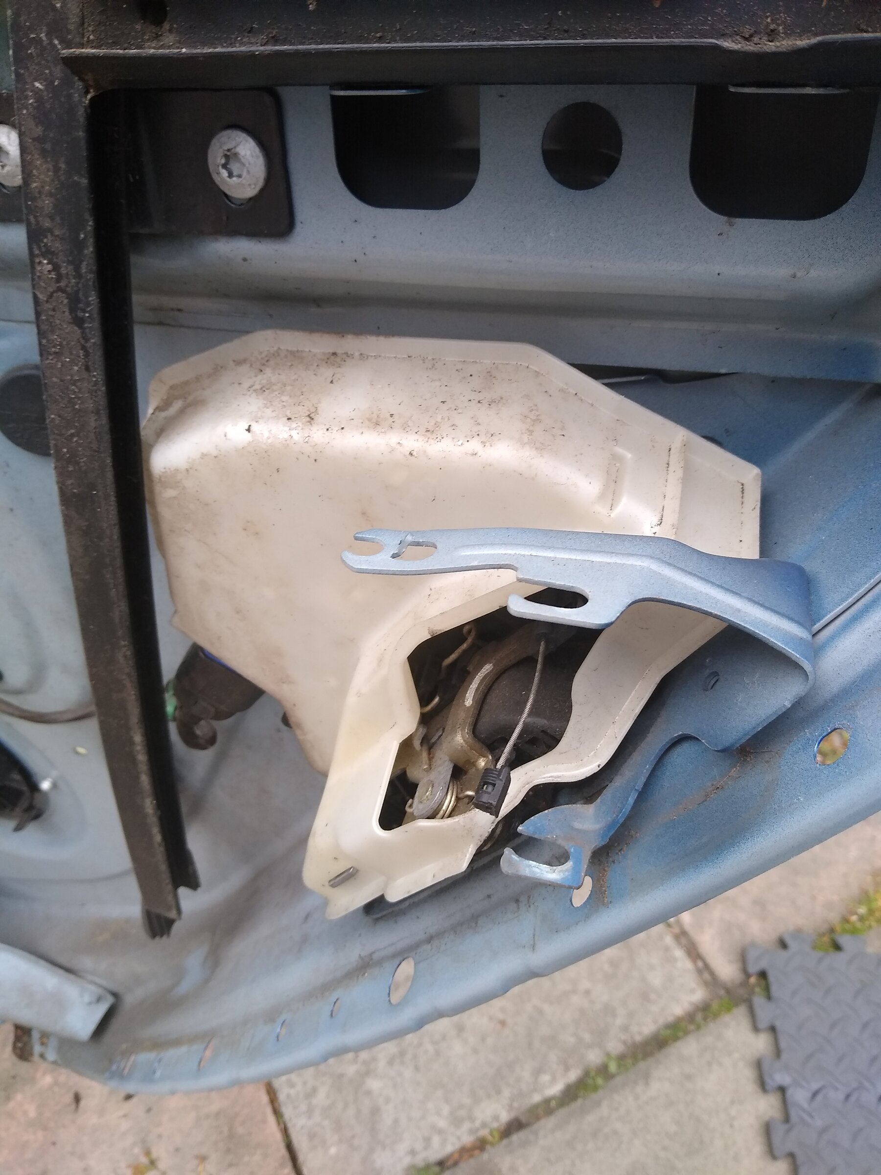

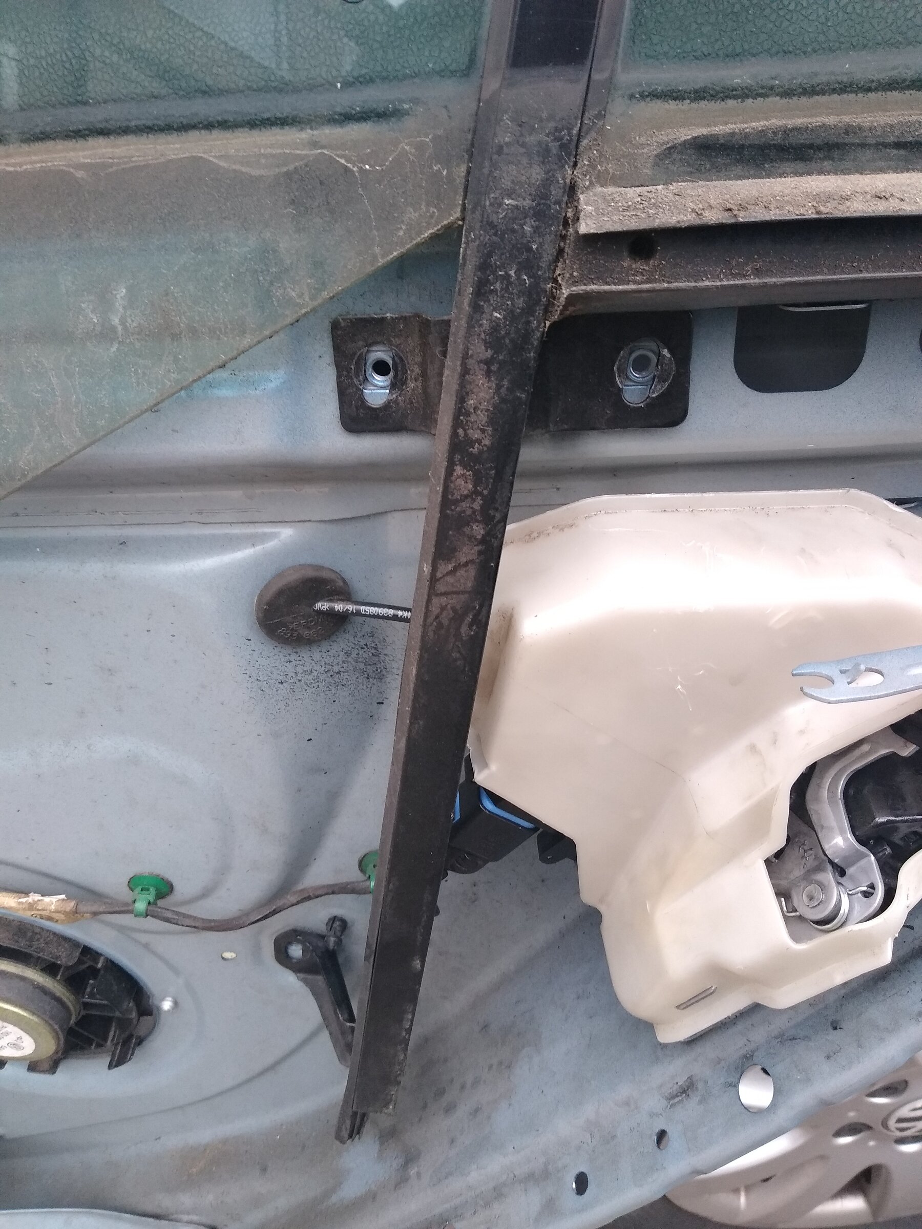

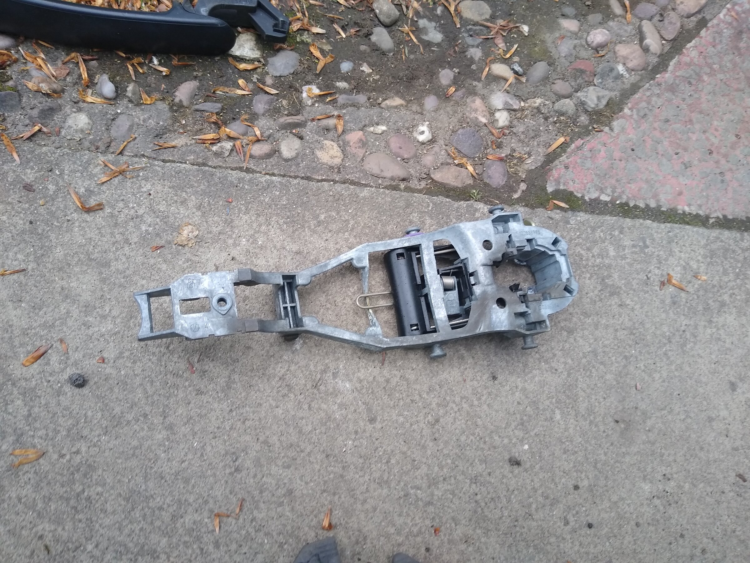

Next up was the door locks.  The rear passenger door didn't lock and the drivers side would lock on the remote but not unlock.
Door locks are cheap at £18 each which were delivered during the week.
Interestingly you take the door skin off rather than the interior.
The first door took over an hour with fiddling.
One of the door bolts holding on the lock rounded so I ended up getting tools on it.
Sadly I had just bought a new aldi angle grinder (it was cheaper than a 5amh battery for my Ryobi one) so that got thrust into action. Finally got it out and need to get a new one.
Put all the door back together then found some missing bits so had to take it apart again, then I couldn't get the weather proof cover on so had to take the window bolts off.
Driver's side one took 15 minutes - even with one of the bolts rounding (used chiesel and hammer this time) anyone want a hand doing a Mk5 door lock I am your man. They are a piece of piss!

You take the door skin off?? Wow.  That’s almost Citroen levels of weirdness.
It's odd but in lots of ways it works well.  You aren't trying to get things through small sharp openings.
Now I have got the knack it is a pretty quick thing to do.
News to me that you can remove a door skin like that. It looks kind of creepy with the door closed like that with the skin off! Very interesting!!
As above, that's really weird but at the same time looks to make things a lot easier.

It looks like the cover of a Haynes manual!
If it works it can't be too bad, and it looks better that feeding your hand through an apature in the door from the door card side, and contorting to reach something that's obscured by a reinforcment beam or window regulator.
