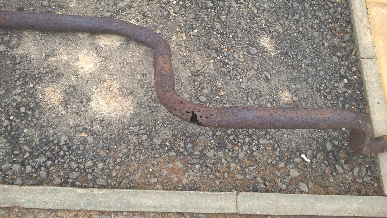

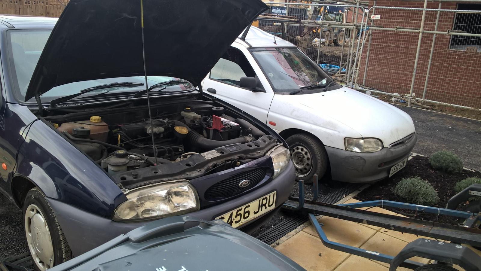

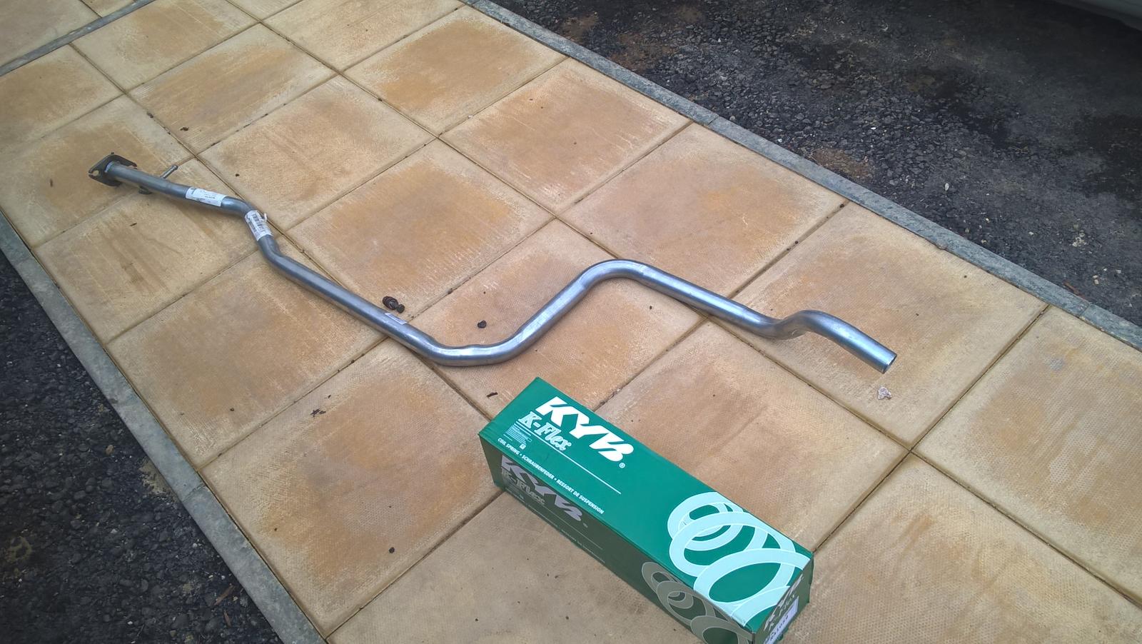

I've not had a car this cheap in ten years and even they had no mot and were looking very ropey. I picked this up yesterday from a deceased ladies family. I have had a good poke and prod underneath and I'm pretty certain the mot tester was trying to pull a swift one. I have bought a new centre pipe and front spring up today for 35 quid all in. As it stands the total so far including recovery costs to my home and purchase of car and parts is £80. Hopefully chuck it in for test this week. No oil leaks on it,new oil filter and clean oil says it was serviced not long before it went in the garage. Also one of the rear shockers looks new. Next installment is spring change.

From the MOT history, a clean up of the brake pipes and some new suspension bushes could help!
Excellent pot there, Bub - a proper car for the price of a curry.   Looks like it started life down in sunny Bournemouth so hopefully has not had the full number of salty winters thrown at it.
I had one of these, the price of parts is silly cheap. Dead easy to work on with the exception of the rear suspension arm bushes.

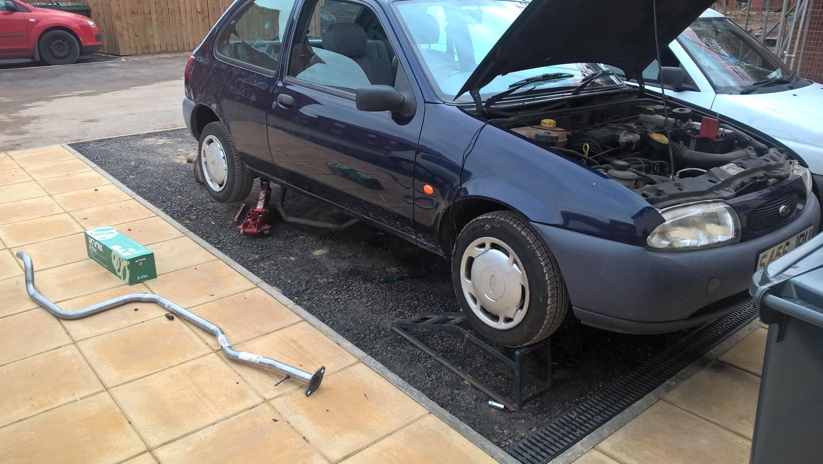

I don't understand what you mean? Excuse me for being dense. No axle stand on that pic just the jack but that was only for clearance to remove exhaust. It has front end on ramps and did have chocks under wheels when removing exhaust.
Well , do they have mcpherson struts  on the back? I thought it would just be a beam axle , springs and dampers?
Are you ok for Spring compressors? If not you can borrow mine if you come get them.
I'm hoping I can find mine mate but ill bear you in mind. I have used ratchet straps before and also removed a spring without any when I was young and daft. Never again!
Lots of heavy things in the boot  ..cable ties round the coils.... jack up.. springs fall out ..sorted .   :-P
Please put an axle stand under that rear end before clambering under (hopefully there's one there and its a trick of the camera that make it look like the rear is just on a jack :shock: )
Good luck! :)
You're obviously new here. He doesn't have to be careful. He's lucky.
