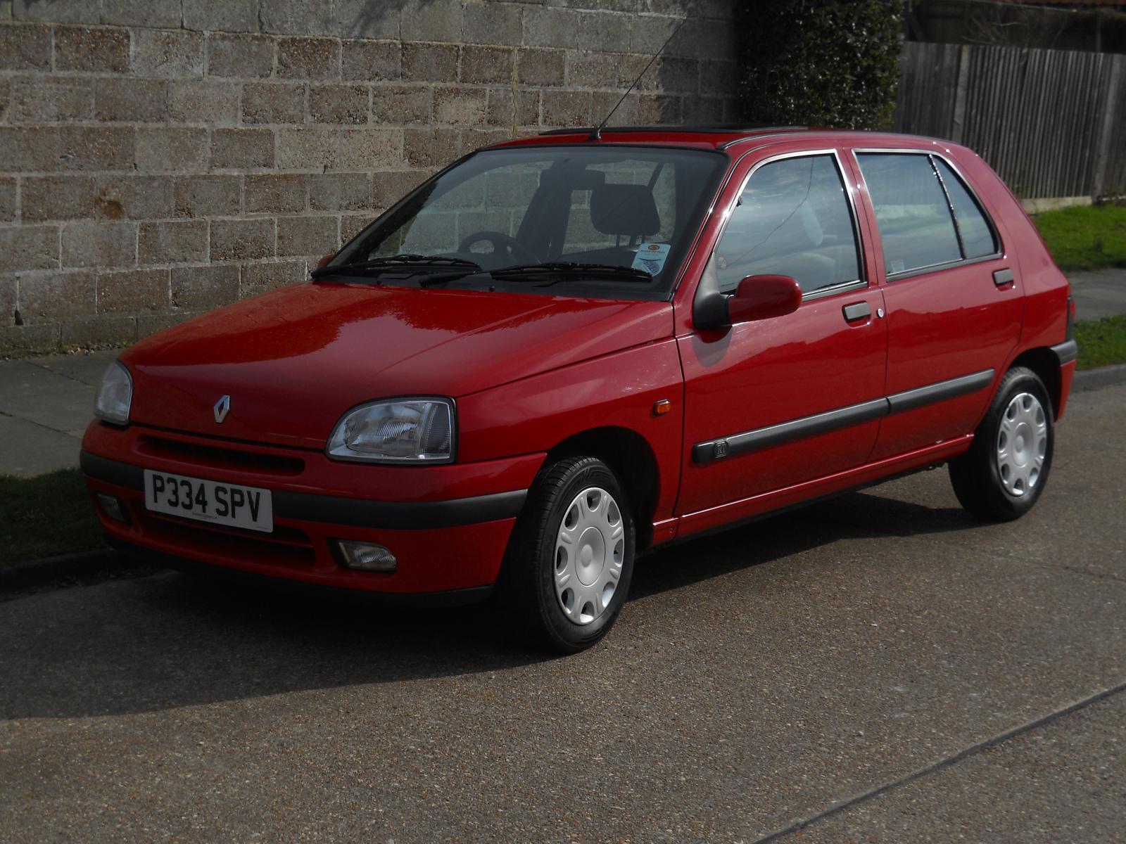

I hate Renaults but I'm loving this..
The boss had this taking up space and wanted shot, offered him £100 on the basis of if I put it through an MOT and it wasn't too bad I'd have it a cheap run-around and hopefully get the missus driving.
It's been parked up for about 8 months since he had it and not moved at all.
It's a Mk1  Auto RT 1.4, and a propper old giffer car, currently has 45k on the clock and fully serviced up to 39k and only done a few k between MOTs and services.
Chucked the booster on and it fired straight up, took it for a drive a few times around the yard with the handbrake on to scrub off the brakes and it's brilliant.
I've always hated Renaults but I love this little thing, surprising comfortable and quite nippy even for an auto.
Took the what looked quite new but left for 8 months Bosch battery and bunged it on charge expecting it to be deader than dead but no it's holding and charging and starting it up no problem.
Chucked it in for a discount £20 MOT and It failed, I knew it would I just wasn't sure how bad, I was expecting quite a bit despite not really checking it over or even getting it in the air on the ramps.

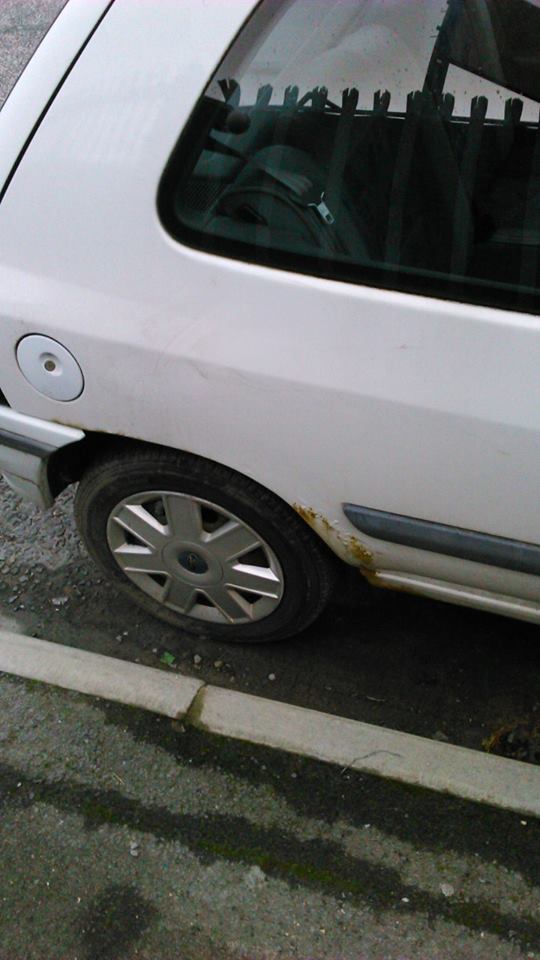

Once that's all done I'll address the little rot and the bad paint, and maybe sort a better interior.
I'll probably try and knock that panel out next week.

Anyway some photies;

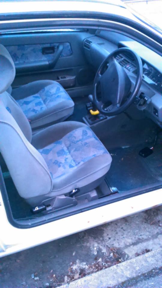

I knew he jumped at a ton too eagerly, I love how it has central locking not on a fob where it would be handy but inside the car and the crooklock is awesome.
The radio cover is great, it has a Blaupunkt stereo that looks original as well.

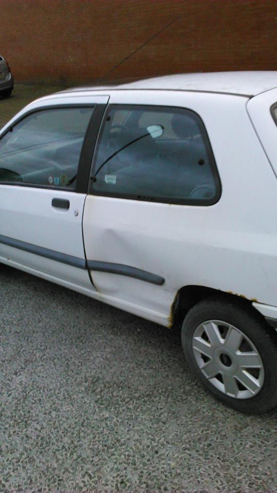

auto argh but rest seems ok
body damage adv when its only a dent and no holes or sharp edges??

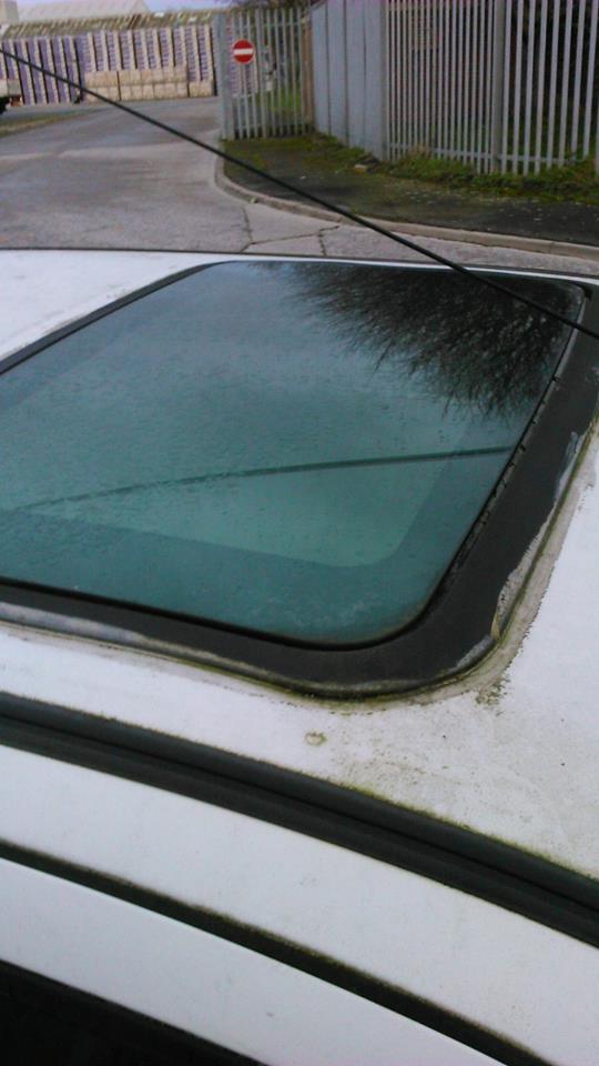

The presence of a sunroof is disturbing.  The immobiliser lives up there in the lining, near the mirror, and is very susceptible to even the slightest water ingress.  Apart from that, good luck!
Surprised it has an immobiliser, the key is just a bog standard metal key no plastic or transponder. There does appear to be an after market alarm of some variety badly wired in that will be taken out asap.
I had to make a structural repair to the wheel arch with gaffer tape til I can get it welded up properly.

Seal the sunroof ASAP. They leak like bastards, into the little central locking pod/sensor dubrey, which is probably why you've not got a plip key, and then all the water falls out onto youir lap while corninering, making it appear like you've pissed yourself. The plip receiver is available - but you'll need to get the keys recoded which cost ££££, so not worth bothering.
I KAN HAZ HEXPERYENSE.
The sunroof on ours is ok, but had leaks in the aerial a few times, fixed with mastic!
The sunroof was sealed until the oldman decided to open the bloody thing so that'll be redone. Is it worth cleaning out the drains and fitting a new seal?
Oh yes and the arial has been sealed  :help:
As I said no problems with our sunroof. Both my kids have a Mk2 Clio (a phase 1 & a phase 2) & I've taken off & re sealed the sunroof on both.
It looks like they used putty.
Putty kitchen sealant and gaffer tape for extra sturdiness.
