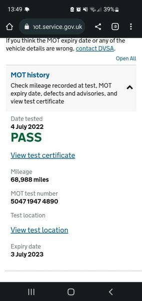

Nervous journey in testing my repaired gear linkage in a huge queue at the Dartford crossing but made it there and back and with a clean pass in my back pocket!
The tester mentioned some peeling underseal and flaky bits which I know about but said its still solid so far as he can see so hoping a wire brush and fresh underseal will have that sorted out
Gear shift feels much better now , much less slop.
 Still a bit of a flat spot when driving, and gets a bit stuttery when you return to idle as traffic lights etc.  I had ordered a new vacuum advance but reading back through this thread I thought @spartacushad put electronic ignition on it but seems like its actually a system that bypasses the condenser but still uses the mechanical points so will take a look at the settings and condition of those alongside a fresh rotor arm and dizzy cap which I didn't see any record of being done.  I also bought a nice retro accessory so will look to see how the dizzy timing is
all in all a very pleasing day

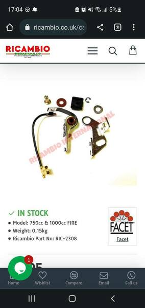

do any of you Fiat fans have experience of rebuild kits for cassette type points?
A replacement points cassette is £45 and I'm far too tight to pay that

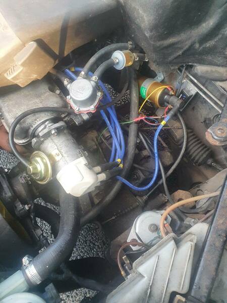

I had another go at trying to sort out the annoying flat spot which @spartacushad identified earlier in this thread.  He had stripped and cleaned the carb, changed plugs and leads and added a semi electronic ignition which uses the points only as a low voltage trigger whilst depensing with the condenser.  I had also replaced the fuel pump and hoses, however it was still there alongside a stumbling when dropping to idle from higher revs
So today I replaced most of the other stuff I could think of.  Coil, rotor arm, dizzy cap, vacuum advance and coil.  I didn't replace the points cassette as its £45 for a new one
I also remade all of the earths going to the hedgehog as although they looked ok there were a few electrical gremlins. This seems to have sorted them
so the verdict after an admittedly short test drive.......
Well I think we are 90 percent there. Its a sputters a bit on choke but once warmed up I think the tip in hesitation and slight misfire under load has pretty much gone. As has the stumbling when returning to idle.  Still maybe a tiny bit of hesitation there but much much better
Next job is to check the timing and the dwell.  I bought a retro Gunsons auto tune to do the dwell but not exactly sure how it works, but following the basic instructions on the back (the booklet is missing) I was getting dwell angle off the scale so not sure if Im doing it incorrectly or the things knackered
or of course the dwell could be miles out but I assume it would run really bad if that was the case.
