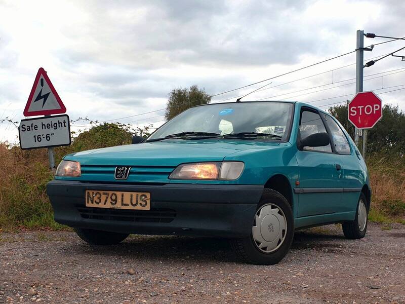

The Joy of 306. Donkey found sanctuary
So, having planted his Corsa into the posterior of our 306, Mr Company Car was no doubt put in a brand new courtesy whip until such a time as his usual steed arrived, all mended and freshly polished, back on his driveway.
Meanwhile Nicola was all grumpy and in the miserable position that her beloved Peugeot had been involuntarily restyled and awarded Category-C status...
