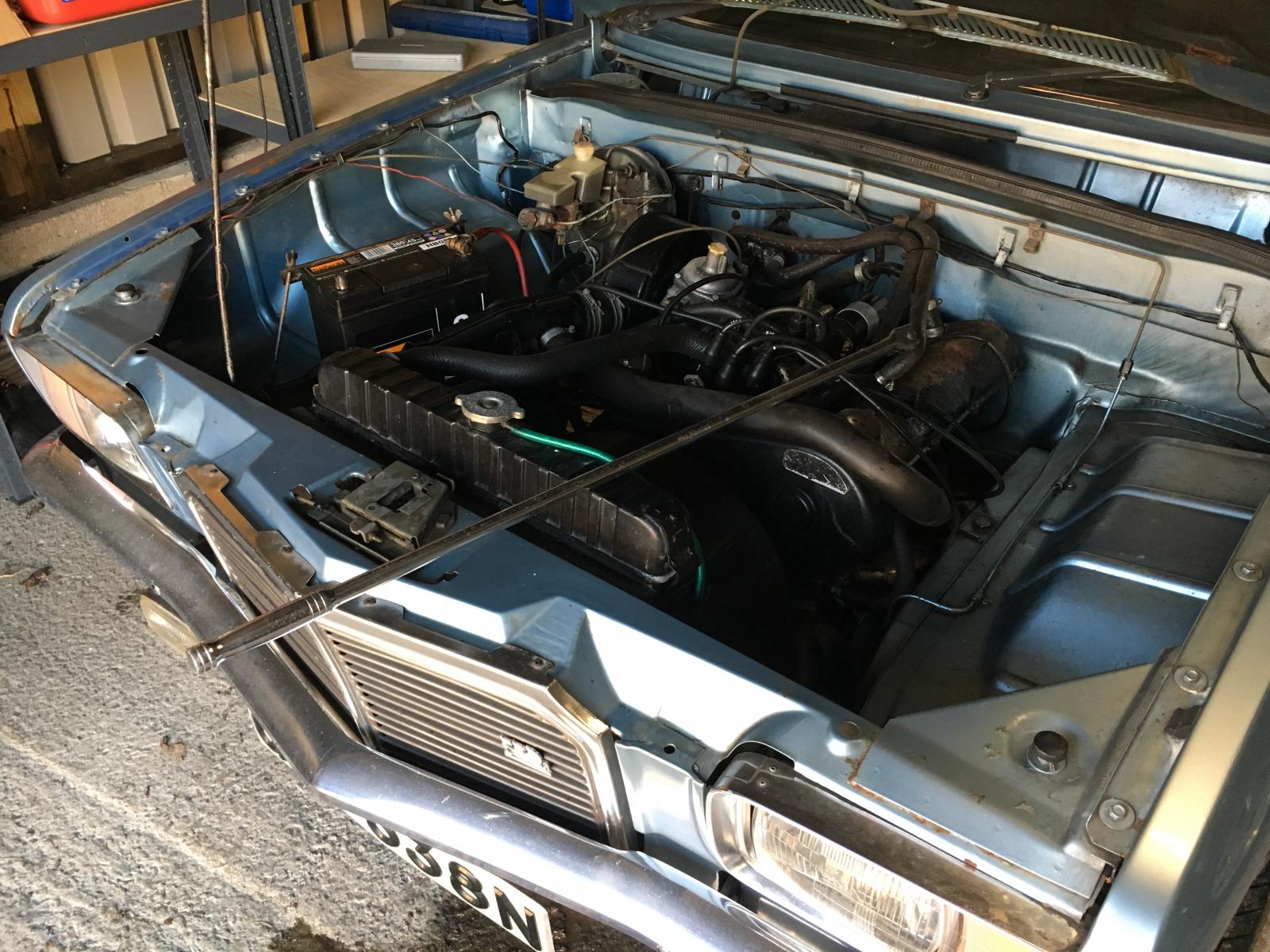

I was wondering about that but it’s royally buggered, it would need drilling out even to do that. Might as well get someone to do a proper job and put a new insert in. I will do that anyway, even if I do buy the van and temporarily cannibalise it.
^^^^ ... worth a shot 'in situ', if you can get a horizontal run at it...
Hmm. Is it head coolant circuit or just heated inlet manifold?
I think it’s just a branch to the manifold...are you thinking bypass it? Could look into that. It might mean bypassing the heater too, but could at least make it mobile.
Yes, iirc the slant 4 head cooling wasn’t related to the manifold. Or it’s completely wrong.
Bypass it but not the heater is possible depending on hose feeds. Sorry, it’s been a few years since I saw one.

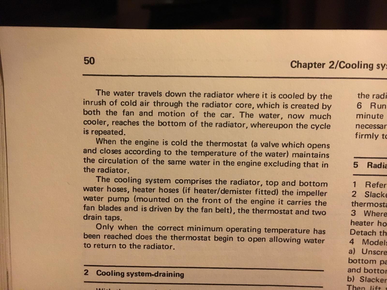

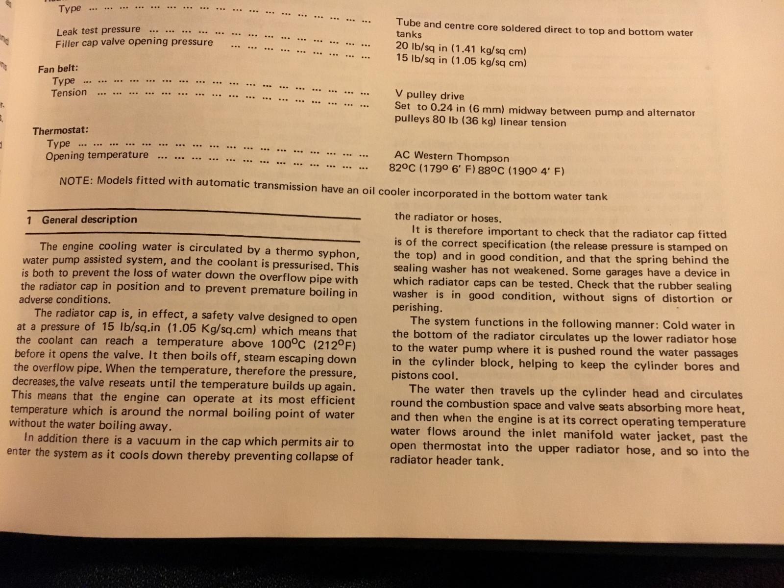

The Victor FE HBOL is bugger all use - cooling is a 3-page picture-free chapter. The main description suggests the manifold water jacket is inline rather than a branch, though:

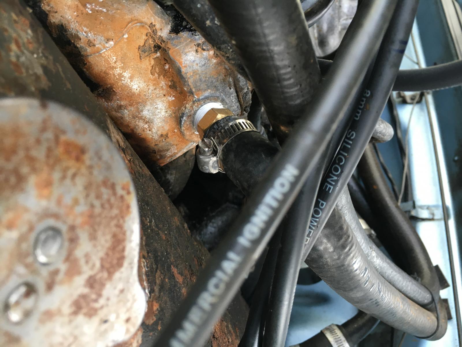

In an unexpectedly positive turn of events today, the offending hose connector actually unscrewed very easily from the inlet manifold using the Bar of Truth after a good soaking in the Fluid of No Nonsense:
I’m not sure what it’s made of - it doesn’t look like brass and isn’t magnetic so some sort of alloy I suppose? Whatever it is, it’s soluble in coolant - the pipe bit is supposed to be about an inch and a half long:
I just need to figure out what size the threaded end is (that hex takes a 19mm or 3/4” socket) and then hopefully the fitting will be available off the shelf - there are various available from the US though I haven’t yet found a UK seller.
If all else fails I’ll be getting some brass hex bar and looking to borrow a lathe, then I can go all Project Binky on its ass.
The chances of it being anything other than a British Standard Pipe thread are nil; the hex being 19mm makes the thread 3/8", so one of these is required. A steel one might be more robust though, there are other suppliers obvs. BES.co.uk are quite good.
Excellent, thanks! That’s the badger. Practically fixed already!

It does look too narrow, but it’s just illustrative of the connector type and you get to choose the actual size. The inner bore of the original is 7/16”, which nobody seems to sell, so I’ve ordered a 3/8” and a 1/2” as they’re only a couple of quid each. Hopefully one of the two will be a good fit for the hose.

I went round one loop of ordering the wrong size of brass pipe insert - what the seller called the ‘inner bore’ dimension was the inner diameter of the hose that it goes into, so the outer diameter of the actual pipe insert - but got the right one eventually.
Thanks to somewhatfoolish for the tip about the 3/8” BSP tapered thread, that was spot on. The AS hive mind at work. I’d still be pointlessly trying to crack an inlet manifold off a Bedford CF otherwise.
