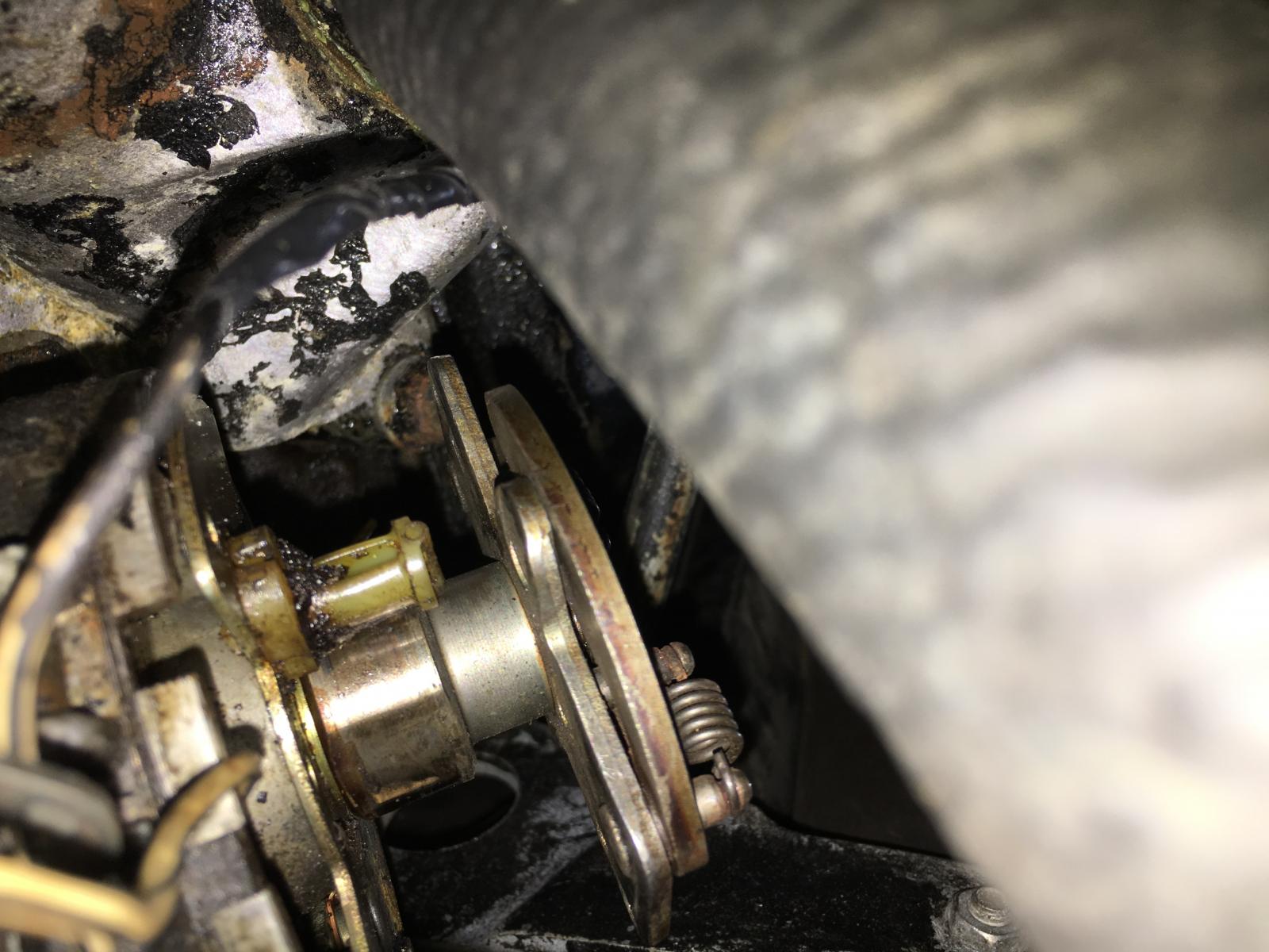

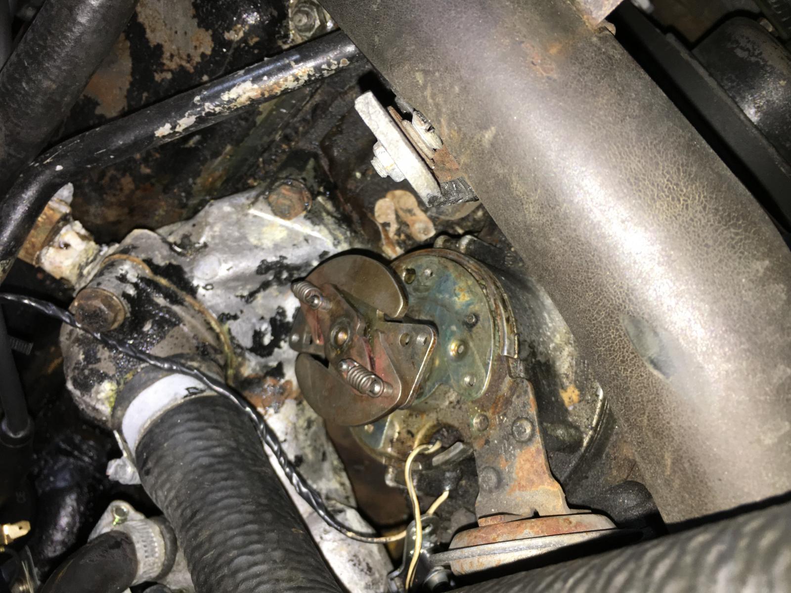

So on to the distributor. Cap off, rotor arm off, electric bits out... rotor and bob weights going absolutely nowhere. The book of lies says they should lift out, but they don’t.
Those two phillips screws by the vacuum doobriefurkin don’t help, by the way.
Any Saab 900, Dolomite 1850, Lancia Fulvia or Bedford CF fans out there with suggestions on how to fillet a Delco D300 in situ? I'm keen to avoid taking the whole dizzy out and adding duff timing to the list of things that prevent this car from running.

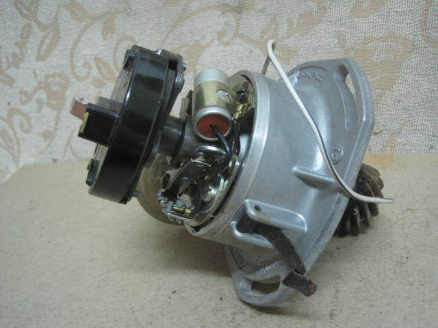

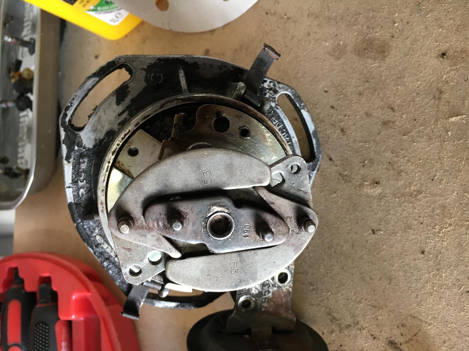

I took the dizzy out and dismantled it on the bench. The shaft has been peened over at the top, and while I could drill it off I’d never get it back on again:
So after some head scratching I gave up on the electronic ignition idea, cleaned everything up, re-gapped the points and put it all back together again.

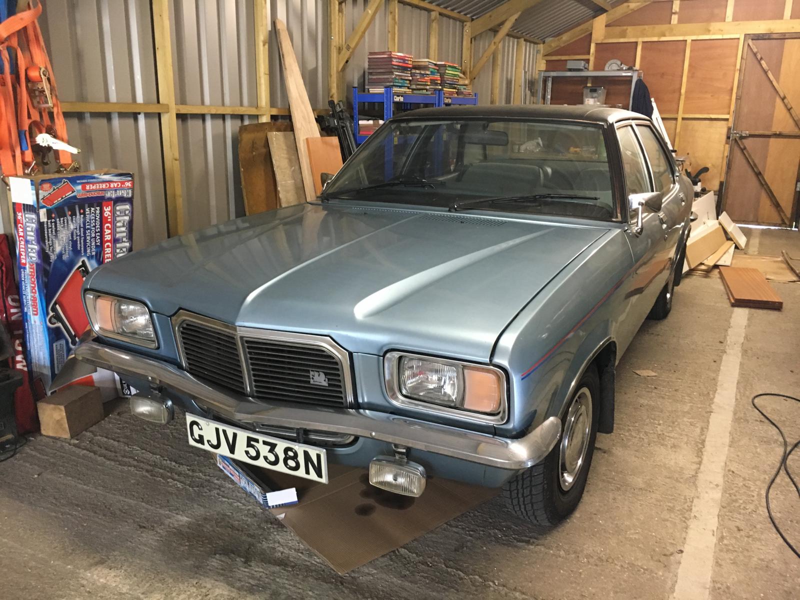

Here it is with the bonnet properly closed for the first time in about a year;

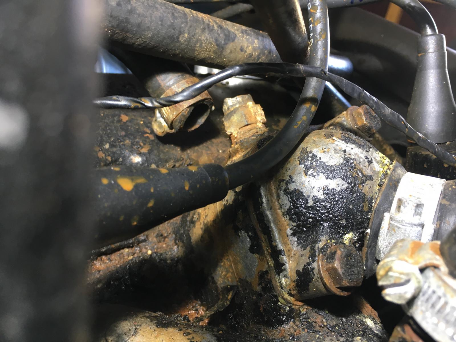

Went back to it today (day off) and discovered the main problem:

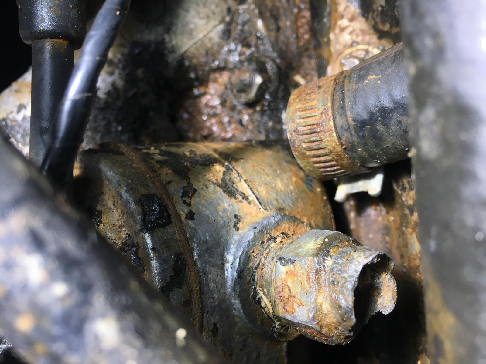

That pipe insert into the inlet manifold (just behind the wire) is toast, and the hose has just fallen off it. Here’s an even uglier angle:
I’ve left it soaking in penetrating oil at the moment in the ridiculously naive hope it unscrews and has a part number on it. Otherwise I’m looking for a new inlet manifold - no luck so far on that.
