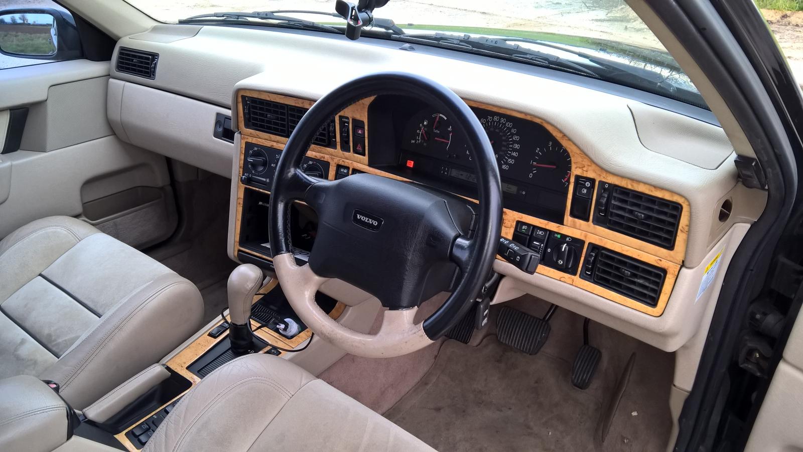

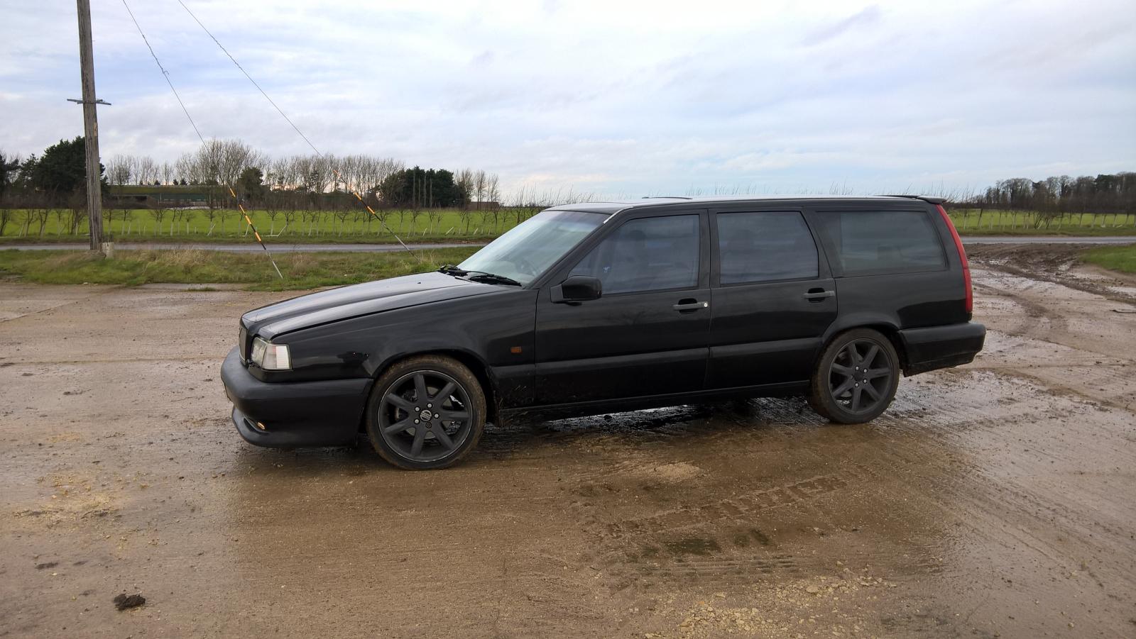

Pics:
That is nice, it's good to see one in mostly original condition. Is that the bulb failure light on? That proves it's a proper Volvo.

Love that Interior! This one looks more or less cosmetically standard on the body which IMO is the whole point of these- discrete speed.

Oh, and thanks for the comments on the motor, the interior was one of the selling points for me as well, I think it's rather lovely.

Excellent. Those R wheels are possibly the best alloys fitted to any Volvo, ever.
I like that interior too, the 800 series carried the lighter trim really well.

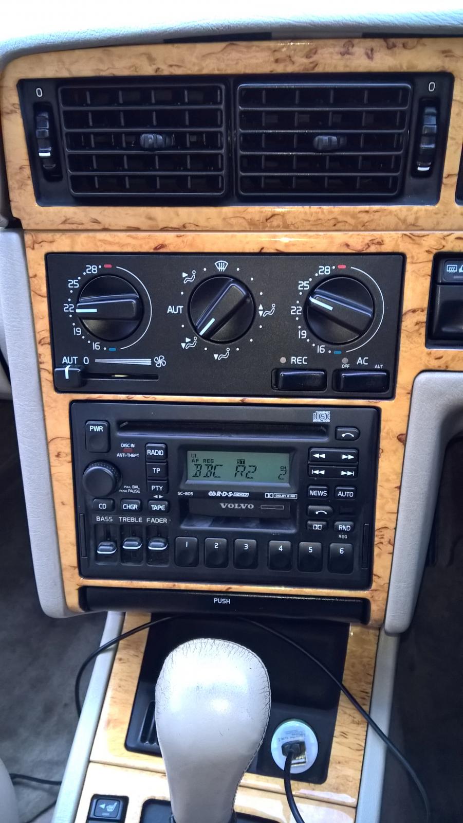

Minor update, today I fixed headlights, fitted a stereo and gave the car an oil and filter change.
Cheers for the stereo Lankytim, it looks and works great.
When I was connecting it up I noticed that not only does the car have a cd changer, it has an amplifier as well. Oh and bonus 6 cds in the changer; Gary Moore, Sade and other stuff I can't remember.
