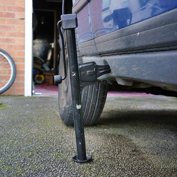

The included jack feels like it is made from reconstituted KitKat foil, and in use leans in way which suggests the car will imminently fall forwards, backwards, sideways or a combination of all three. That said, it lifts the car very easily and not even the stupidest person would get underneath a car so precariously balanced, which must count as a safety feature.
