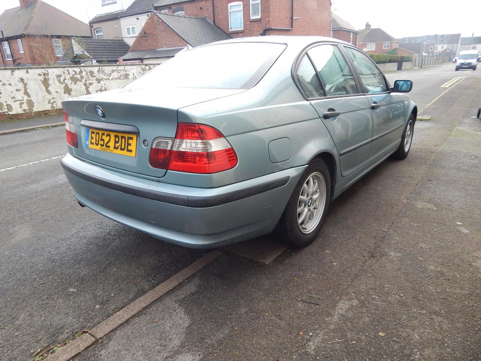

2003 ish 318i auto. It's a metallic misery with anthracite misery trim. Not really worth a cup of cold piss, but hey ho.

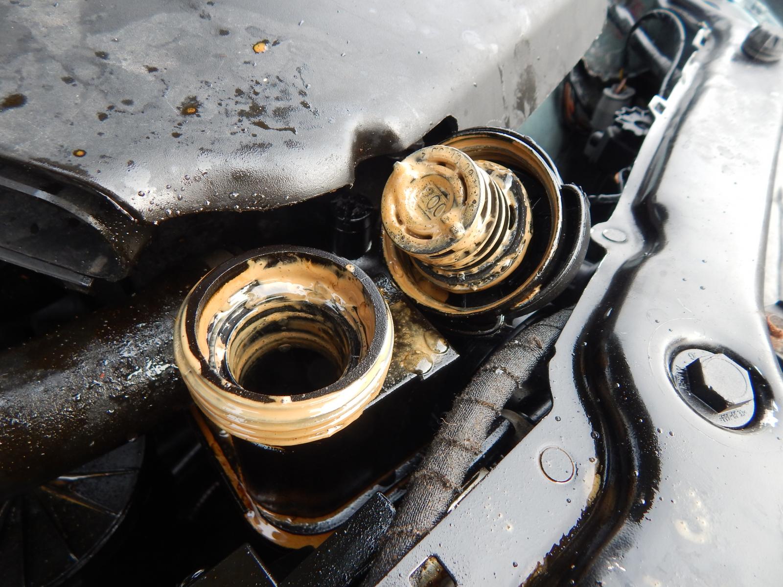

These things can be a barsteward to get fixed and bled-they like to banana the head..
Gonna flush the fukcer out and K Seal it. Mite work yo.

2.14 pm. I set off to collect it. It took me 12 minutes to walk there.
2.18 pm. Greetings and small talk.
Did you run?
E36 wheels, so it's trying to make you like it.

It's not auto box fluid in the coolant is it? Looks a bit browny reddy in the pic. Dunno about e46's but I've seen other stuff leak through the cooler.
This may require clarification.
Ignore the fool. He just pops up from time to time to insult folk for no reason!
Not sure. These shitheaps also have an engine oil to coolant heat exchanger, but it's not that - already checked. But anything's possible.

I was led to believe HGF on some BMW's necessitated a new motor because removing the head bolts usually brought the threads with them as well.
Yes, but that's more 6 cyl alloy block stuff. I don't think anyone's ever dared to take the head off one of these turds.
Well.
Good used hoses and an almost new Behr branded header tank fitted. Drained coolant and refilled with a few litres of parts washer and ran that thru although the oil shite is only in the top hoses, not the lower ones. Drained that after 10-15 minutes running and it brought a lot of shit with it so did repeat performance with Fairy Liquid and water. Then tipped K Seal down the top hose into the engine, added 5 litres of reclaimed* antifreeze, topped up with clean water, ran it up, bled it out. And it seems okay so far. Had it idling for 15 mins or so and no sign of oil in header tank.
Only thyme will tell, but obvs I'm not as smart as I think I am.
*I never throw decent looking anti freeze away. It gets decanted into 5 litre containers and used in shit like this.
