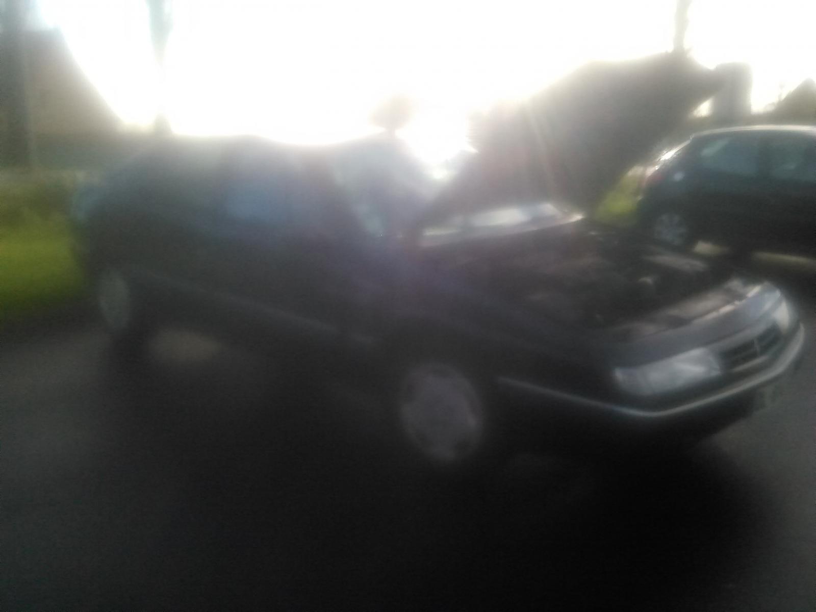

Here's a crappy teaser photo:
  • Like 8

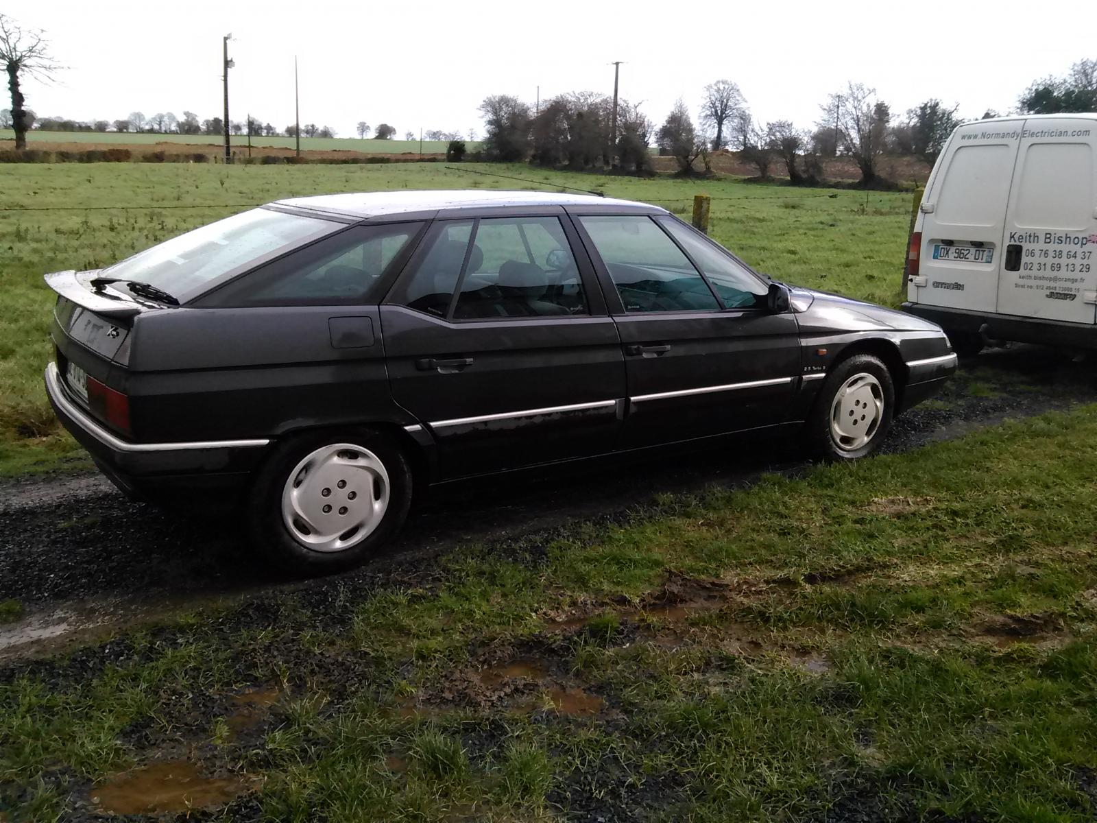

post-18019-0-14220800-1452608318_thumb.jpgXM2.5TD collected.

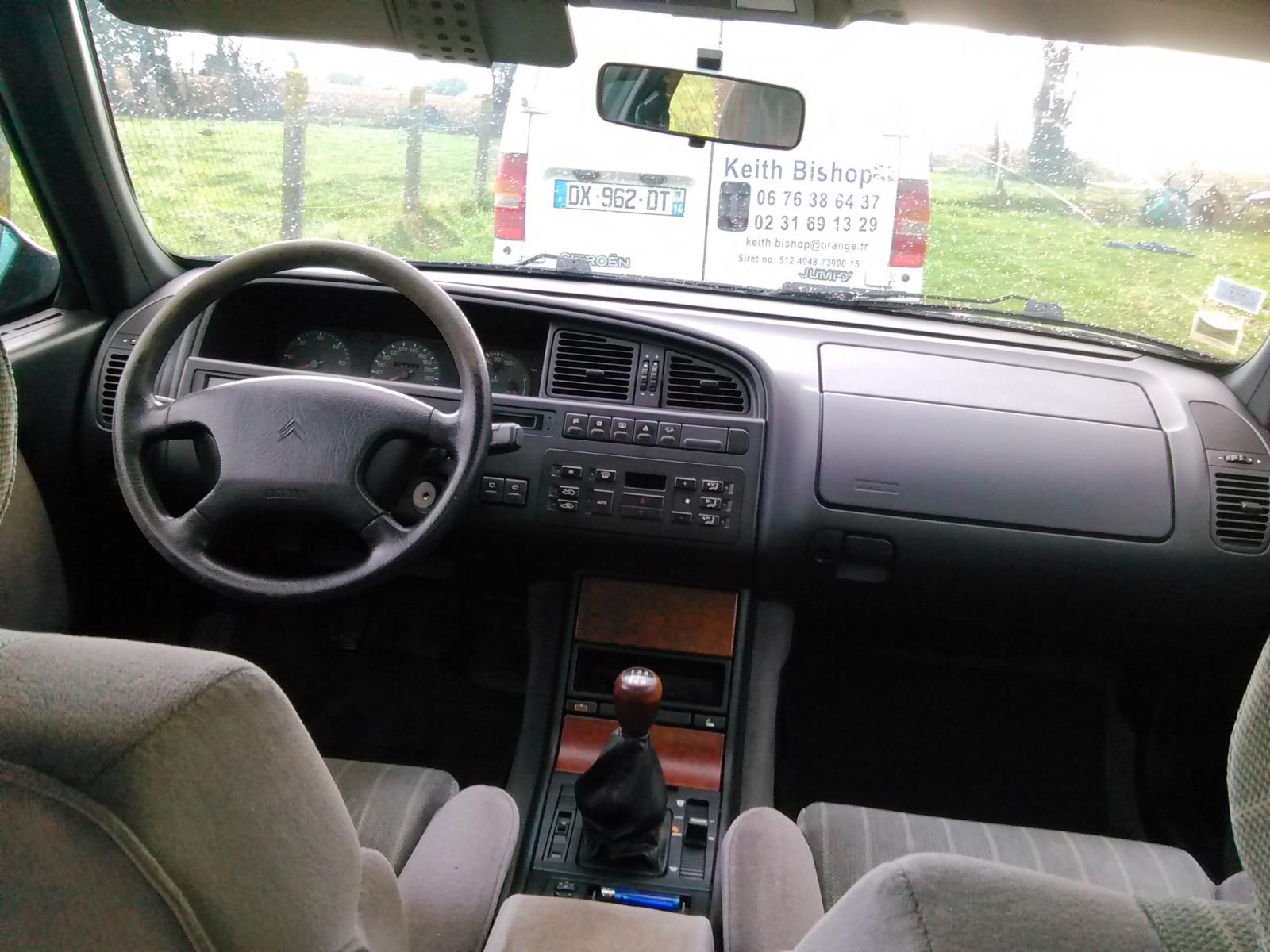

A few niggles to sort out, dot matrix has gone Chinese, heater display is awol, clock is 88888 and I cant get in the boot.
Put my tools in there at sellers house ok,now wont open ?
Throttle action seems a bit heavy, especially second half of pedal travel. Are they all like that?

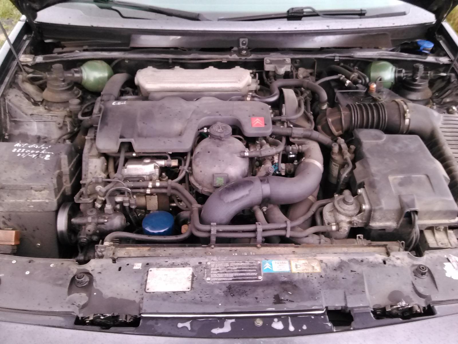

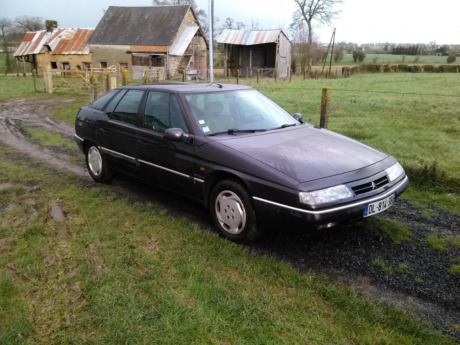

Some pics:

Heater display (if air con) is the fuse in engine bay behind left side headlight. They often get melted!
Thanks to RichardK , boot is open.
Checked the fuse box and yes, there was a melted 30A fuse. Still in working order though. Changed it any way.
Still the same. The display is there, if you squint you can see the set temperature go up and down in response to the temperature control.
Air bag light is on now  :(
Nicely chosen Sir. We do like an XM.
I think "Philibusmo" detailed his DIY repair of the dot-matrix screen somewhere on here, see if you can dig it out.

Looks nice. The clock showing 888888 most likely just means it needs the the time setting ...

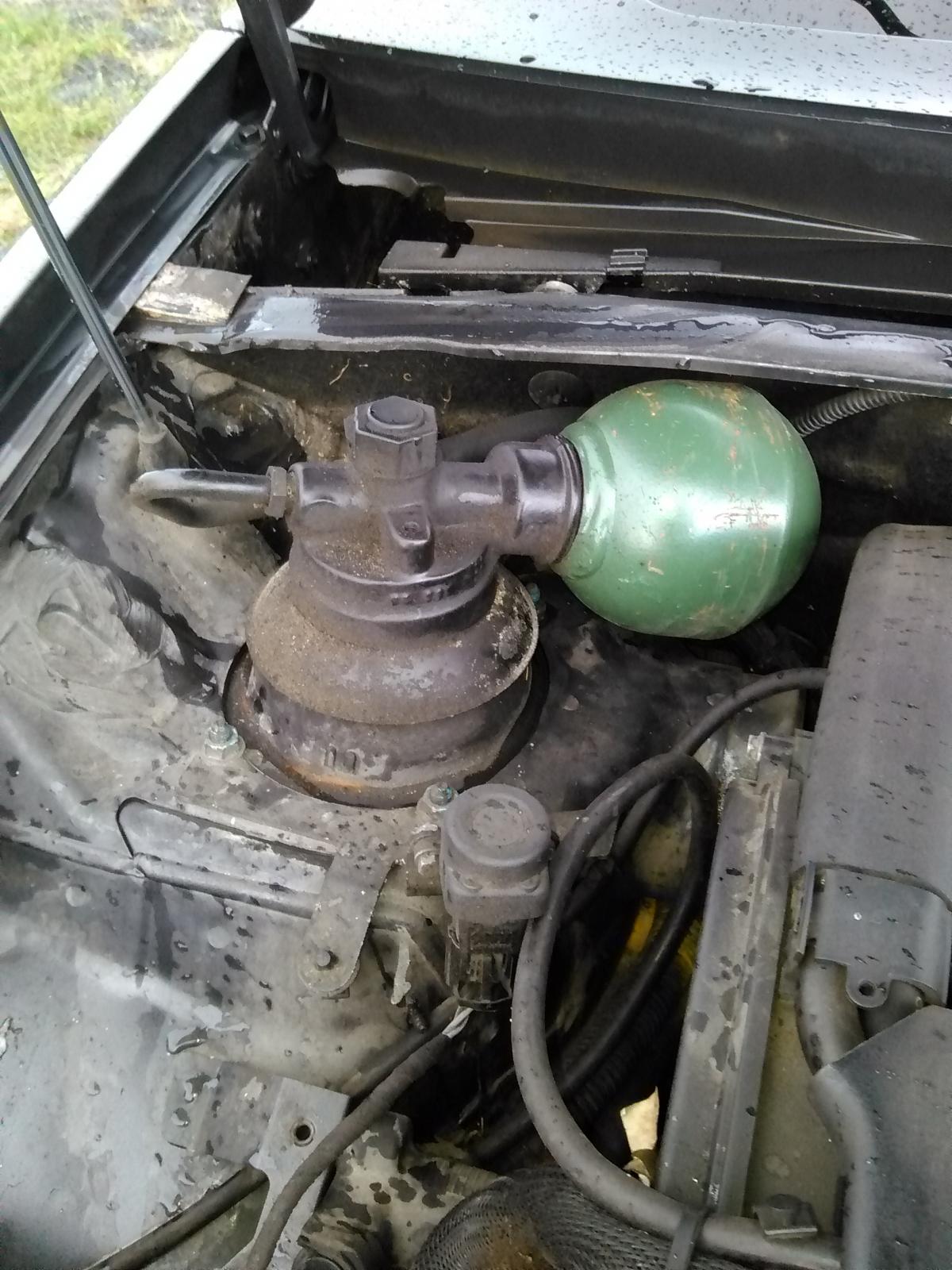

Things to do list is getting longer though. Accumulator sphere is clicking far to often, so I ordered one, then I opened the bonnet...... and closed it again.
Looks a PITA job. I'll have a go when it's not snowing or raining.
Rear sinks over night, I think that's another sphere.
And entering the security code every start is bugging me. C 1 C is supposed to put into auto mode but it doesn't. Is there a way around this ?

IIRC, you can disable the immobiliser. Mine thankfully doesn't have such nonsense. I seem to recall something about unplugging it while the engine is running and then you're ok.
Wouldn't worry about the anti-sink sphere. It's better when they sink. Makes the start of every journey more exciting. Accumulator spheres are a bit tricky to access even on the 2.1.
According to the manual for mine you have to enter C1C within ten seconds of entering your usual unlock code. You should then hear four beeps and the green light should flash four times.
