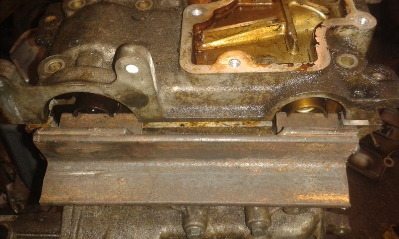

I had a little time this afternoon, so I got some oil and antifreeze together and got on with it.
Some video is uploading... but first I thought you would like to see the special cam setting tool.
Demonstrated on the old engine, which is why the cam cover is loose - I needed the two bungs for the other one because you either destroy them on the way out or you need a gasket. Or a dead engine to rob bits from.
Back soon!
Anyway. when I connected the battery, the radiatior fan started to run, and wouldn't stop even with the ignition off and the doors locked. This was quickly* tracked down to the temp sensor on the side of the thermostat housing - it wasn't plugged in.
First go....
Oh. What the? Grumble mumble... Oh, hang on, it's in gear and the clutch is up. TRY AGAIN
Noooooooo! Red light of doom and nothing else. Consider using fire - it's very cold (I'm not smoking - that's just my breath). Decide instead to check battery voltage with multimeter - 8.4v and falling. Change battery.
Watch the volume on this one! It runs! I didn't leave it running because it's backed into the garage and I like being alive. Tomorrow I will clear a path and take it for a drive but tonight it's cold and wet and I CBA.
