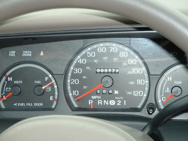

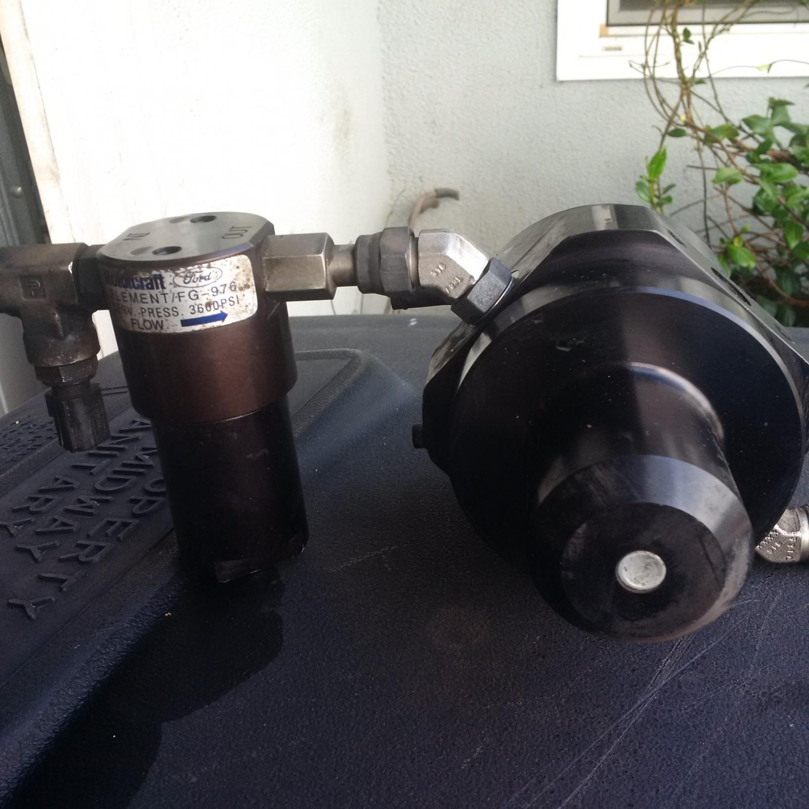

For the first time in my ownership it has started to play up a bit and I am trying to figure out what the problem is and how to fix a car that hasn't been made for years, and when it was it was only made in small numbers resulting in every CNG specific part being made of unobtanium.
I changed the oil a couple of months ago, which naturally led to the check engine light coming on... I mean, why wouldn't it?
I plugged in the OBDII scanner and came up with PO192 - low fuel rail pressure.  Everything was fine and dandy before I changed the oil and there didn't seem to be any issue that I could feel when I was driving.
Using the magic of Dr. Google I was able to find out that fuel pressure should be 125 psi at the rail.  So all I needed was a fuel pressure gauge capable of reading 125+ psi.  I couldn't be arsed to pay the price for a fancy gauge so I bought a cheapo one from Harbor Freight.  It only goes to 100 psi, but I reasoned that if it pinged the needle it was likely pushing out close to the correct psi.
Gauge showed a reading of 95 psi, so I figured it must actually be low fuel pressure.  I checked with a local garage who confirmed it was 95 psi at the rail.  This was a good news, bad news kinda deal - good news because the fuel rail pressure sensor is north of $700 if you can find one.  The garage ohmed out the sensor and declared it to be okay (more on that later), bad news because it meant that it was something else that would likely be a) more expensive; b ) harder to find; or c) both.
My fuel is stored under high pressure, and I mean really high pressure - 3600 psi high.  So it's not something you really want to fuck around with as it could all go quite badly if not careful.  What this means is, that the high pressure gas must be stepped down from 3600 psi to the fuel rail pressure of 125psi and this is done using a regulator.
My next deduction was that the regulator must be bad - otherwise why the low fuel pressure?  I mean the only thing between the fuel in the tanks at 3,600 psi and the fuel rail is the regulator, so logically it must be the culprit.
I got really lucky and found a scrap yard that had a CNG CV so I loaded up the tools and headed off.  It was relatively easy to get the regulator off the scrap car as it had no fuel tanks so no fuel pressure to worry about.  Even better is the fact that the scrappy knew the square root of fuck all about CNG cars and sold the regulator to me for $27.  A new one, if available, runs the best part of $2,500 - so WINNAH!  the worst part was lying on my back on gravel in 95 degree weather stripping the part from the CV - the car I got it from was ace though an ex taxi with something like 566,000 miles on the clock.

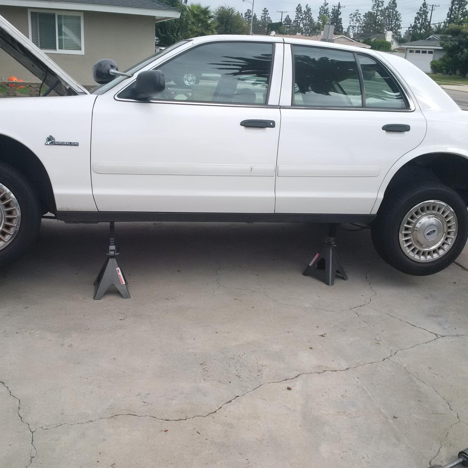

I got the regulator home and cleaned up.  Crown Vic was jacked up and put on 6 ton jack stands - ya can't be too safe...
I figured out that I could purge the fuel system by using the schrader valve on the fuel rail leaving me with a fairly easy swap.
Everything went back together without a problem.  I flushed the fuel system with injector cleaner and changed out the coalescent filter while I was at it.
I buttoned it all up and got the fuel pressure gauge out - pressure at the rail was now pinging off the needle, so well over 100 psi.  The car is smoother and definitely idles better when cold.  I canceled the Check Engine Light with my scanner and went for a test drive.
Three miles into the test drive and the fucking CEL is back on.  WTF?
So the current state of play is as follows... fuel pressure is up at the rail, the cold idle is much improved, car drives smoothly and without any noticeable issues.  Fuel consumption has decreased - I haven't driven enough to know for sure but it could be down by about 15% or more.

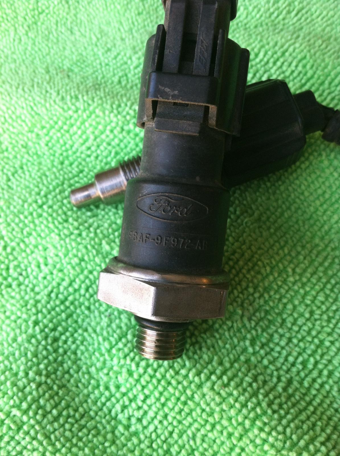

I spoke to another mechanic today and he told me that ohming out the fuel sensor won't tell you if it is breaking down when in operation, so it could still be the sensor.
I had been contacted by a guy on the CNG forum offering to sell me one of his spare fuel rail sensors for $125 - this was when we thought they were unobtainable.  He has since emailed me to tell me they can be bought from Ford for about $700, so now he wants $350 - he can go fuck himself, I would rather get raped by the dealer than do business with someone like that.
So for now, the car runs and drives without any problems other than the low mpg and CEL.  The only real problem with the CEL is that I can't get it smogged while it's on, and without smog I can't register the car - I don't need registration till April, but I need to figure it all out before then.

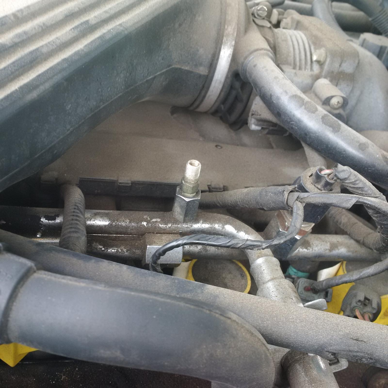

You could try going around the rail with a match to check for leaks.

I'd see if there's a manufacturer name and part no on the sensor and Google them.Ford don't make things like that themselves and its probably used in other applications maybe even on things like fork trucks.I know that in Europe the way to buy Bosch engine management parts is to use the Bosch part no and go through a Bosch dealer rather than buy from the car maker.

As for the pressure sensor, as is said above, try and identify the manufacturer. Pressure sensors are routine industrial parts, made in quantity.
http://www.gemssensors.com/Markets/Oil-and-Gas
Unless you know exactly what type of sensor it is "ohming it out" is not going to tell you very much. There are various ways of producing an electrical indication of pressure and they are all going to measure differently when poked with a test meter.
Like any other car electric problem it is as likely to be the connectors and cables in the circuit as it is the sensor itself.
That's not a bad idea, except... the part is stamped with the Ford logo and a Ford part number - I haven't been able to find any other numbers on it.  As best as I can tell these were only used in Ford dedicated CNGs, so F150 through 350 and the Econonlines as well as CVs.  Due to the relatively low production numbers Dr. Google has the best part of fuck all information on the sensor.  You can get aftermarket sensors, but they are still quite dear and they seem to be pretty hit and miss.  I am sure that they are made by someone other than Ford, but I don't know who, and I don't know what applications (if any) they had outside of Ford CNGs.

Can't you go back to the scrapyard, steal the sensor, then go back to scrapyard office with it stuffed in your tool bag scratching your head in puzzlement saying 'nope, someone got there before me'

Of course I had failed to pack the appropriate tools, but after a little screwing around I got the sensors out of all three cars.  I was counting on the cashiers having sweet FA knowledge of CNG price parts, but I got a little nervous when talking to the fella in front of me - he knew right away that I had the fuel rail pressure sensors out of a non standard car, and came close to guessing what it was.
It took longer waiting in line to pay than it did to get the sensors out - today being black Friday, believe it or not the junkyard had a 40% off special and the place was mobbed.  You certainly get to see a little bit of the rich/poor divide in these places - the customers were predominately Hispanic as they tend to be on the lower end of the economic spectrum - and, if you are a less well informed sort you just refer to them all as Mexicans, even though they are Guatemalan, Honduran, Colombian, Argentinian, etc.  Perhaps they also come from a culture where they are more likely to repair things than just throw them away... anyway these junk yards are an interesting visit.
I wasn't able to get two of the sensors out of the fuel rail, so I just took that with it and I snagged a fuel temp sensor - with my nerves on edge I waited for a total... $34 and change - WINNAH, WINNAH!  Three new sensors from Ford - $2,100.
I will fit the sensor to my car over the weekend - maybe... I figure that with three sensors I have a good chance that I will find at least one working item - there again, I don't know for sure that the sensor is at fault on my car but, at $34 it has to be worth a punt.
I plan on going back to the local yard this week as I am going to pull out the PCUs and fuel pressure regulators to keep as spares, or maybe to sell on.
I will report back with the findings.
What does this sensor do?
Measures the fuel pressure at the fuel rail.

I finally got around to pulling out the fuel rail pressure sensor and replacing it with my bargain basement junk yard parts.  It took all of 2 minutes to swap the bits and all is well in CNG world again... the main reason I didn't post the update earlier is that it was a such a boring and simple fix and completely without drama.  My fuel consumption seems to be back where it should be and the check engine light is staying off... yay!
