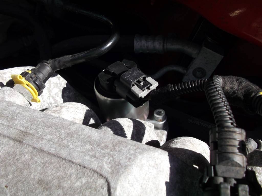

As a reward for its reliability, I treated it to a set of new spark plugs :
You may recall that those nickel Denso TTs had replaced a set of iridium NGKs when I bought the car. Denso suggest 18K replacement intervals, but the set above did 21K and the electrode gap was still within specification (1.1mm maximum). For £8 a set, they definitely deserve the Fraud Garages seal of approval !
Thankfully, the ignition coils were also within specification, and a quick diagnostic scan with my new box of tricks revealed no issues :

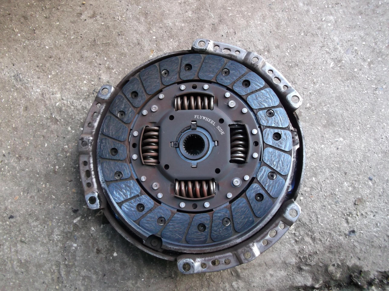

Thankfully, taking the clutch apart revealed the problem. Here's the flywheel face of the clutch plate :
And here's the gearbox face :
Prior to selling the car, the previous owner had spent £40 on this no-name Chinese kit, which lasted 45K miles of very light (mostly motorway) use. False economy !

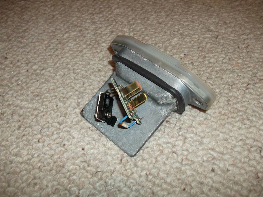

So I spent a couple of hours replacing the MAP sensor (which also incorporates the IAT sensor)...
...the lambda sensor...
...the thermostat, and a couple of the exhaust mounts that had crumbled away.
As expected, this made a big difference to how the car ran, and the EML light has been successfully extinguished in readiness for the next MoT.

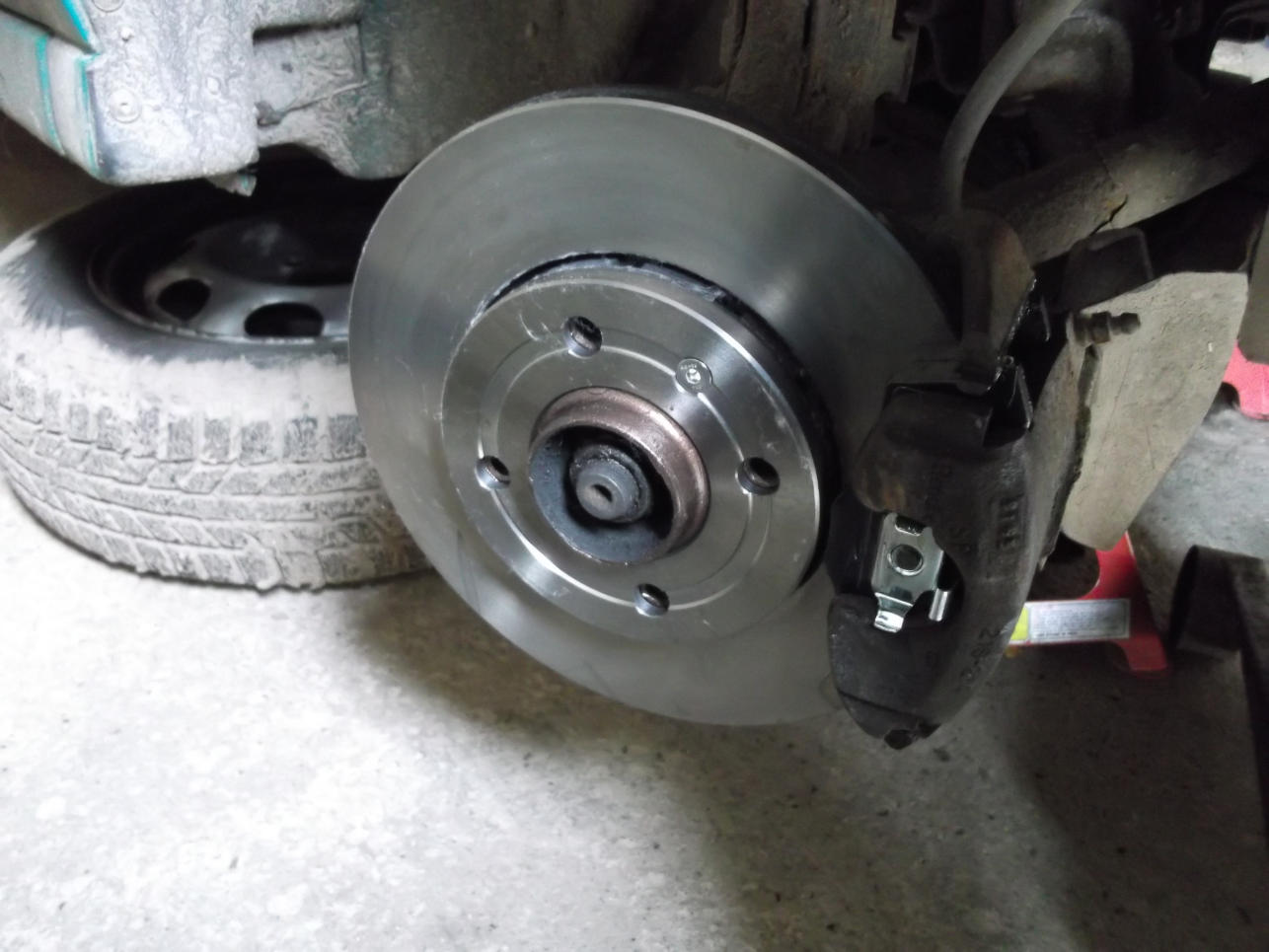

Since the car was in bits in the workshop, I also took the opportunity to renew the front brakes. They still had a bit of life in them, and if this was my car they would have stayed. But Mrs F has a spirited driving style (the Gilles Villeneuve kind of spirited) so fresh tyres and fresh brakes are always a good idea.
VAG quality* meant the caliper sliders were very rusty and the cap heads of the sliders rounded off as soon as an Allen key got close to them. So they were replaced.
I also finally got round to replacing a snapped disc retaining bolt, that had annoyed me since we bought the car :
And here's the end result, before a final wipe over with brake cleaner and covering the hub surface with copper grease :

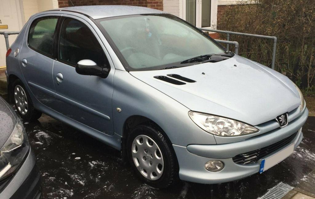

Why didn't Mrs F not just keep and use the 206 as the daily if she preferred it?
The 206 looks shabbier, has covered 40K miles more, returns less mpg and insurance is more expensive compared to the Polo.
Also, I really hate fixing German cars, but I hate fixing French cars even more :mrgreen:

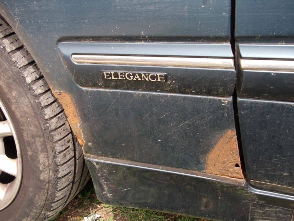

Elegance my arse !

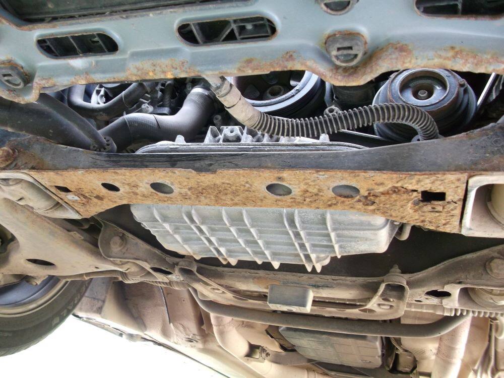

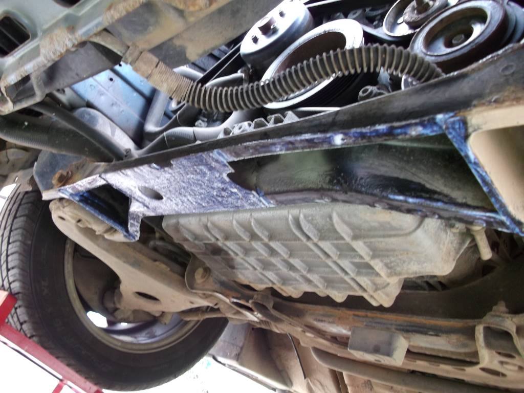

Both front wings need repairs, with the nearside one ideally needing replacement. One of the rear arches needs a bit of paint but is saveable. The wells behind the wheels on both sides of the boot floor (do those bits have a proper name ?) are completely buggered and need extensive repairs.
But none of the above are structural. Unlike this :
Mercedes engineers made sure that this crossmember is protected* by a fairly deep undertray with poor drainage. The undertray ensures the crossmember is kept immersed in water for prolonged periods of time, as this is clearly* the best way to protect it from corrosion. The undertray also makes this area completely invisible to MoT testers, which is why the crusty Merc passed its most recent test with no corrosion-related advisories at all. FFS !
Thankfully, this was the only structural rust I found, which for a car with the W210s reputation is a pretty good result !
So a large piece of 2mm plate is on order, and the next update will hopefully include some XXX-rated hot welding action for your viewing pleasure.

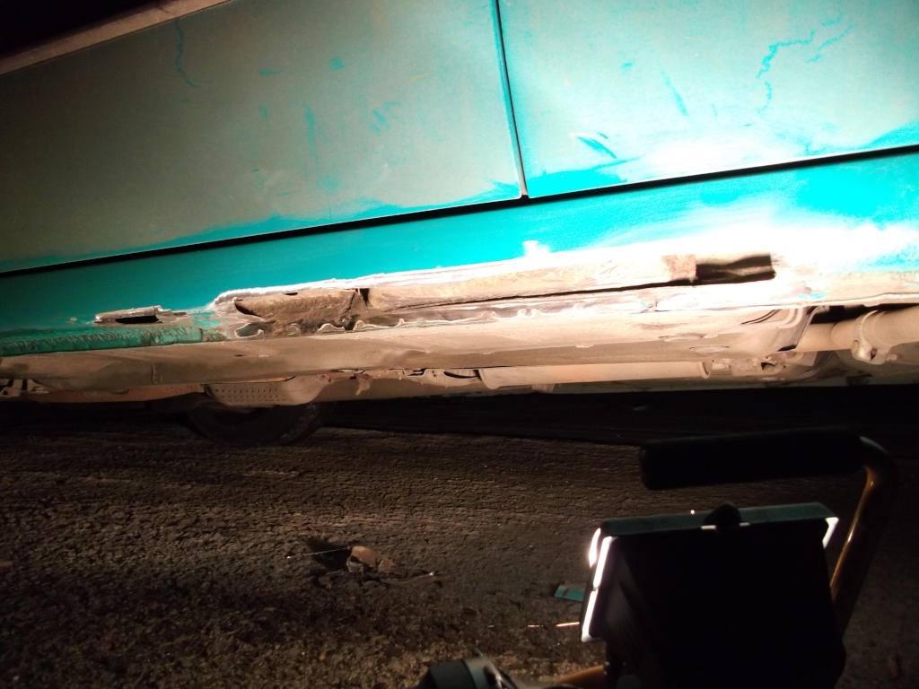

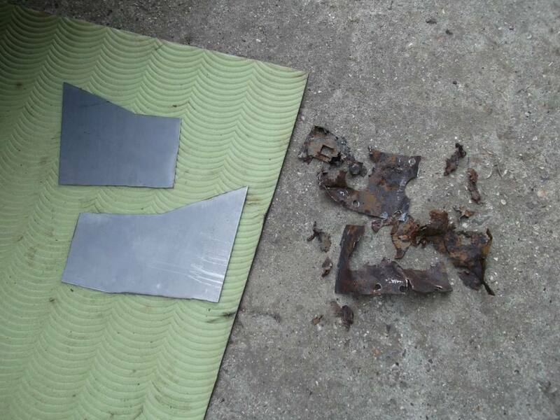

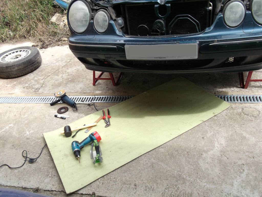

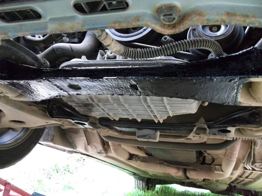

Come July, it was time for my annual continental holiday, and I needed to make sure the front subframe of the Merc wouldn't snap in half while doing 130 mph km/h, monsieur le gendarme, on the Autoroute.
After several hours of drilling, hammering and cutting, all rusty metal had been removed :
Now, a perfectionist would have removed the entire closing panel and bought a repair panel from MB, who still list it for around £60.
But I am not a perfectionist. Also, I had worked out that the rest of the subframe consists of a pretty substantial, inverted-U-shaped pressing, and the flat panel I was repairing contributed relatively little to the rigidity of the whole structure. So I reckoned a pair of rudimentary repair patches would be good enough for the job, and certainly far better than what I was replacing :
Several hours of trial fitting, trimming, trial fitting, trimming etc. followed. I then used plug welds where the factory had used spot welds, adding 50% more because I'm slightly paranoid. I then seam welded everything, to add that little bit more strength and keep the MoT man happy. Everything was covered in "Bodger's Friend" brand underseal, to restore a factory* look :

But the only one that mattered related to this :
Yep, the EGR valve, basically a service item in all Vauxhalls of that era. Taking it off and cleaning it with cellulose thinners didn't make any difference, but replacements were plentiful and cheap.
I was tempted to buy a £15 chinese one off ebay, but with the Astra being a keeper, I decided to pay double that for a QH one. Which, of course, ended up being identical to the £15 chinese one, but packed in a nice, sturdy QH box, the latter proudly "Made in Britain" !
Ah but the decent ones are not identical! The cheap 15quid ones have always been a lottery of working out of the box. Like the National Lottery, the chances of winning are remotely small.

For that reason, I spent several weeks intensively searching for the best, low-mileage 206 that I could possibly find. And this was it ! Just 26k on the odometer, and truly looking like a million dollars francs !
I collected it from The Smoke, and drove it straight into the workshop for a proper check and a replacement of the cambelt (which was well overdue on age) :
Now, when I drained the coolant I thought it looked a bit suspicious. But I just assumed that some twit had topped it up with non-OAT, as often happens. Such a low-mileage, well-looked-after car couldn't possibly suffer from headgasket issues !
I was, of course, wrong. And over the course of the following weeks I watched as the lovely pink coolant I had filled the system with turned into something that Costa could easily sell to hipsters for £10 a cup.
So the car was driven back to Fraud Garages, where this happened :
I forgot to take a picture of the blown gasket, but it had gone at the bottom left hand corner, allowing high-pressure oil to leak into low-pressure coolant. This is an extremely common fault in the later TU engines, due to a weakness in the OEM gasket. Using a good aftermarket gasket makes sense (I am a fan of BGA), as most use a different, stronger design.
Anyway, reassembly was the reversal of disassembly, and the 206 has been running like a swiss french watch ever since !

So I drove it to the workshop one evening after work, hoping that a couple of hours' work would be enough for a small MoT-standard patch. Typically, it was the coldest, windiest, most miserable evening possible, and I had to work outdoors :
Even more typically, the more I poked around, the more rot I found :
I soon came to the realisation that a new sill would be required -  a task that was promptly added to the very bottom of my long, car-related "to do" list.

Now, those QR engines are notorious for stretching their cam chains, which require replacement at intervals not too dissimilar to those of a cambelt. A most irritating problem, in an otherwise well-designed car. But it is extremely uncommon for the chains to snap, so I chose to delete the code and defer any further investigation for when it absolutely needed to take place ! Isn't this the Autoshite way, after all ?
Happy that the EML was now fixed*, I gave the thing a full service, with no expense spared :

I also got the climate control working again, by replacing this box of magic that had leaked out all its Lucas smoke :
