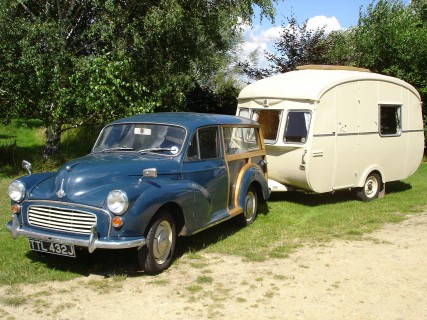

cros Posted November 29, 2015 Posted November 29, 2015 Found a picture of my minor from 10 years ago. I sold it because of the pain of keeping on top of the wood- it was used all year round. It had a 1275 and 5 speed type 9, would leave it standard if I had another though. It managed the caravan OK except once into a very strong headwind and then it didn't. 70 miles in 3rd gear. When I see the monstrosities that people tow these days I reckon they must get into the same situation as modern stuff is so high geared. It ran on LPG and was spotted a few years ago, I hope its still going strong. mercrocker, vulgalour and Joey spud 3
mercrocker Posted November 29, 2015 Posted November 29, 2015 Cheltenham Fawn? Nice outfit - wouldn't try it with my 1098, though! Portafold's my limit....(no airflow restrictions either!) cros and vulgalour 2
