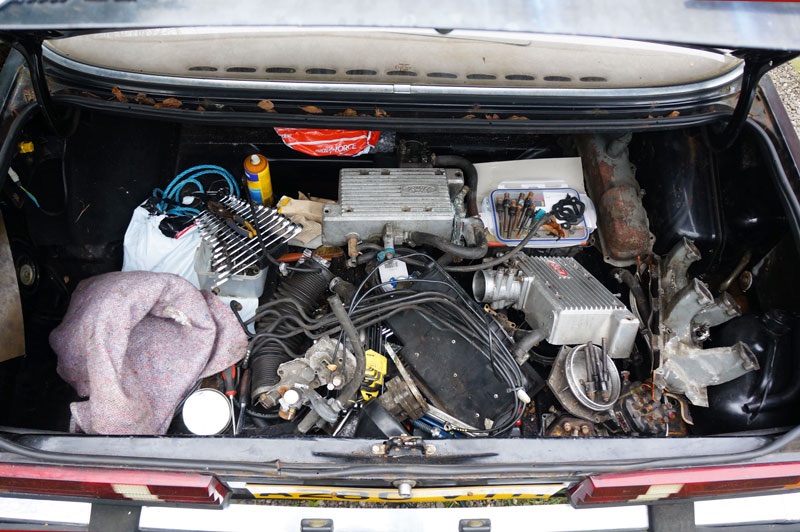

The last time we did anything on this car, morale was low. The cleaned out fuel tank was discovered to contain a jar of Lyle's Golden Syrup instead of a swirl pot, the fuel distributor didn't distribute fuel and we'd noticed a nasty MOT-failure of a crack in the windscreen.
A bit of enthusiasm was restored when a windscreen sized piece of bronze tinted glass turned up in Birmingham. With that safely installed in the back seat, it was time to get the car running. Junkman swapped the fuel distributor for one which proved itself functional by fountaining petrol out of ten orifices at once. But still no life from the engine. We swapped the cold start valve for a spare, and suddenly there was life - but only momentarily. The engine would run for a few seconds and then die. If the throttle was touched it would die instantly.
In the spirit of Blue Peter, a Fairy Liquid bottle was filled with petrol so Junkman could spray some fuel directly into the air intake. The engine bay was soon ablaze. I'm not sure what happened in the next few seconds because my view was obscured by the bonnet and the sweeping waves of flame. But I can say that Junkman is quite good at extinguishing fires and I my fight or flight instinct is well tuned to the latter.

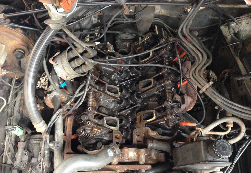

We decided that the fuel injectors were probably gummed up, and set about removing the inlet manifold.
Most of the injectors came out without a fight, but the last two had to be removed with a crowbar. The manifold itself turned out to be an awkward bugger - the distributor had to be removed to provide a half centimetre of clearance. Not amusing.
But with that done, all that was left was to assemble one good fuel system from our two old ones...
Unfortunately we ran out of day. But look what we have that we didn't have two days ago. We have fuel arriving at the injector pipes, and we've heard the engine run! I'll leave you with the scene of Junkmanish chaos found in the boot of this poor car. We've done a marvellous job improving the car's weight distribution.

Tomorrow I'll set the tappet clearances, since the covers are off anyway. Camshaft looks good as far as I can see.
Then it's basically a matter of everything back together whackage, testing the injectors (we have twelve to chose from),
and setting the whole shebang on fire again...

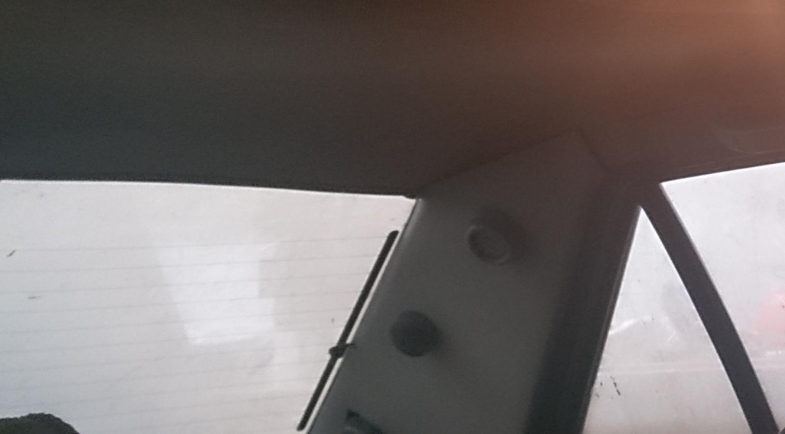

It's a rubbish zoomed in photo, but that C pillar light looks familiar...
More Ford parts bin raiding by Hyundai?
