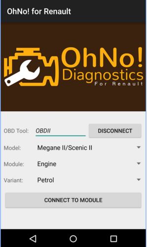

I received the ODBII bluetooth dongle from Dink but unfortunately I can't seem to connect to it via Bluetooth (it never appears as a connectable device).

Hi Wolf,
Stupid question but you do have the thingy plugged into the car when you're trying to connect yes?
It takes power from the 12v in the cars diagnostic socket, should have some lights on when it's being powered.
I seem to think it appeared as "CHX" or something in Bluetooth.
Hopefully you can coax some life out of it as it should be compatible with this app, developed by a Shiter whose name I've forgotten.
https://play.google.com/store/apps/details?id=com.ohnodiag.renscan&hl=en
Yes, connected to ODBII port. Lights come on, do a short scroll through and then it settles on one orange light. But it never appears in the devices available to pair with/connect to.
Dud bluetooth chip - I had one like this (it's the one I converted to RS232) Next one out of the bag identified fine as "OBD" and wanted a pin code of 1234 to pair.

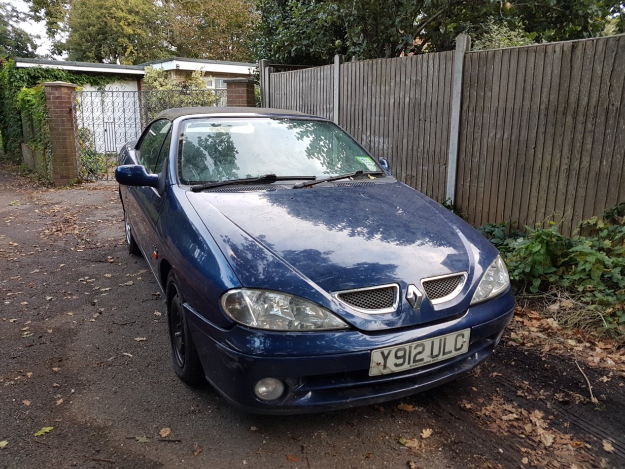

Just to finish off the saga of this car. It went to the Bridge in the end. I got over a ton for it, plus I sent the spare car too and got over a ton for that. Can't remember the actual amount. Silverlake for both. I can recommend them, decent service both times. I kept the interior and some parts I stripped out. They're now taking up room in my garage. Quite a lot of the sensible bits were in the boot and I couldn't be bothered to take them out. I could have kept them and listed them on the bay of E but frankly I couldn't be bothered. I was having a fairly crappy time of it so just wanted to rip off the bandaid and send it off. I was sad to see it go, but rereading this thread has reminded me how much it needed to get it back to roadworthiness - it was too much for me. The nail in its coffin was a big crack that suddenly appeared on the windscreen.
The leather seats sold to a nice chap with a minty example, he collected them in it. Wish I'd taken a photo of the car seat Tetris that that entailed. He got it for £1. The spare wheel likewise sold for £1. The dangers of ebay auctions with low start and no reserve. I'm just happy they went to good homes.
I wouldn't mind getting a better example in the future. The engine was great. It was a really nice drive. And really compact for a four seat convertible. Would recommend.
I think I put over £1000 into this car all told, and got a little over £200 back. I think I drove it properly maybe five times total. One of the many motoring learning experiences.
Here's the last photo I took of it, having moved it off the drive ready for Silverlake (who came and got it while I was at work). RIP fine steed - you deserved better owners.
