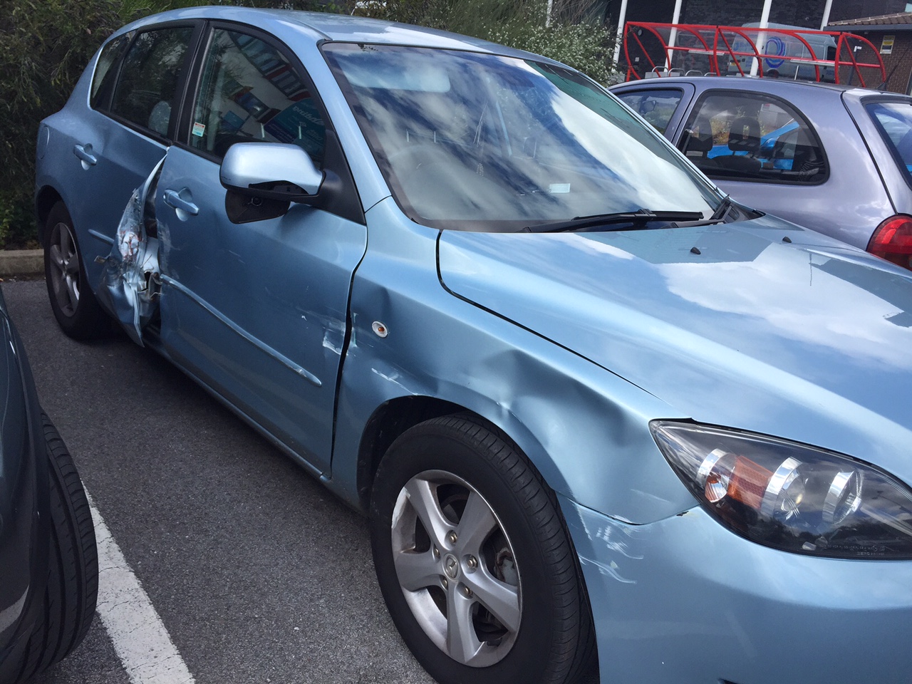

Someone at work has just posted this car up for sale.
2007 1.6 Mazda 3. It is category C write off with damage you can see.
It is only £600 ono
What should i be looking for if I go to view it? Is it theoretically a new set of doors and that would be fine or more too it than that?
I'd expect the b-pillar to have been torn back, looking at that damage. If it's not, then just get one secondhand rear door, have an experimental bash at the dented wing and front door and run as is, if the oily bits are in good health. Front door looks like it's closing straight and sealing okay?
+1 on B-pillar having been moved by that impact, looks like the hinge is damaged/torn out so getting a new door on the back might be interesting*
£300 tops, it'll be a right shit to fix IMHO.
Also, this example is going to do the Mazda reputation for attracting the rust fairy no favours at all.
Cheers Chaps - will give it a swerve. I think in my head I associated it with being a new car cheap.
It might only be £600 to fix but to paint it up alone could be £1500. I'd aim to give no more than you could afford to make back by breaking it up.
Possible b pillar damage, cost of possible airbag work. Unless you are seasoned in this sort of work and can obtain the panels in the same colour I'd avoid it.

By the time you have sorted it could have bought a straight one that won't be a Cat C.
Obviously It's a complete write off if the b-pillar is damaged, and that looks mashed - it's a pain in the arse to fix properly with regard to alignment of the doors, etc.
