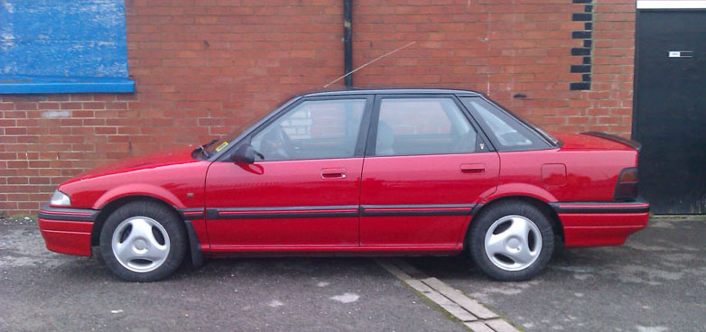

I have learned a 30mm drop can be got from fitting MG ZR springs at the front and MG ZS springs at the rear.  That's about all I need and it's the cheapest, easiest way to do the job so far.  If i wanted to go lower I'd just get the lowered versions of the same springs.
I like the wheels and agree it would benefit aesthetically from a bit of lowering, saying that i do love a lowered saloon
Found and ordered a set of brand new proper lowering springs for £150 delivered, no complaints with that!
I had Gmax -40mm springs on my 214. I feel they were lower than 40mm though. There were certain speed bumps I had to avoid.
The ones I've ordered claim to be a 45mm drop.  At a guess, I'd say that should end up looking like this:
I wouldn't want it much lower as it'd be unusable everyday.  Not really any speed bumps to speak of where I live now but there's plenty where Chompy lives so I've got to be able to at least navigate to his house occasionally.
They're not ZR springs, they're R8 springs.  Which was surprising.
