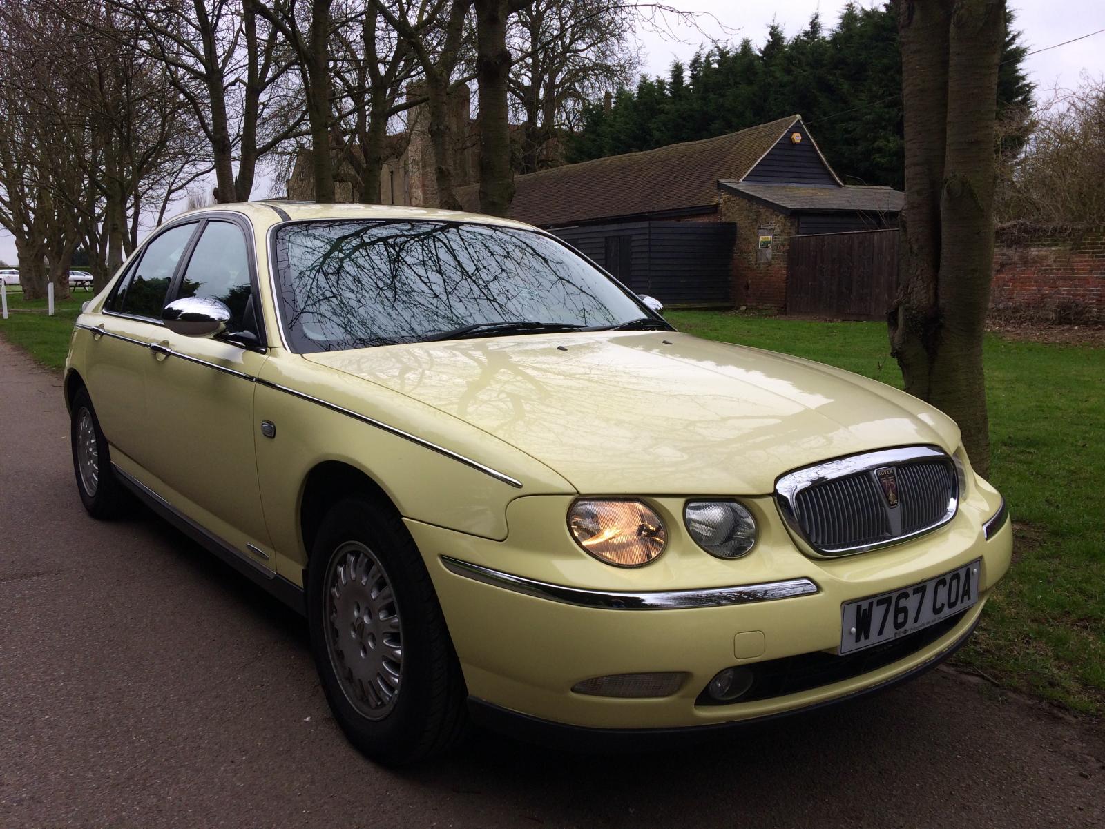

Some up to date pics, that's all. After a quick once over with that showroom shine 'no water required' stuff. Have to say it works quite well considering this was filthy this morning and it hasn't seen a bucket of water.

A couple of pics from earlier this year
39827508124_089ce96b68_c.jpgMy Rover 75 by steve wilson, on Flickr
27912026828_bbc7607bf0_c.jpgRover 75 V6 by steve wilson, on Flickr
Blast from the past! Good to hear from you chap. Been down to Southend many times recently, always keep an eye out for Primrose when there. Still a fine looking vehicle. Bummer on the MOT but spreading the cost over your ownership, it’s dirt cheap motoring
Hoorah! Good to hear from you, Steve. You’ve been much missed. Glad to hear you still have the wonderful 75.
Great to have you back! Your primrose 75 is such an elegant car, especially on a sunny day... I thought it was always sunny in Southend but your pics suggest otherwise.
Brilliant to see you and the Primrose back on these pages! How are you doing?
Sounded abouit right for a 75 re: MOT stuff mate. All good now though :)
Yellow cars always brighten up my day. That MOT sounds like a wallet stinger but old rope and sections of drive belt dont really sound like appropriate long term engineering solutions either!
Glad to see its still providing stirling service. This board needs more yellow car action.
Love this, mega rare colour. Your mot fees are in my dreams. My own ones are in my nightmares. Still for some odd reason love my 75.
