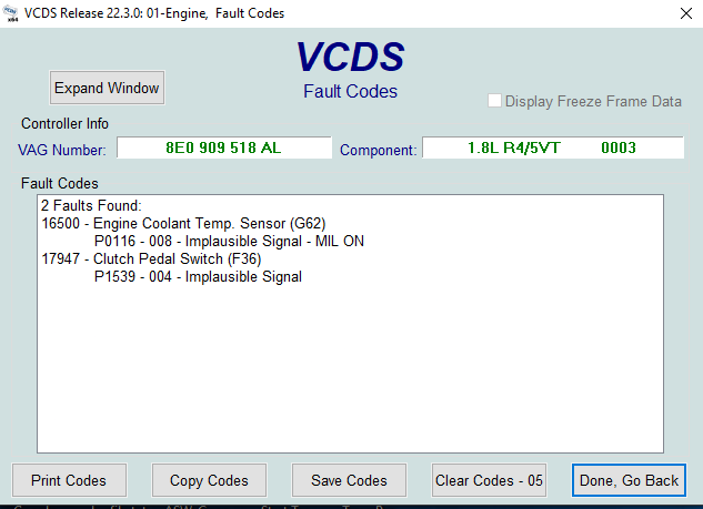

That was with torque and an ELM thing.
VCDS says:
These cleared OK.

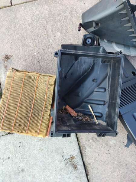

No books hidden in the slot and I was able to get into the glovebox just now wherein I found: a MAF and an N75....
A quick run with VCDS logging and the MAF value looks OK at idle and got to 180g/s going up a hill which I think is OK-ish?
Although coming back with the MAF unplugged it felt better.
Suppose a new genuine one rules something out, I will clean the TB first though as the revs are definitely hanging when you've had your foot down which can't be a good sign.

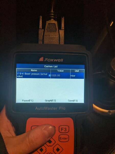

@SiC which measuring blocks do I need for actual vs requested boost?
I got as far as 40 and didn't see it?
This isn't VCDS (as this is easier to use in the car when driving) but I believe the group numbering is the same. So group 119 for boost measurement blocks.

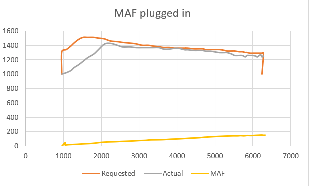

Done a bit of logging and none the wiser tbh.
I assume these are the same as the diesels and requested/actual boost is in mbar absolute? Meaning that whether the MAF is plugged in or not it's requesting and receiving about 0.4bar max?
The MAF reading goes from 3.5g/s at idle to 150g/s at 6250rpm, I think this is too low?
I did also confirm the clutch switch isn't working regardless of codes and I also have a code for temp sensor implausible that has come back so will order those as a starter for 10.

The stuff I am reading suggests that the overall MAF reading might be about right so I'm still a bit baffled as to why its asking for so little boost.

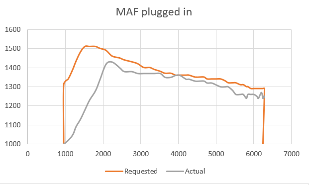

My 180 peaked at just under 1690mbar absolute. So 690mbar = ~10psi which I believe is correct.
Check of the reg says yours is a 163bhp. I don't know much about that engine but the 150bhp TT iirc is around 7psi of boost so about 1480 mbar absolute.  Sounds like yours maybe a tad low but not excessively.
What's interesting is that it tracks the demanded to actual pretty closely (ignoring under 2k when it'll be spinning up). So looks like the ECU is happy with the turbo and what it is doing.
Actually the enlarged scale on that excel graph isn't helping here. Looking again, the demand looks a good few tens of millibar away from the actual. At 2k requesting 1.5bar absolute but getting 1.4bar (1.45psi loss). 3k requesting 1.4bar and getting 1.37ish bar (0.5psi loss).
Boost leak? DV valve not sealing? Vacuum hose/solenoid control valve leaking?

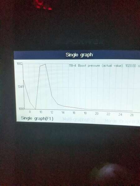

Here is the boost graph with a better scale.
I think that standard it should be somewhere around 0.5-0.6. Seems like it requests this at 1500rpm but never gets there and therefore starts limiting the boost?

Should be boost be constant? I thought it would drop back with revs but haven't really looked into it. As the revs increase, the engine is sucking more air in anyway (as it's a compressor) and so to limit bhp/torque it'll reduce boost with revs? Which give a fairly flat torque curve that everyone likes for driveability. That was my assumption anyway.
Might be a hard thing to do on the road but if you hold the revs at say 2k on a steep hill (to keep under load), does the actual boost match the requested? Just thinking of ways to test for a boost leak versus a sticking/seizing actuator.

Someone on a 1.8T FB group suggested that the temp sensor implausible code could put it into limp mode, so I have a temp sensor due today.
Will do that + clutch sensor + DV as a start then see where we're up to.

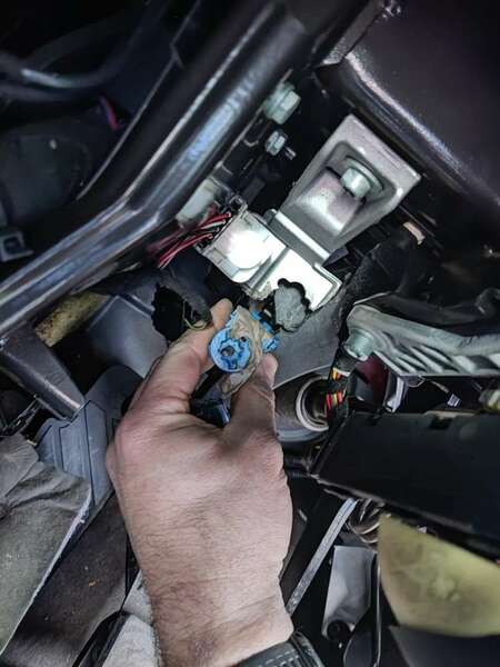

CTS and clutch switch arrived today.
Clutch switch: got it mounted despite past bodgery. The switch (Intermotor brand off Amazon so more fool me I guess) was DOA.
CTS is the wrong type, ordered one based on model checker which has 4 pins, mine only has 2.
