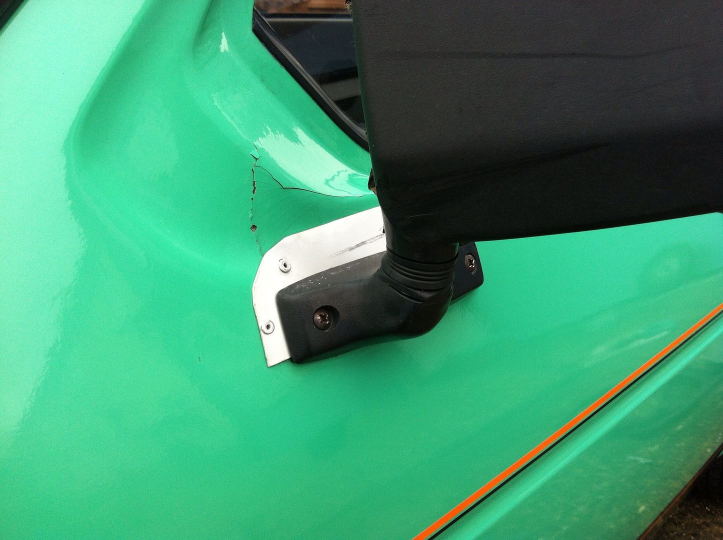

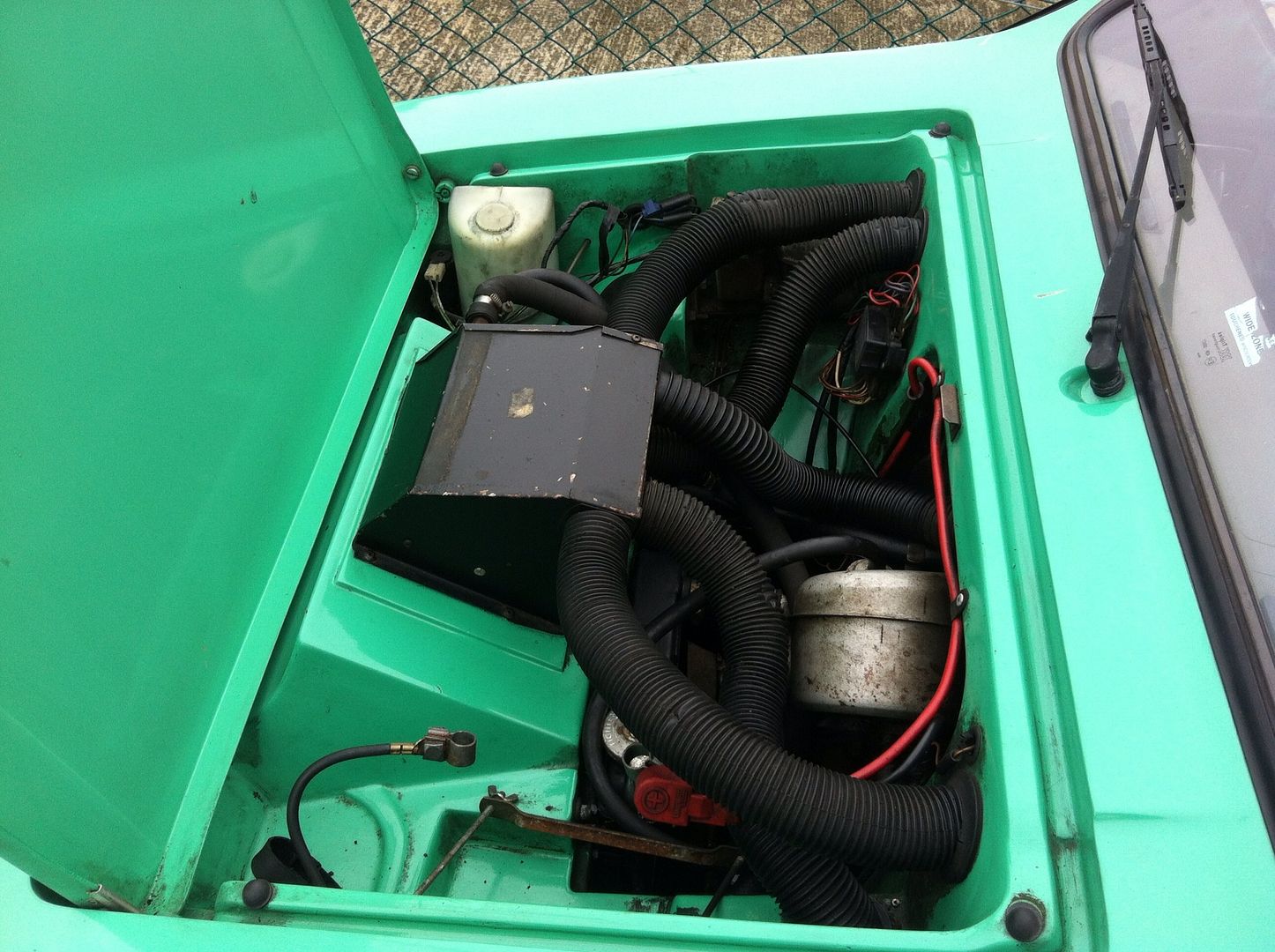

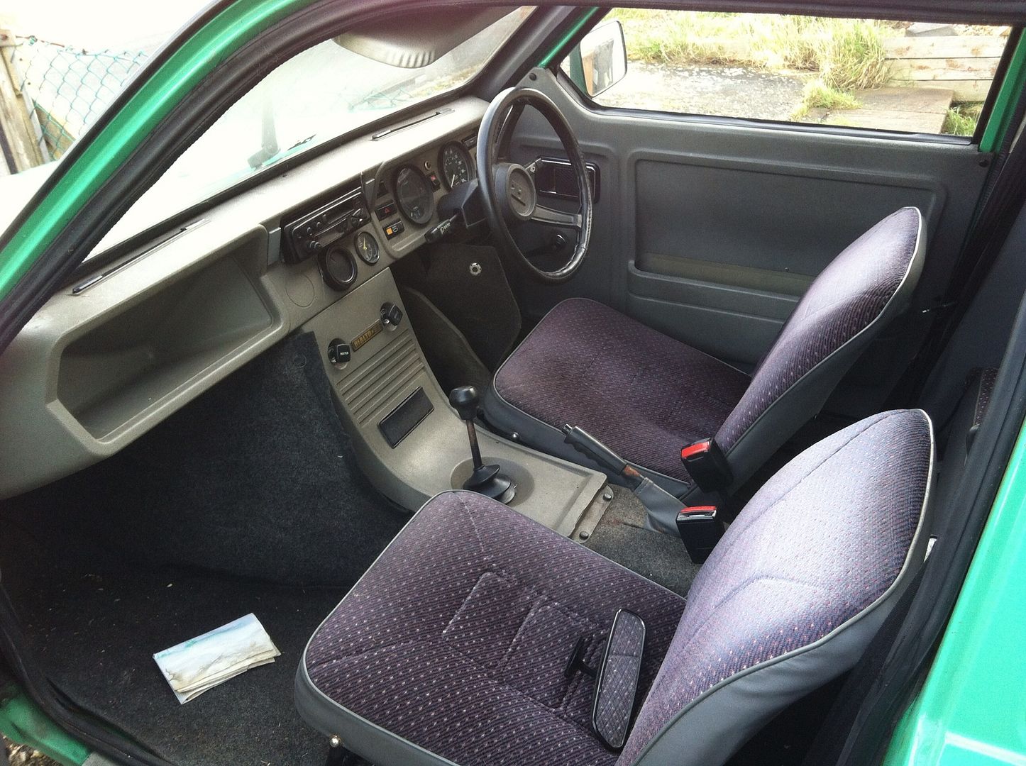

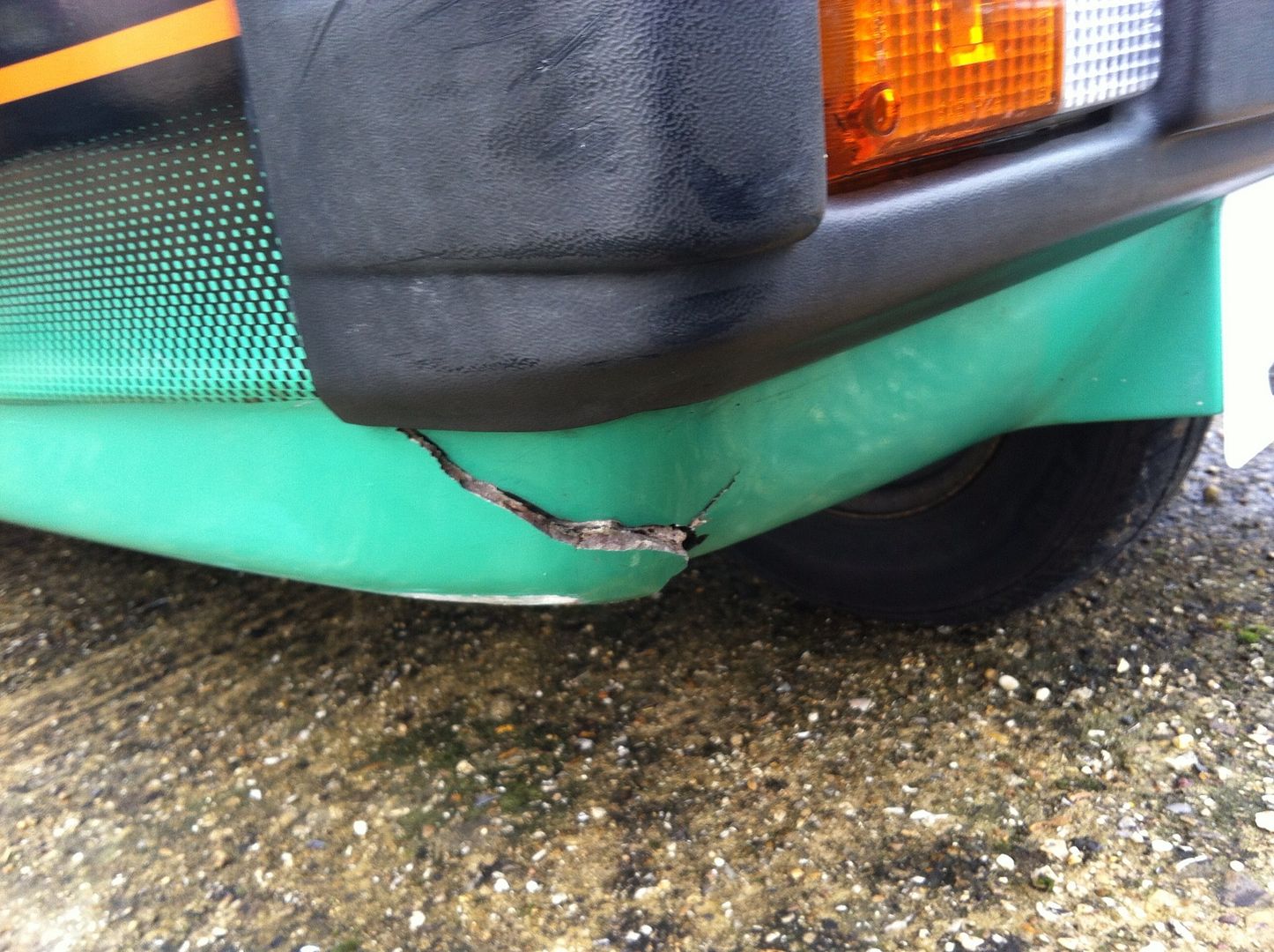

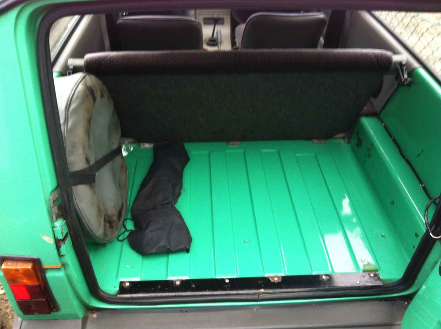

once home i got a bit more up close and personal.  there is minor damage all over the place, but otherwise she is in relatively good nick.  all the tyres hold air, the brakes are seized on, but nothing a good mk1 eyeballing wont sort, and it needs new rear shocks.  the front sidelights/indys are shot (more on that later) and the heater didnt work.  worst of all, the battery was dry, so no chance of trying to start her.  i'll let the pics do the talking:

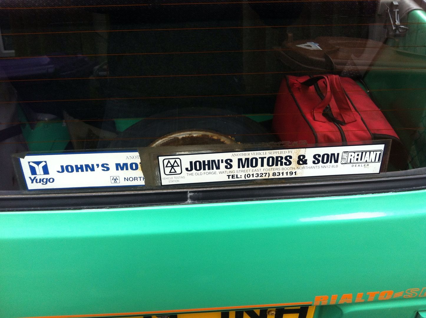

"John's Motors & Son" brilliant!!

Nice one.  John's Motors at Fosters Booth (near Towcester, on the A5) is still going strong.  They do the MOT on my Reliiant every year.
