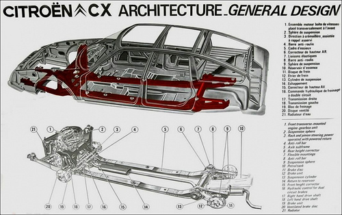

Structurally the cars combine the best of monocoque and separate chassis construction - massive subframes are linked by lightweight 'longerons', to which the body is bolted. (They'd introduced monocoque cars in the early 30s and learnt that to make one properly strong the weight would be huge - hence this expensive coach-style structure). It may make sound engineering sense but the uninitiated do get frightened off by this complexity. In practice, it's usually rear sills and front floors which have been replaced, with the odd patch on a rear subframe in an uncritical place. Most of the badly built or cheaply made cars have long-since vanished. Longeron condition is rarely bad, but ones with several patches might be best avoided.
