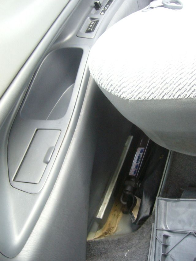

Krujoe - In this car, I challenge you to find the jack/toolkit. It is hidden! GO!
Ain't found it yet...

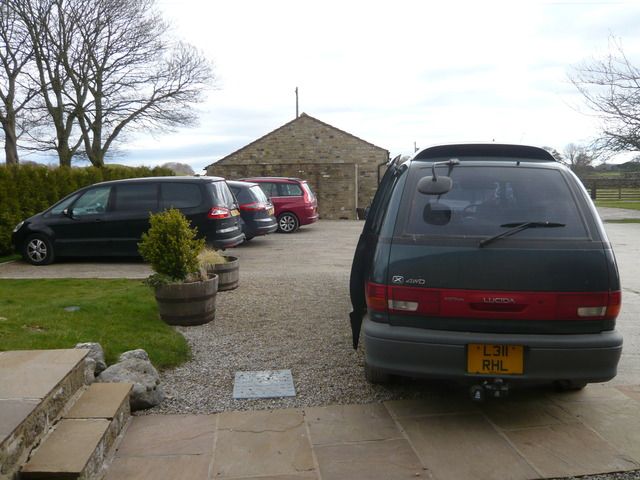

Last night the Pleasure Wagon looked like this after a quick hosing off:
It's mucky again now because it's been ON THE ROAD all day!
Yes, now legal, insured fully comp for £130.ish by Footman James with £50 excess (I don't know how they do it).

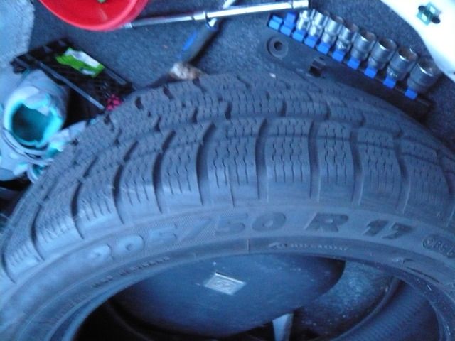

I scored these four winter tyres off ebay for £30, very local and poorly listed. WINNAR!
I don't have any 17's to put them on, so BIN'd five Lexus wheels (with knackered tyres) for £80. Tried 'em on just for LOLs.
They look a bit daft, but the chunky tyres will be better, and I'll only put them on for the wintry months.

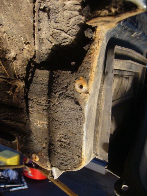

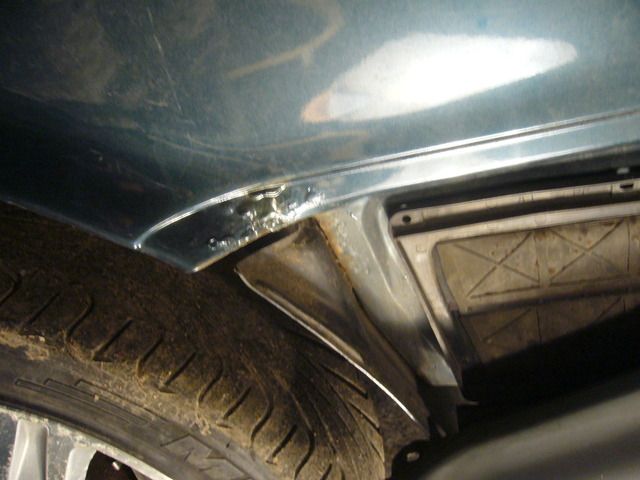

While the bumper was loose, I tackled these blebs at each side.

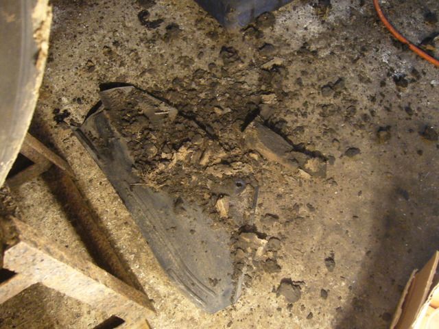

Behind the wheel, there's a plastic panel doing nowt but gathering damp mud.
A quick prod-
Squeezing the blisters, water squirted out! How it's not rotten, I don't know.
The camera has gobbled the pics of my process, so we'll do without. I flappered it all back to bare metal, slapped on my phosphoic acid, left it to dry, then did two thick coats of warm Tetrosyl over the whole area.
I left the daft bits of plastic off.
Cocking Photobucket. I rotated that one twice.

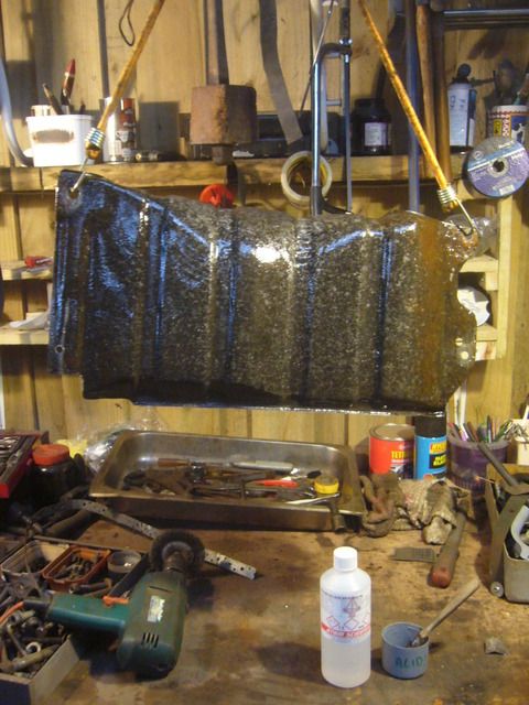

That's an exhaust heat shield which protects the spare tyre. It was getting a bit thin, so it received the acid/underseal treatment too.

I agree that those wheels won't look too bad with higher profile winter tyres on.

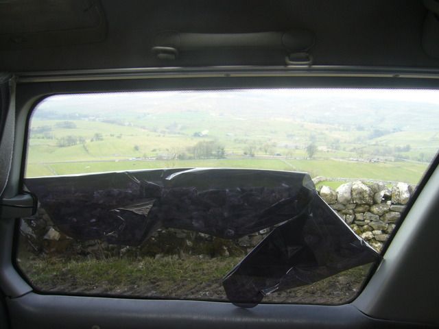

Anyway, the tint on the middle glass only looked a bit odd, so that had to go.
Warmed with my workshop hairdrier, it came off ok once I got under a corner. It has left a right PITA thin layer of dry glue, which will come off when I have half an hour more to give it.

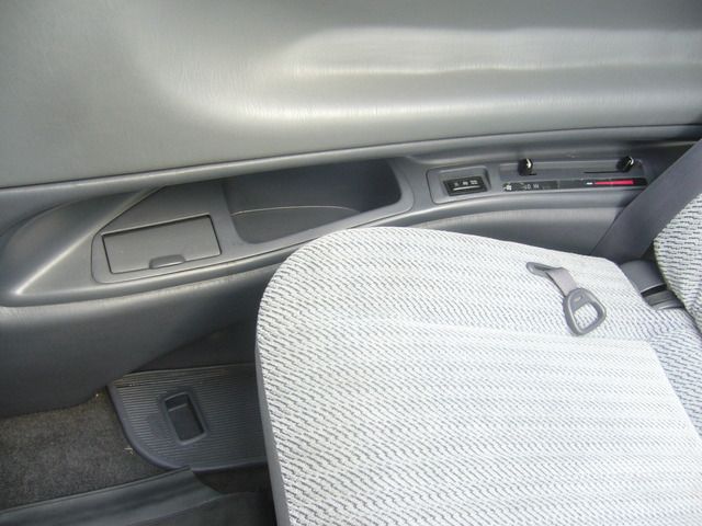

Oh, Dave_Station asked if I'd found the tool kit yet...
It's hidden under this little hatch in the floor, beside the middle row.
Nifty :)

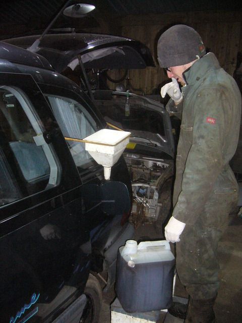

I fitted an extra in-line filter (red) before the main fuel filter, to catch any diesel crud loosened by the veg.
The veg THE VEG! TIME TO VEG HER UP!
Will took great pleasure in decanting 50l of his finest filtered golden-brown.

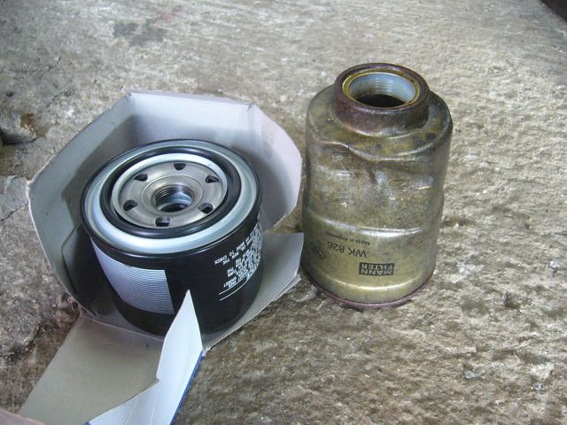

The wagon was a little unsure of the WVO at the beginning (fuel starvation issues) so we tried bypassing my little gause filter. No better. We figured the extra viscosity of the veg wasn't getting through the old main filter quick enough under power, so we boshed on the new one I had ready. Old one beside new oil filter:
That's the old oil filter still in place under the centre of the car, and the new fuel filter fitted under the far side:
Once warmed up after that it's been fine :)
The first time we brimmed it, I'd only got about a litre of petrol in before it was spilling out, so I ran it for a day, then tipped in the rest of my gallon of pez. This thins the veg slightly and has made starting a bit sharper. I'll play with the blend a bit as we go on, but so far so good.
Now on 90% WVO and loving it!

Nice work Joe. I like the veg filling setup. Looks like Will was adding some bogies to the mixture in the second pic...
