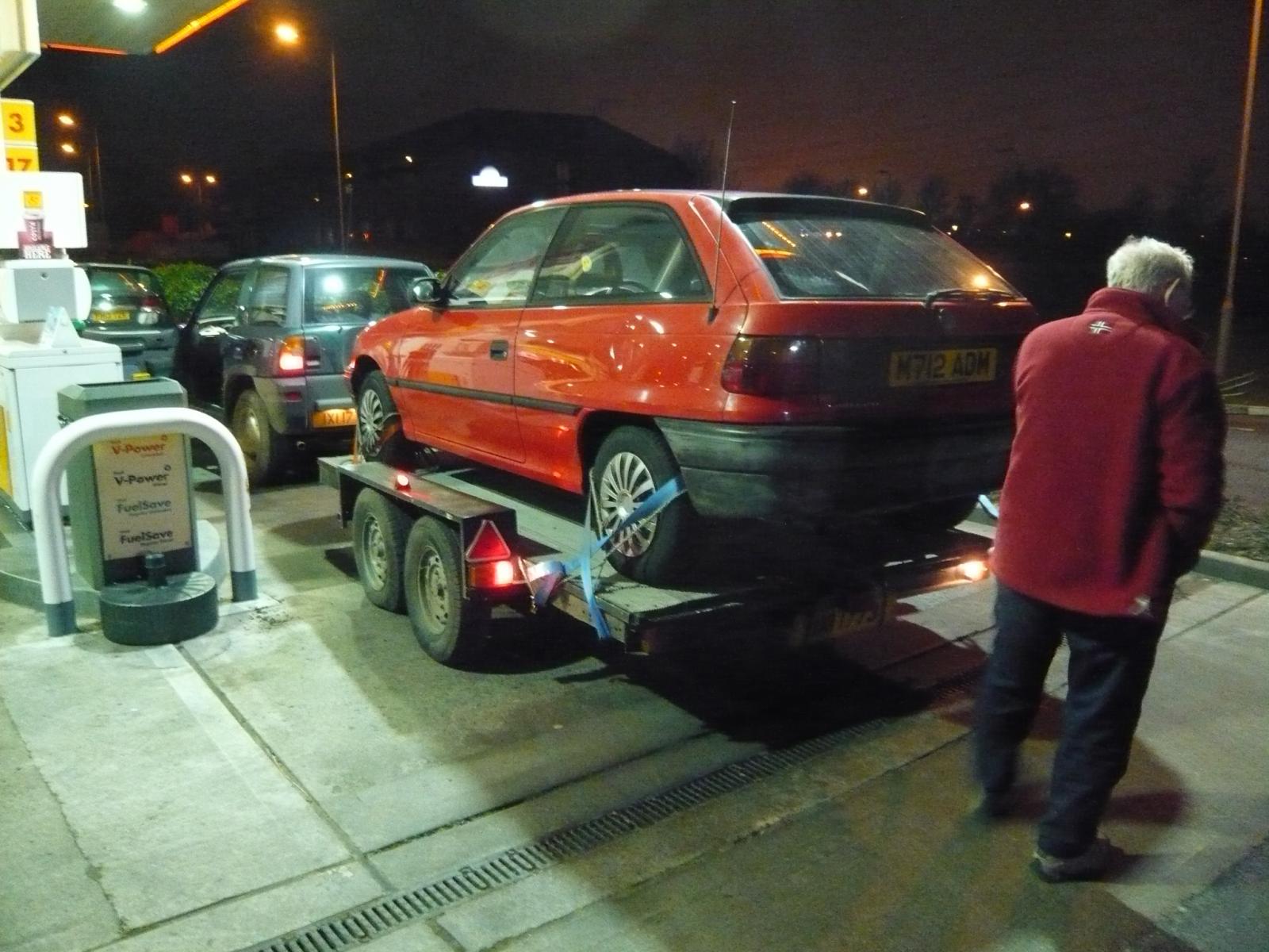

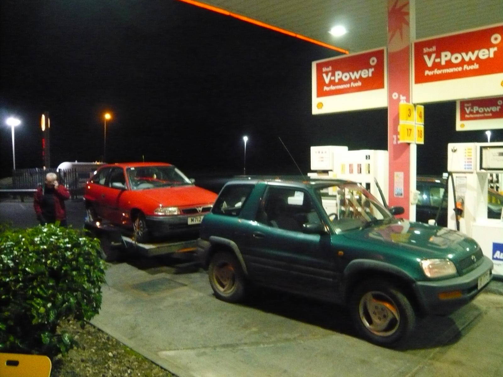

I'd have A-framed the bugger back behind the R8, but it was some distance to pull an automatic with its wheels down and I didn't want to screw up the gearbox, so we took the RAV and trailer.
We had a bit of fun* with the much-too-short ramps and then lashing the bugger to the deck with a combination of hairy old ropes and an odd pair of not-quite-up-to-the-job ratchet straps, but took it easy on the way home and it stayed put.

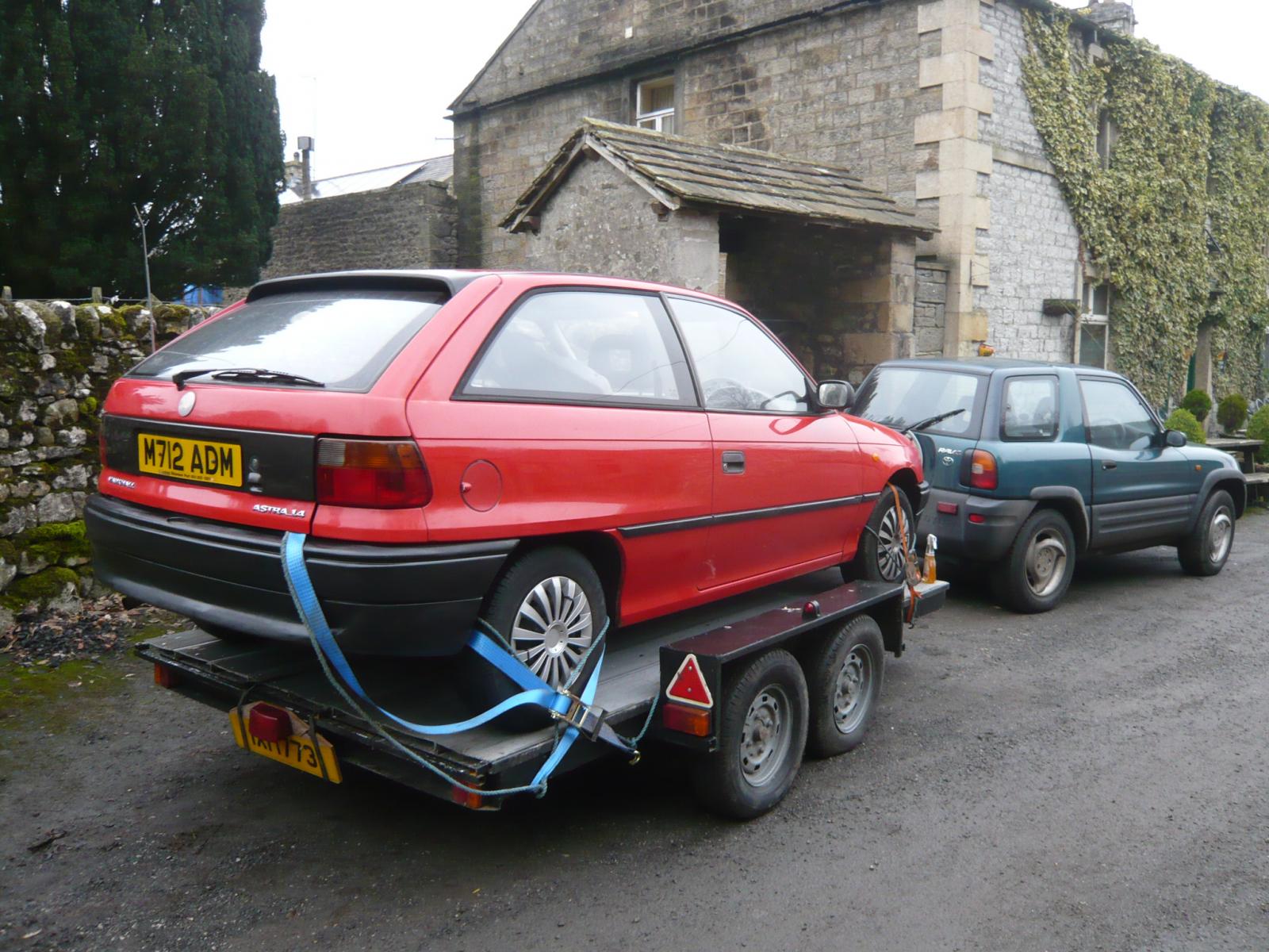

For me, the palm-sized dent above that nsr wheel spoil it a bit. We had a go at it with a toilet plunger and washing-up liquid, which did pull it, but it wouldn't stay out. When I get chance, I'll pop the trim off the inside and see if it'll stay right. The paint's ok there, and hopefully the metal's not creased, so fingers crossed for that.

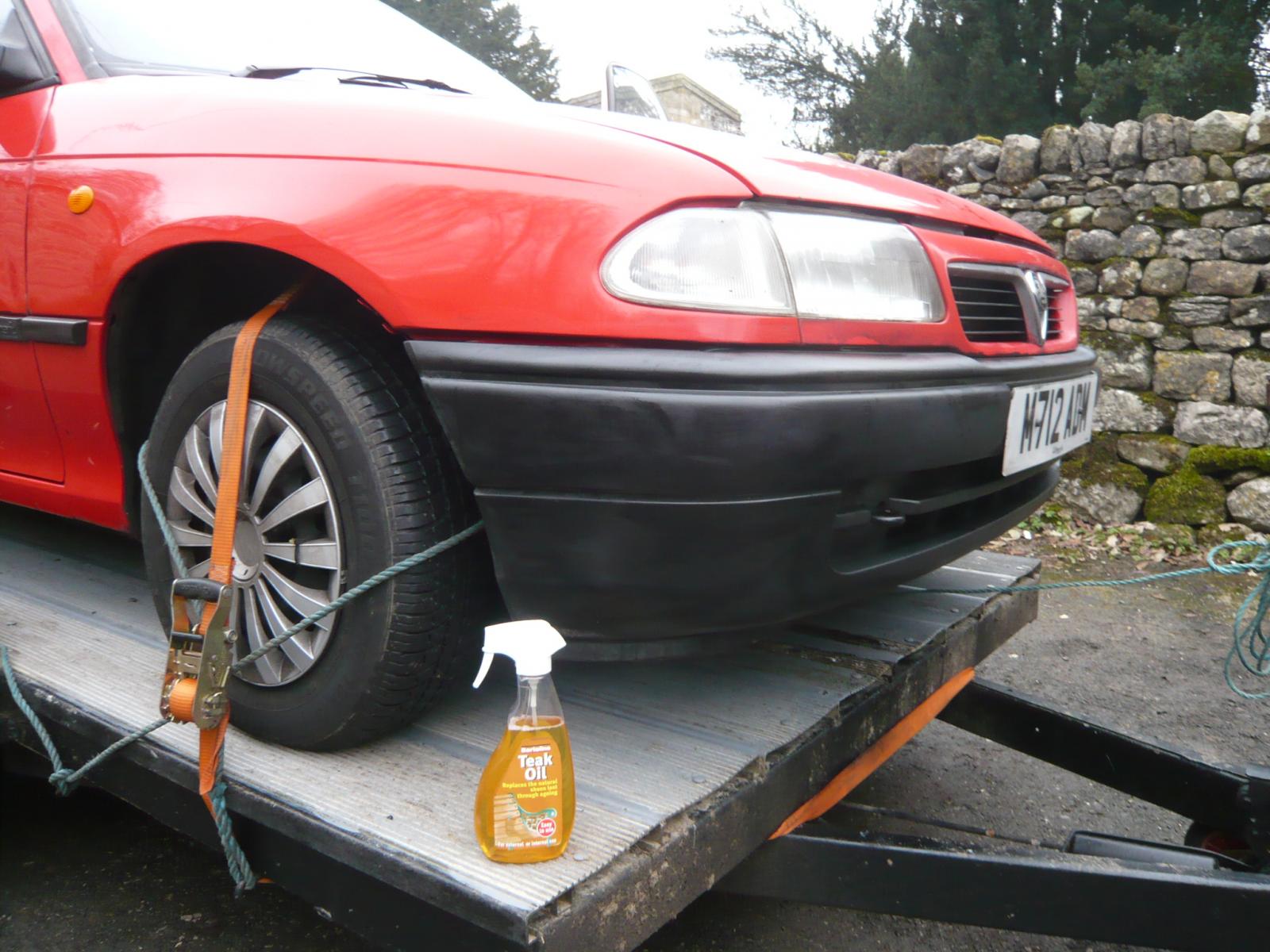

The bumpers are faded, but also streaky as though they'd been painted with something water-based and it'd started washing off. So this morning, after 30 seconds with a sponge...
And another 30 on the back end:
How much better does that look now?

Another satisfied customer and indeed seller! Krujoe, what is that yellow liquid you used to get the bumpers black there? I need some for my Corsa.

We brought it back to Kirkby-in-Malhamdale and parked the whole rig outside the church overnight to save jack-knifing the lot on the corner made famous in "Will's First A-framing Adventure".
Yesterday morning I took my trigger spray of teak oil with me, and an old sponge (for the bumpers) SUCCESS, and a bog plunger (for the dent) FAIL.

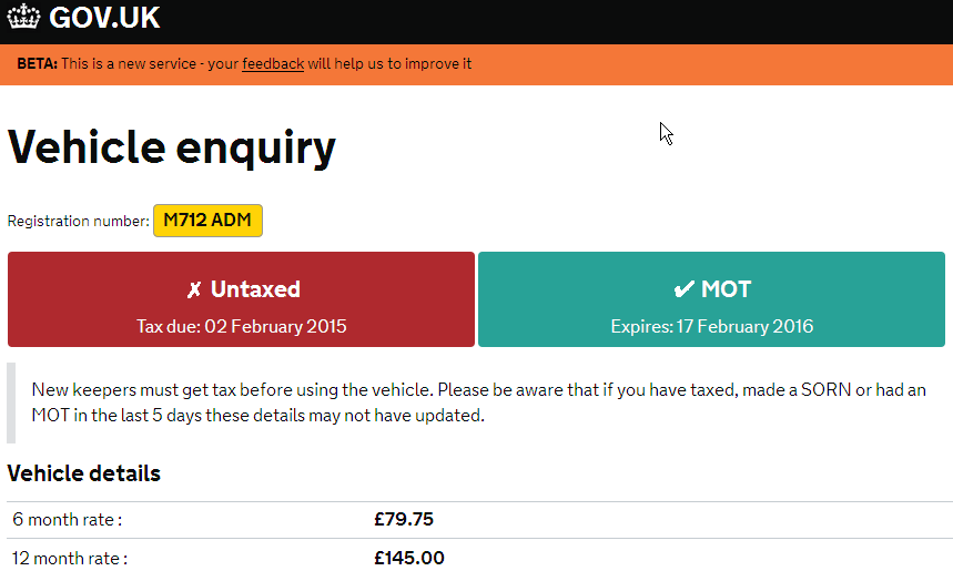

Me and Pops_KJ then took it the 20 miles down to my tame MOT man, Jack_the_Test. He's away just now, but there's a good lad in charge, who had a quiet day and stuck it straight it the bay. We met Ann there too - she lives nearby, which is nice. She was impressed with the smartness of it, and the generous boot space.
The teak oil had dried a bit by this time, but still looked 10 times better, time will tell how long it lasts.
I made the call to Ann to ask for a progress report, she said it needed only a brake pipe, which was done straight away by the lads in the garage next door. Bill for work and MOT: £114. WINNAR!
We spent £40 on pez dragging it back,so that's a tidy, low mileage automatic with a fresh test for £354. Bargaintastic tax band an'all, this one.
Ann has asked the lads who did the brake pipe to give it a "full service", so we'll see what that turns out to be, and whether they decide to stick it up her. I hope not, it should be a mechanic's dream, this one, and bits'll be cheap. She's local and could be a good customer, so they should look after her. We'll see.

Autoglym bumper care or Autosmart highstyle will work a treat on the bumpers if your looking for a more permanent fix.

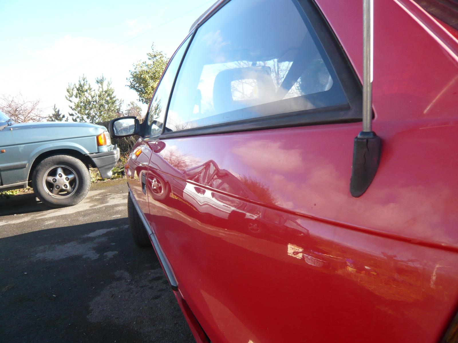

Remember this dented back quarter?

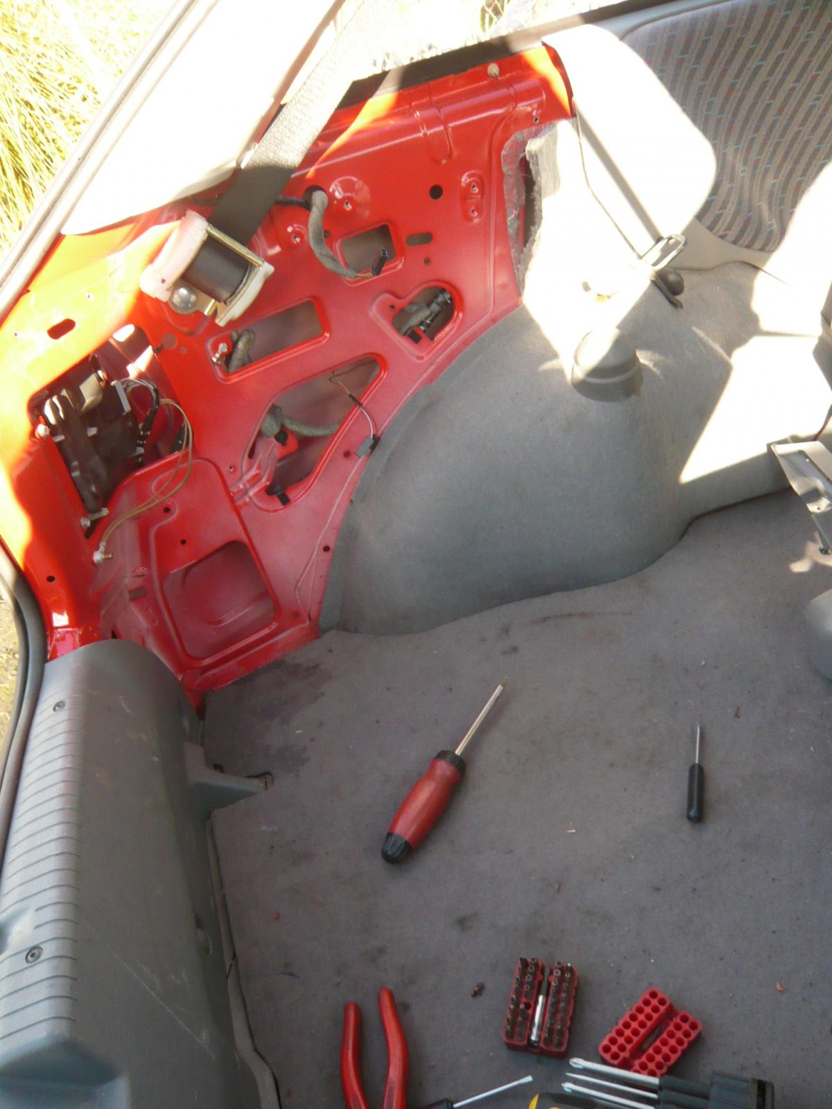

I trundled over to see Anne, have a poke about the old Disco, and attempt to pop out this imperfection.
You know a job's gonna go well when you choose the right size torx bit first time!
A couple bits of trim unscrewed, the felt pulled back, I squeezed my mitt in, and it popped right out.
Easy as that! It's not perfect, but it's 90% better, and we'll settle for that :)
Great work, I love when little easy jobs make a big difference.
