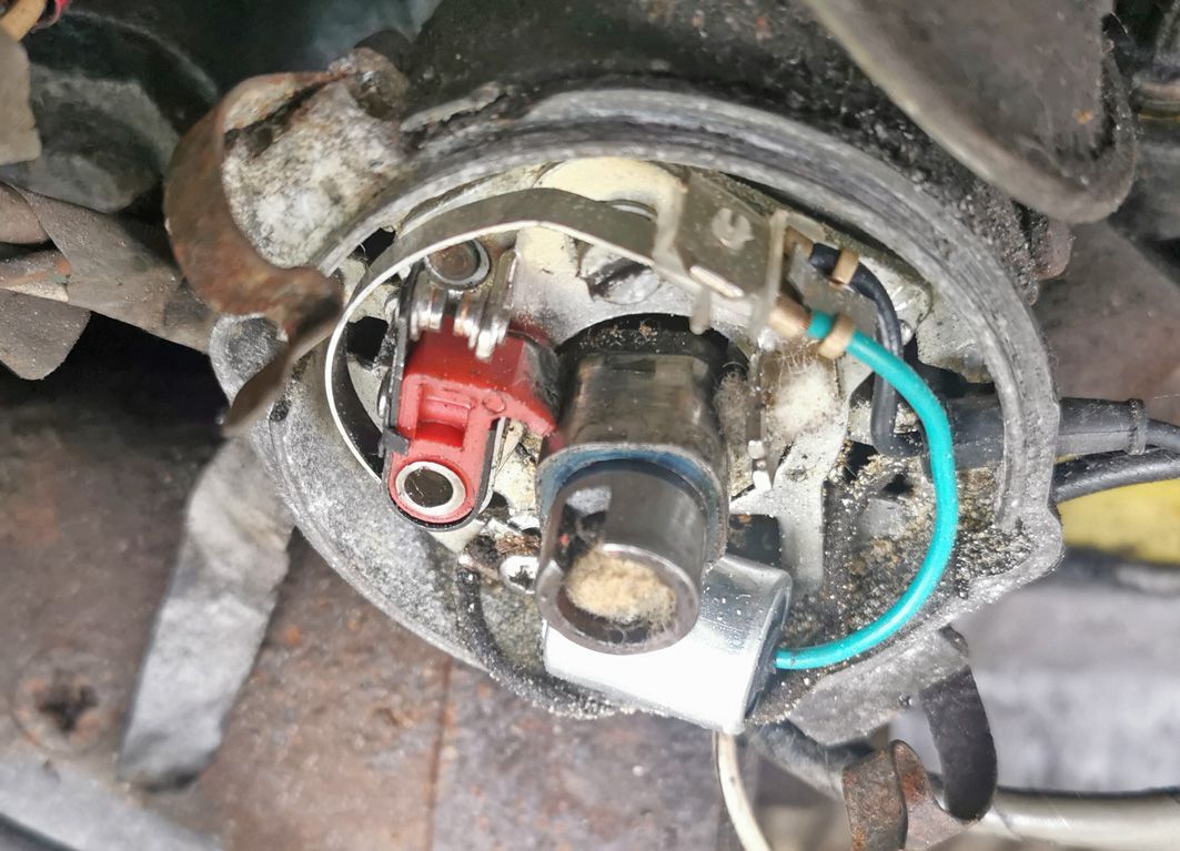

Driving the car home last time it misfired badly near home and then had a light misfire. I have never seen this before, one of the metal posts inside the distributor cap is loose and rotated! New cap and rotor needed. Anybody seen this before? Also points gap was double what it should have been.

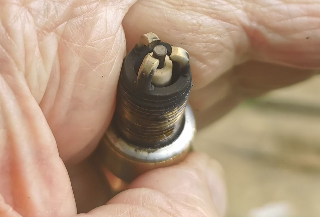

Plugs look great.
  • Six-cylinder changed the title to Six Cylinders Motoring Notes - I have never seen this before!
Yep, had that on a cap on one of my Estelles - it also destroyed the rotor arm.  Luckily I had the pre-service parts still sitting in the boot so it was a 90 second side of the road fix.  Was an Intermotor branded cap as I recall.

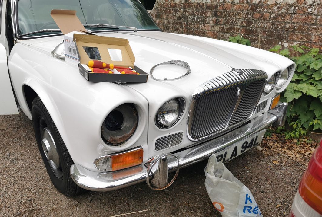

Thursday night I blew the driver's side sealed beam headlight with a blackness to it on the Sovereign S1. It made getting home in the dark hard work because the n-s is set a bit low. Today I fitted a new o-s one.
This was in preparation for loaning the car out to a local friend who is considering buying a series 1 XJ6. He used to own a series 3 and came back saying a series 1 compared well and felt more special.
Today Slowsilver and his Mini owning friend have been helping me with my Mini snagging list.

Plugs look great.

Is that a new distributor?
No just points, condenser, distributor cap and rotor arm.
Plus HT leads and plugs.

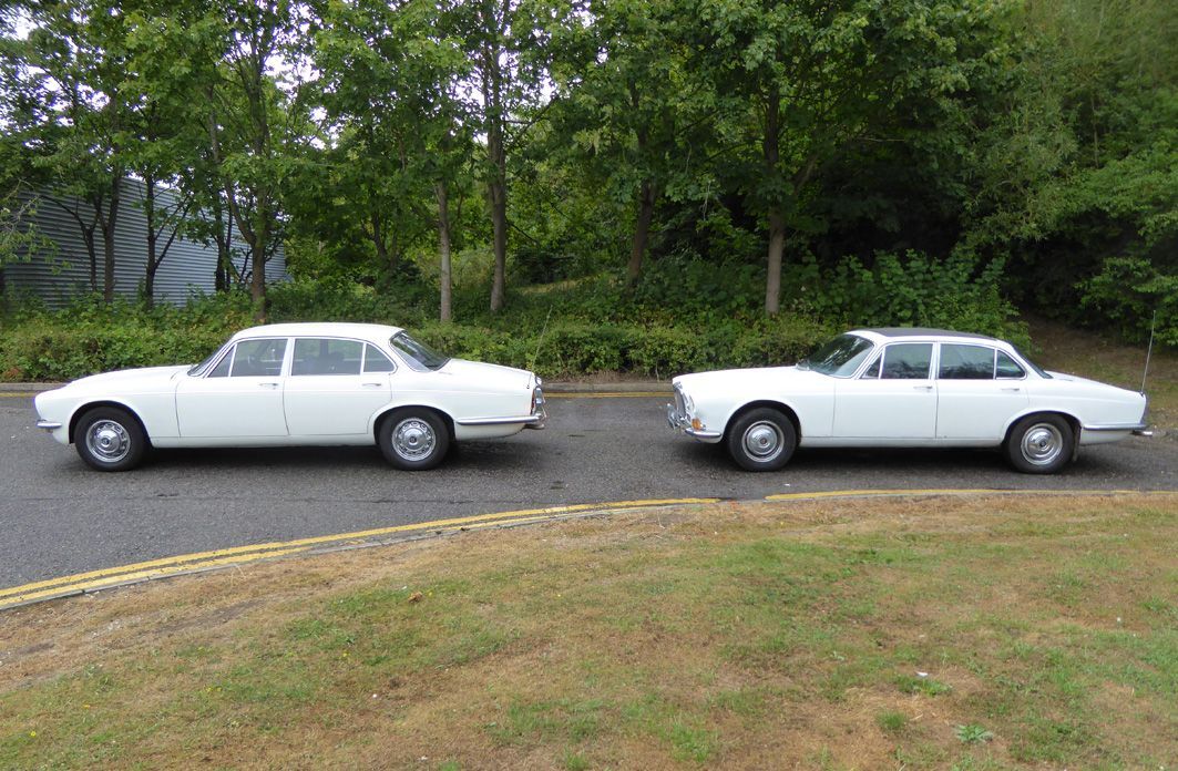

9 Years ago we decided that we wanted another early XJ6, but the price of the Series 1 cars had risen a lot so we settled for a Series 2 Daimler Sovereign, which pleased Mrs6C because she preferred the Daimler grill, fittings and upholstery.  10 days later on this forum a Series 1 came up for sale marooned in North London with no brakes at a garage that said they could not fix it, but at an affordable price. so we bought that as well.
The plan was to then decide which of the two cars to keep, yes we still have them both in running order!

That extra few inches in the wheelbase of the series 2 really helps the proportions.
I like the SWB car better.
Late Series 1 cars had the option of LWB and the series 2 cars were initially announced with either wheelbases, but later only LWB was available on S2.

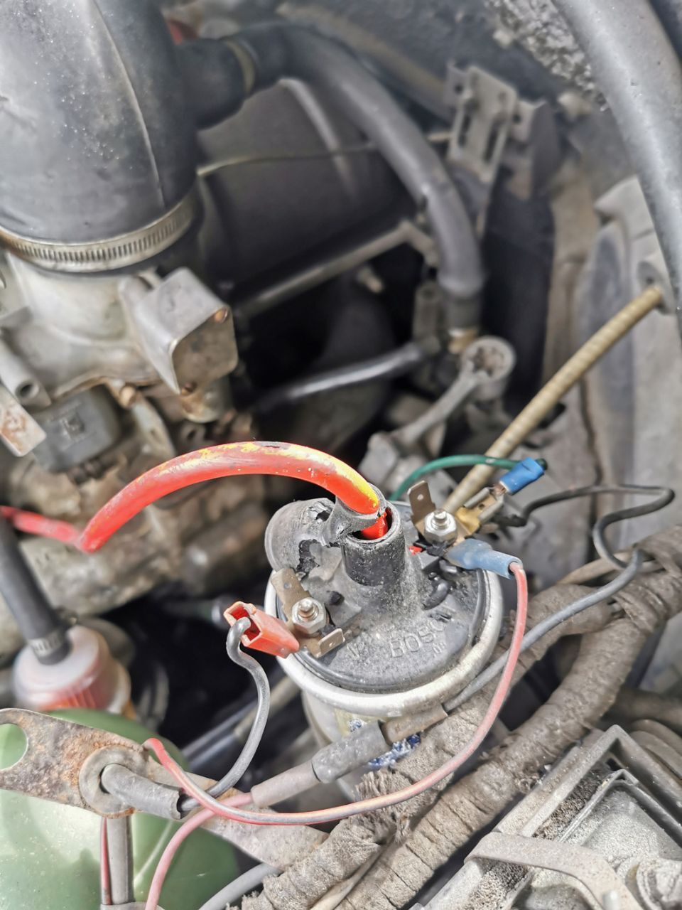

Friday afternoon @Slowsilver helped me get the Citroen DS out of storage. We found the rubber on the coil lead had disintegrated but it started well and ran fine.
A quick legal and levels check showed oils and water fine, one tyre was very low on air and the spare a bit low. Later I checked the lights as I was planning to drive it in the dark and they all worked.
I took the DS to Milton Keynes Classic car gathering Friday evening. Trouble is it had quite bad misfire on the way home.

The misfire was bad enough I did not want to drive the DS to this mornings MK Modern Classics breakfast meet.
The Alfa 156 got called on as reserve.
This afternoon was the annual Citroen DS rally. As it is not as far as this mornings breakfast meeting I decided to take my chances and misfire to the rally field.
The good news is at the Citroen rally this afternoon I was able to buy a new set of HT leads and cheeked the guys into fitting them for me. Misfire is gone and I had a lovely drive home even if it was raining. 38 Citroen DS's on a wet Saturday in a field at one point!

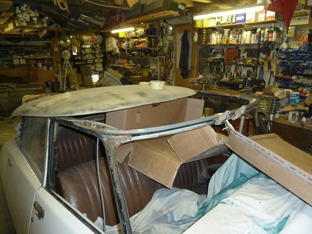

No water running down the inside of the windscreen anymore since Citroen Classics rebuilt the cant rail and refitted the roof.
Same company as I bought the HT leads from today. I asked the price and when given the price simply said is that fitted! Shocked by my cheek they fitted them then and there just as the rain started so no pictures.

Looks like rodent damage on the coil lead to me.
