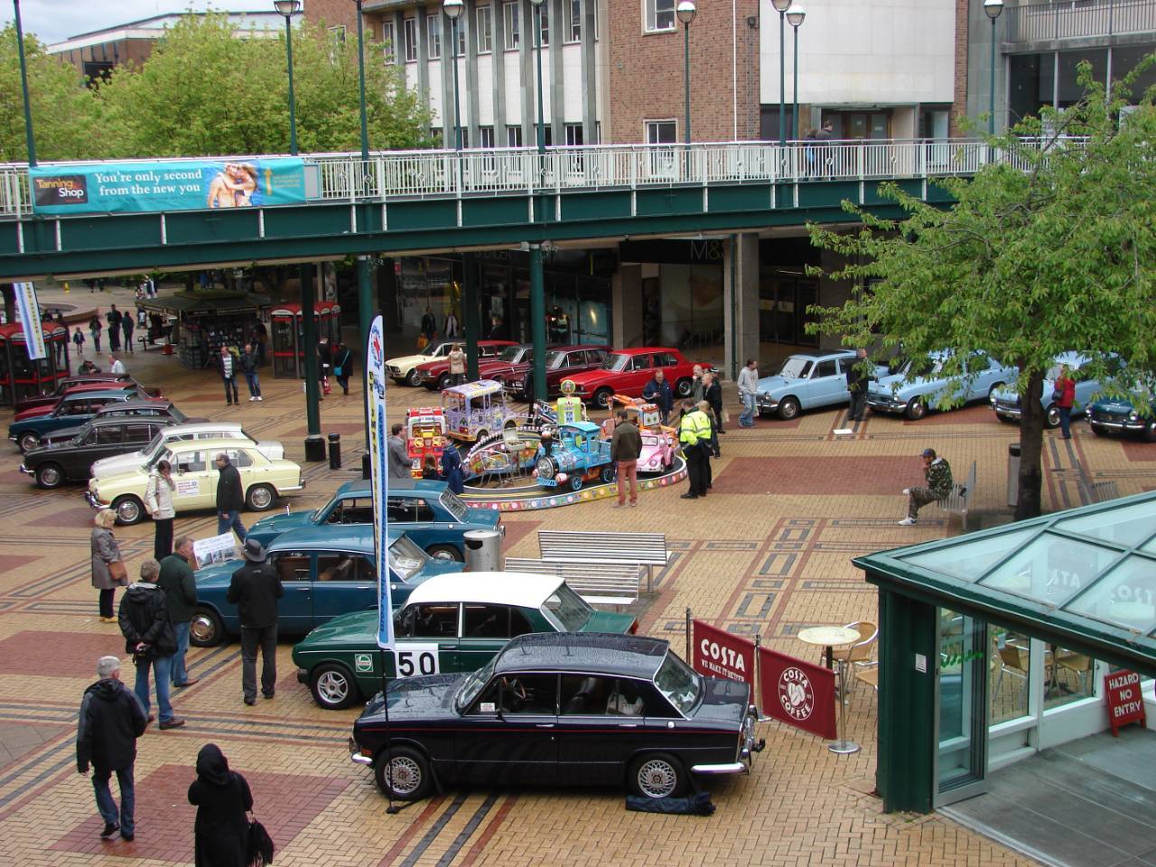

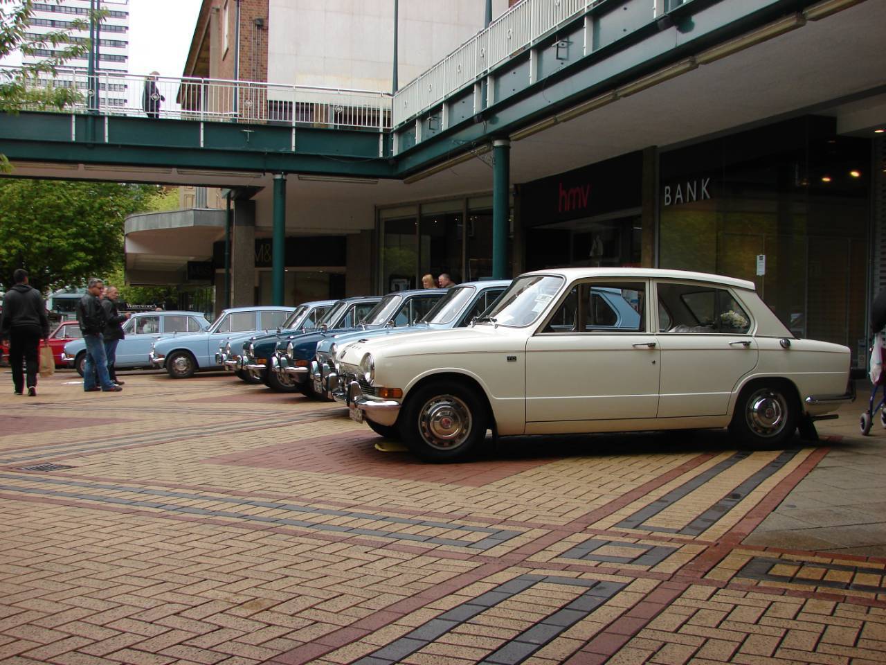

I do wonder how loud this starter motor actually is. As owner of a FWD Triumph with exposed starter ring and motor at the front of the engine bay it might sound completely normal to me.
A few years back (in fact was 9 years ago, blimey) we had a gathering in a pedestrian precinct in Coventry as part of Coventry Motorfest. There were over 20 cars there.
And at the end of the day all 20 odd started up within about a minute of each other to go and do a tour of the ring road together before going our separate ways. The sound of all those exposed starter motors ringing around a confined concrete arena will stay with me forever.
We all gathered on the slip road whilst waiting to be released on to the ring road. They had been using it for other events all weekend as can be seen by the slalom barriers in the distance. . The whole city centre had been taken over by Coventry built cars
