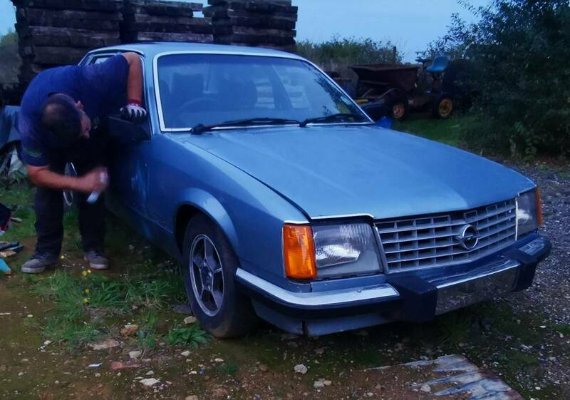

Six-cylinder Posted October 4, 2023 Author Posted October 4, 2023 Tonights motoring job was to knock the large dents out of the front doors in the Vauxhall Royale. My fiend Colin came round and took the driver's interior door trim off and worked away at getting the worst of the dent out but really the door is quite rusty. We were going to do the passenger front door as well but the sun broke and it got dark! High Jetter, Dick Cheeseburger, beko1987 and 10 others 13
richardmorris Posted October 4, 2023 Posted October 4, 2023 6 minutes ago, Six-cylinder said: Tonights motoring job was to knock the large dents out of the front doors in the Vauxhall Royale. My fiend Colin came round and took the driver's interior door trim off and worked away at getting the worst of the dent out but really the door is quite rusty. We were going to do the passenger front door as well but the sun broke and it got dark! You should get him looking at the deer dents on my* merc. Six-cylinder 1

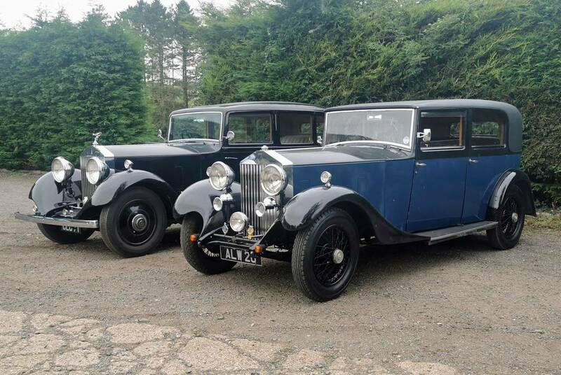

Six-cylinder Posted October 5, 2023 Author Posted October 5, 2023 Today’s car adventure was to visit my friend Ian who has a 1935 Rolls Royce 20/25. Ian has recently bought a 5 ton 4 post lift large enough for a Rolls Royce and he invited me bring my 20/25 over and we would have a look over/under it. Three thing have been concerning me about my car, the brakes seem to pull to the right, it is hard to get it into gear when stationary and is the chassis lube system functioning. We started with the brakes which are cable operated, but have a mechanical servo. In fact the front brakes are not directly pulled on by the brake pedal but are pulled on by the servo which has a drive plate from the gearbox and friction clutches to power the activator. The hand brake has separate cables. We tested the movement of the brake shoe operating arms by manually pulling on the cable and found the left front moved a lot further that the right front. We adjusted the front brakes so they had equal movement and now the car pulls up square with reasonable authority. The chassis lubrication is a lever under the dash that pushes oil out to various points under the car and it all seems to work well leaving oil drips on many points. This is why the underside of the car is rather oily. The problem engaging gears when stationary appears to be the clutch is not quite fully disengaging leaving gears turning in the gearbox. We tried taking some of the free play out of the clutch pedal but that did not help. The next thing to do is check the clutch finger clearances, but this involves taking up the floorboards and unbolting the clutch inspection plate on the bellhousing and Ian did not have time to do that today. Between my trip to see Ian, test drive and taking some fiends for a ride this afternoon I have driven my Rolls Royce 66 miles today. Bear, Mrs6C, Vantman and 15 others 18

beko1987 Posted October 5, 2023 Posted October 5, 2023 Yours looks cleaner too! Yes I heard you kidnapped some OAP's and went for a joyride Nice fix re the brakes! Did you note where these oil ports were and if I need to be careful of any cleaning it next year? And how did the carpet dry? Does it smell still? Hasn't gone crispy has it? richardmorris 1

Dick Cheeseburger Posted October 5, 2023 Posted October 5, 2023 What year is your Rolls? The smoothie hubcaps on your friend's car along with the larger headlamps give it a hint of Bugatti (when squinting... a lot).

Six-cylinder Posted October 5, 2023 Author Posted October 5, 2023 1 hour ago, Dick Longbridge said: What year is your Rolls? The smoothie hubcaps on your friend's car along with the larger headlamps give it a hint of Bugatti (when squinting... a lot). My car is 1933. I have smoothie wheel covers for mine but they were not fitted when I collected the car and I prefer seeing the spokes. Dick Cheeseburger 1

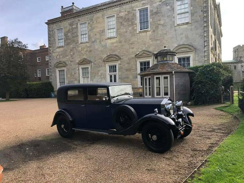

Six-cylinder Posted October 6, 2023 Author Posted October 6, 2023 My transport for today. beko1987, richardmorris, LightBulbFun and 3 others 6
