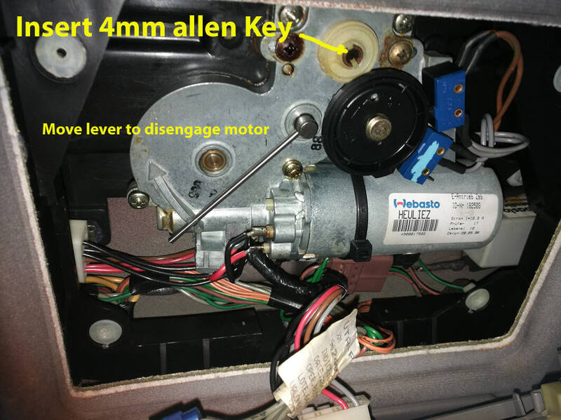

Six-cylinder Posted September 2, 2019 Author Posted September 2, 2019 Next problem The XM has sat as a mobile store for several weeks and I was delighted when it started on its own battery this afternoon and drove it onto our drive. I cleared it out and noticed the sunroof was a little bit open so I went to close it, trouble is it would open further but not close. I have an auto electrician visiting tomorrow because the indicators on the VP1500 packed up Saturday evening and I had a fiddle with fuses and a couple of relays this afternoon and now the starter won't even operate. I thought I would burden him with the problem but Mrs6C reminded me usually electric sunroofs have a manual closing key. Sure enough the wind back handle was missing (another warrantee claim against the Autoshite seller) but a 4 mm allen key did the job. Mrs6C and RayMK 2

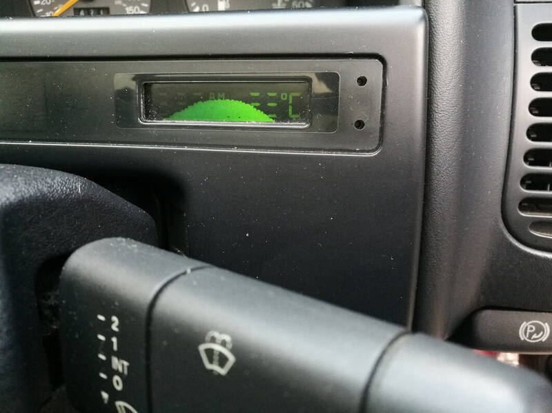

Six-cylinder Posted September 2, 2019 Author Posted September 2, 2019 11 hours ago, richardmorris said: Wot no sunroof? Presumably the climate control works perfectly? Lucky it is nearly winter! No A/C, no Climate and a bulb out in the heater controls! When I first got the car it was Feb and being rather cool I turned up the heater one evening, but was still cold and went to max, I could feel the heat but the cabin was not warming sufficiently. When I first drove the car I don't remember this being a problem and in the morning wondered what was wrong, pilot error! There is a left and a right heat control I was only using one! Driving it today reminded me of a couple more problem: Gear selection indicator numbers don't work so you just have to learn where they are. Digital clock and outside air temp has gone Green Hill! Drivers door check strap does not keep the door open
dean36014 Posted September 3, 2019 Posted September 3, 2019 Chris, that sunroof switch was always a little dicky, spraying electric cleaner in it usually sorted it out for a few months. Warranty has well expired I'm afraid ?? I might have a check strap for it, will have to go in the room of doom and have a look.
Six-cylinder Posted September 3, 2019 Author Posted September 3, 2019 2 hours ago, dean36014 said: Chris, that sunroof switch was always a little dicky, spraying electric cleaner in it usually sorted it out for a few months. Warranty has well expired I'm afraid ?? I might have a check strap for it, will have to go in the room of doom and have a look. That is an even worse warranty than when they were new! When I sold Citroen's I remember our service manager arguing with the Citroen warranty manager about claims and I was told Citroen had a warranty budget so it was used up hard luck! It looks like I need as many bits for the XM as the CX!

Tadhg Tiogar Posted September 3, 2019 Posted September 3, 2019 15 hours ago, Six-cylinder said: ......Digital clock and outside air temp has gone Green Hill! The LCD probably still works alright, but this looks like a sign that the polarising filter film that is placed over the display to achieve the green-on-black effect has failed. CX S2s have the same problem. Not an easy repair, but can be done.
