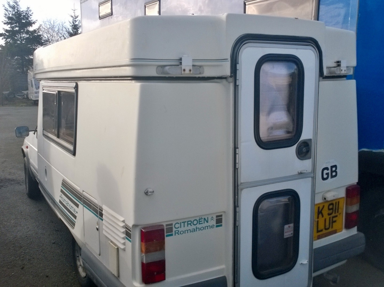

Behind it was a few campers including ex race motorhome which had full workshop in back.

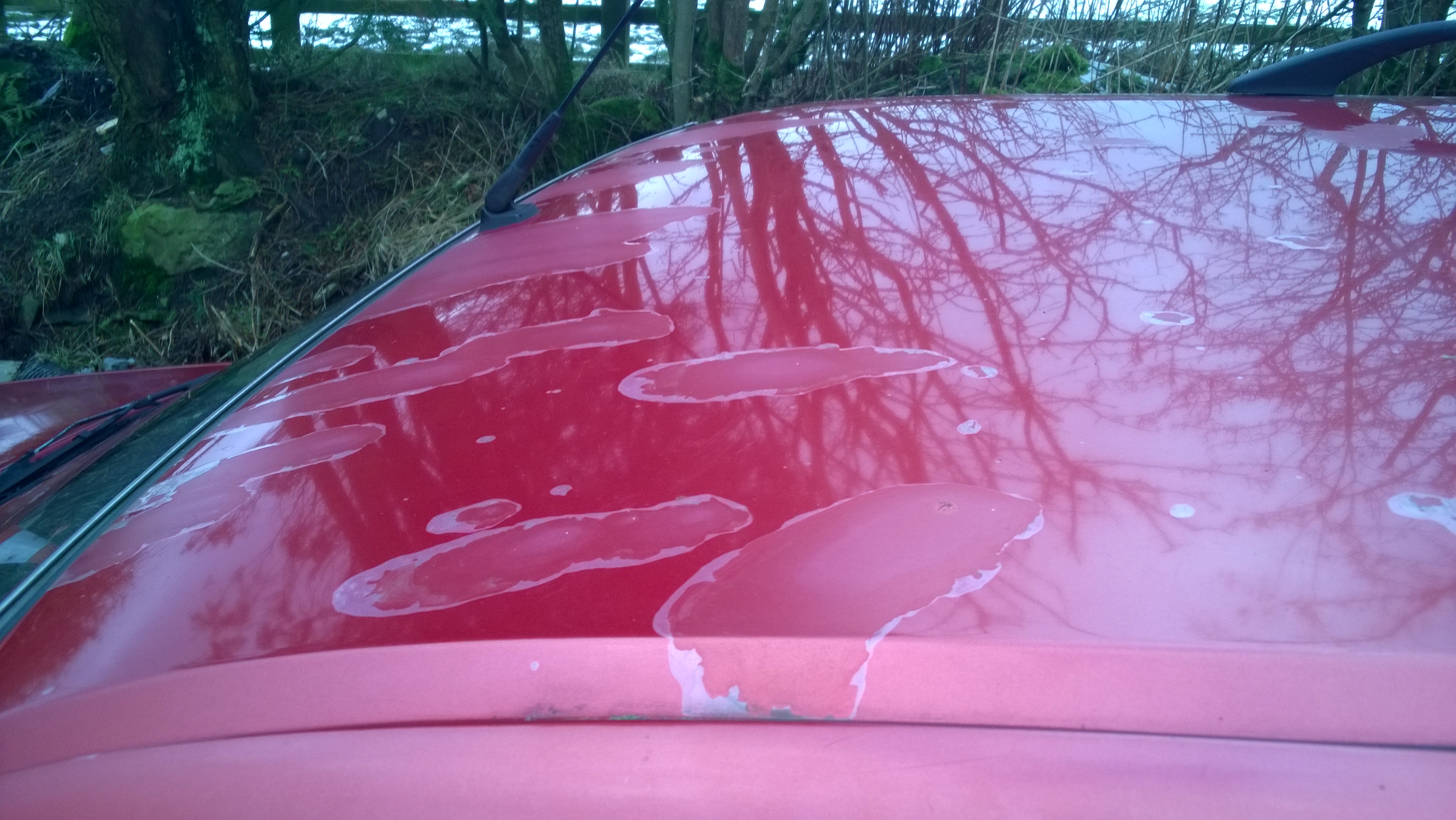

Downside is that it is Lucas pump (should have checked that). Wishbone bushes need doing as it wanders and it is epically slow compared to my blue one. Got lacquer peel on roof and bonnet.

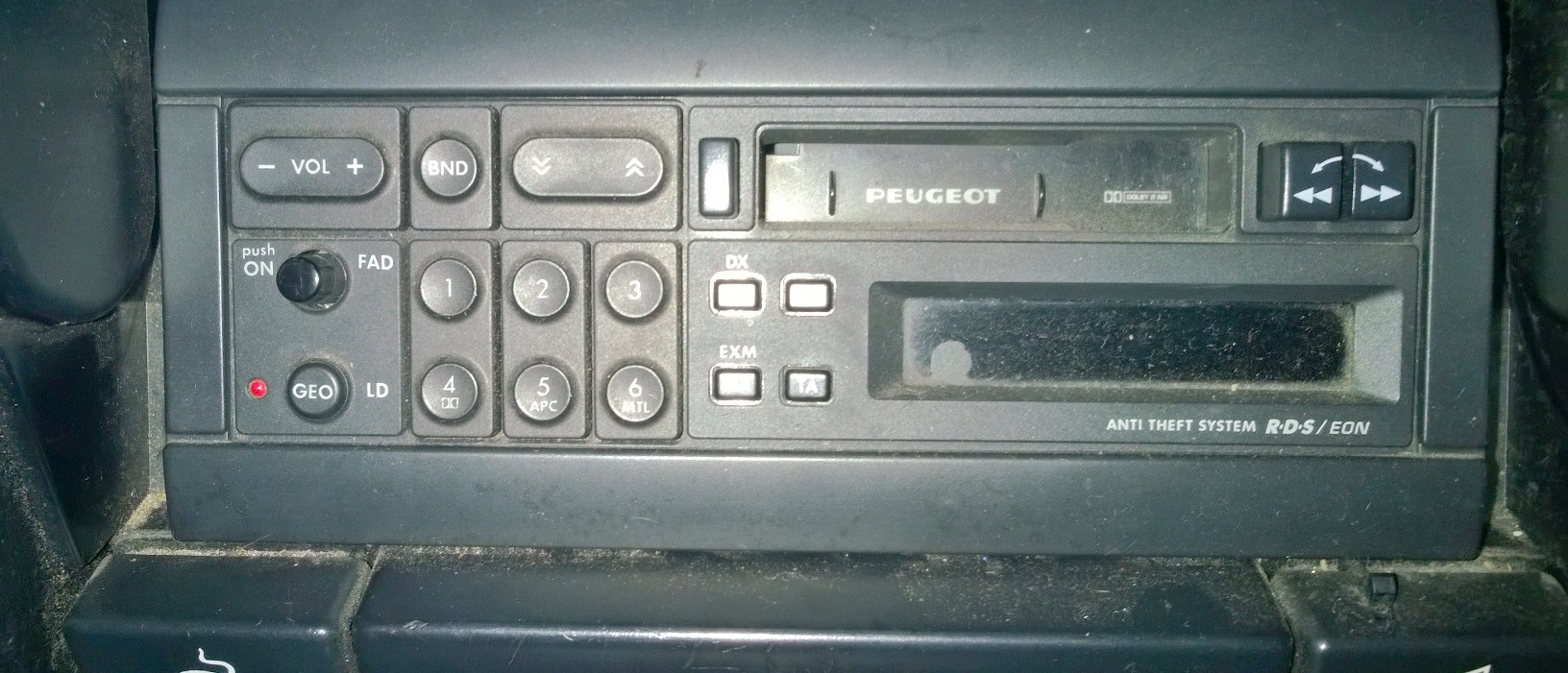

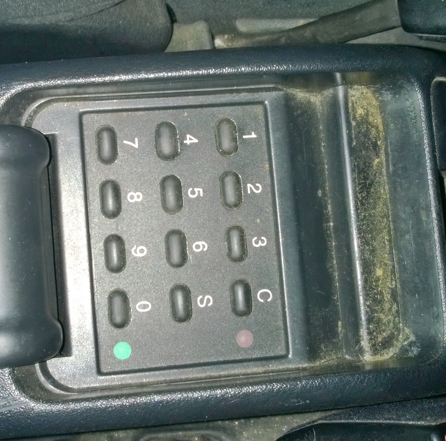

For some reason they have put an immobiliser keypad in the storage bin.

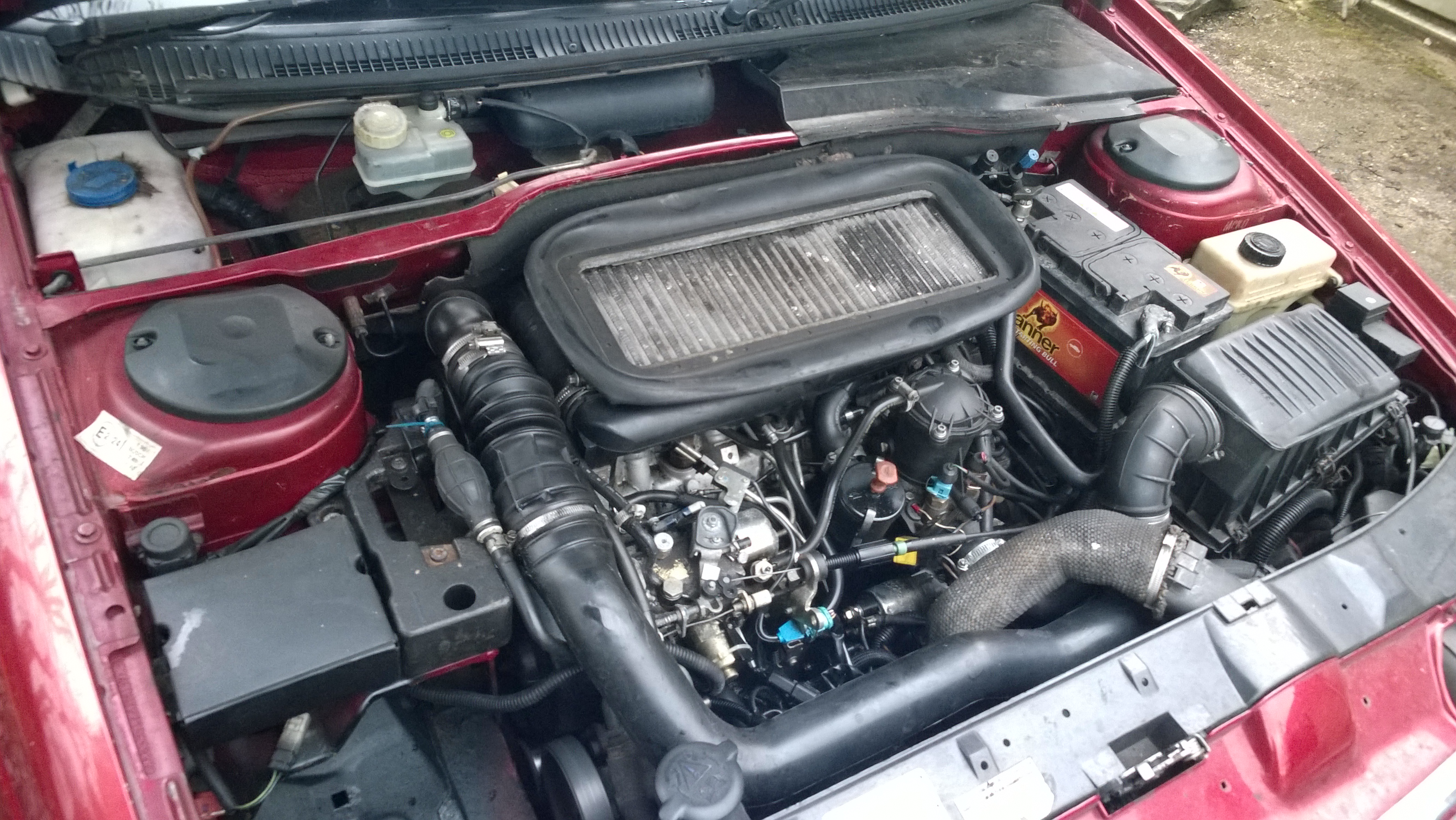

Other thing I noticed on the way home is that temp sat at 90 and would increase going up hills. Is this right?
The blue one is 10 degrees cooler normally
Temperature doesn't sound right, all my 405 TDs sat at just below 80C normally and would go up to 90C up steep hills etc. before the fans kicked in.
Shame about the Lucas pump, these late run 405 TDs are fitted with them, but at least you have a donor Bosch pump.

85deg is about right when the thermostat has opened up in my experience, it should go a bit higher than this before the stat opens - I changed the stat on all of mine and think I got the 88deg version although 82 was also an option from memory. That said, it should not go higher than that under any circumstances. So a bit odd given the new water pump and rad (the fact the latter has been changed is a good thing). How much higher does it go? Is it losing any coolant?
Edit: are fans kicking in - didn't you have relay issues on your last one?
Yep fans kick in. First thing I checked after last time 😊
For me something is up, not sure it should be running that hot. Coolant it up to top, only done the trip home so didn't spot any leaking.

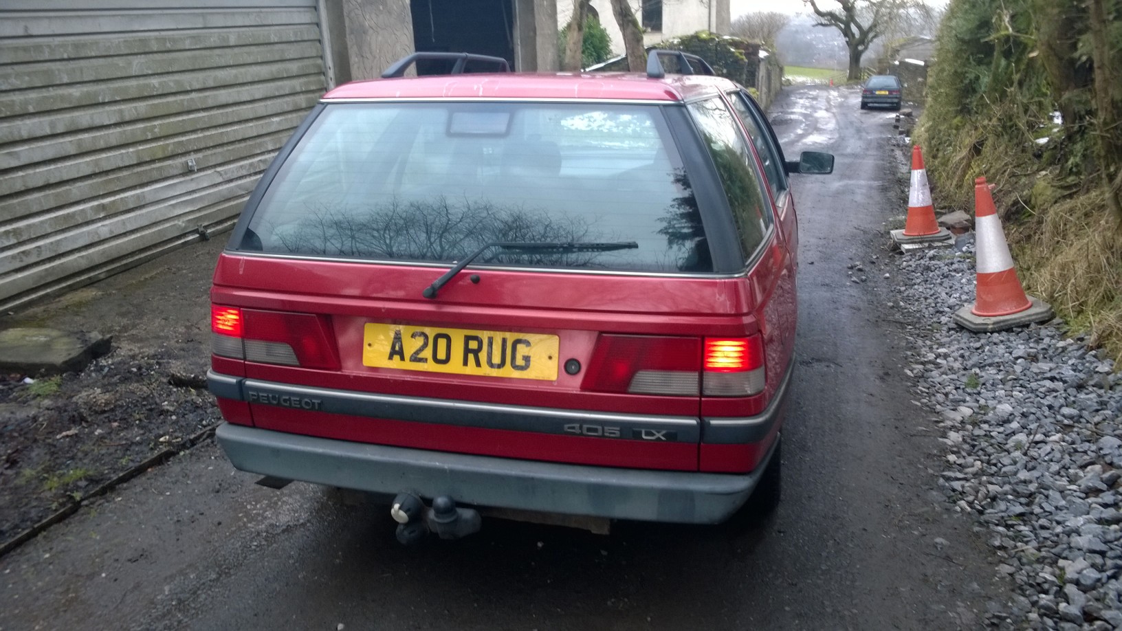

Is that a stuck-on LX badge from something else? Seems out of place.
Lovely! Had a GLX Dturbo estate myself on a 'n'.  What year is yours? That looks a really late one- what with the high level rear brake light and the LX trim- the  RUG 'cherished' plate makes it hard to be sure exactly.
I agree with the above commments re the temp- mine only ever got up to that when a fan relay blew on a long climb.
The numberplate was a personal one as one of previous owners had a carpet shop. We are moving house in a month so might see if I can swap it for some carpets 😊

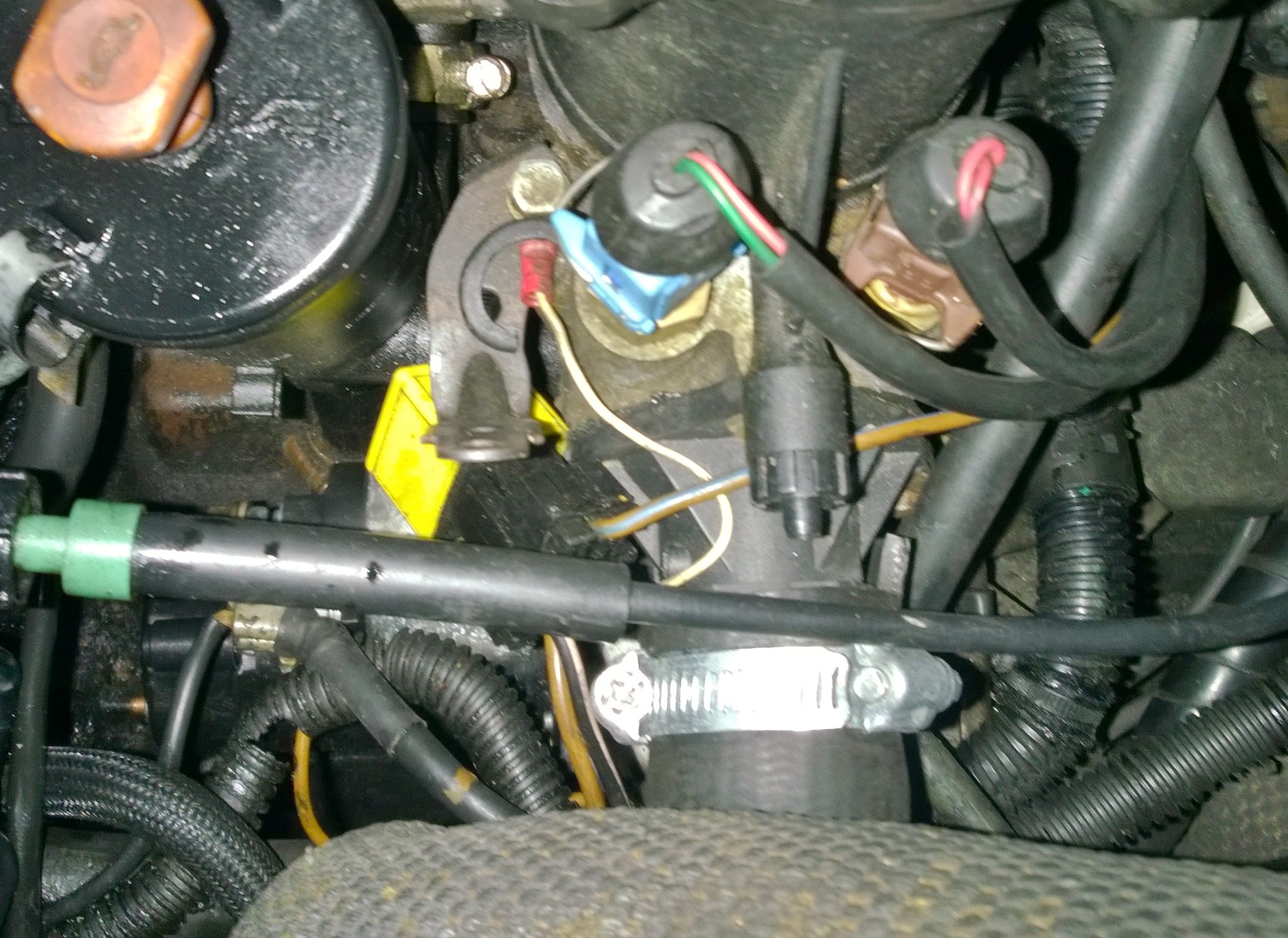

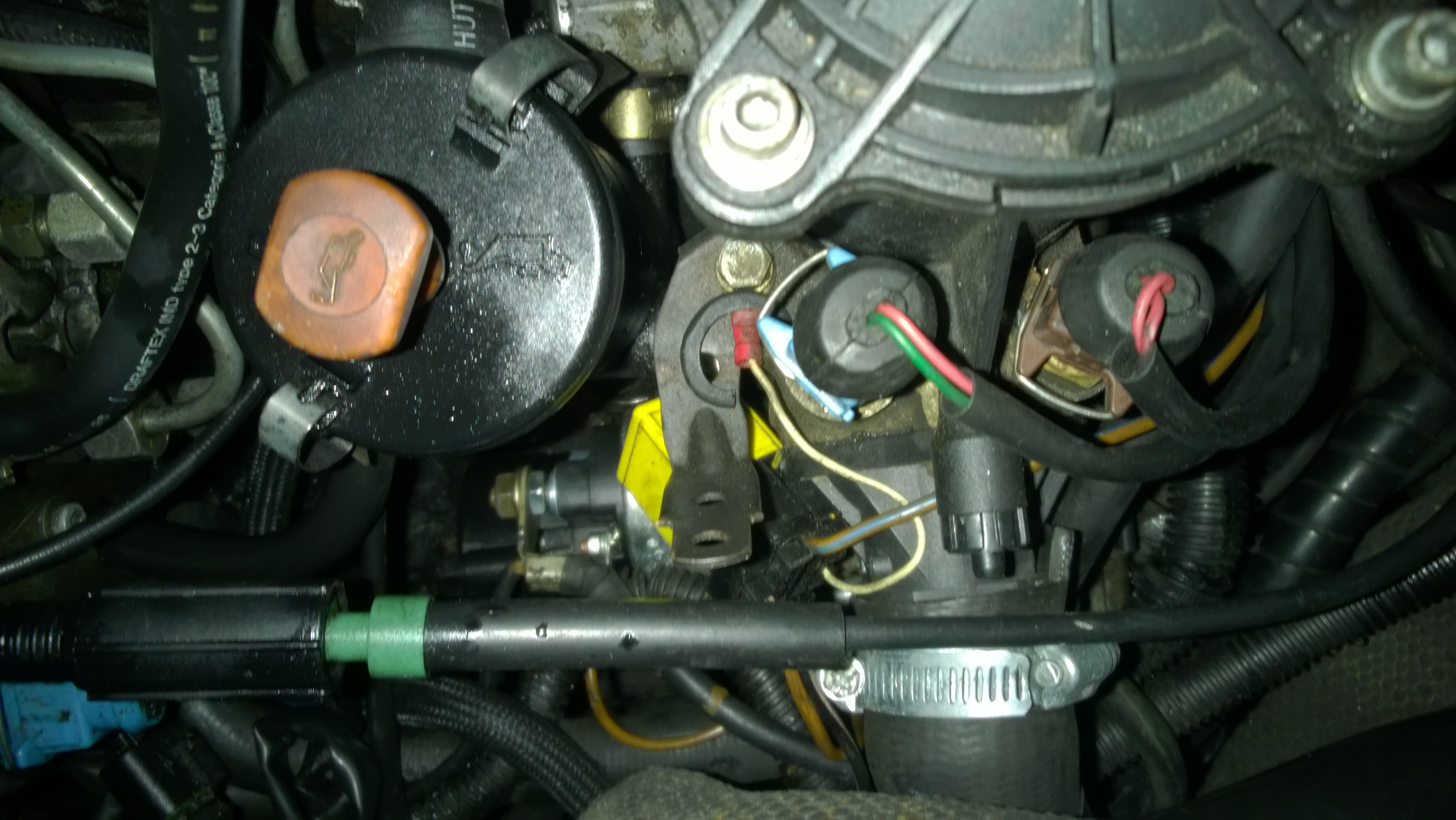

Poking under the bonnet after dark there was a random relay. Any ideas? Seems to be feeding the starter I think

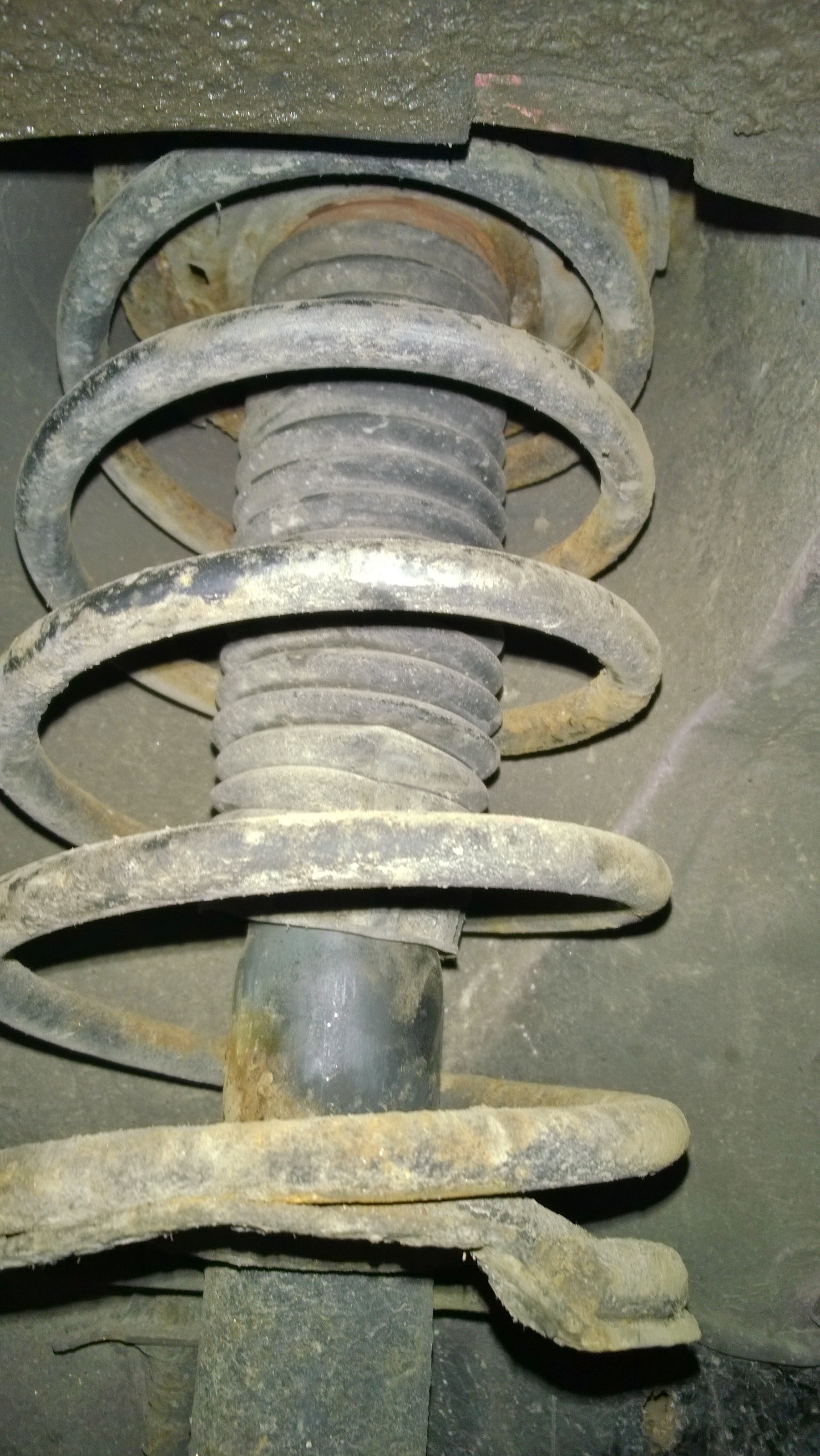

Second one is that the drivers side suspension is lower than passengers side. Between top of tyre and wheel arch on pass side i can get 5 fingers, drivers I can only squeeze 3. Felt the spring but couldn't feel any breakage.
Any ideas on this?

Failed water pump unlikely. That would do stuff like stopping the heaters working. Could be a mammoth airlock, especially if someone has replaced the rad. Get it parked so the expansion bottle is the highest point of the system (I find uneven ground handy for this, or jack it up) then go around 'burping' all of the hoses.
Do the 405s have an xud7 or xud9 in them?
Either, depending on age.
Might be headgasket - if it doesn't overheat, I wouldn't worry at the moment.

Jack it up high, drop the coolant, remove all the bleed screws (there are at least four but I can't remember where they are, thermostat housing, rad and heater pipes IIRC), get a 2 litre pop bottle and cut in half, put the neck in the rad cap spout to get yourself some more height.

You have an earlier thermostat - however Im a bit puzzled as I thought the intercooler on the 405 was front mounted not top mounted like the BX
EDIT  - ignore me on the intercooler that was the ZX/306
Edit 2 - Ignore the thermostat thing as I have just re read and missed the water flow issue - I only mentioned it as early stats did sit at just below 90, later ones ran cooler, not sure if that was to try and stop OMGHGF

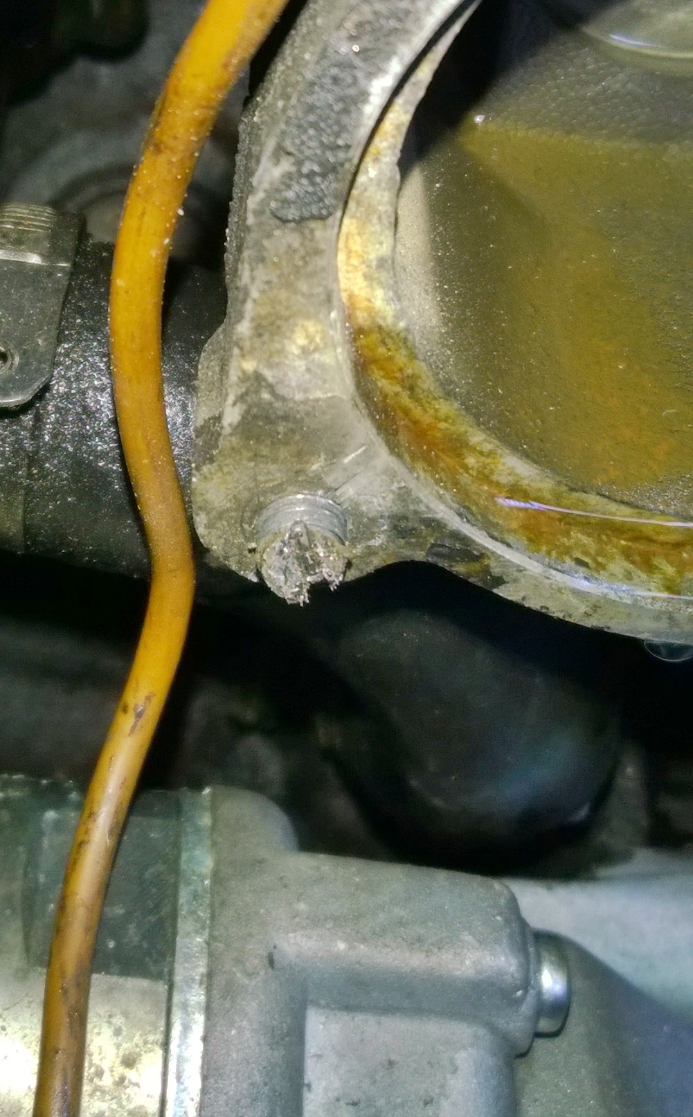

Had a play today with 405. First off change coolant, like an idiot I managed to shear one of the thermostat housing bolts.
Whipped off hoses and managed to cut a slot in top of head so could unscrew it. All back together I hunted for bleed screws and I couldn't find any. I have got one on top of rad and cant find rest. Any pointers?
Temp is still doing its thing. Sits at 90 any load it climbs to over 100.
Swapped the wheels off old pug and onto new one. Ball joints and wishbone bushes need doing.
Measured the front heights and the drivers side has 8cm difference between top of tyre and bottom of wheel arch, passengers is 10cm.
Wheel off and spring looks fine. No obvious cause, very confused.

I think I am going to give it to tame mechanic to bleed coolant, sort front drivers side drop, change ball joints and wishbone bushes as I have run out of ideas.
No it cant be as I can't find the bleed screws. Xantia ones were obvious, not so on pug
I just did a quick Google search on XUD bleed screw location and one of the links was a thread I posted on the Club Peugeot forum several years back. Funnily enough on that car it seems I could only find one bleed screw like you, however on another one I had (I ended up having four of the buggers, all '94 model year 1.9TDs with Bosch pumps) I am sure I found three bleed screws; the rad one, one on the top heater pipe just before it enters the bulkhead, and one on a plastic hose stub going into the fuel filter or thermostat.
The bleeding is critical! Look hard for those bleed nipples-there are 2 of them & it takes ages to get it properly bled. I have an old anti-freeze bottle that fits exactly into the expansion bottle & use it to keep the level up as I run the engine & bleed the system. There could be problems with the obvious, such as blocked hoses etc. but if the previous owner was a mechanic & says he'd recently done a new pump I can't imagine it would fail quite so quickly.
