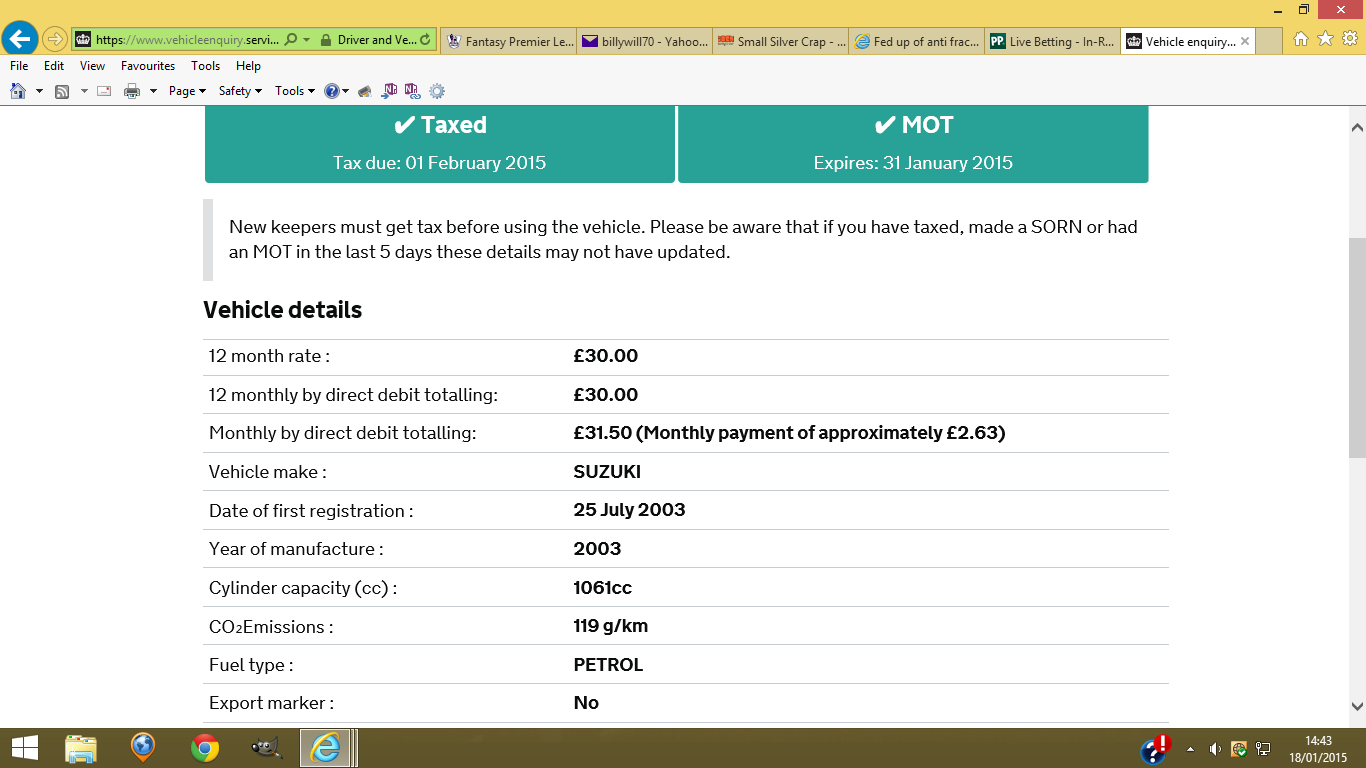

That's a right little win-mobile that. In other good news, Matt, according the Vehicle Enquiry website, it's only £30 per year tax!
https://www.vehicleenquiry.service.gov.uk/
£30 a year tax!  I am amused by the option to pay monthly.
It is indeed, I'm sure that 99% of for sale ads will gladly say that in the title (as will mine when I sell it).
£2.63 a month! Not sure why anyone would do that.
