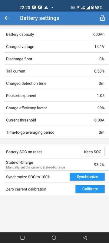

The 100% charged level is set upon installation, and now I have the LiFePO4 batteries, I can see that sometimes the full point (i.e. when the charge current tails off to next to nothing) doesn't correspond to 100%. I suspect that it's not measuring discharge and charge currents equally accurately, so getting out of sync after a few charge/discharge cycles. So I then have to reset it manually when I know the batteries are full.

It automatically sets the 100% level whenever over a certain voltage, current has dropped to a certain level, after a configurable delay.
It has an additional input I can use to monitor the starter battery.
It'll calculate the remaining battery life at the current...erm...current.
I can configure it to stop the charging above a set voltage, which may prove useful to avoid high voltage/low current charging whilst driving, which isn't ideal for longevity.
The accuracy specs are better, ±0.4% versus ±1%.
As a bonus, it has bluetooth so can easily check stuff without looking at the dashboard. I can envisage time in bed doing exciting stuff like checking out the app.

If it's any help, I've put some cycles on the battery in the workshop with our programmable dc loads and a charger on a timer switch to sort of simulate a few weeks of general use, being charged at 60A for an hour, discharged continually at a varying current from 0.5A to 40A, trickled at 5A for a few hours a day to simulate a solar panel but never let it get more than about 75% full. The victron recommended battery settings work quite accurately at tracking the capacity even when it's had small cyclical loads without ever getting full up. If you leave the settings as lead acid (with a lower charge efficiency particularly) then the battery monitor will drift down to reporting a incorrectly lower remaining capacity over time.
I changed the "charged voltage" to 14.3 as my battery was still drawing a bit of current occasionally at that voltage.
Incidentally I think these batteries use the 280AH cells, not 305AH - there are several other manufacturers selling the same super budget "300AH" battery in the same case and people have tore them down to find 280ah cells. A little disappointing - the capacity will probably drop from 305ish to 285 ish over the first 20 cycles, then plateau at that.
Think my settings are fairly similar to that, although still tweaking them.
I've set it to show 100% full at the point the current is next to nothing; with me not discharging them heavily at the moment it's always 90%+.

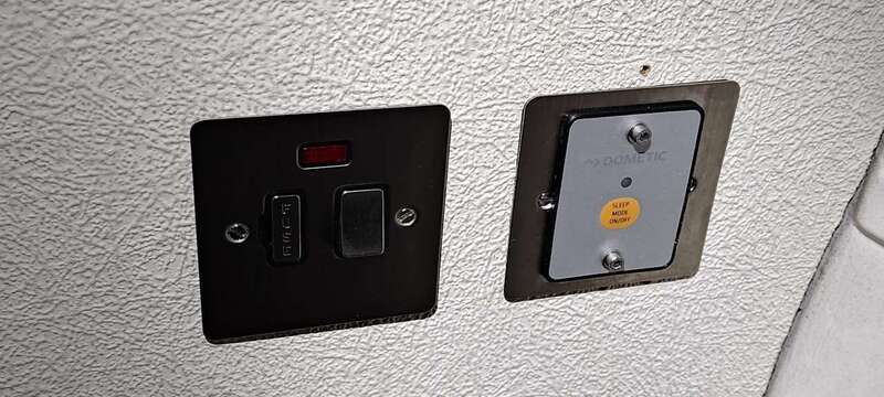

I also bought a new remote control for the replacement mains charger. The only real functionality it has (apart from a status LED) is being able to switch on and off Sleep mode without messing about with the DIP switches on the charger. I suspect that's a crafty move to make you buy the remote! Sleep mode is just a half power charge (40A) without the rather loud cooling fans running, although it turns out that it'll still run in full power mode until the temperature rises.
Unfortunately the remote for the previous charger was bigger than the new one...

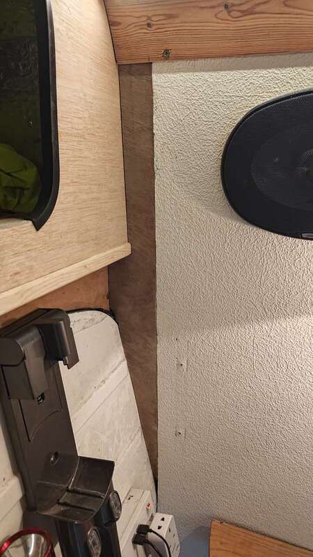

...and due to a numpty moment whilst cutting out the original hole, the new one no longer covered the butchery.
The nearest solution I could think of was to use a matching blanking plate to the FCU , and cut a hole in that for the remote.
Two small holes to fill, but easy to do without being obvious.

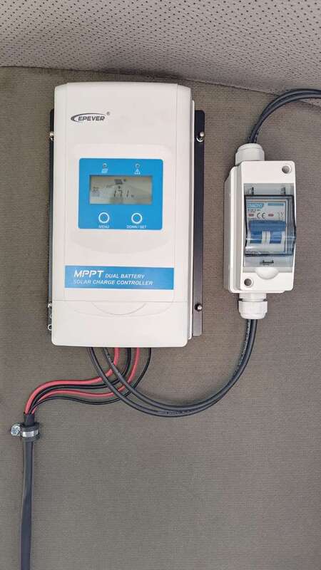

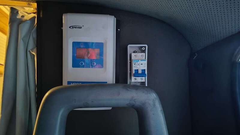

Other news is that I've decided to add a solar panel to it. Couple of reasons - having a bit of charge flowing into the batteries during evenings and mornings will slow the discharge while we're overnighting with the AC on.
But secondly I've started a bit of a business as an auto-electrician specialising in campervan systems, and I've been asked several times about fitting solar panels. I wasn't entirely comfortable for my first install to be for a paying customer, so I wanted to gain a little experience first. I've fitted but not wired up a solar controller...

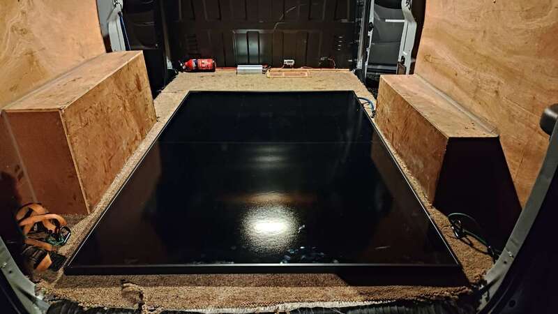

...and today purchased a new flat screen TV panel
£57 for a standard sized 400+watt domestic panel, versus double that for a sub-300 watt panel sold for fitting to a van. Partly down to the economies of scale manufacturing in big numbers, but I suspect a bit of it is the 'campervan tax' applied to things sold for that particular purpose. If I've measured correctly it should fit nicely on the roof...

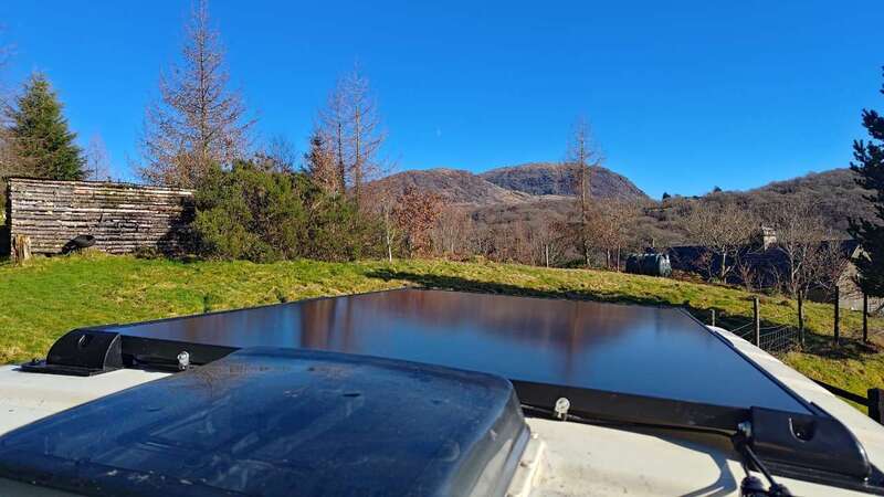

Today I hoisted it up onto the roof, and after abrading the areas to be bonded I stuck it in position. To avoid the risk of the panel's weight squeezing the adhesive out from the bond gap, I popped a few tile spacers before seating.

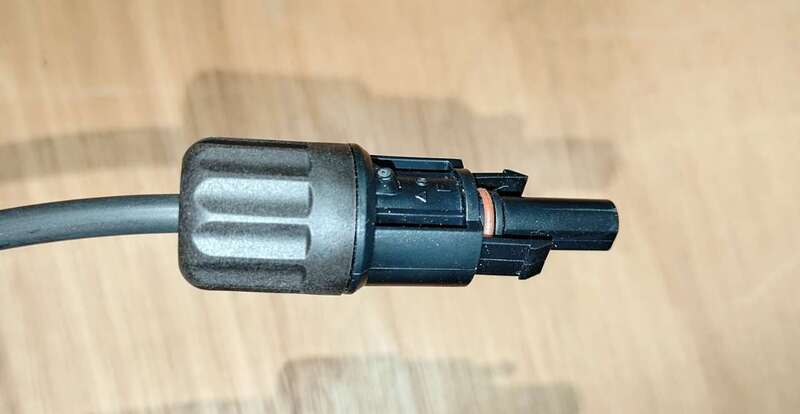

Using this, and the potential business as excuses to buy another tool, I bought an MC4 crimper. Seems to do an acceptable job:
Then the outer housing just snaps into position, noting that the male housing actually holds the female terminal...
I've yet to fully secure the panel, but will do so tomorrow once the adhesive has cured. But it's in position at least!
Good idea with the tile spacers - I've got a similar panel to fit on my new camper topper thing I'm building and was going to use similar brackets but I want the option to remove them without too much damage. The tile spacers will leave the adhesive thick enough that I can cut it off with some cheese wire if needs be.
In my case it was more that the adhesive I'm using (OB1) had a minimum bond thickness of 1mm. You see YouTube videos with folk putting weights on the panel to squeeze it all down, when in reality they risk causing a weaker bond! You also see people fitting wind deflectors at the front of them, not realising you'll get maximum lift with zero airflow underneath. Mine isn't ideal seeing as the roof vent will block some airflow, but in reality I'm a long way from the limits.
Interestingly, when I did the loading calcs, I was surprised to find that I only needed a bond area of 1100 sqmm to withstand a force equal to what the panel is rated at. So my 6 brackets are more than adequate, even without additional fixings.
Next stage was to cut a hole in the roof for the cables. That was the easy bit!
Because there is insulation followed by tongue & groove cladding on the ceiling, routing the cables was tricky to say the least. I have a set of fibreglass rods for the task, but they were too stiff, and a nylon cord but that was too flexible. What I ended up doing was using the cable itself seeing as it is fairly stiff, taped to an endoscope so I could see what it was getting jammed up on. It was such a relief to see it pop out above the cab, and I could then bond on the gland housing.
It was a sunny day today so drove it out into the light.
But although bright, the sun was still very low in the sky so I was interested to see what kind of output I would get.
I don't think that's too shabby TBH. It'll be the summer when I'll really benefit from the extra charge anyway.

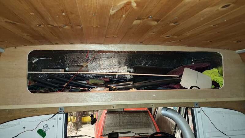

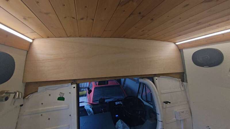

In a break from electrical work I've started to tidy up the overcab storage area. It's basically just a shelf above the cab where stuff gets dumped, and I've been meaning to do something about it for the last 10 years.
Not wanting to rush into it, I've made a start. First job was to cut a piece of ply to the right shape, and put it into position to check the fit. There's a steel strut at the top pf the cab height, so it needed be as big as possible so it just slid past this and into the wider part above. It fits!
Although was such a tight fit I had to tap it into position with a hammer, and that meant I couldn't remove it past the strut to cut an opening into it! So resorted to cutting it in situ, which was a little bit awkward.
Not sure whether it would have looked neater to follow the curve of the roof, but it'll all be covered by the hatch so probably doesn't matter.
Next was the little infill piece on the top offside, between the new wood and the existing ply lining. I confess that when I first converted it I was so strapped for cash that I reused the original ply lining (after fitting the insulation), and in some places it wasn't a great fit.
I've already bonded in a few discs to support the new infill, so just needed to cut the slightly complex shape to size. I'm an engineer rather than a carpenter, so I was pretty pleased with the end result. It's slightly short as it was from an offcut, but there was no way I was buying a complete 8' x 4' sheet for this one little piece!
Hopefully I'll cover and paint it sometime in the next 10 years...

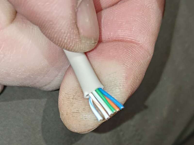

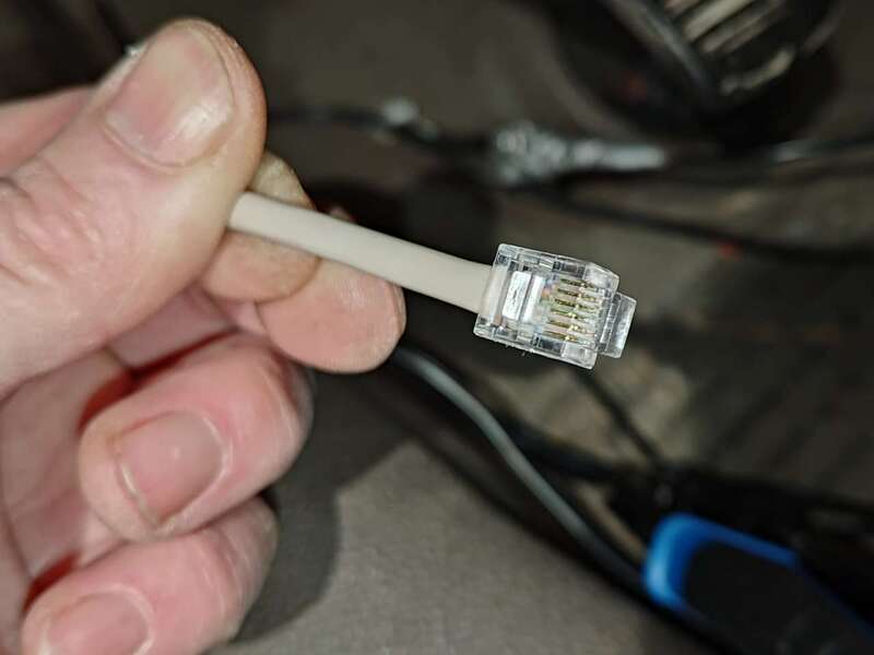

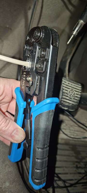

I needed to route the wiring properly for the new meter,  But Victron had supplied probably around 10 metres of cable which I didn't really want to try and coil up out of sight. It was just a standard RJ12 lead, so a simple job to trim to length, and just fit another plug to it.
I've only ever done them once before and that was when the apprentice they made do had crimped it with the plug upside down lol. So near, yet so far....

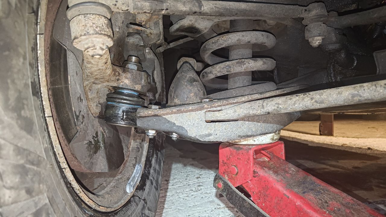

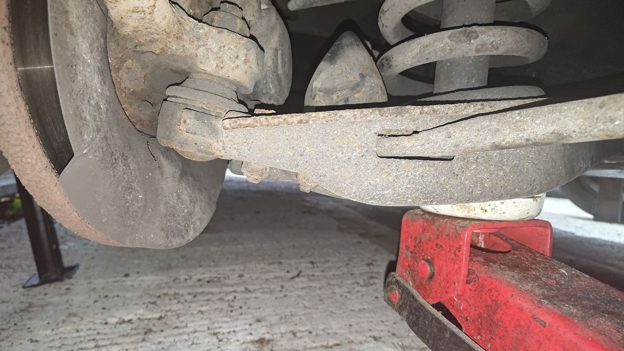

One of the ball joints was an MOT advisory, so changed that.

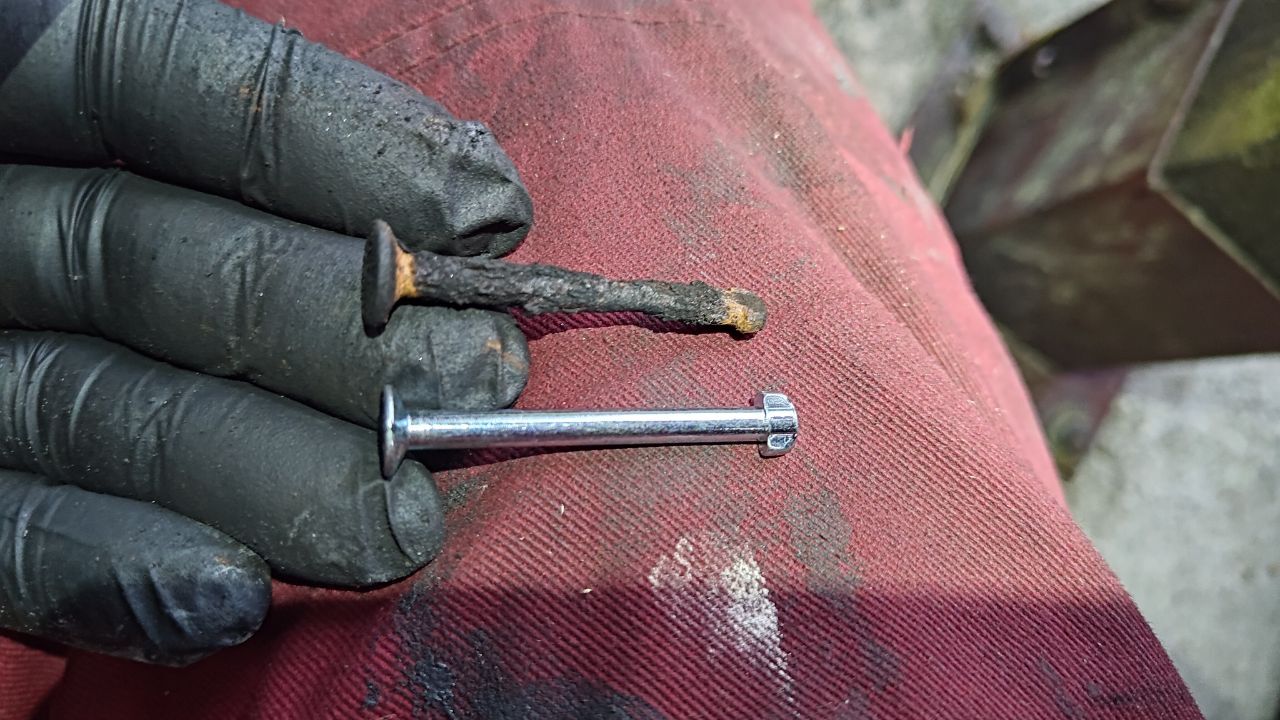

And I had a broken spring on the rear brakes.
The fittings had seen better days too!

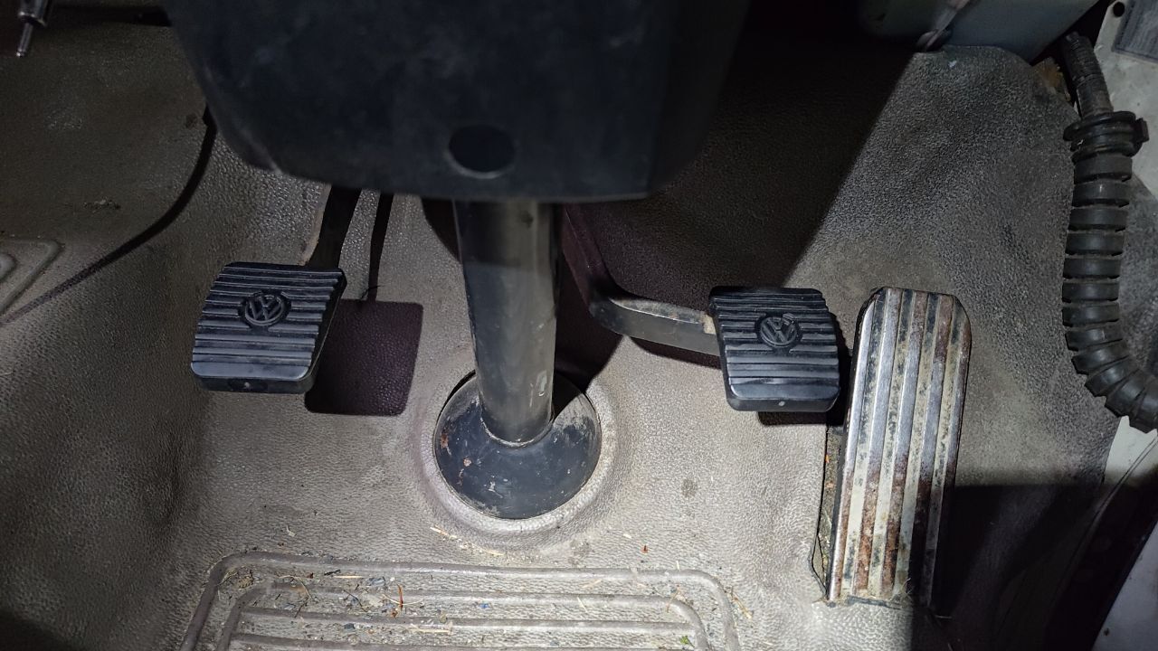

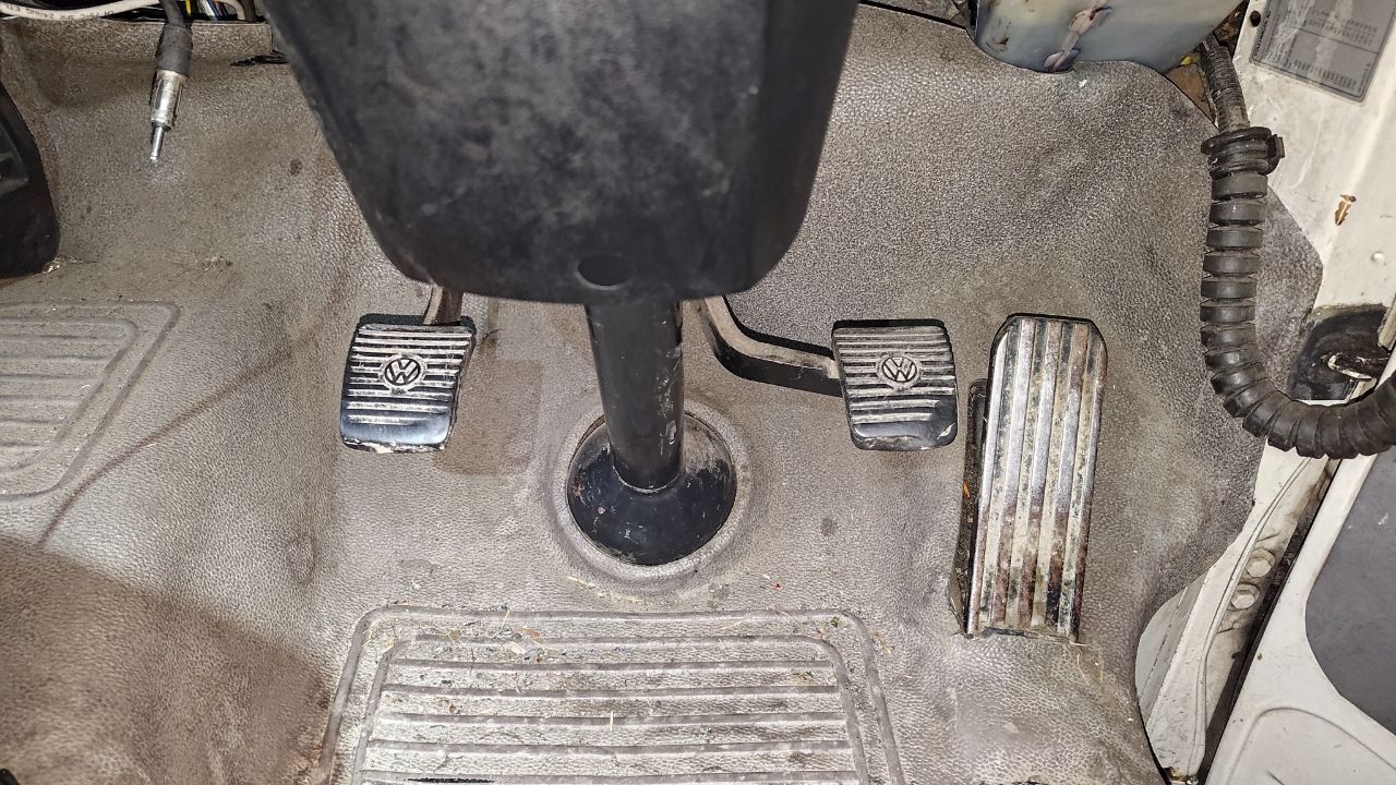

A minor item which is now available again, is the pedal rubbers.

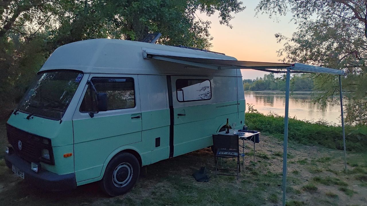

Ended up in one of my favourite places, the Loire.
But all too soon it was time to head home.

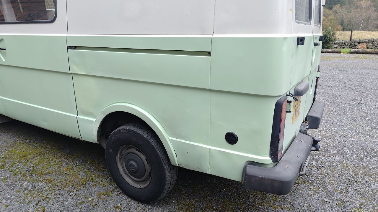

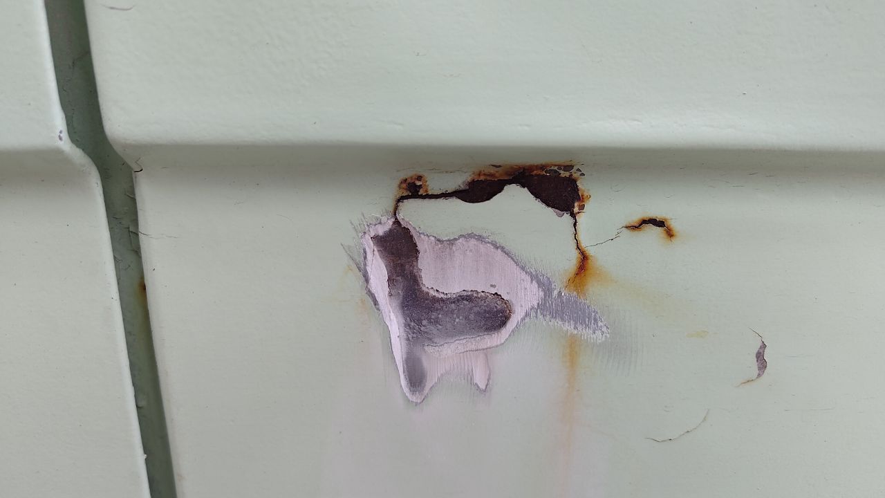

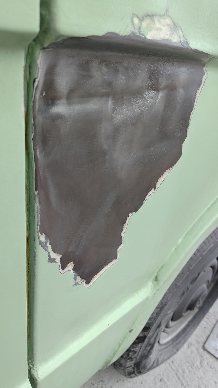

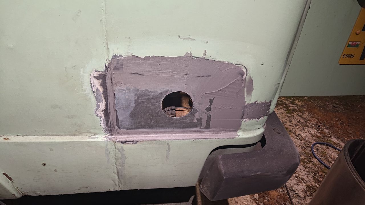

I'm taking advantage of some dry weather to catch up with a spot of bodywork. There was one dent next to the sliding door which is previously filled, but the filler had cracked and allowed water in with predictable results.
TBH there's a bit more depth of filler than I'd like, but I don't really want to weld in a new piece of metal. I'd previously filled on top of Zinga, which hadn't adhered perfectly to the wire brushed surface.
This time I phosphate treated the surface after roughening with 40 grit abrasive, so hoping the filler will adhere better.
I'm still actually using a file (originally for horse'a hooves) given to me years ago by @Talbot for smoothing body filler, which probably says how little bodywork I actually do!
Then a coat of primer.

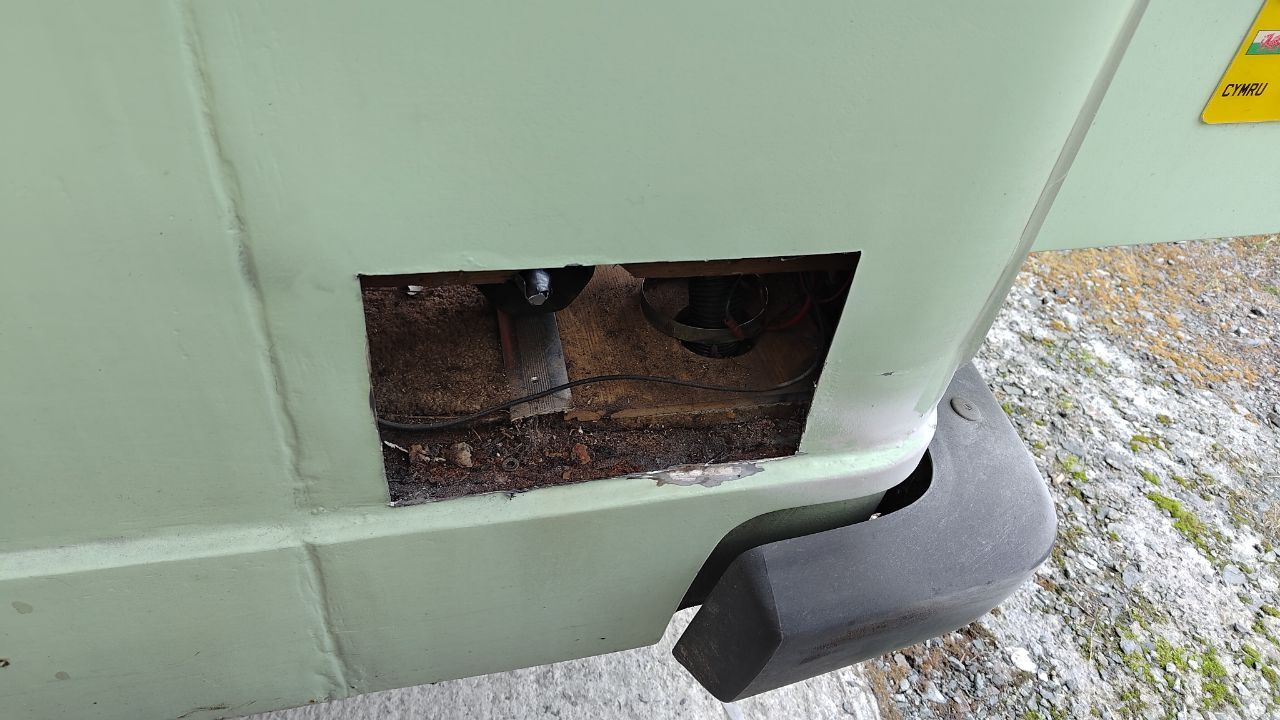

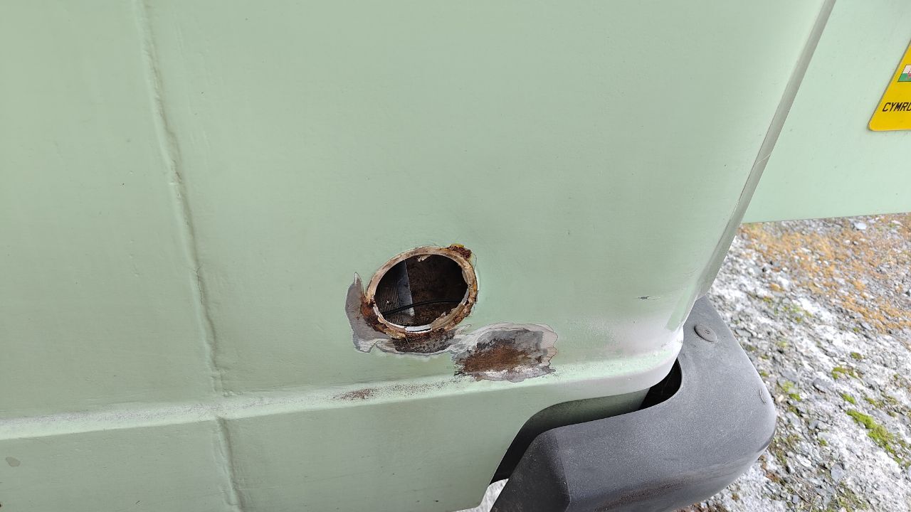

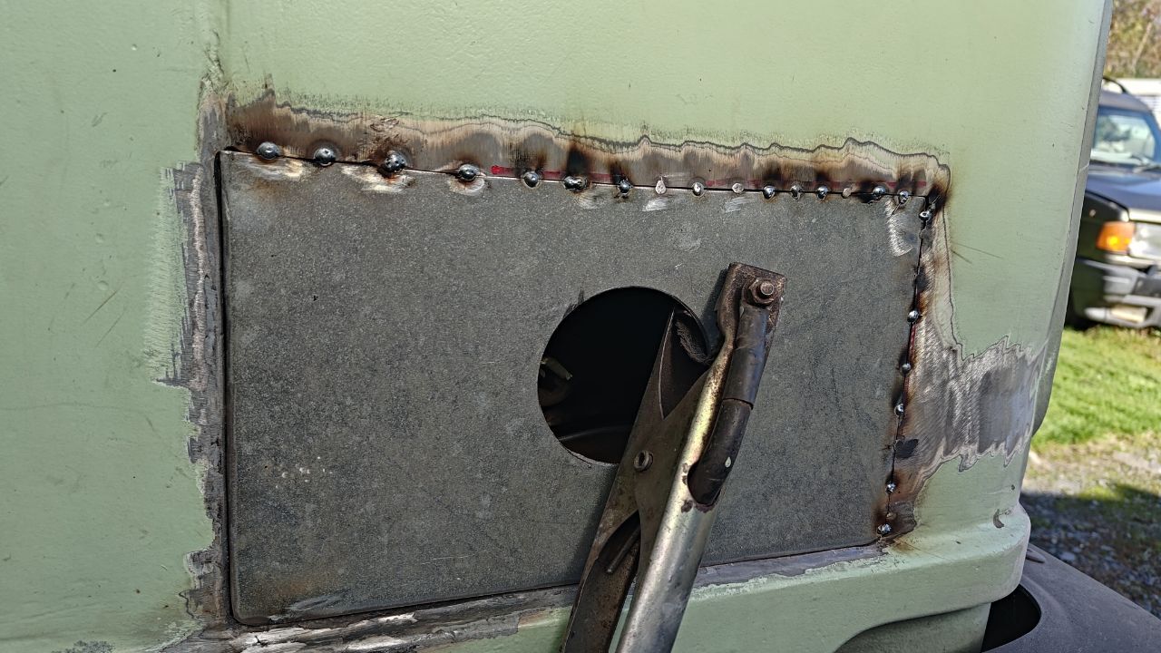

I'm waiting to do the top coat, as there's another area needing attention, around the LPG filler.
The rust had set in too deeply IMO to salvage the panel (it was already pitted before I fitted the filler, and the location was chosen to cut out an existing rust hole!) So I cut the lot out...
...and will replace with a sheet of galvanised steel.
I ran out of gas last night whilst tacking into place, so just started welding properly today.
Obviously I have to go super slowly to try and avoid distortion, but my plan is to leave the two joints along the seams until last, and give the panel chance to move a bit while I do the two trickier joints.
Despite doing no more than 4 spots (dotted about the edges) at a time, and letting it cool, it still distorted along the top edge.
Left and bottom edges were easy in comparison!
So a skim of filler was required, but nothing too deep.
I needed to use the van again, so have given it a quick localised blow over from a rattle can, rather than roller it on. This is glossier (and a slightly different shade!) to the original Rustoleum, so less forgiving of my handiwork. It really does need a couple more goes with filler I think, but in reality I think I'll be doing another bottom half paint job in the not too distant future.
Looks passable at several paces, and more importantly protected from rust.
