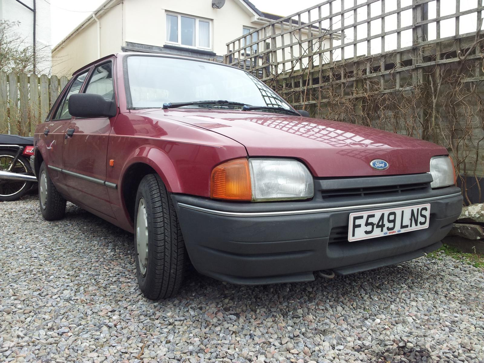

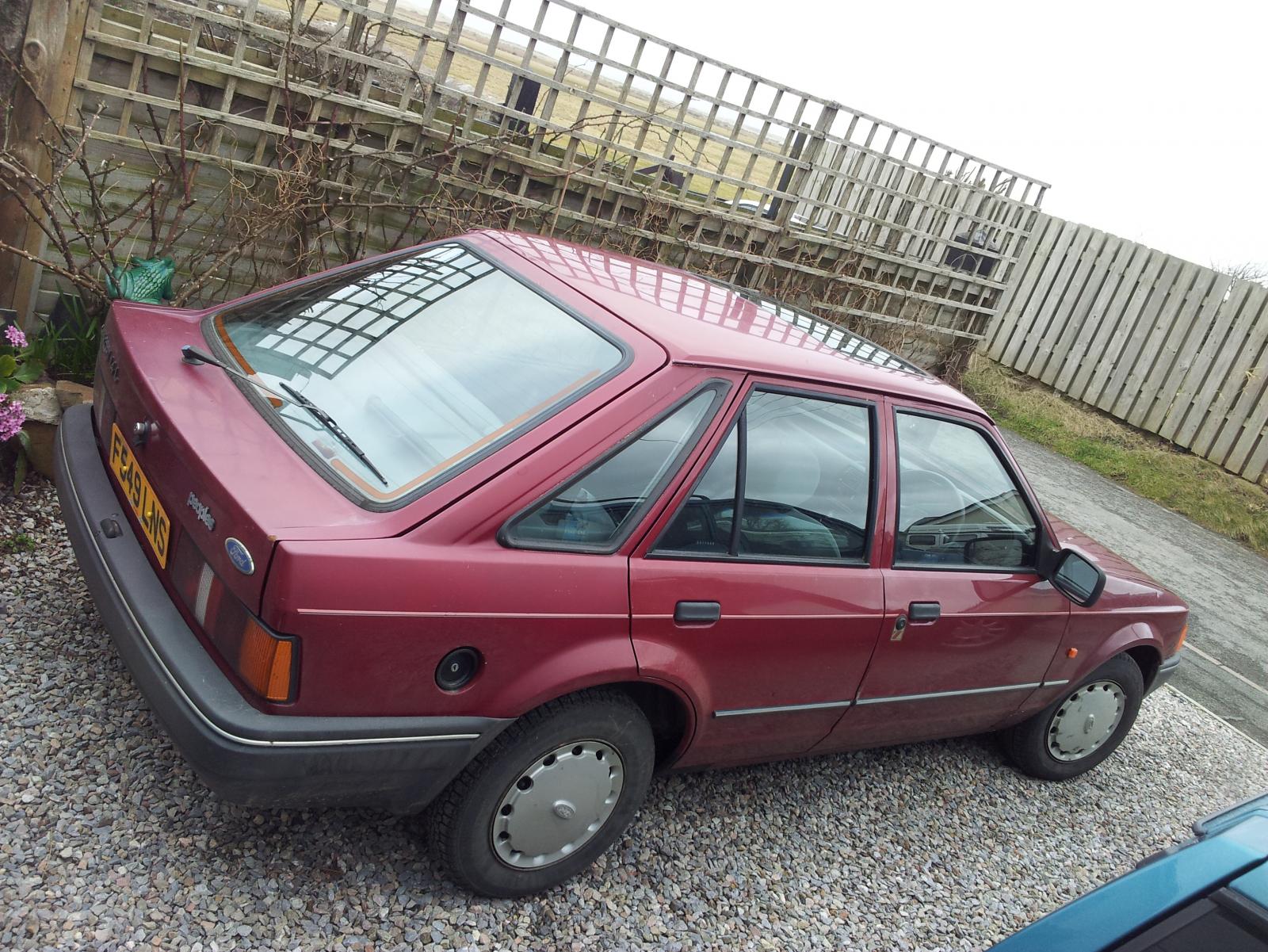

Some overdue pictures...
The Escort's been a pleasurable runaround all weekend while the Volvo continues to dry out after the heater valve replacement nightmare (thankfully now done).  The Escort also sports a pond, thankfully not antifreezey and confined to the boot.  Gary reckoned this was rear light seals and he was right, both were soggy and knackered.  2 new ones fitted and water mopped up, carpet out to dry, job done...once I replace a couple of missing 8mm bolts on the light units.  A quick jetwash and some rain has so far shown it to be watertight.
The paintwork is pretty bad but will hopefully respond partly to a good polish, the back end seems to have been resprayed badly at some point and it's coming off in places, showing a white undercoat completely absent from the rest of the car.  Those rear tyres make a dreadful racket too, they seem to have gone as hard as nails so they're high on the wish list after seeing how much a decent pair of Firestones on the front transformed the steering.
